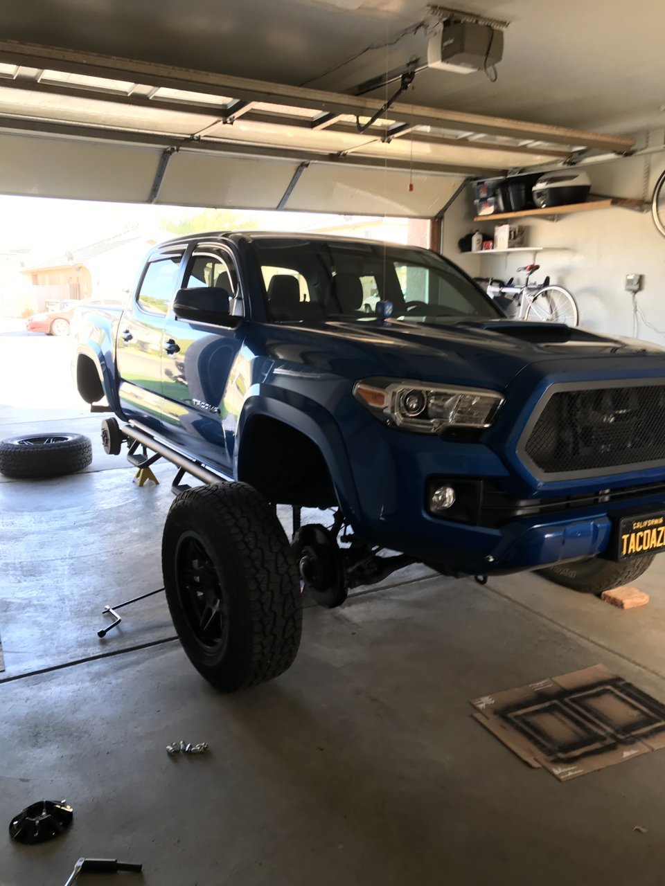

    That's what i did when i switched to black lugnuts.
    raised rear by diff and put jack stands on the frame
    took both rear wheels off
    lifted front drivers side with jack
    front drivers side wheel went to rear drivers side
    rear passengers side wheel went to front drivers side
    lowered front drivers side
    lifted front passengers side
    front passengers side wheel went to rear passengers side
    rear drivers side wheel went to front passengers side
    front wheels were chocked when they were on the ground
    easy peasy
