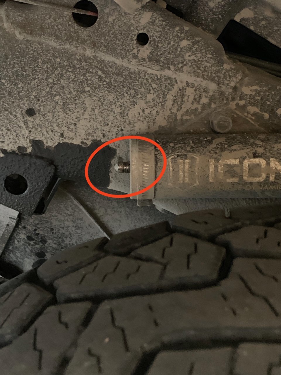

    What is this valve for?

    DON'T TOUCH IT!!!!
    that valve is for blowing up your tuck. its like a self destruct button in case you regret buying Icons

    But srsly, I'm pretty sure its Schrader valve for recharging the shock with nitrogen

    Correct, that us the Schrader Valve when the shock is filled with nitrogen.

    Well, I emptied it before I asked the question... And fluid came out with it. :notsure:

    depending on how long you pressed it for and how much oil came out, you may need to get it rebuilt and serviced. you may have just let out all the nitrogen and killed the shock... told you it was a self destruct button
    also, didn't anyone ever teach you that if you don't know what something is, don't mess with it lol

    Remove shock, send it in for a rebuild, dont do that again. Good luck OP.

    If you have access to a nitrogen tank you can tip them off to 150psi.
    Running the shock without nitrogen is no recommended and will shorten the life of you shock, but more importantly the ride quality will suffer due to the loss of nitrogen.
