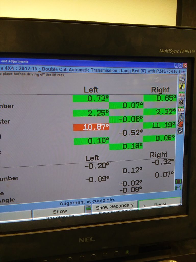

    Just now on the alignment rack here you go.

    Is that on your 15? That's actually a lot better than I expected. What are your hub to fender measurements? It seems a lot better than *most* 2gen alignments with 2.5" lift.
    If all techs did alignments like you there would be far less posts on here questioning their new alignments. :thumbsup:

    Yes its the 15, I couldnt tell you the height as I never measured, but the SAI is a little off on the drivers side for some reason, over time things have settled and it could probably be put back that extra tenth on both camber and caster which would probably fix the SAI. But i was in a hurry so I didnt make any adjustments. Once you hit that 3in mark getting that much caster is pretty hard, but 2.5 you should be able to get in spec all day long unless theres something wrong with the suspension.

    Would you prefer 0 camber or are you good with ~.6°+? I know a lot of people prefer 0 or even slightly negative, but you'll lose your caster doing that. I set my camber at 0 because I can with my SPC arms and can't find any reason to add camber. :notsure:

    When you start loading up your cab with people camber goes down, toyota has these specs with the truck unloaded, some manufacturers gave you do an alignment with specific weights in the seats

    So to actually answer your question yes I would prefer a little more positive then negative.

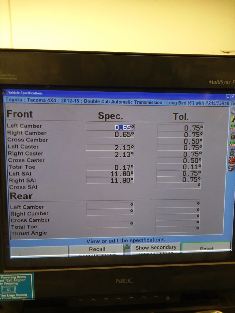

    Good to know. I have been curious why a lot of alignment sheets show them shooting for a half degree of positive camber.
    Although while accelerating your front end will rise causing more positive camber. :goingcrazy:
