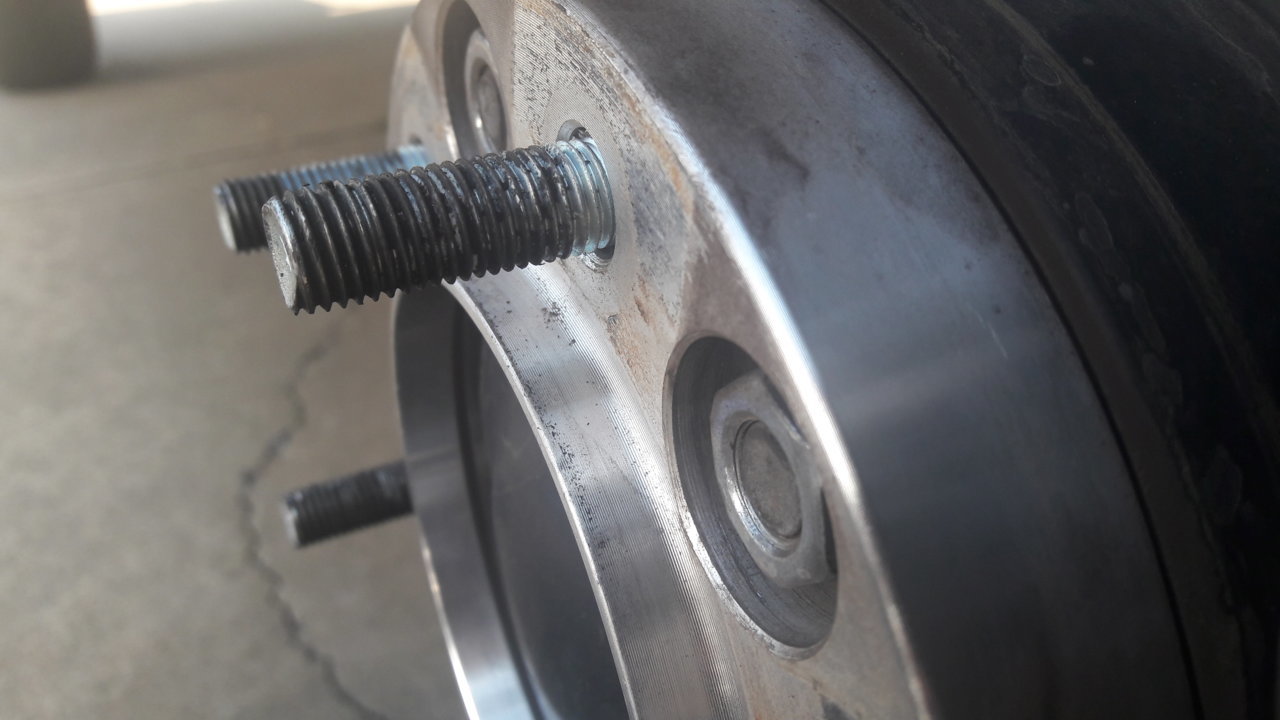

    So I got my lift installed and put my wheel spacers on..I went with 1.25 just to be safe (should have gone 1 inch but meh)....This is what my rears look like but I was concerned about how my fronts only go on the factory stud about half way or a smudge more...
    How do your fronts look?

    that is his front. you need extended studs with the 1.25 spacers.

    manufacturer says It only needs 6 threads. Its about half way all in all so its right at about 6 threads deep.
    Im hoping I can just roll like it is.

    ^ What Devin said.
    I've had 1.25 and 1.5. No issues.

    most guys go with extended lugs including me although i did run them for a while without.
