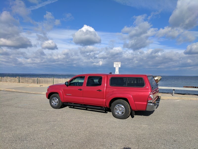

    I live on Long Island where it is pretty flat and the 2.7 has plenty of power for my use. LI is flat. I went upstate NY today and was wondering how it handle the inclines on highway mountain roads and found with cruise control it downshifts to 3rd often on inclines. Also if Im in 4th doing 70 and push the peddle down say around half way without changing gears it doesnt maintain the speed. So i was manually shifting down to 3rd and it stayed under 3k rpm. And was able to keep speed better and a few inclines it shifted down to 2nd and was over 4k rpm. So my question is if I shift manually to 3rd sometimes at highway speeds is it bad for my transmission? Is it bad to just run in 3rd when in the mountains? my 5 lug seems happier in 3rd up in the mountains. The 3rd gear ratio is the same as manual 5 speed 4th gear. I have a double cab 5 lug.IMG_20161230_113908.jpg

    Are those tires bigger than factory? My eyes may be playing tricks on me, but they seem closer to a 6-lug's wheel size.

    Yes I put 235/75r15s on. first thing I did. Thanks for the response.

    these will make the engine lug and work harder than the stock tires, but nothing wrong with downshifting to 3rd I do it all the time

    yep. those stock tires are just too small. 3rd it is.

    I run 245/75R16 and my truck is an auto. The engine lugs in most cases but I have been running it that way since 2010 with out any issues other than higher fuel consumption. A Prerunner with a 2.7 usually comes with 4.10 rear gears for the larger tires which were 245/75R16. The small 3.58 rear gears on the 5 lug are pretty borderline for 235/75R15 but is under geared for tires I run. The key is to stay with a light and very round tire. My Toyos require very little weight to balance and are fairly low rolling resistance.
