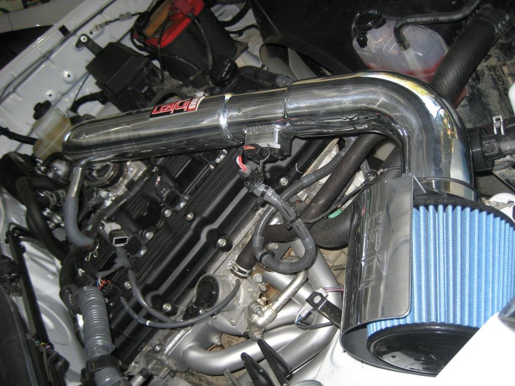

    The runs were done with a stock 2.7, an Injen intake...
    ...an LCEngineering header...
    ...no power steering, no air conditioning...
    ...stock ECU, no tuning, and Regular 87 octane pump gas.

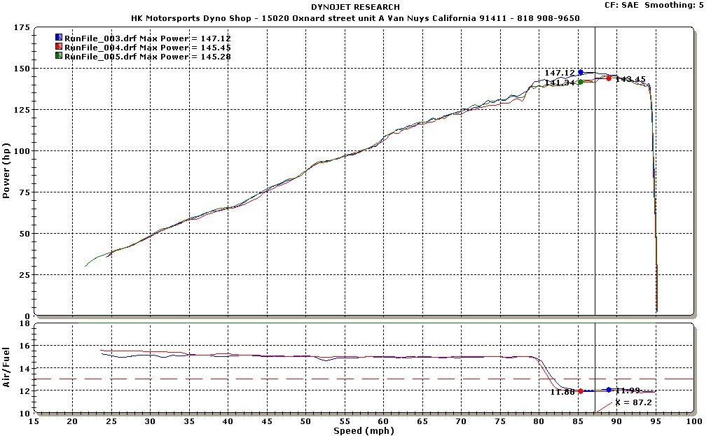

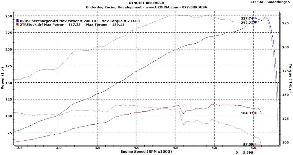

    Here are the URD bone stock baseline dyno runs.
    The results:
    Bone stock 2.7 URD baseline runs:
    117 hp 139 ftlbs
    119 hp 133 ftlbs
    My stock 2.7 baseline results with Injen intake, LCE header, and stock exhaust:
    145 hp 158 ftlbs
    Net gain:
    26 hp 19 ftlbs :)
    I'm happy with the results from just a few simple bolt on mods.

    So far I have recorded gains of 22% more horsepower and 14% more torque with just a header and an intake. Heck, the intake isn't even cold air, (I think they're highly overrated). I'm running the stock muffler so as not to lose the low end torque, as that's the little 2.7's strong suit. :thumbsup:

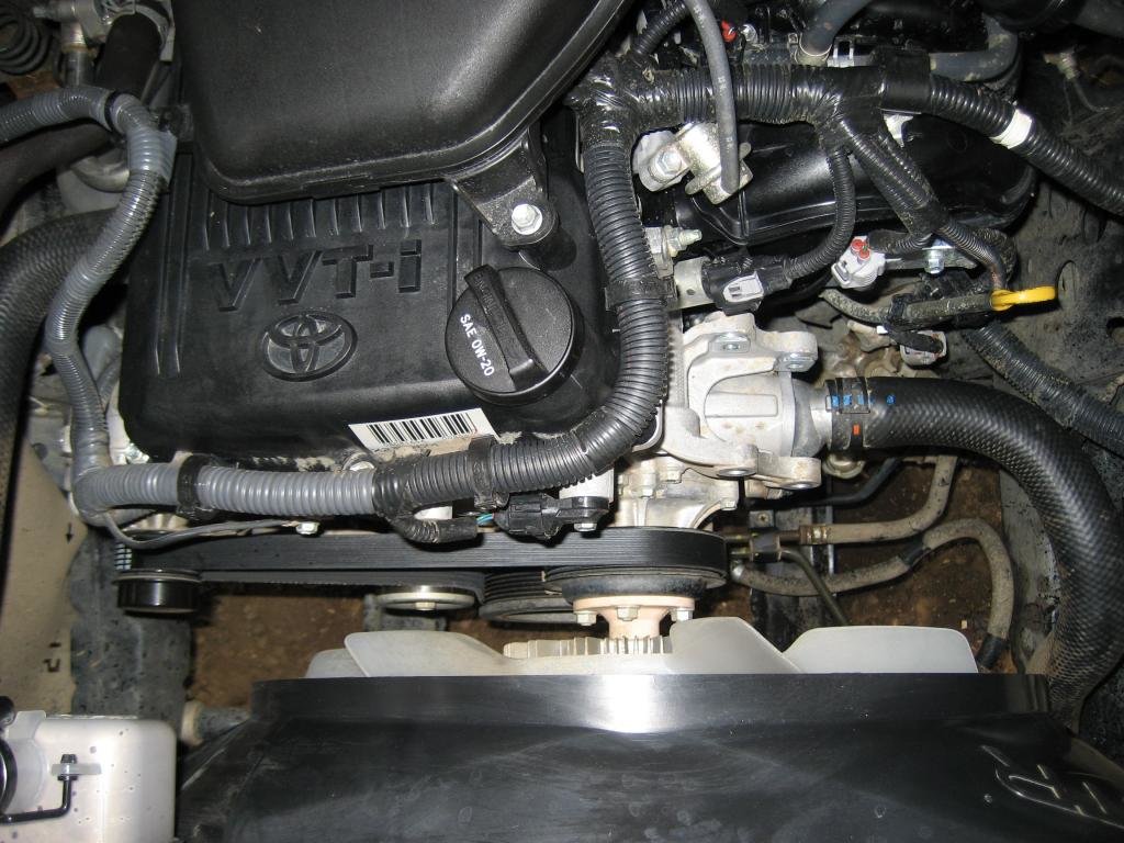

    The gain is minimal as the AC compressor pulley freewheels when it's off because its electric clutch is disengaged.
    And there is no steering input when running on the dyno, so there is zero hydraulic load on the power steering pump.
    Still every little bit helps, and I'm sure that it's good for a couple of hp.
    I removed all of the extra idler pulleys while retaining the spring loaded tensioner, and am running a short belt so the crankshaft turns just the water pump and alternator.

    I have noticed my stock intake has a decent growl at certain RPMs,
    Is the Injen noticeably louder?
    I imagine so...
  17. Jul 10, 2013 at 3:07 PM
    #17
    tooter
    tooter [OP] play every day
    Apr 13, 2013
    #102021
    2,450
    Greg
    Los Angeles
    2012, std cab, 5 lug, 2.7, 5 speed
    Built for maximum low end torque, tooter II.VII intake manifold spacer, LCE long tube header, Injen long tube intake, 2,900 rpm torque peak.
    Since there is no air box to resonate the sound, the Injen intake is actually very quiet under all normal driving conditions (and I also run the quiet stock muffler)... except wide open throttle.
    Because the intake tube is a whopping three feet long...
    when you mash the pedal you hear this really deep BBBBBWWWWWWAAAAAA!!!!! :eek:
    The Injen intake is also very economically priced at only $220 including free shipping from MicroImage.com. :thumbsup:
