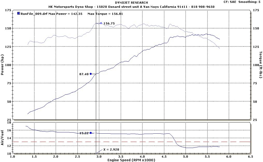

    Ok, here's the before and after dyno runs. :)
    These two were 4th gear runs, so the speed limiter cuts off the engine at about 4,700rpm. The spacer run started really low, at just 1,200rpm.
    BLUE: stock intake
    RED: tooter 2.7 intake manifold spacer
    (ta da... :) )
    The torque peak is now increased by 2ftlbs over stock to 160 ftlbs @ 2,900 rpm. :)
    And also look at what is happening at that 2,900 rpm. There's a difference of 10 ftlbs from the stock intake.
    Now, we did one run in third gear just to be able to get a horsepower peak up to red line.
    tooter 2.7 147 hp
    stock intake 145 hp
    Conclusion: While the torque peak itself was only slightly increased, ithe peak was lowered way down to only 2,900 rpm, and at that rpm the tooter 2.7 yields an increase of 10 ftlbs over stock at that rpm.

    ...have all been completed. And the results have successful. The tooter 2.7 has been proven to be a useful product because it lowers the torque curve, fattens the curve at very low rpms, and slightly increases the torque peak... and all without giving up peak horsepower. :)

    That is all on the OEM tune correct? If so, man does it run lean until after 4000 rpms.
    Aside from that, good implementation. Glad to see your piece is making gains. :thumbsup:

    Yes. Both runs were done with a totally stock ECM, no tuning, and just regular 87 octane pump gasoline.
    I'm sure that more gains can be gotten from tuning, but these runs were made only to quantify the difference of before and after the tooter 2.7 without any other changes to cloud the accuracy of the results.
