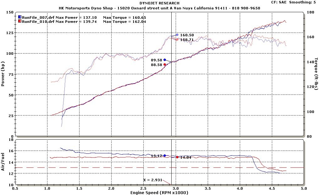

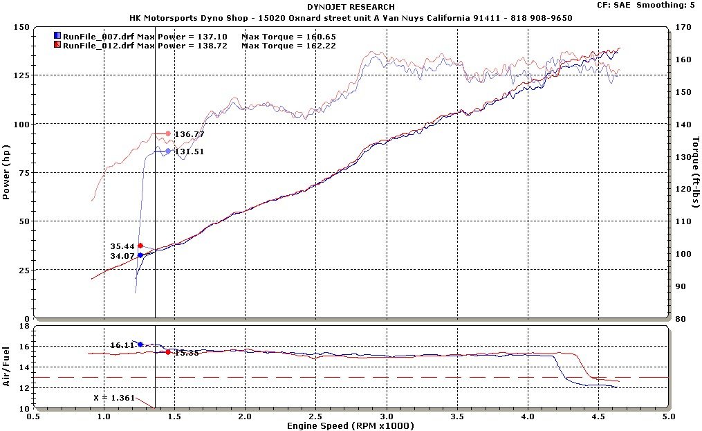

    Got some more 2.7 dyno runs to post up. This thread is helpful in that they can all be found in one place minus a lot of surrounding text. :)
    This is a head to head comparison between the stock 2.7 muffler, and a 22 inch long 5x11 oval Magnaflow muffler.
    This one is a head to head comparison between that same 22 inch Magnaflow and a Flowmaster 50 Series Delta Flow muffler.

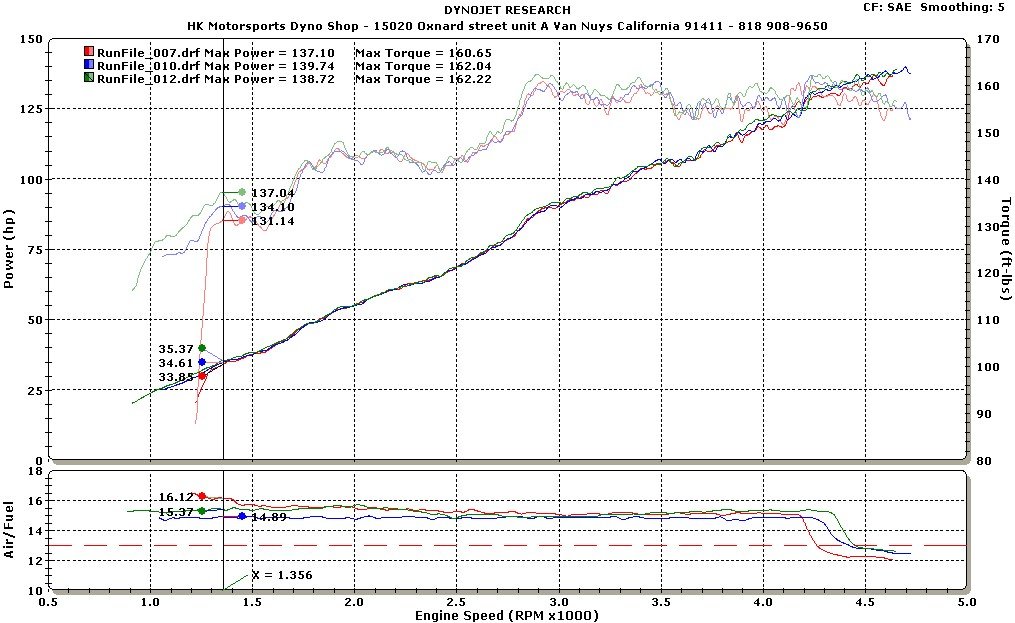

    Here's all three together.
    All of these runs were 4th gear so the speed limiter cut them off at 4,700 rpms. That's the equivalence of 110 mph.

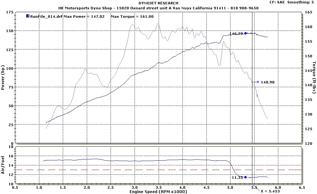

    This is run up to redline we did in 3rd gear to get around the speed limiter. Using URD's baseline 2.7 dyno run of 119hp 133 tq shows a difference of +28hp and +28 tq.

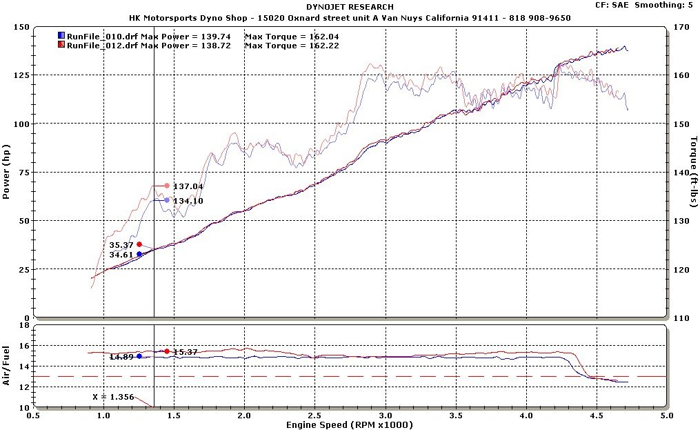

    Just one more chart from the muffler shootout... :)
    This is the Flowmaster compared to the stock muffler. The factory muffler line would have done better if it started at as a low rpm as the Flowmaster run. We actually got the dyno to begin recording at only 900 rpms. I've never seen any dyno chart begin that low.

    Another item worth noting...
    The stock torque peak is 3,800 rpms. My engine with the stock muffler hits its torque peak at 2,900 rpms. Now look closely at the Flowmaster run. It meets and surpasses the stock muffler torque peak at 2,800 rpms.
    So now there is dyno documentation of three specific mods, all of which shift the torque peak lower in the rpm range.
    1. LCE long tube header 650 rpms
    2. Tooter intake manifold spacer 250 rpms
    3. Flowmaster Series 50 Delta Flow muffler 100 rpms
    With these mods the torque peak is achieved 1,000 rpms sooner than a stock engine... and as well all three increase the torque peak itself. This is an improvement of 25% over a factory stock engine. :)

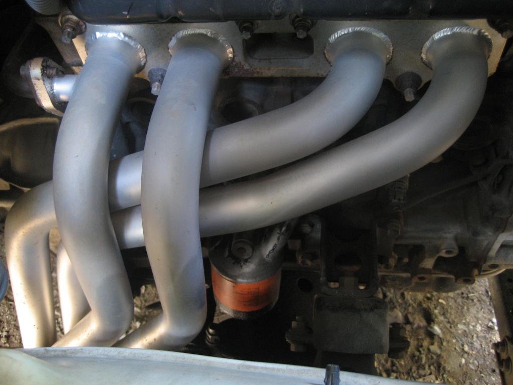

    I had a 1996 Tacoma with the 2.4 engine, and only did one mod to it... an LCE long tube header. This is a picture of it after 10 years.
    It held up amazingly well and really helped the engine to pull stronger at low rpms. It's a straightforward simple bolt on, and replaces the single stock down tube with longer individual runners and bolts directly onto the catalytic converter flange.
    I highly recommend it for your 2.4. It's the one accessory that will help your towing ability the most (besides lower final gearing of course). ;)
