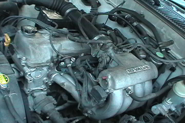

    heres my 95 tacoma automatic with like 195k miles on the mustang dyno. its all bone stock engine has a bad cat also brand new 31x10.5 toyo mt tires. made 113.2 whp at 4700 rpm and 142 tq at 2300 rpm.
    only thing ive hanged different on it so far is got a new high flow cat which i notice a difference and a k&n air filter also cut my airbox so more air gets into it. havent been back to dyno it since

    Nice torque at very low rpms. :thumbsup:
    You have that really neat long runner intake manifold with an individual port for each intake valve. I wish it was possible to put one on my 2012.

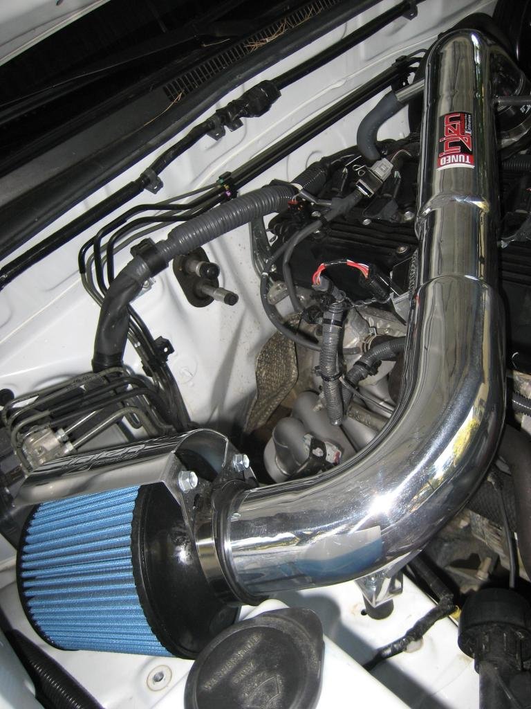

    Hey Tooter, I'm interested on an Injen intake for my 2014 4 cyl. Does the same intake fit 2005 thru 2015?

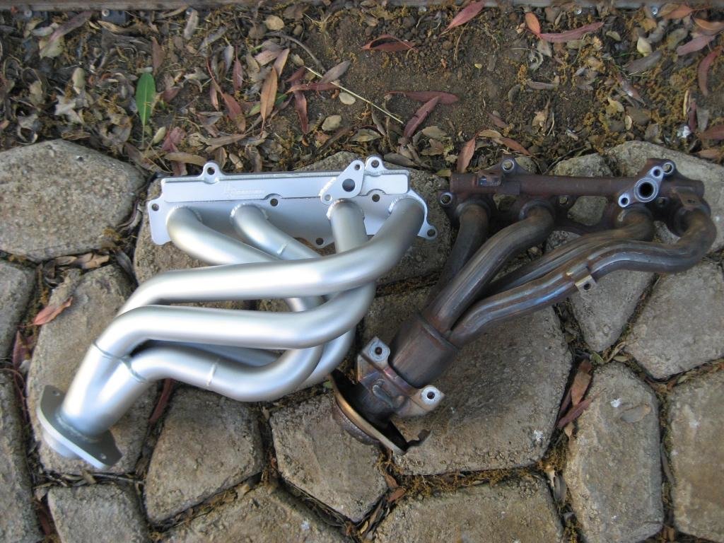

    @tooter LCE 2.7 header worth it?

    He hasn't posted in quite some time. He did say many times how much he enjoyed the engine's improvements in torque, with that header.

    I've been busy working on other projects, so I'm not making spacers. I don't see any reason the Injen intake wouldn't work on any 2TR FE because it clamps directly onto the throttle body throat, and only has one mount.
    Near the bottom of the pic directly under where the intake tube takes a 90 degree there's a little black rubber button. That's the shock mount for the intake. It's the only point of attachment for the intake. This is a really LONG intake... about three feet long. And man oh man does it make a neat sound when you get on it. :)

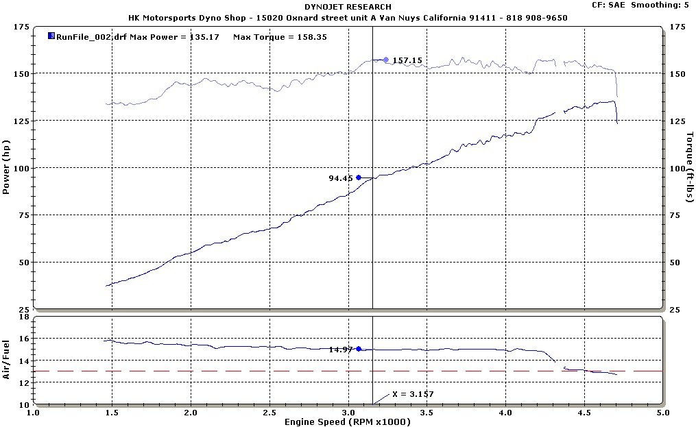

    I agree. :)
    The LCE folded long tube header is the best bang for the buck 2.7 mod. When I dyno tested the header, it lowered the torque peak by 650 rpms down to 3,150 rpms.
    (this dyno chart is just the header alone, no intake spacer and no Flowmaster muffler)

    Actual proof that the product works as advertised. Good to see this as I had been looking at them when they came out but I didn't believe that LCE was accurately providing the dyno figures.

    The factory torque peak for the 2TR is verified by Toyota to be 3,800 rpms.
    My own test results for the long tube LCE header are 3,150 rpms.
    Doug Thorley's own dyno testing results for their short tube tri Y header shows a torque peak of 4,000 rpms.
    Short tubes = more top end.
    Long tubes = more bottom end.
