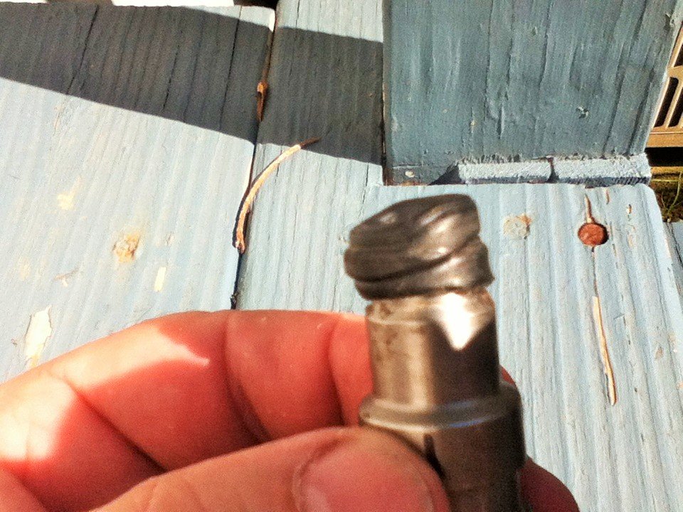

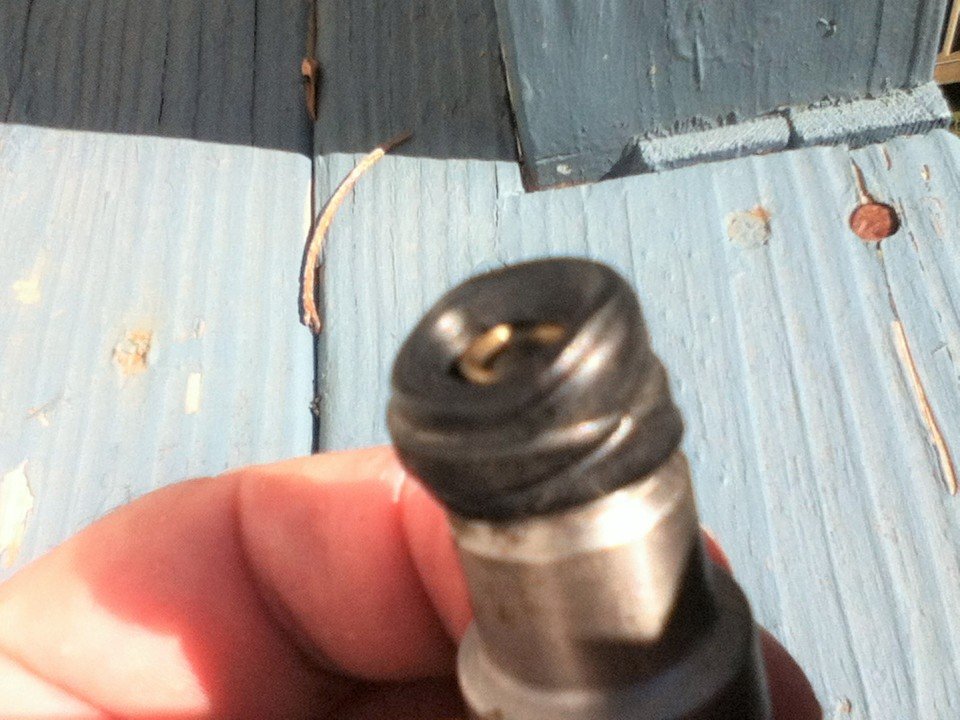

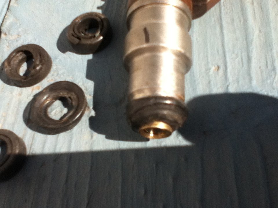

    just got done pulling it apart to clean out the intake , super dirty. i just bought this truck, turns out someone else was in the engine before me, the injectors had 2 lower seals on them partially covering up the spray nozzles ! it ran ok, no power going up a hill though.

    (included a few pics of this guys handy work to the injectors , thought you guys would like a laugh ) !
