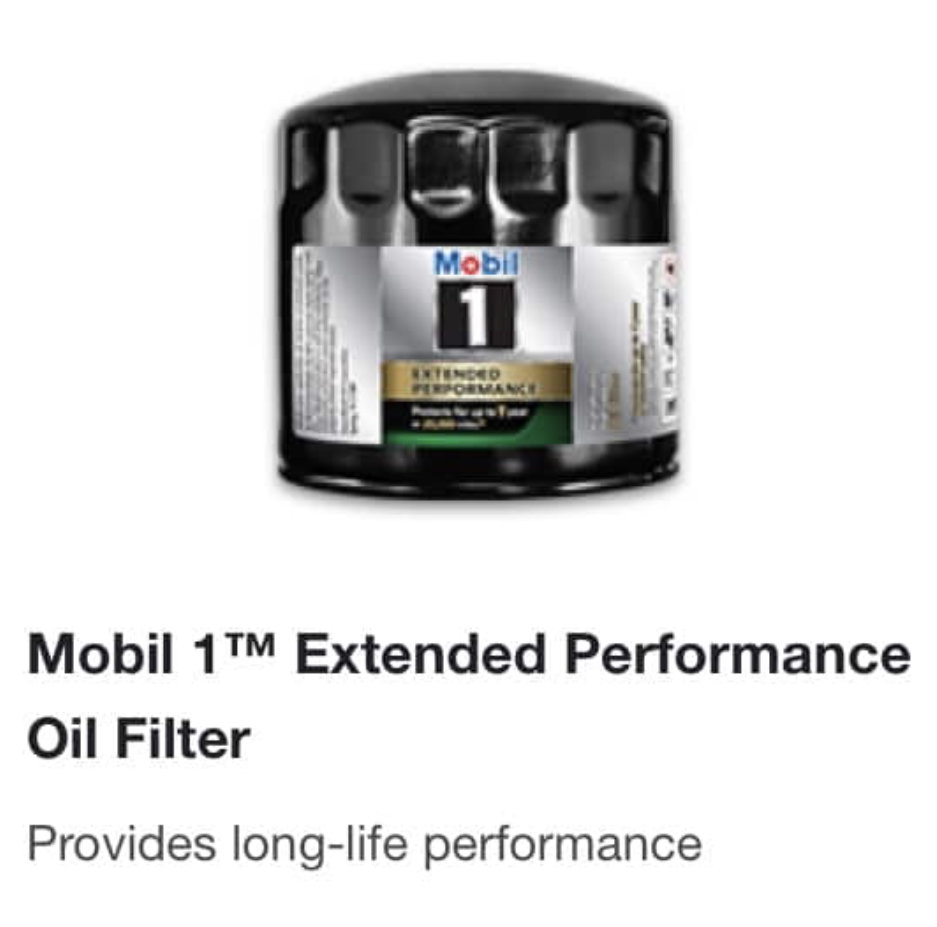

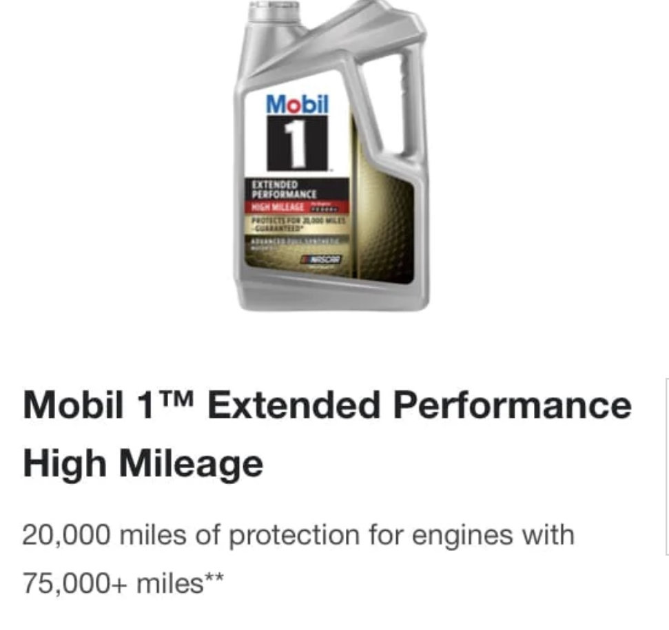

    I change my oil for about $25 with synthetic every 5K - a new truck would be around 40K - I don't think it makes any sense to go for 20K between changes.

    I don't have the guts to go 20K, I get the shakes at 7.5K.

    I totally agree with you I’ve only let it go almost past 7k once or twice. And it’s been just about to turn black and still has some clarity when drained.
