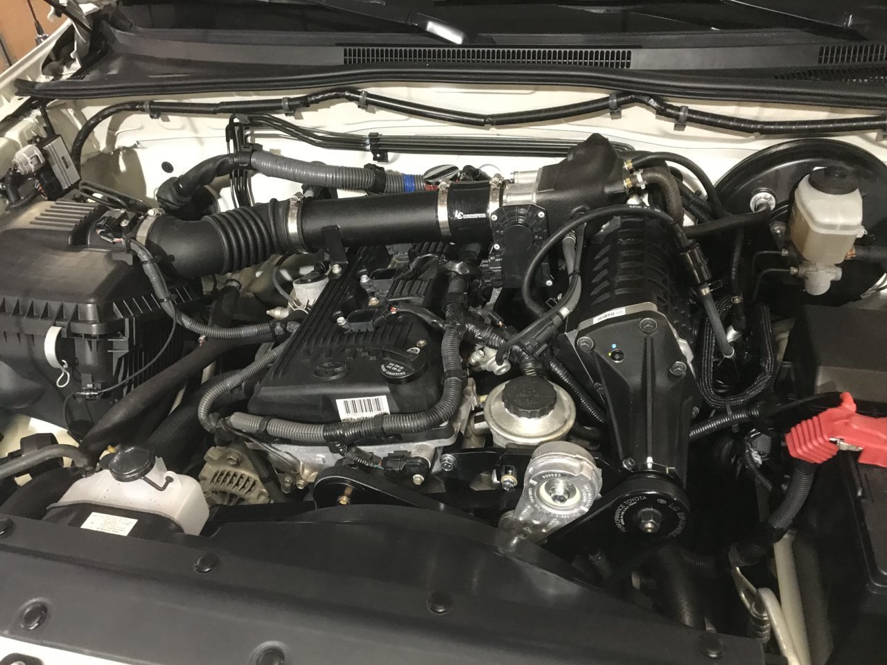

    I'm waiting for this beauty to be released later this year.
    URD has a problem with the rotrex supercharger burning out at 12000 miles. No thanks!

    What is that?

    Link on this !
    Looks bad ass

    Top secret right now, teaser.

    Should we tease some more?
    Maybe something like -“HP is over 200 Torque is 248.7 w/ the bone stock exhaust system @ 111 w/ 20% humidity.”
