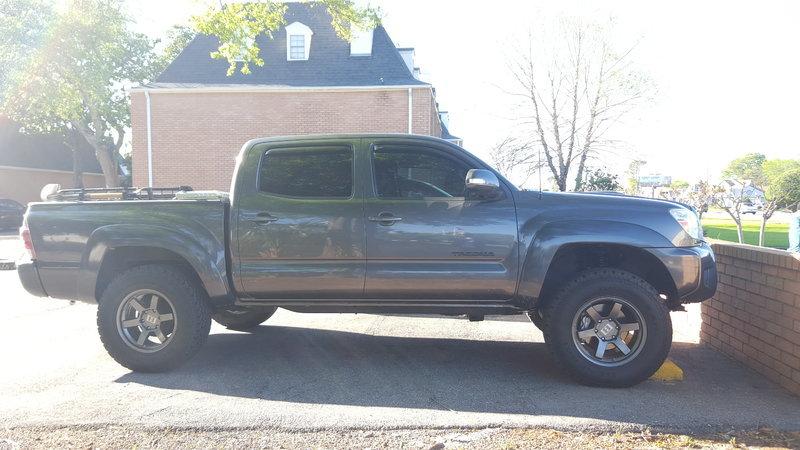

    Trimming will definitely be necessary. Chopping and hammering as well probably. Look into the cab mount chop (CMC) and hammering the pinch weld. This is common to do in order to clear that size.
    As far as the suspension, that's exactly what I'm running, so this is what you should expect. My tire size is 265/70r17 if you're wondering.

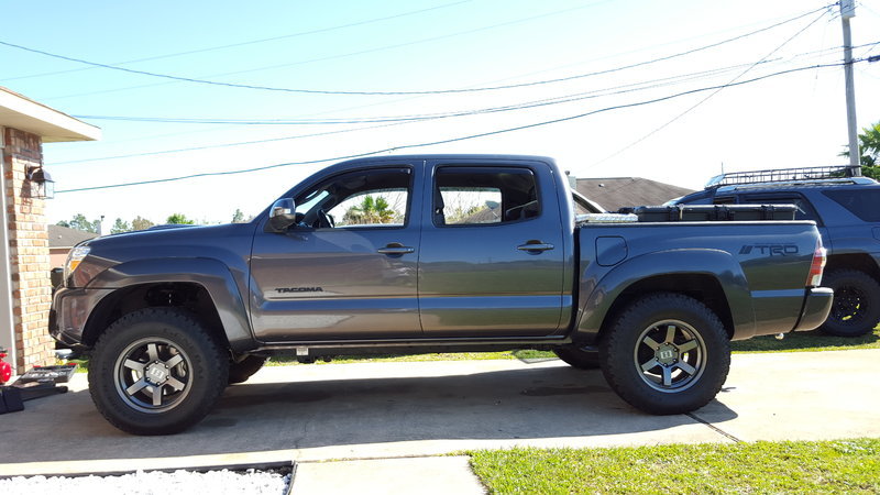

    Agreed! It's not bad, just be prepared for it. Would hate for you to order the tires and not know about it. I also just reread your OP. Are you planning on doing anything in the rear? If not, it'll look like this.

    Not planning to lift the back just the front. Would that require me to do any trimming in the back to fit 33's?

    To be honest, I'm not sure if they'll fit with no lift in the rear. I assume so, but I'd go take a tape measure out there and see how wide the wheel wells are.
    Since you're a Prerunner, you should look into the Maxtrac spindle lift. You can get 4" of lift and then you'll fit 33's no problem. You should lift the rear though if you go that route.

    Depends. I'm guessing since you weren't planning on originally lifting the front, you're fine with a little bro lean? If so, you'd be fine with a 2" AAL and a 5100 back there. That's what I've got and that'll either level you out or you'll be juuuuuust a little bit nose high.
