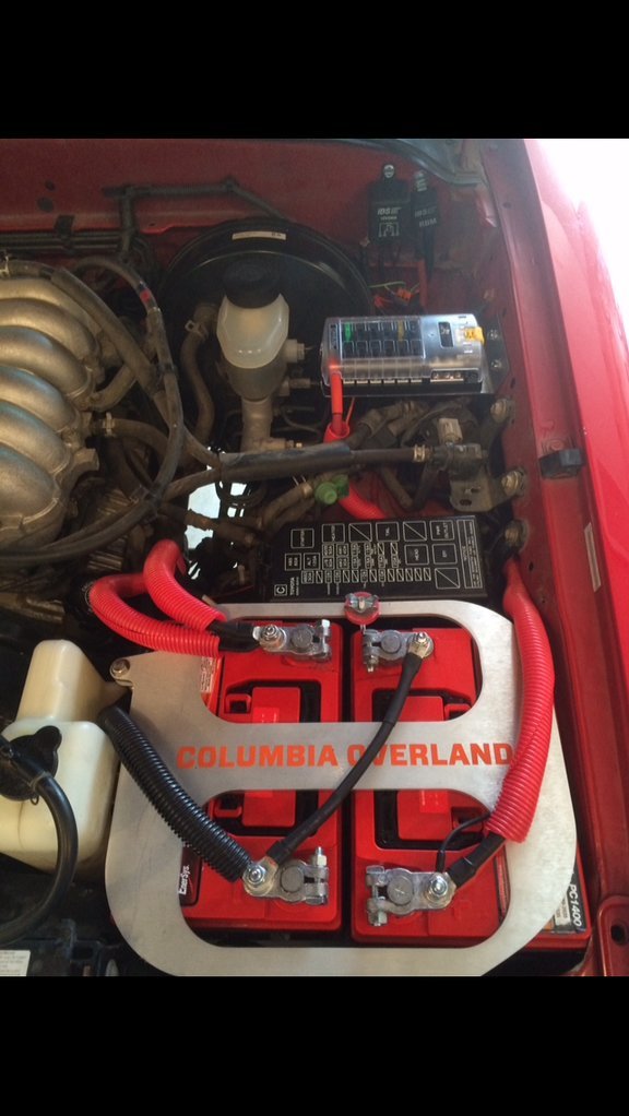

  4. Feb 12, 2019 at 9:37 AM
    austinmtb
    austinmtb Well-Known Member
    Feb 26, 2017
    #211727
    1,053
    Austin
    Southern Oregon
    2004 Toyota Tacoma DC TRD 4x4
    ADS Coilovers & Shocks, All Pro Standard Leafs, TRD Supercharger, Haltech Standalone, URD 2.2'' pulley, Method NV wheels, Copper Discoverer STT Pro tires, ECGS 4:56 gears, custom steel tube bumper, custom steel skid plate,
    Here's my dual battery setup. The battery controller is IBS, the batteries are Odyssey 35 PC1400's, and the battery box is columbia overland. Unfortunately I don't think Columbia Overland is in business anymore, but if you were interested in that mounting setup I'm sure a custom fabricator could build one fairly easily.
    chiefO and Taco critter like this.

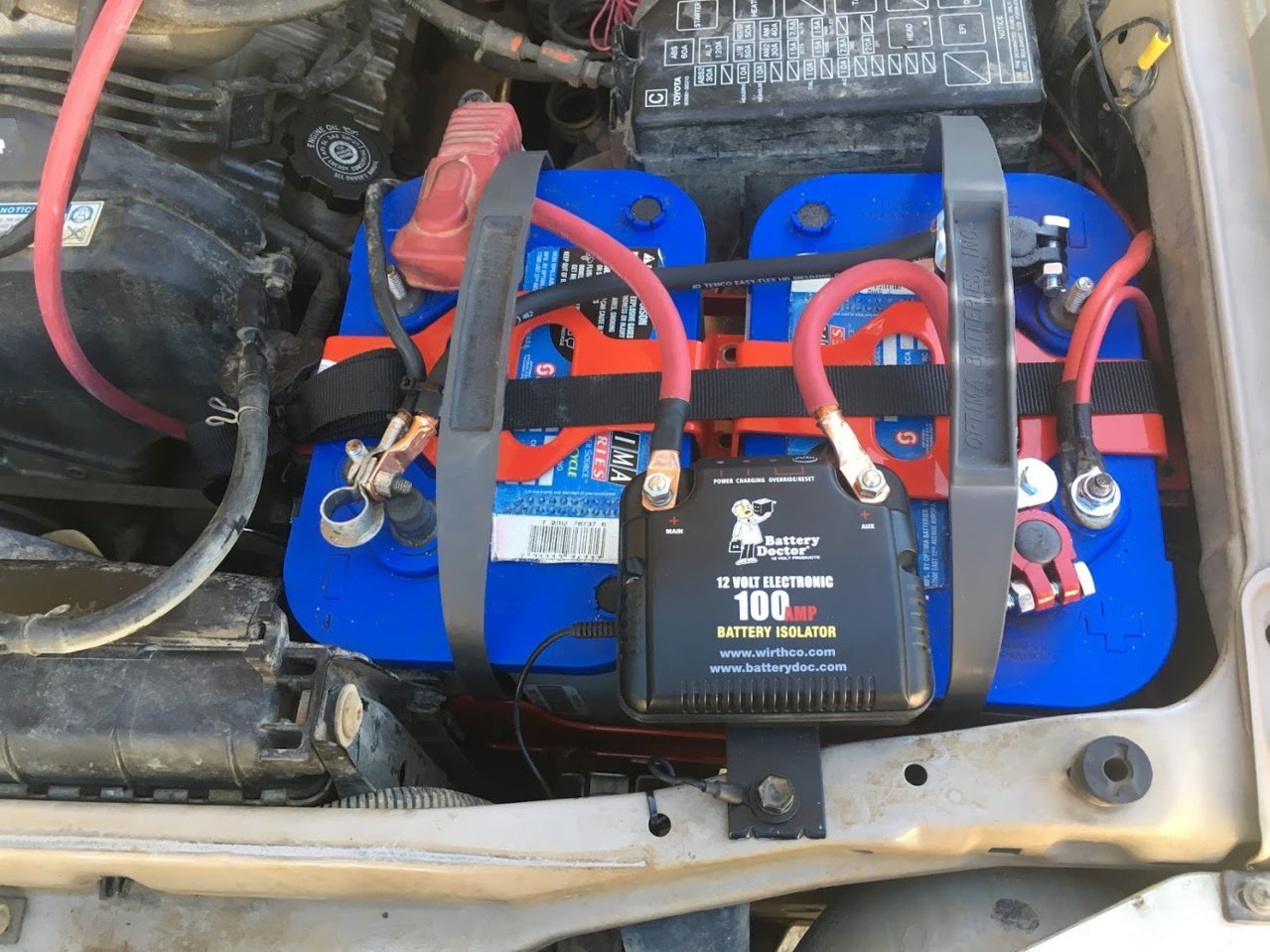

  8. Feb 13, 2019 at 4:22 AM
    anewman9
    anewman9 [OP] Well-Known Member
    Aug 7, 2018
    #262021
    148
    Austin
    ATX
    1997 Tacoma Ext
    ARB Bumpers. Warn Winch Bilstein 3in lift. kargo Master Roof rack. K&N CAI. Mickey Thompson Classic II
    With that said... I currently have the stock alternator. What higher output one should I look to replace it with just to ensure im getting the most out of it?

    Be really careful about putting 2 batteries in the stock location. I would recommend against it. My main support and fender well is bent and cracked from the extra weight. My driver side headlight points at the sky and it's adjusted as low as it can go. I've had this set up since November 2016. I do offroad my truck but not a huge amount.
    I'd also recommend against Optimas, especially for a house battery...and I wouldn't recommend my set up below in general. I've changed it a bunch since I took this picture. I currently have a CTECH D250SA as a DC-DC/solar charge controller and got rid of the battery doctor. I also have a red top and blue top now. I might get rid of the blue top and replace it with a true deep cycle battery and not AGM.
    I'm going to move both my batteries to the bed pretty soon and take the extra weight off that corner. I'll probably put a new wind shield washer bottle in that corner since my current one is a quart size nalgene bottle with the pump jammed into a whole I drilled in the bottom of the bottle.
    As it's been said it doesn't sound like you really need a dual battery system. If you decide to add a battery spend some time on expedition portal and youtube. There's more bad info out there than good info so really really take your time.
