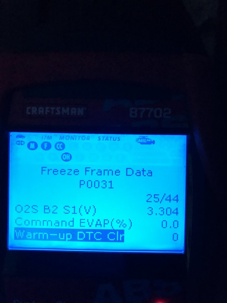

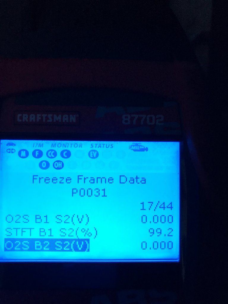

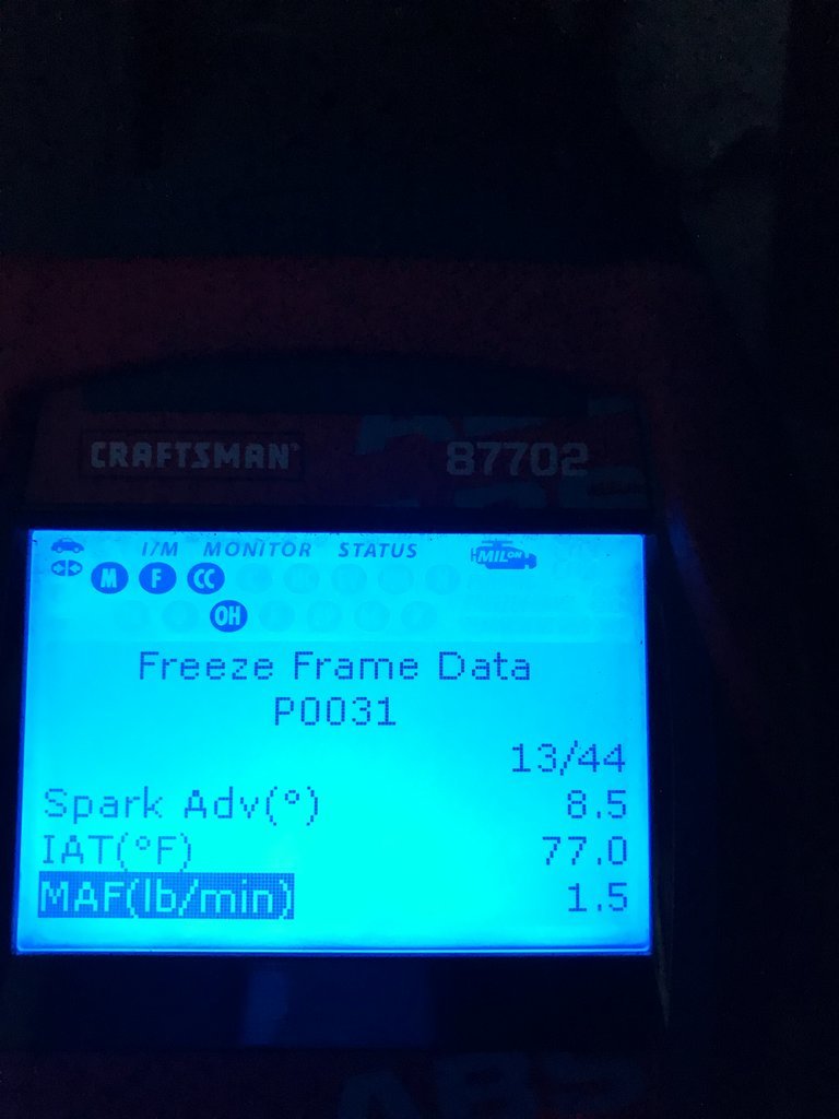

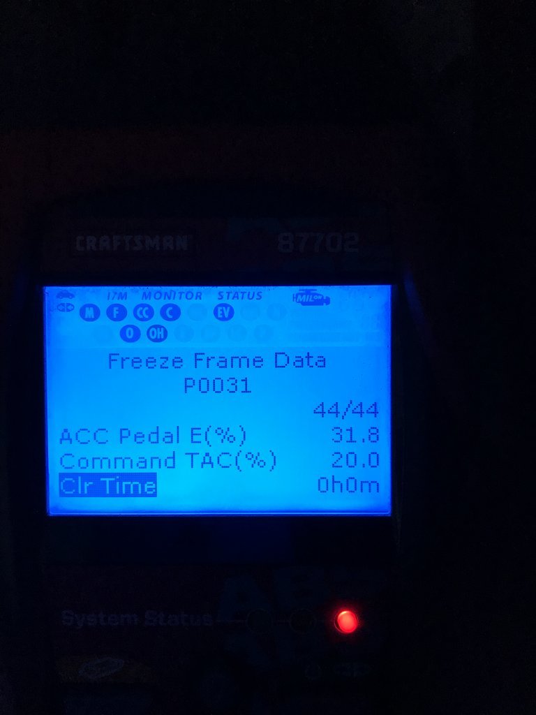

  11. Oct 9, 2017 at 5:31 PM
    hensonjd
    hensonjd [OP] Member
    Oct 3, 2017
    #231919
    12
  12. Oct 9, 2017 at 9:41 PM
    Sandman614
    Oct 26, 2010
    #45273
    36,009
    Tim
    Garner, NC/Boone, NC
    '06 SR5 Off Road
    You actual need to look at live data, short term fuel trim and long term fuel trim. Anything outside of 10%(POS or NEG) will set a code.
