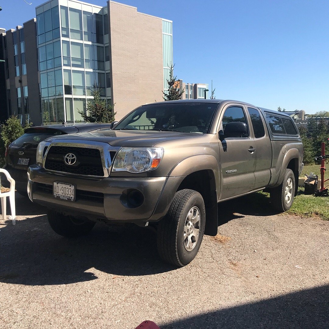

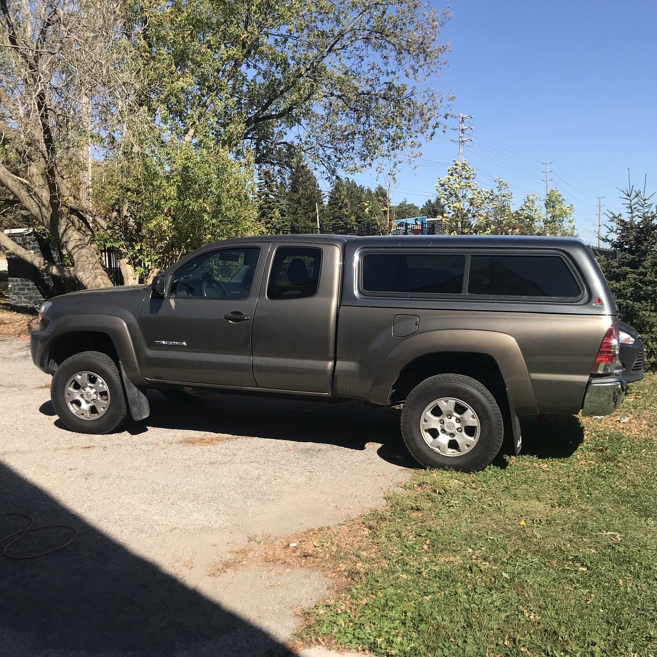

  9. Dec 26, 2017 at 1:38 PM
    Prometheus1
    Prometheus1 Jamie
    Apr 23, 2017
    #217071
    4
    Here's mine:
    2011 Tacoma 4x4 access cab
    bilstein 5100's in the front set at 1.75" w/ factory springs
    stock tires and rims:
    245/75r16 BFG Long Trail A/T
    OEM rims
    The Bilsteins improved the ride quality for me especially in the corners, but I think the stock tires look a bit small now imo. Ordering 265/70r16 rubber this week.

  10. Jan 2, 2018 at 8:34 PM
    Dr. Hook
    Dr. Hook Well-Known Member
    Aug 13, 2012
    #84713
    142
    Jeff
    Winnipeg, Canada
    14' Tacoma sport
    TRD pro suspension, TRD baja rims w/duratracs, rock armor side steps & tonneau cover
    What r u using for the rear AAL or spacers?
