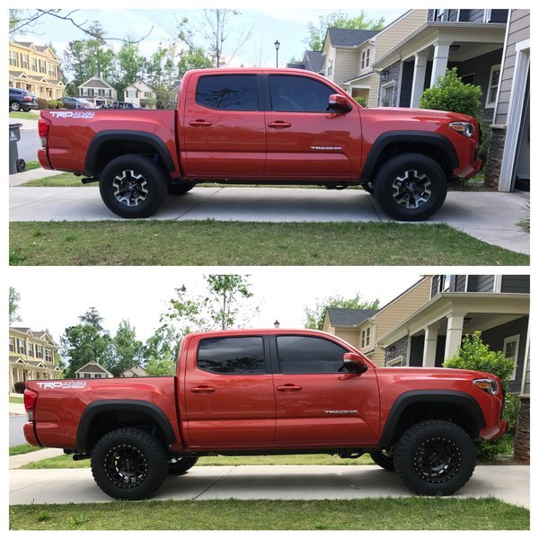

    Apr 5, 2017
    #215474
    58
    Blake
    2017 TRD OFF ROAD 4x4
    2.25 front 1 rear
    Tig3r_Bit, Fedup13, Laugh4044 and 7 others like this.

    That was on my 2010 off road. 3" ToyTec spacer. Got me too 85,000 miles then went coilovers. Now with the 2017 I have the ready lift 2.25 strut extendor
  17. May 12, 2017 at 12:51 PM
    #17
    Fishysmalls
    Fishysmalls [OP] Member
    May 12, 2017
    #218841
    6
    2017 Tacoma TRD OR
    Looks great. What size tires/wheels are you running now?
    Thanks!
  18. May 12, 2017 at 12:52 PM
    #18
    SunriseTaco
    SunriseTaco Well-Known Member
    Apr 5, 2017
    #215474
    58
    Blake
    265/70/17. Wishing I would've went 275 now after seeing it. I have plenty of room left.

    What specifics did you use for your 2.25: front and 1" rear lift? And what wheels and tires?
    that looks great!
