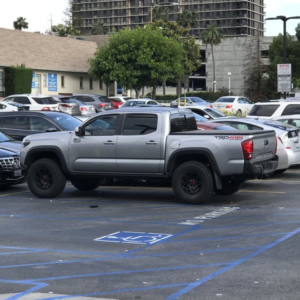

    AramsTRD
    AramsTRD Well-Known Member
    Mar 25, 2017
    #214326
    548
    Aram
    North Hollywood
    2017 Tacoma Silver Sky Off Road 4X4
    6k LED headlights Baja Design Squadron Sport R fog lights CaliRaised Ditch Brackets w/ Baja Designs Squadron Amber Baja Designs Squadron Pro flush mount on Rear Bumper Kings 2.5 with Resi’s Front and Rear Icon Tubular UCA’s with Delta’s OME Dakars Leaf Springs Timbren U-Bolts Flips kit with Timbren Bumpstops Demello Offraod Front Bumper Smittybilt Winch9500lbs W/ Synthetic Rope TRD PRO Skid Plate for the front Pelfrey Mid, Rear and Gas Tank Skids Pelfrey Rear Bumper with Wilco Tire Carrier Welded on SCS F5’s 16x8 -25mm Wheels BFG KO2's 285 75 16 Prinsu Cabrac AllPro Rock sliders Import Equipment Red & Dark Grey Light Decals
    Does it kind of shake when driving with the spacers?

  17. May 19, 2017 at 9:32 AM
    #37
    AramsTRD
    Mar 25, 2017
    #214326
    548
    Aram
    North Hollywood
    Cuz mine shakes now when going around 25 miles. I have Eibach 2.5" up front and 1" in the rear with 1.25" wheel spacers with 285 75 16 KO2's. Any ideas?

  19. May 19, 2017 at 4:04 PM
    #39
    jsinnard
    jsinnard Well-Known Member
    Feb 4, 2009
    #13279
    6,679
    J
    Virginia
    16 QS DCLB OR 4X4
    Does it shake in 4 Hi? If not then you need to replace needle bearing with the ECGS bushing.

  20. May 19, 2017 at 9:24 PM
    #40
    AramsTRD
    Mar 25, 2017
    #214326
    548
    Aram
    North Hollywood
    Yes it does. I am thinking it's the stock springs. I just ordered ome 887. I'll wait and install it and find out.
