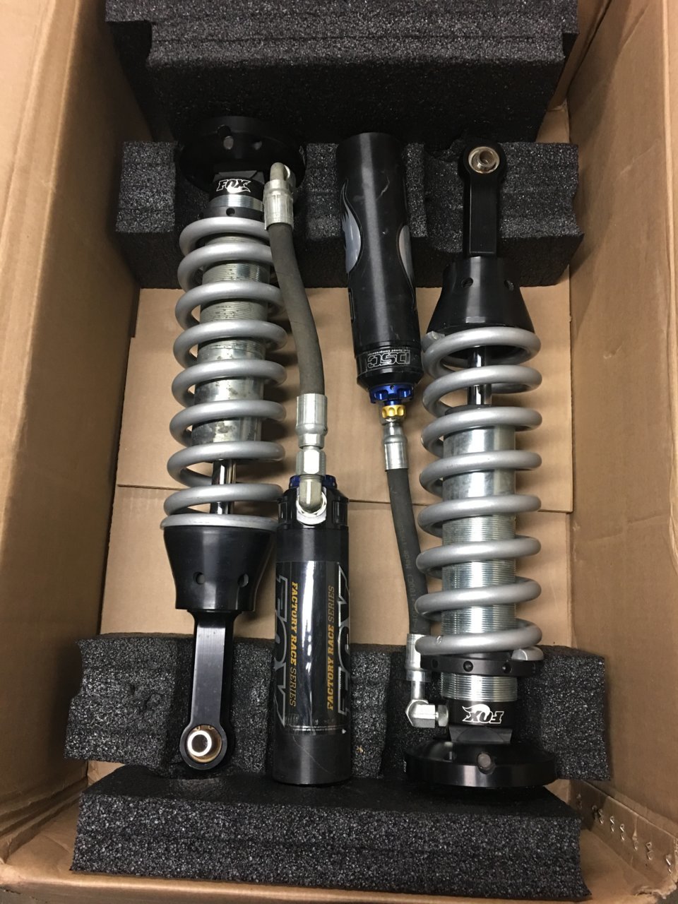

    2.5” Fox coilovers RR with DSC Deaver U402 stage 1 leaf pack ‘16 OR wheels on 255/85r16 Snugtop Rebel
    If 2” is all you need then try these. BA89D1E5-7BF9-492C-A81A-543F757DF359.jpg
