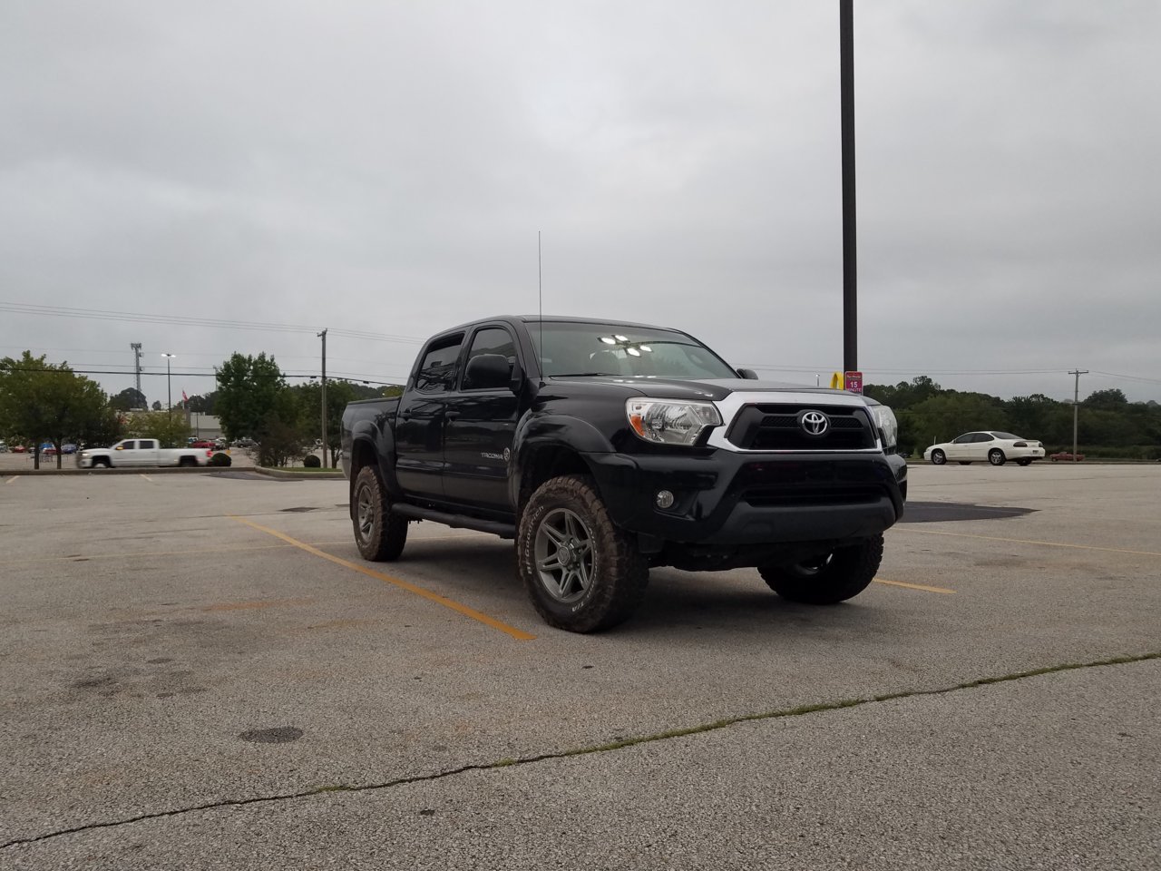

    Worked all night and got mine installed. In the pic I have the measurement before and after for each position. Measured from ground to fender.

    It's hard to tell it's even lifted unless you park next to a stock Tacoma. If there is a vibration, it's negligible. Ride quality seems just a tad stiffer than stock. Over all, couldn't be happier thus far.

    isnt it fun to park next to stock trucks now :)
    I did this to mine awhile back and love it. and now I'm getting parts for the next step, Offroad bumpers, & a winch

    Griffin what size tires are those?

    265/70R17
