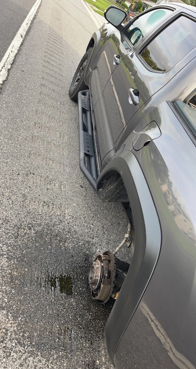

    Had a little adventure yesterday during which my left rear tire and wheel decided it no longer wanted to remain attached to the vehicle. Needless to say, to the shop it went. While I'm having the brake bits/hub/whatever fixed, I thought it might be time for that lift kit I've been wanting.
