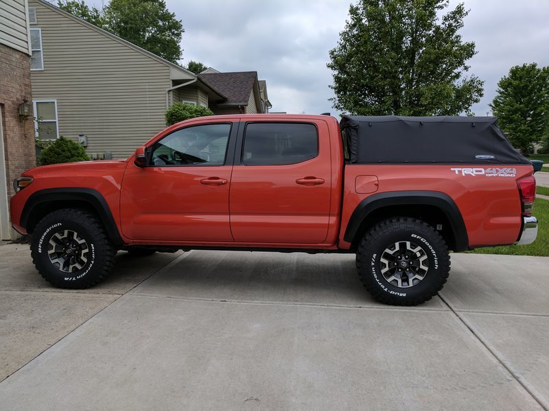

    Any side views? I was looking into getting some skinny 33"s on my OEM TRDOR wheels as well, except I have a suspension lift.

    Oh I SUPPOSE I can go take more pictures of it... The drool puddle in my driveway is getting out of hand thoughIMG_20170512_163257.jpg

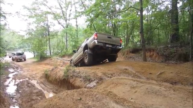

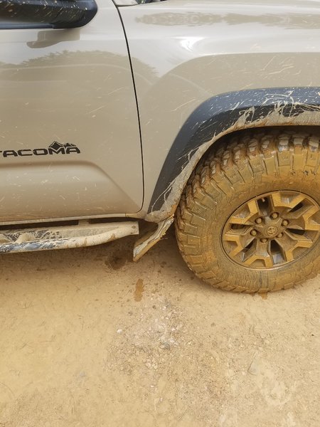

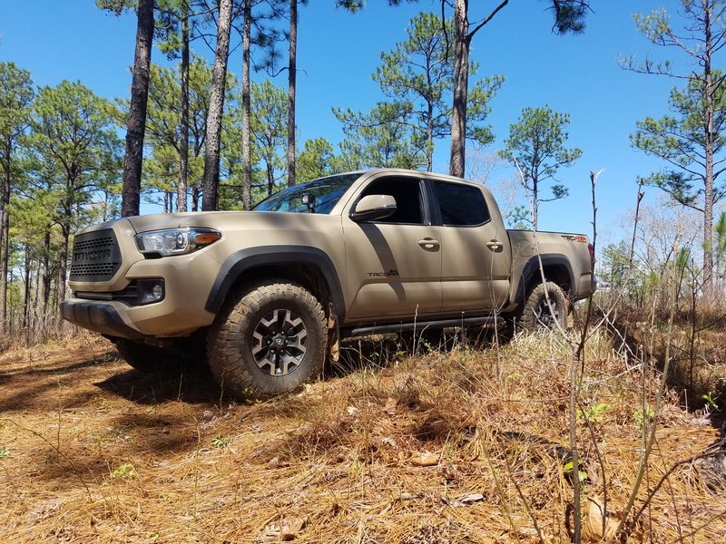

    Best I have.

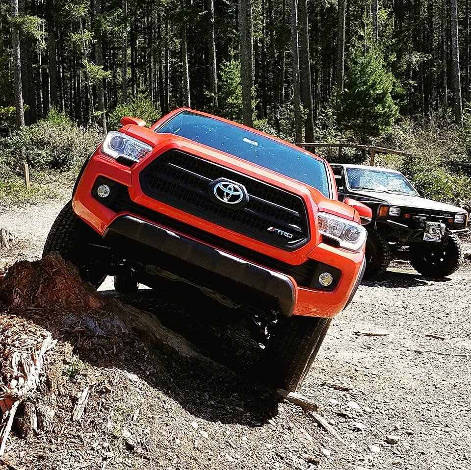

    Ugh, AND you have a black soft topper that I want to buy as well. We could be twins. 18033227_10208886621658632_7191396919502_b33b7af58cffa10287c95aff77e2d66df33d8645.jpg

    I have had zero issues with uca clearance even at full stuff.
