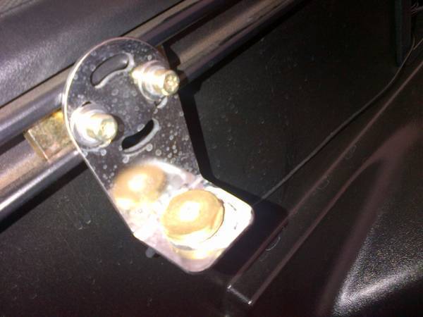

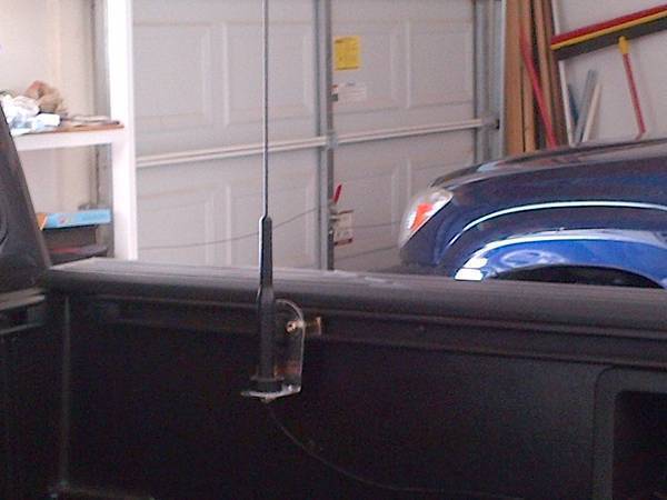

    Ill have two grab a few pictures but put a two meter up in the bed. I went with a self grounded antenna so that i could just put it the bed attached two thebed rails and whala.

    no ground on the rail at all. I went with an antenna that did not require grounding to the car.
    http://www.diamondantenna.net/Product_Catalog/mobile.html
    There are two you can do that dont require ground plane.
    SG7500NMO
    NR770HA
    They come in black too. I found someone on this forum who helped me find some metal tabs that fit into the ridges behind the bed rail. These plates have a bolt hole. I then used a diamond RV mount, angeled at 90 degrees to thread the bolts thought. It left a large hole so I used an NMO male end, seperated it and used the washer to tighten down on the CB style hole. This is the mount for the antennal.
    Actually I just looked at it and realized I went with commet antenna
    http://www.cometantenna.com/products.php?CatID=1&famID=4&childID=4
    SBB5. I liked the style more and did not have the center ballan or coil pack in the middle of antenna. It looked more cell like. ill upload a few pics.

    Here are some pics with cell phone camera...
    enjoy

    I think I'm going to mount it like you have. But I have one question I noticed your mount is away from the cab do you get to much reflection up by the cab? I was thinking of putting mine on the front of the box.

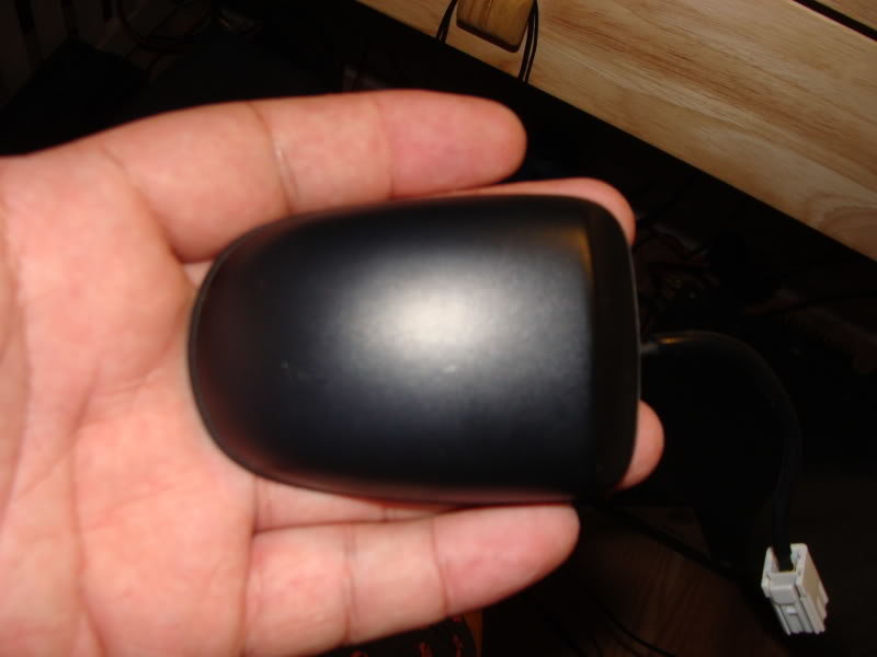

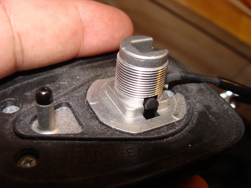

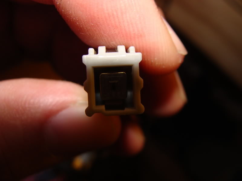

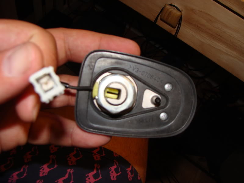

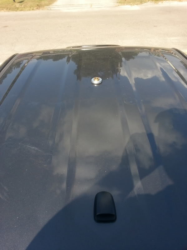

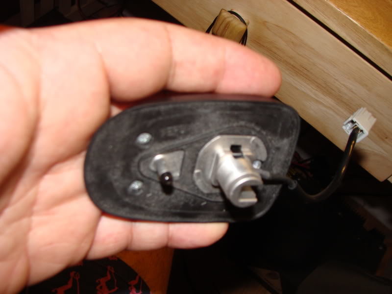

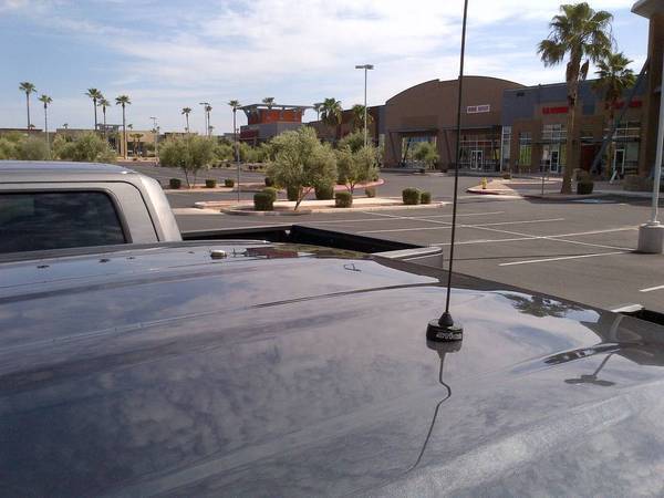

  19. Aug 4, 2013 at 9:07 AM
    #19
    2009tacomav6
    2009tacomav6 Well-Known Member
    Dec 6, 2008
    #11323
    383
    phx AZ
    2012 4x4
    TRD SC TRD Cat Back KMC 17x9 Addicts
    I just put in two NMO mounts on the roof. Did a quick SWR check and it was looking real nice. less than 1.4 to 1.
  20. Feb 19, 2014 at 1:04 PM
    #20
    BenMara
    BenMara That Asian RedNeck
    Apr 14, 2011
    #54903
    1,944
    Ben
    Belton, SC
    2011 DC 4x4 SCed
    TRD Blower, Ham Radio, DBA T2 Rotors
    ended up replacing the stock sat antenna, so drilled roof for a breedlove NMO mount
