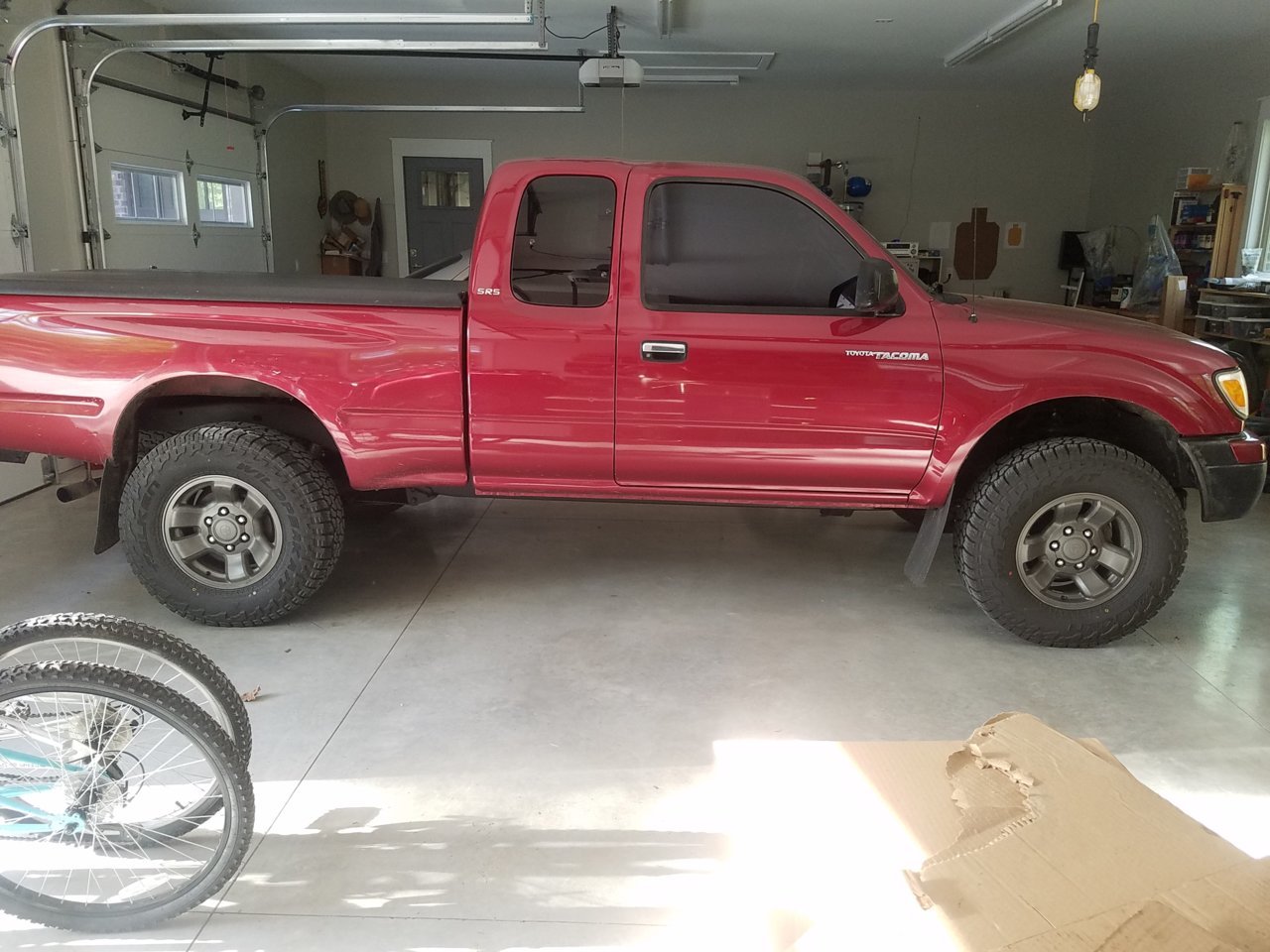

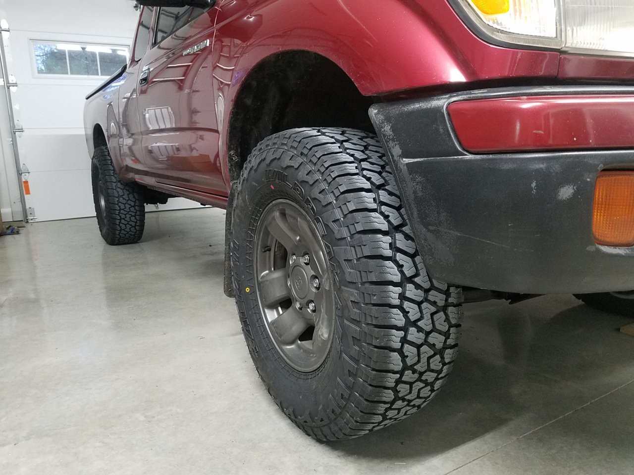

    I swapped over to Falken AT3W from the same size Toyo AT2 yesterday. Very impressed with the Falkens and was drawn to them due to wet weather traction. The Toyos were a bit scary on wet roads even with a good bit of tread left.

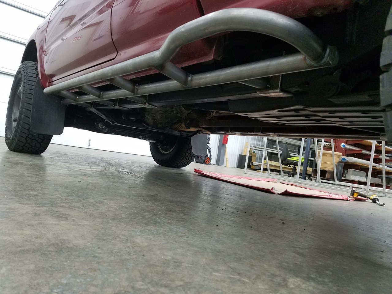

    My wife expressed an interest in hitting some trails with me when I mentioned it so I plan to add 4xi sliders and an offroad bumper of some sort. I'm also considering another rear bumper.

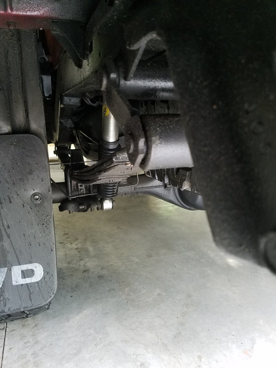

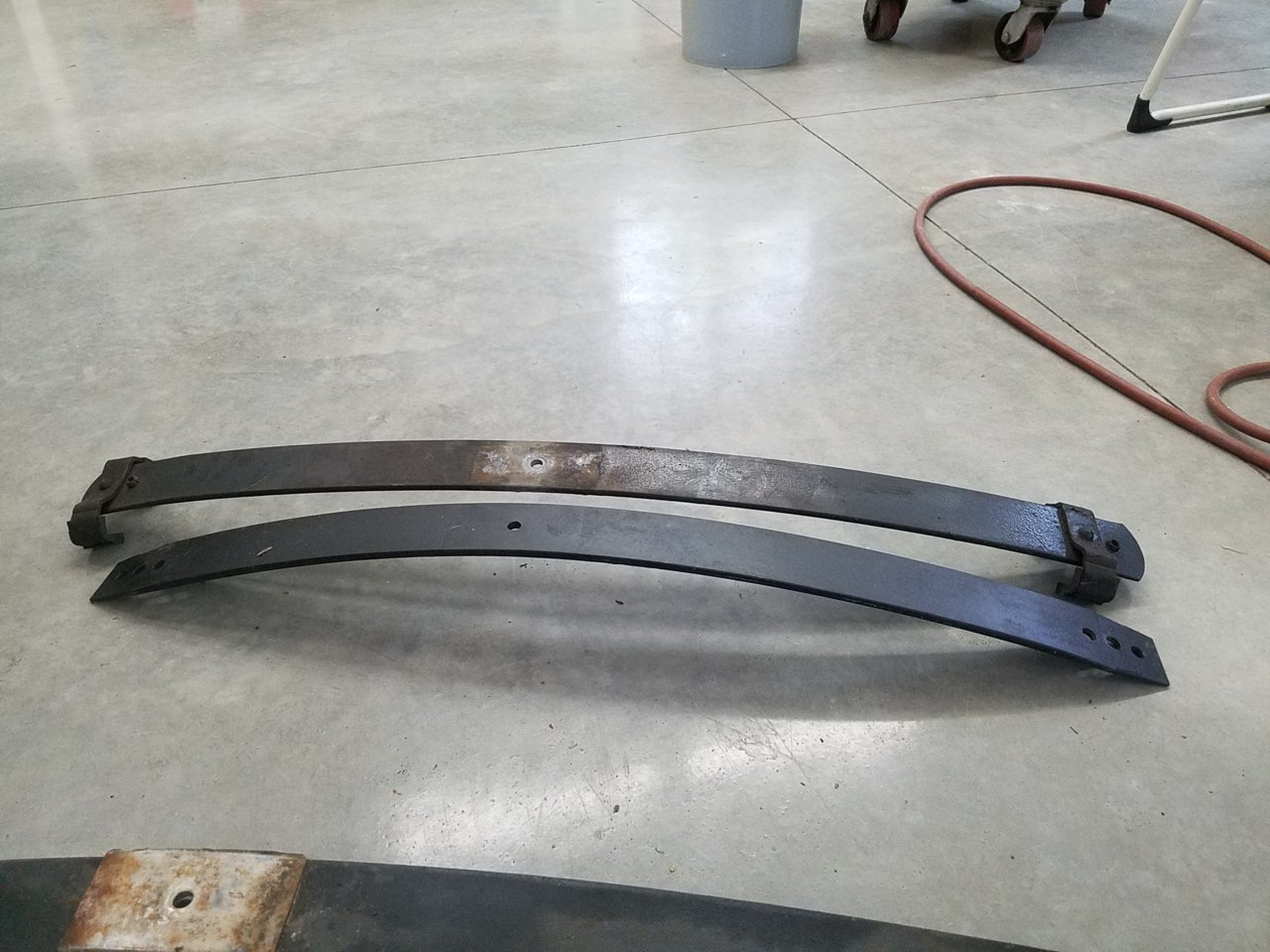

    Two years ago I swapped the 2nd leaf spring with a Dakota leaf to help with the sagging leafs. Today I swapped the 3rd leaf which raised the rear up an inch. Front is now 22.25" from fender to center if wheel and rear is 23".
    Here's a comparison of the 3rd OEM leaf and the3rd Dakota spring. I also included a pic if work in progress and new stance.

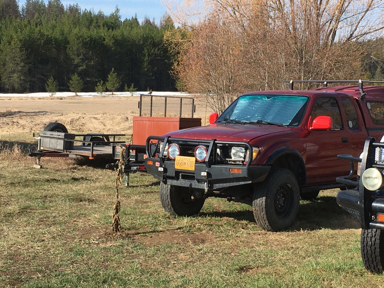

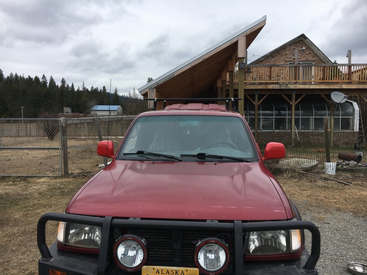

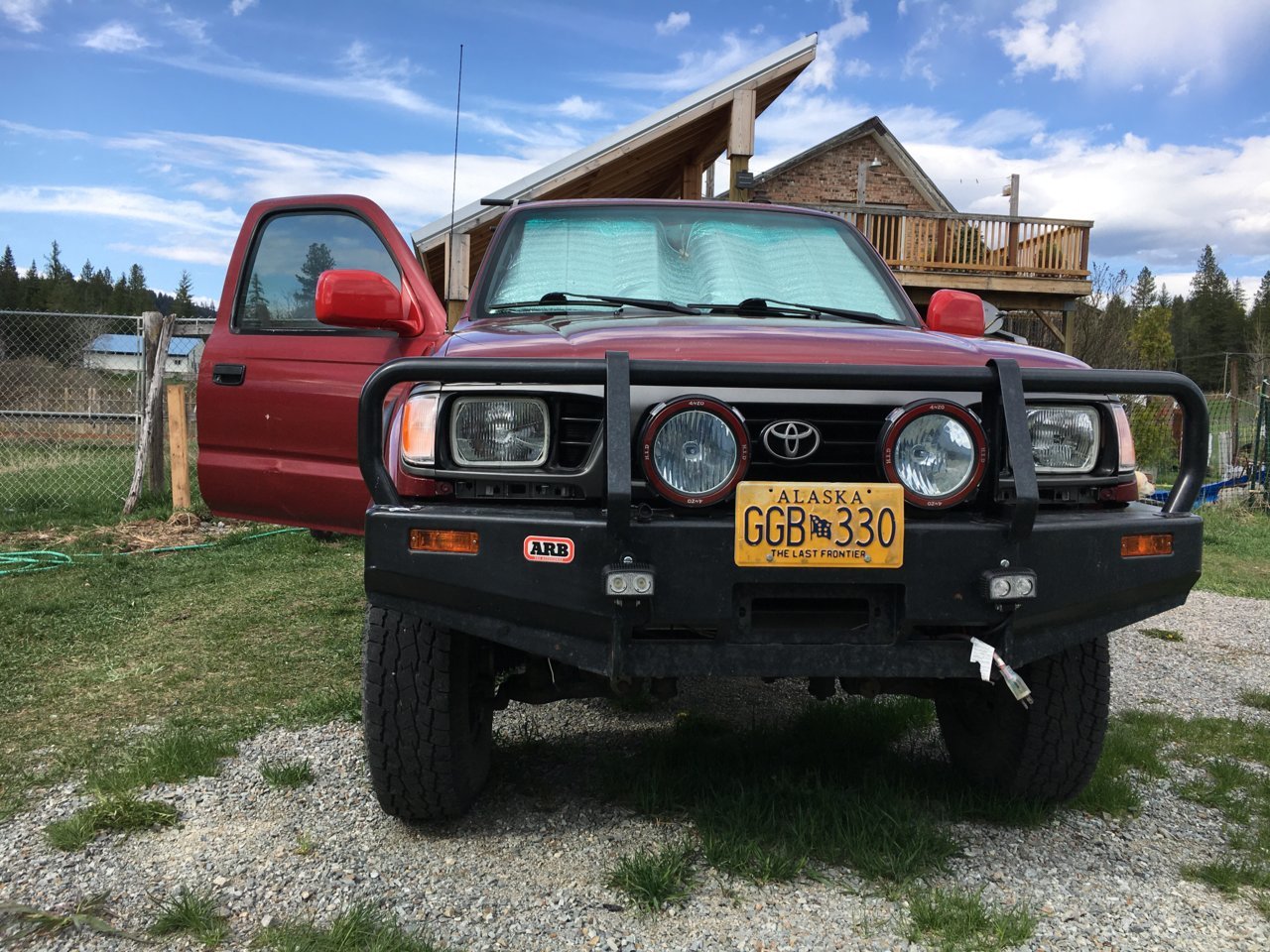

    Nice looking truck, is that the radiant red? It looks similar to mine- I have a terrible eye for colors- the OEM color is ‘Sunfire Pearl Red’ . The mirrors are off of a 2000 4Runner, eventually to be painted gloss black. This phase- currently in the middle of the 97 grill and headlight mod- still have to do some trimming of the stock buckets for getting the headlights aligned properly.

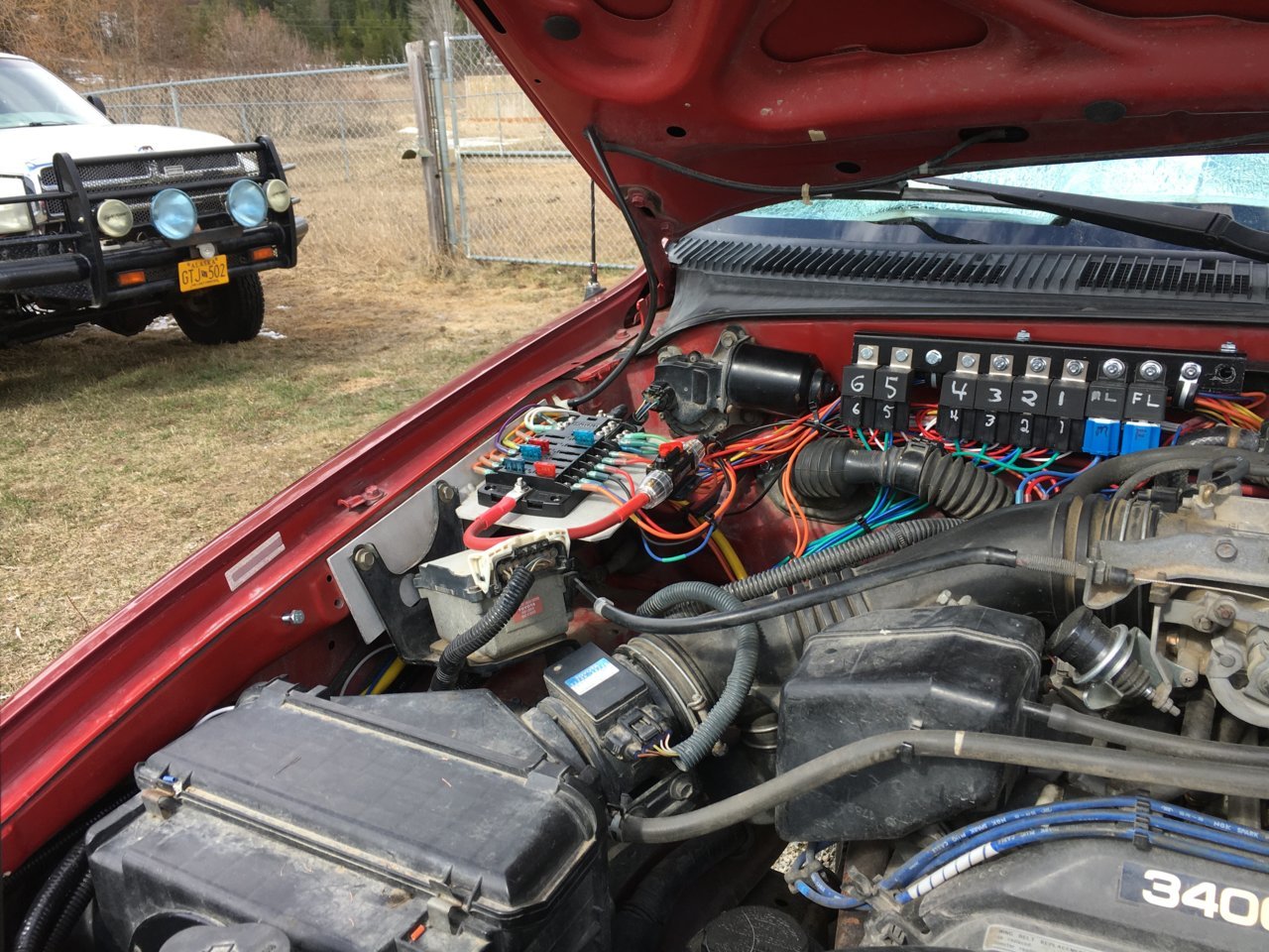

    Then some more aux fuse panel wiring re wiring the moose lights and fogs from the relay location between the battery and fender adjacent to the relays from the ‘Headlight Services’ harness I installed a few weeks ago.
    Trying to do the mods that are paid for, the rest will have to wait till next year.C4A17960-EA43-4EC4-808F-55B7C6122863.jpg

    Thanks. 3K4 is the paint code. I think its sunfire red pearl. Our trucks certainly are very similar. I upgraded mirrors too. I'd like to trade you bumpers. ;)

    Solid copy there, I really like the iconic look of the ARB. I was able to get it in a package deal from 4Wheel Parts, came with a set of IPF lights discounted enough that with shipping it was list price, so boom jumped on that one.
    I am very curious to hear how the Dakota spring mod is working. I am finding that I do have some lift aft, but it has settled down some to where I am about level. Of course I haul a lot of stuff around-it is a truck after all.
    I plan on painting the mirrors semi gloss black, once I get the wiring sorted out (connectors and harnesses either bought or built) and wire in a time delay relay for the heaters.
    Still have to clean up the switch panel wiring and get the stereo hooked back up, run another 12 awg ext cord back to the bed for a future fridge, compressor and light fuse panel for the shell.D49E03E4-BCC1-431F-920D-78D5045C107A.jpg

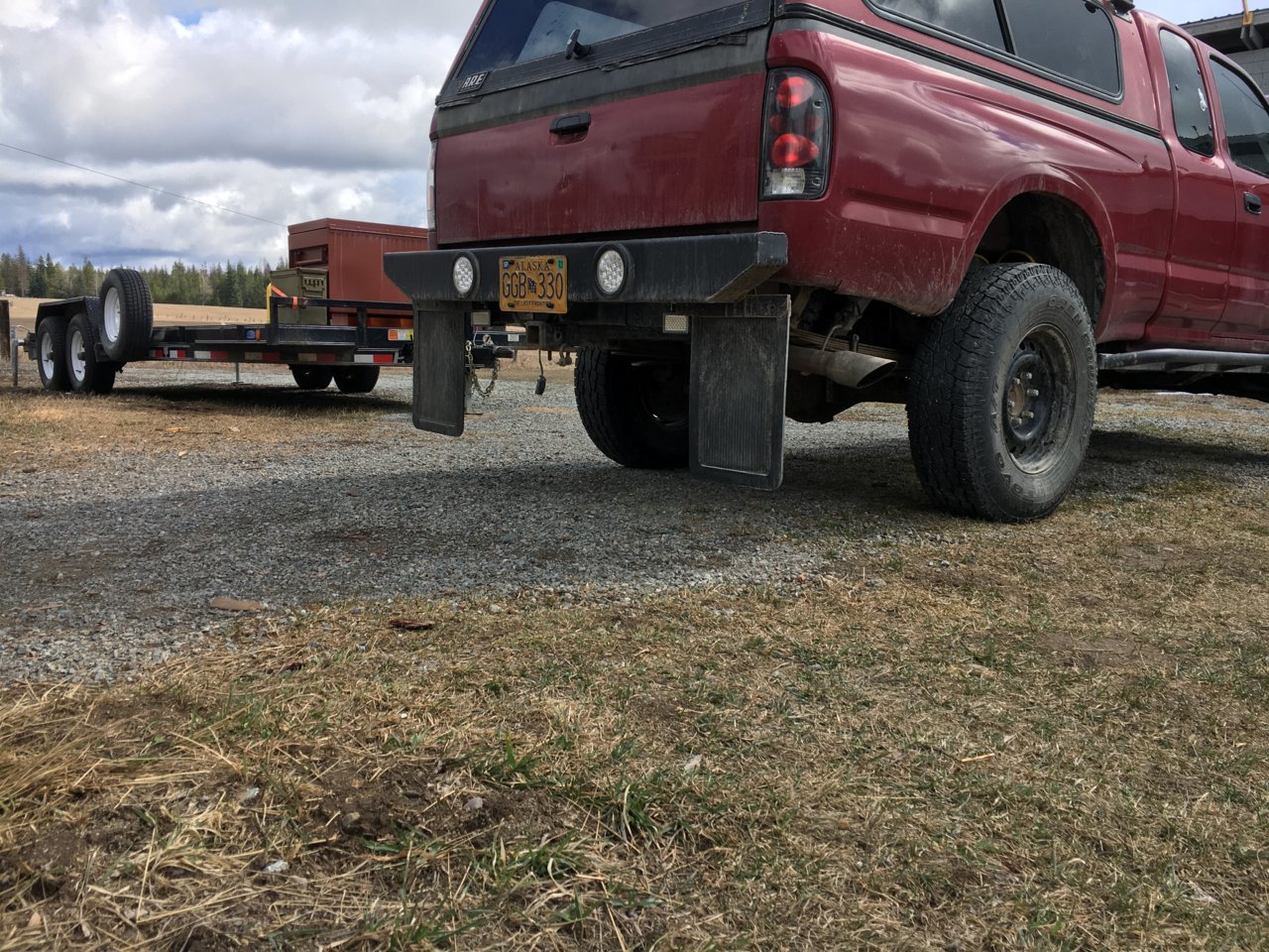

    I was able to get the rear work lights installed and wired:16B251BD-8CC9-4C82-BFB0-5DAF591E01C3.jpg

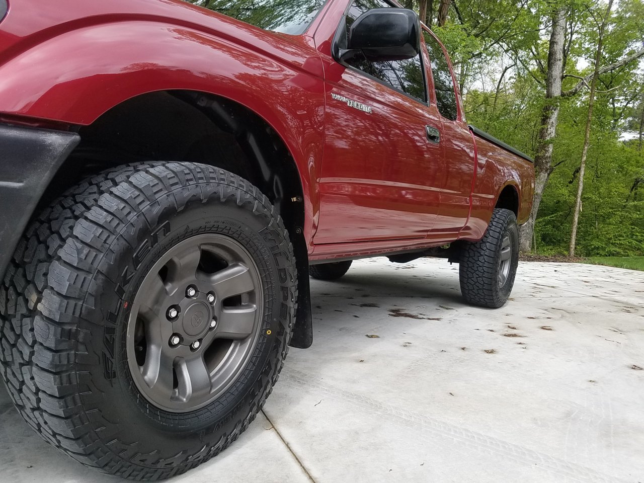

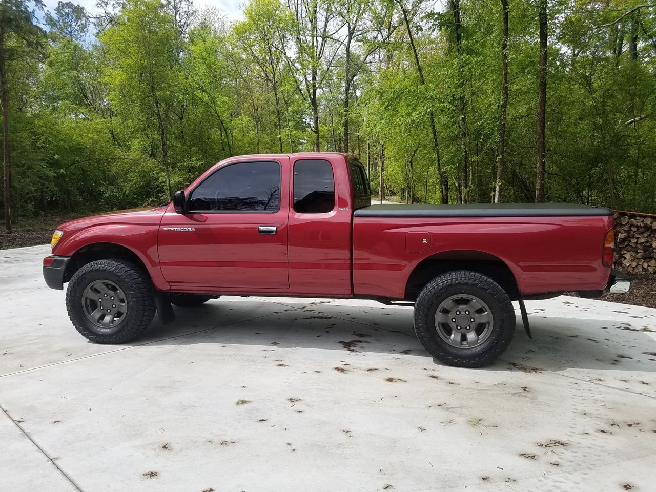

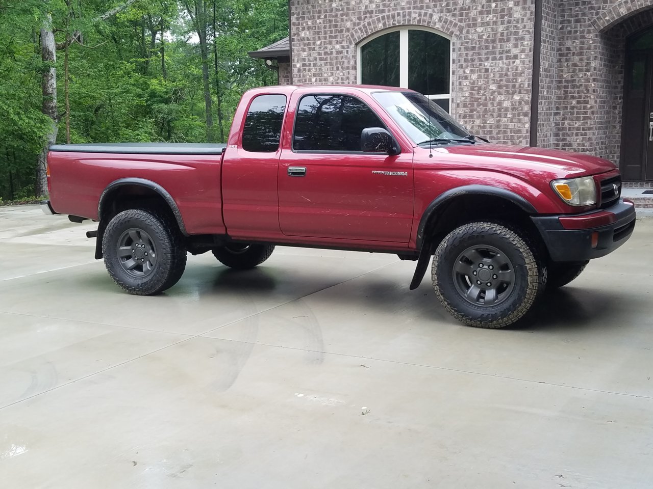

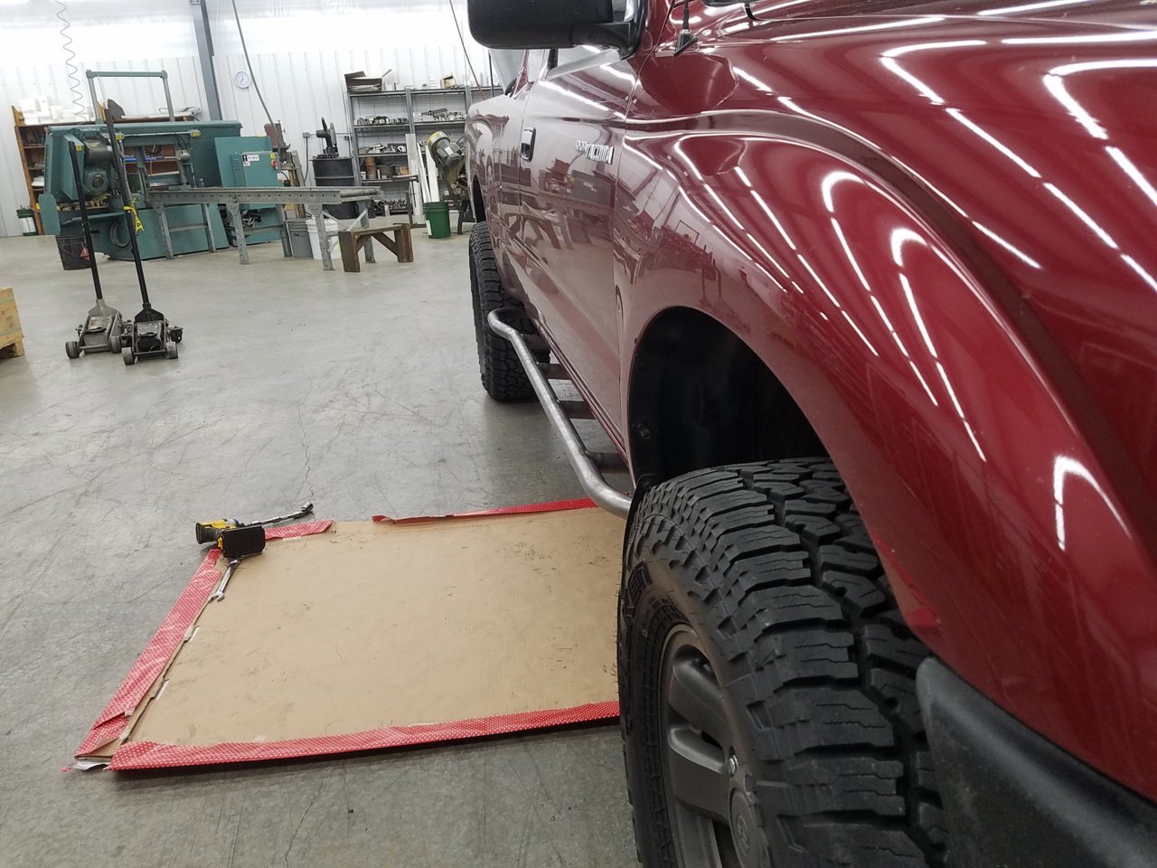

    Got the truck cleaned up so here's a few shots of the Falken 265/70r16 AT3W.

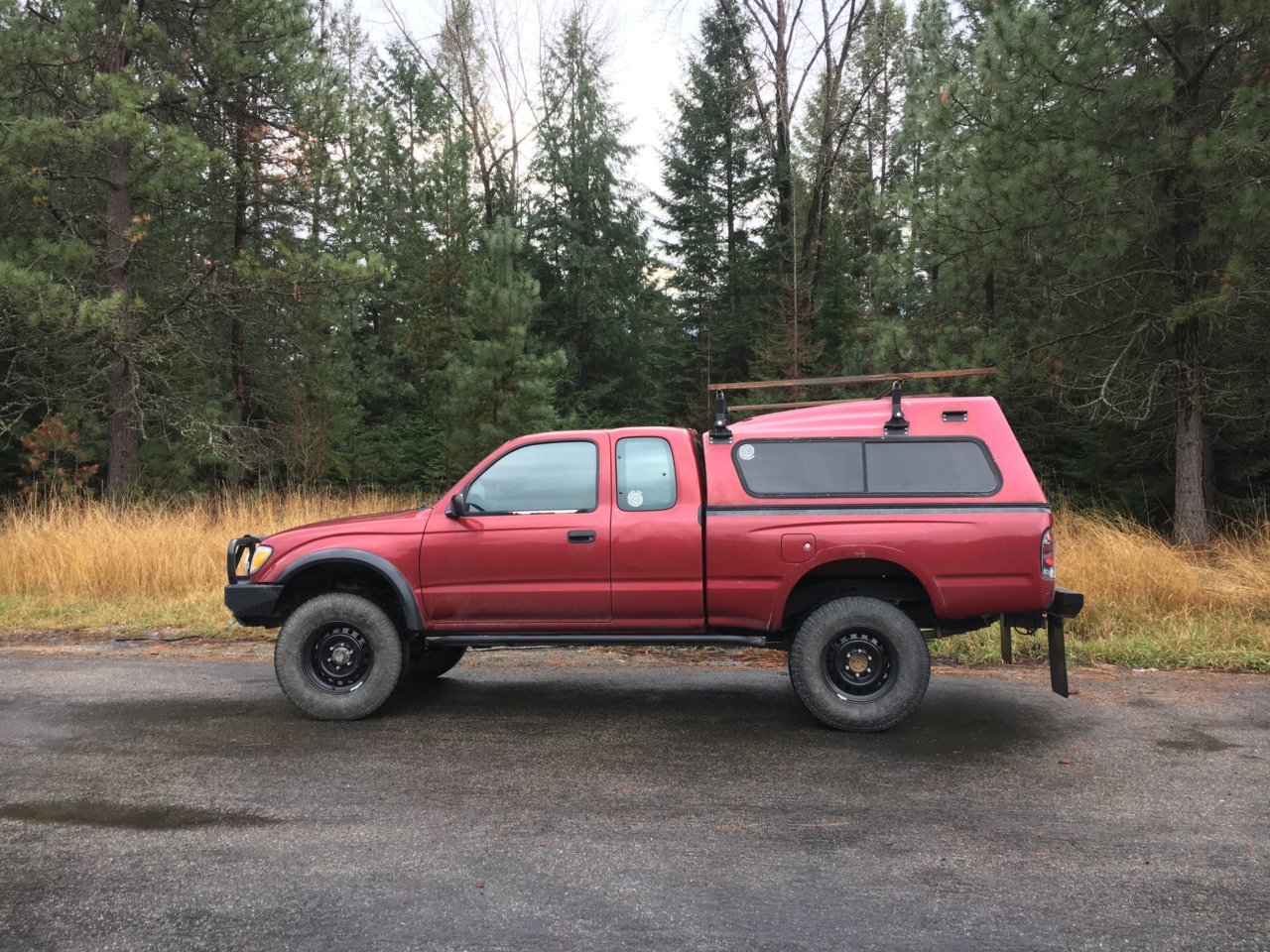

    Wow, the truck is looking great, mine is more Monet like, looks better from a bit farther away, but it was an abused child before I got it, and functional fixes move to the head of the line.
    The Hella sealed beam H4 lights are great just need to do some more trimming to the plastic buckets level them out, they are E codes, and I really like the cut off, and with the headlight hoops and scatter from the aftermarket lights, there was some weirdness in the pattern.

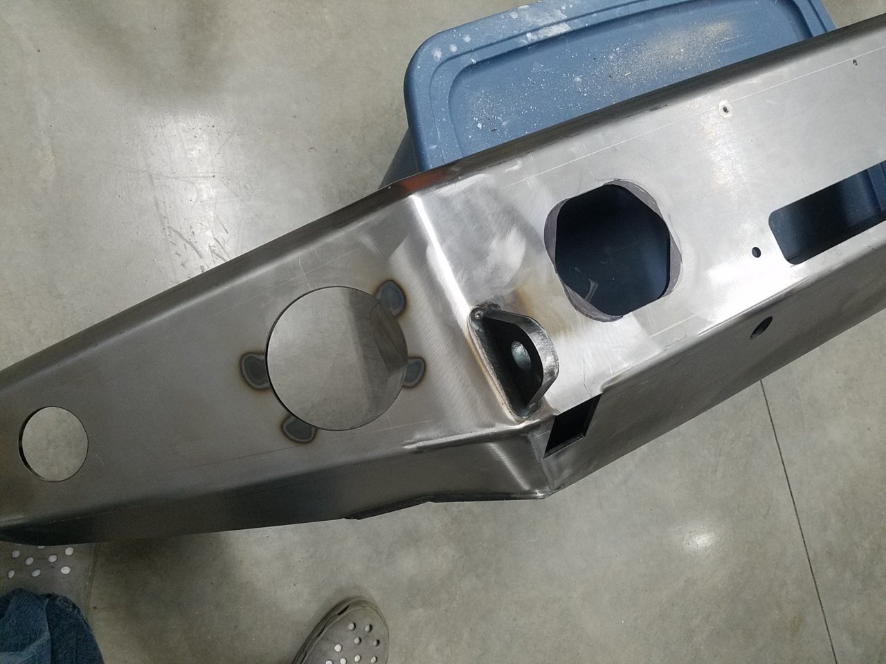

    4xinnovations bumper made it today. Weighs in at 95 lbs and is super nice. I'm thinking about modifying the hex cut outs into circles or squares with large radius corners like I have drawn in pic below. I've included a few more images of the bumper. I love the Shrockworks hoops and will be putting hoops like them on this bumper.

    I went over the edges with a flap disc and it didn't really need much. At work, I have the rep of being able to find a burr on an egg. I went to the extreme and rounded over almost every edge(even on the backside) including the 4.25" light cutouts.20200506_203213.jpg

    So, I've decided to turn the hex holes into 4.25" round holes(like the Relentless Predator). I plan to set the bumper up on a Bridgeport milling machine this evening to make the transformation. It should be interesting. ;)
    One hole done.

    Success. Loving the round holes.
    Got the center hoop cut to 11.5" high. Shown here upside down on surface plate. I used a height gauge to scribe lines at 11.5" on both ends of tubing. Then to the horizontal bandsaw to cut it on the lines.
    I'll mount bumper to truck next to determine final height. Shrockworks height is 10.5-10.75". I'm thinking a little taller since the 98-00 headlights are pretty tall are are partially obscured by the headlight guard hoops on the Shrockworks hoops. I'll make my final height determination once it's on the truck.

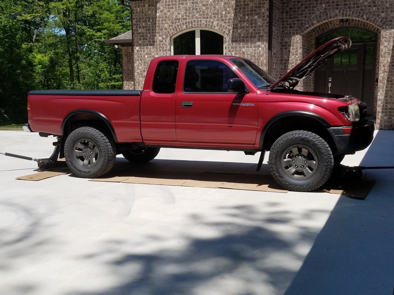

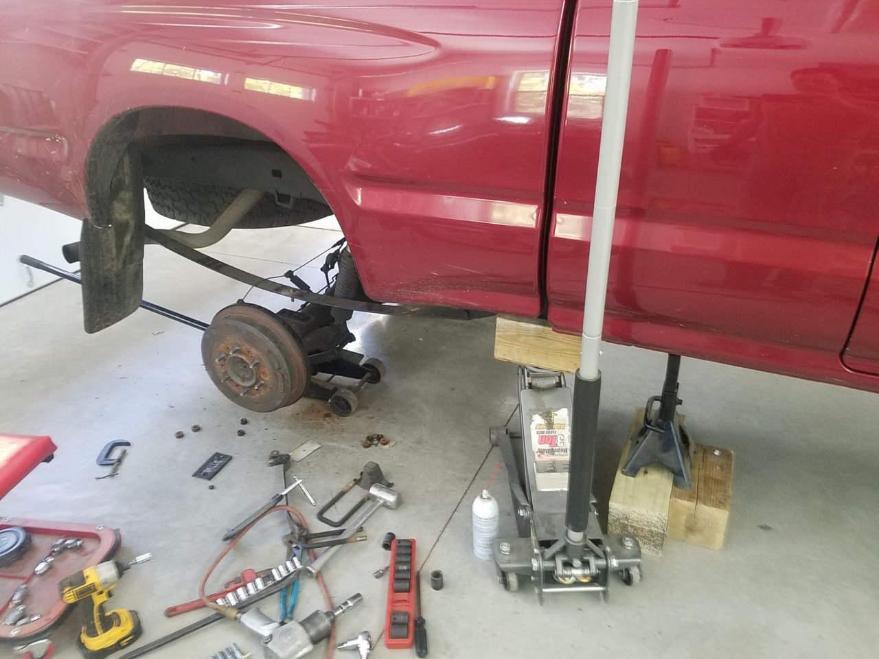

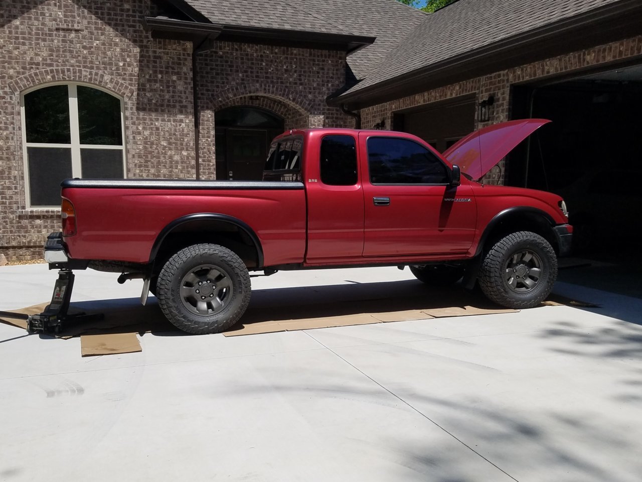

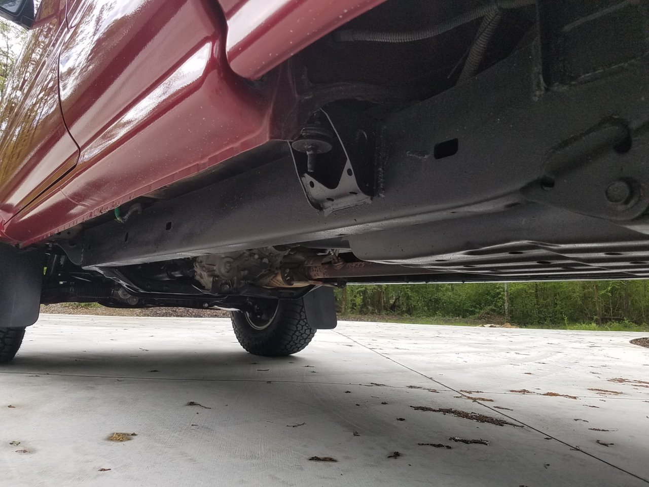

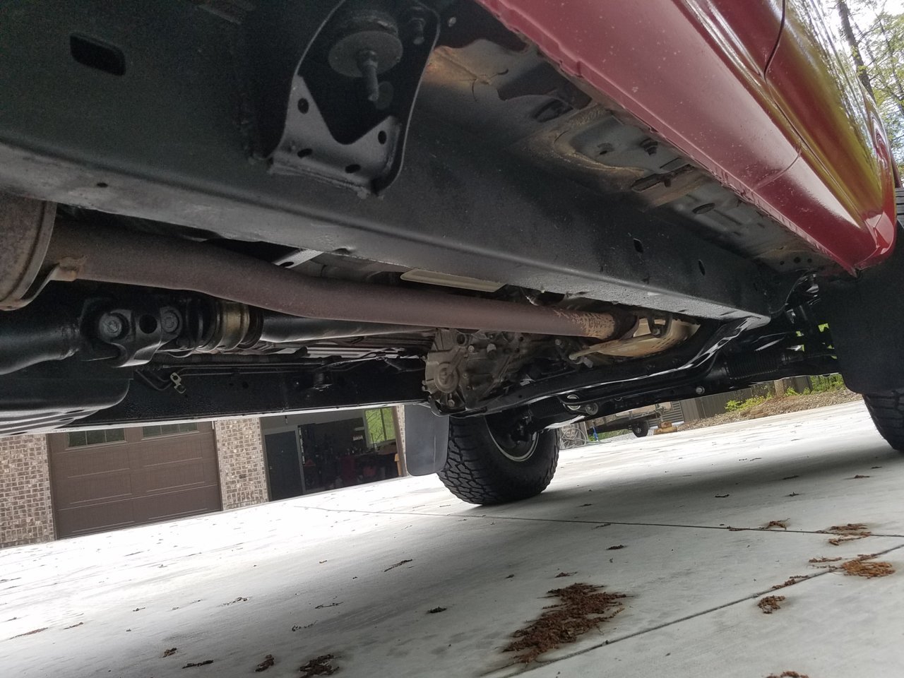

    I added the 2nd OEM rear leaf to the packs: 1st and 2nd are OEM and 3rd and 4th are Dakotas which added 1-1.25". I also moved to the 2nd notch which raised the front .75" I believe current set provides a 2" lift. Rear springs have some nice arch to them now. I do wish I would have dog eared the ends of the 2nd spring, might tackle that another day. It took me about 2.5 hours to add the rear leads and nother 2.5 to move the 5100's from 1st to 2nd notch. From ground to bottom of fender is currently 37.0" front and ~38.0" rear.
    I did the BPV bracket while I was at it.
    BEFORE:
    AFTER:
