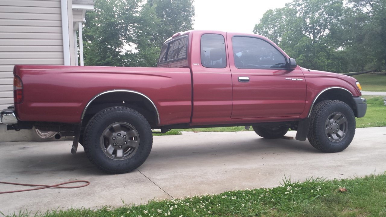

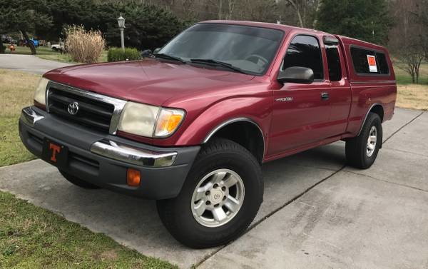

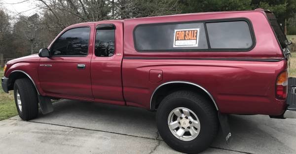

    I bought this truck in April of '17. It was a 1 owner totally stock 2000 SR5 2.7, 5 speed, ex-cab with pw, pl, cc with 289K miles. Clean carfax and shows dealer serviced(owner's wife works at Toyota dealer). Paid $6500 and promptly sold the topper for $450. A lot of cash for high miles but truck history and cleanliness made it worth it to me.
    Here's pics the seller sent me right before I drove to TN to look at it(April '17).

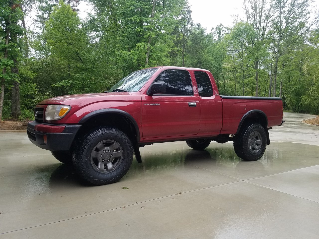

    Jun 2017 Original 15" 3 spokes with 265-75r15 (original suspension)

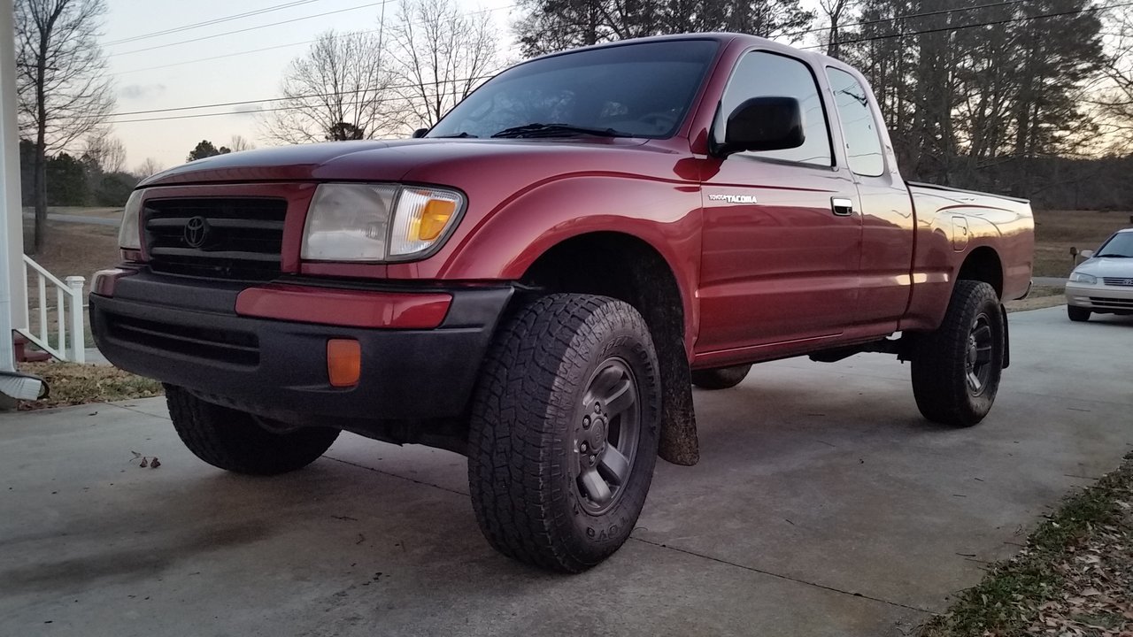

    Jun 2017 16" 3 spoke with 265-70r16 Toyo ATII (original suspension)

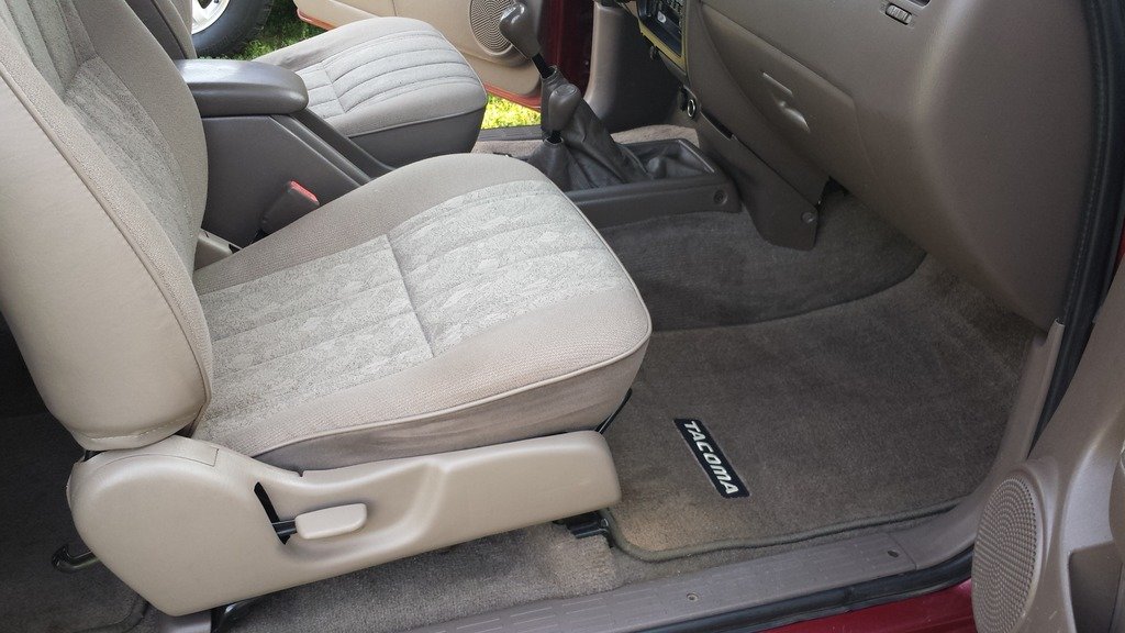

    Woah. This seats are about 1000 times better than mine at similar mileage!

    Yeah, the guy had seat covers on for years and floor mats on top of the stock floor mats.

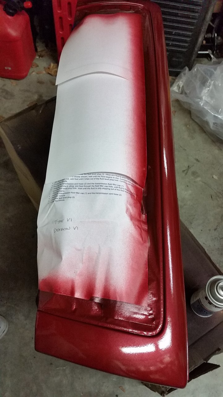

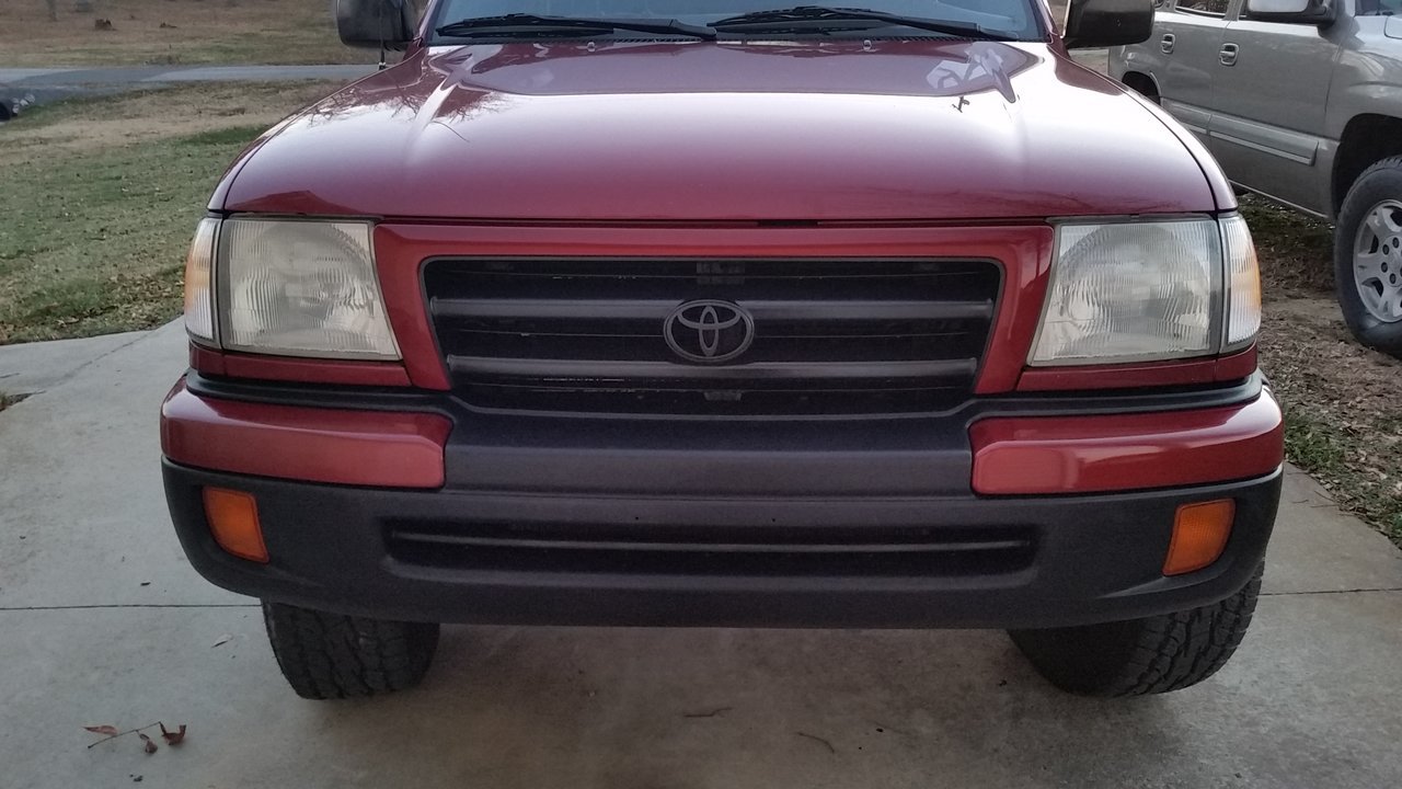

    I haven't kept up with much that I've done. No big mods to mention though. I've been wanting to get rid of the chrome on the front end for a while now. OEM grill was cracked so I took a chance on the Rockauto aftermarket black grill. Looks pretty good and fits good too(I'm picky too). I'm color matching the surround. I've sanded all surfaces to be painted with 600 grit (no pics), then cleaned with prep wipe, then primed with 4 coats of auto primer.
    Here it is ready for paint:
    Here's after 5 coats:

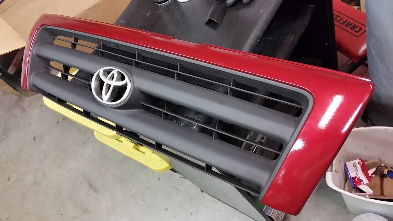

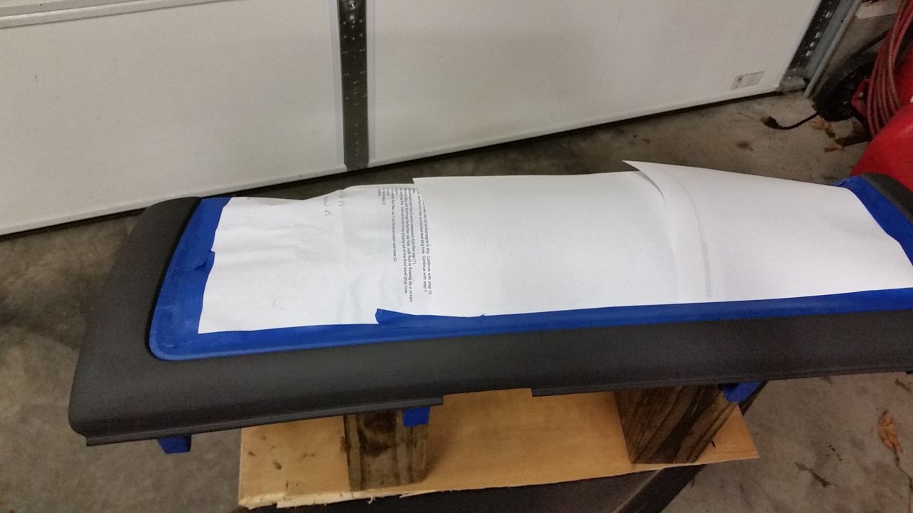

    Color matched surround done. I still have to paint the black. Thought about bedliner or flat paint with clear over it. I also sanded the Toyota emblem with 600 grit to give it a brushed look. I may blacken it instead.20171224_192946.jpg

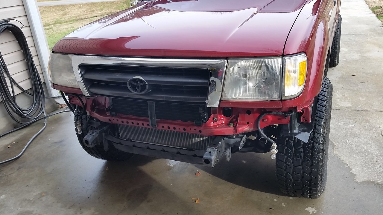

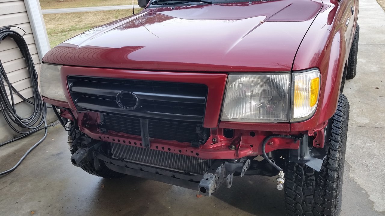

    I removed bumper for the first time(like folks have said, not really that big of a deal). I'm going to paint the chrome pieces SFR and also wanting a long term solution to keeping it looking nice. I also finished up the grill this morning. I still plan to wet sand it two remove a bit of orange peal. But I think it came out real nice. Color is pretty close but does look a little bit lighter.
    Now I have to decide on dye, paint or bed liner for bumper.

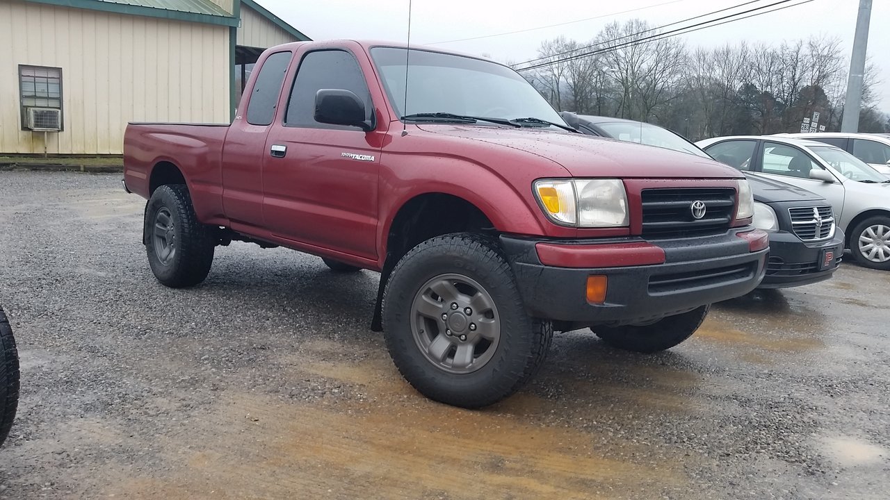

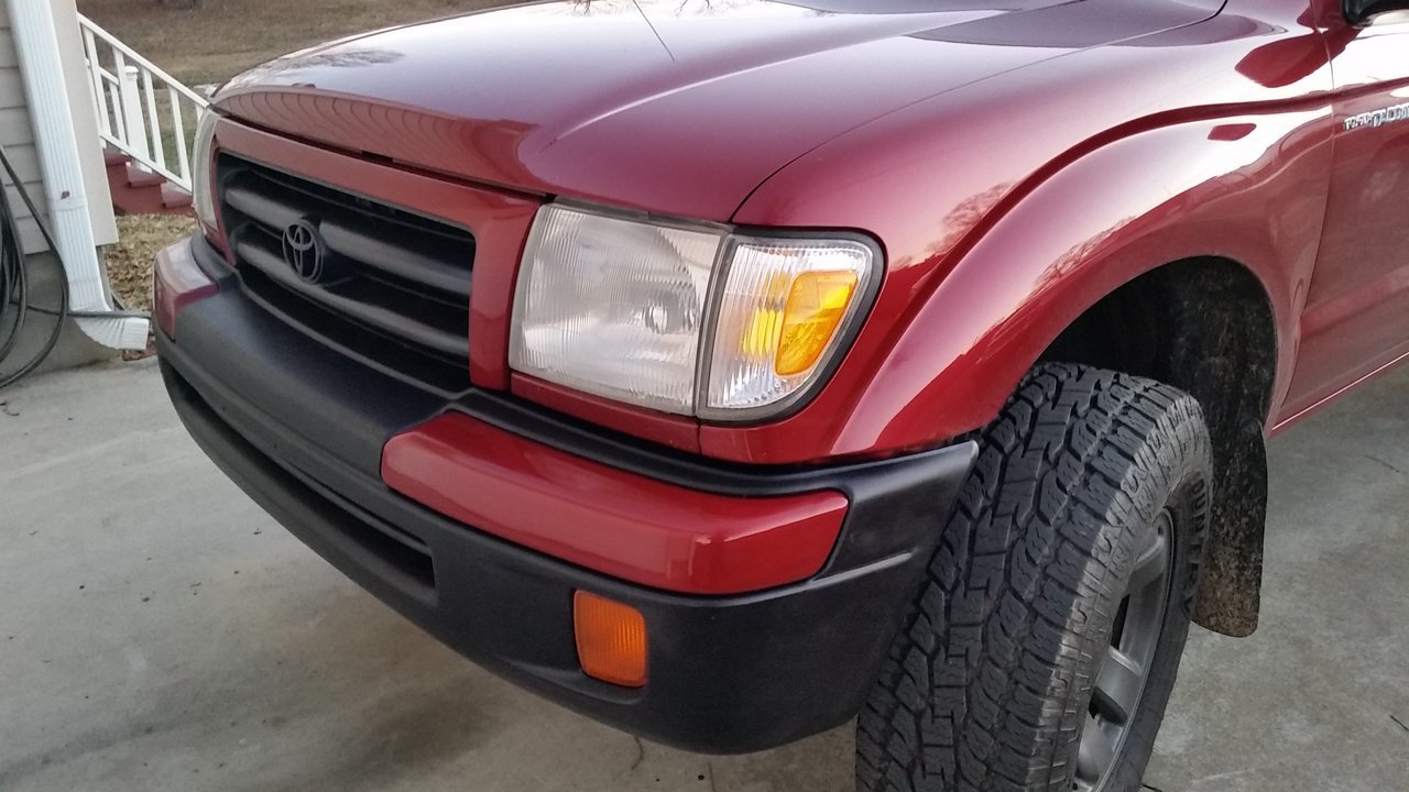

    All back together. I ended up using adhesion promotor and Rustolium bed liner on the bumper and then once it dried, I lightly sanded it with 400 to get rid of the sand paper feel that I thought would be hard to clean. Then wiped it down with silicone spray. Came out exactly how I wanted and should be easy to keep clean. If the grill and metal inserts don't hold up, I may do the same bedliner treatment on them. But for now I like a little color on the front end. Not sure if I like the color on the bumper inserts or black like the rest of the bumper. Toyota emblem is Plasidip.

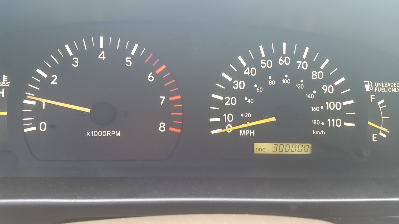

    Turned 300k today. I've had truck 11 months and very happy with it. :)
