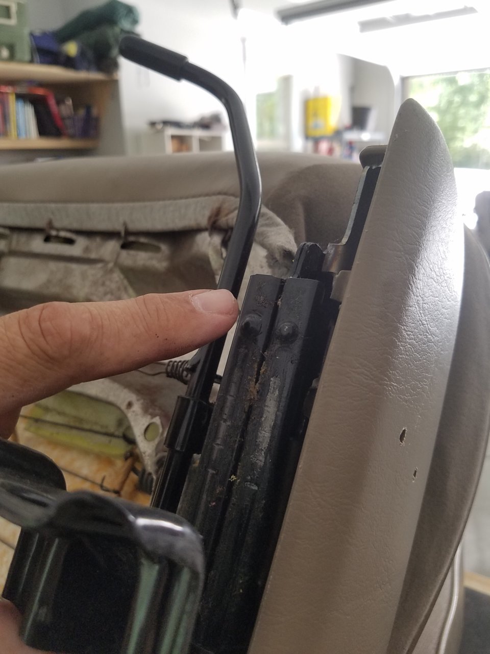

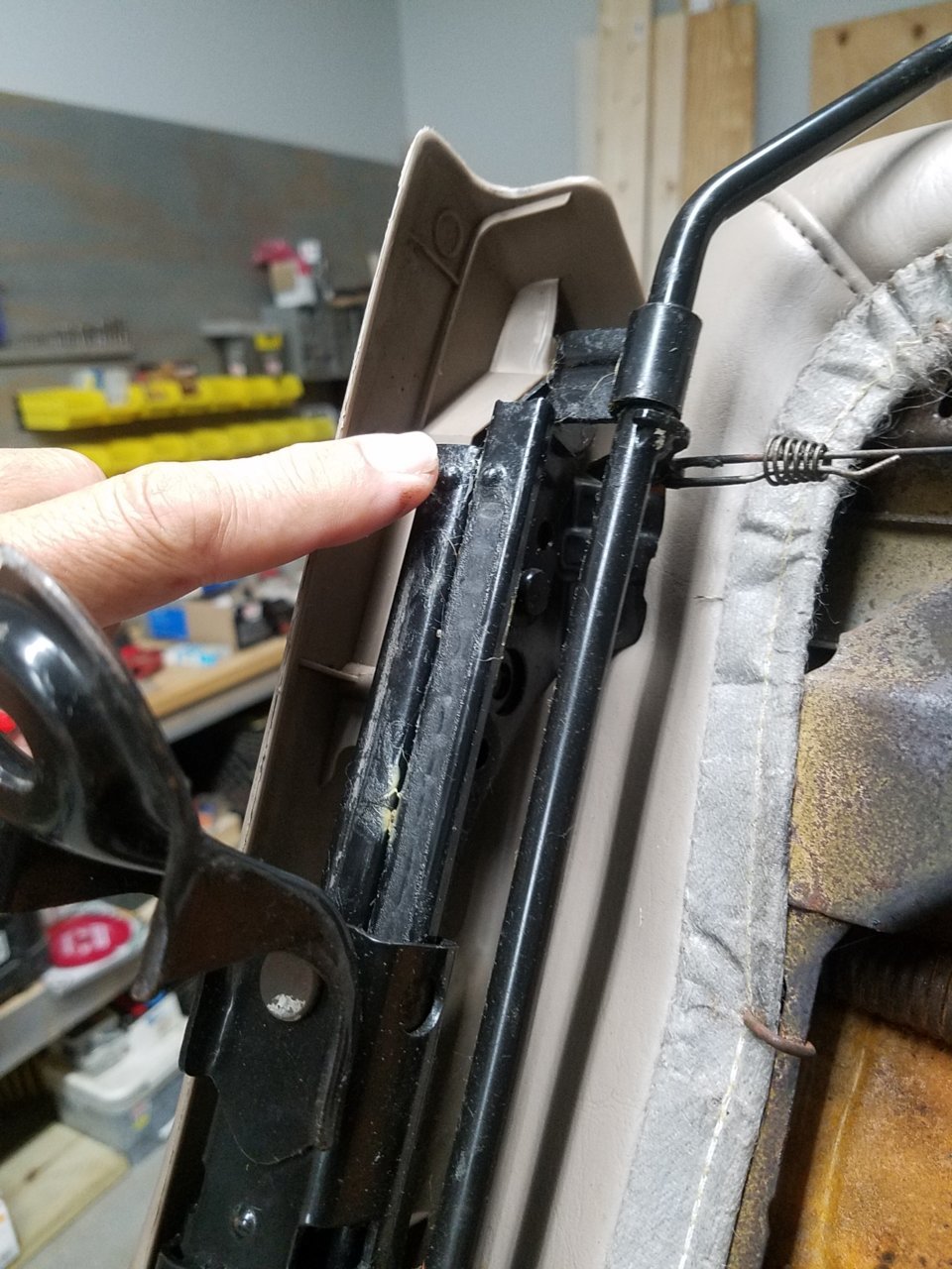

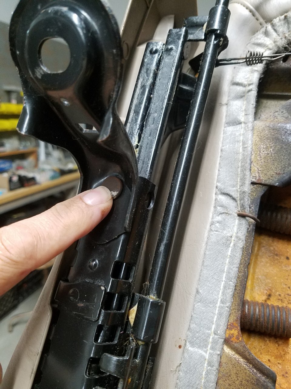

    I have confirmed that the inside seat rail on the 4runner seats bolt right up to the 2000 Tacoma cab. I'm a bit confused on swapping the outer rails though.
    @JBTacoma
    I'm a little confused. I know I need to grind off these bump stops. I have ground them off on the other seat and the rail won't slide all the way off. Something inside the rail is preventing it:
    But it looks like the video shows finding off the other side(inside the rail) of these rivers where the foot attaches:
    If I grind off where the foot attaches, then won't the foot come off? If so, then wouldn't it make sense to just swap the feet?

  9. Jun 10, 2020 at 4:27 AM
    #69
    JBTacoma
    JBTacoma Well-Known Member
    Feb 16, 2015
    #148844
    11,118
    Jeff
    Cullman Alabama
    2000 SR5, 2003 Double Cab and a Suzuki Samurai
    You have to grind off the rivet where the foot attaches to get the bearing cage out then it will slide off.
    I have not looked at swapping the feet but I guess it could be an option
    OG_Tacoma likes this.

    Ok, thanks. I was thinking that but not sure. Then put a bolt back in its place I suppose.

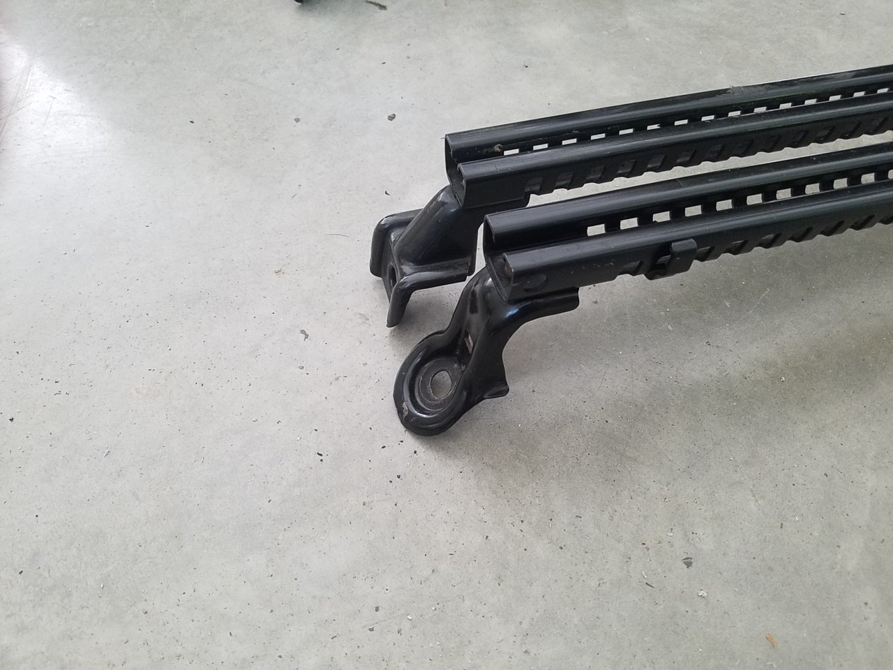

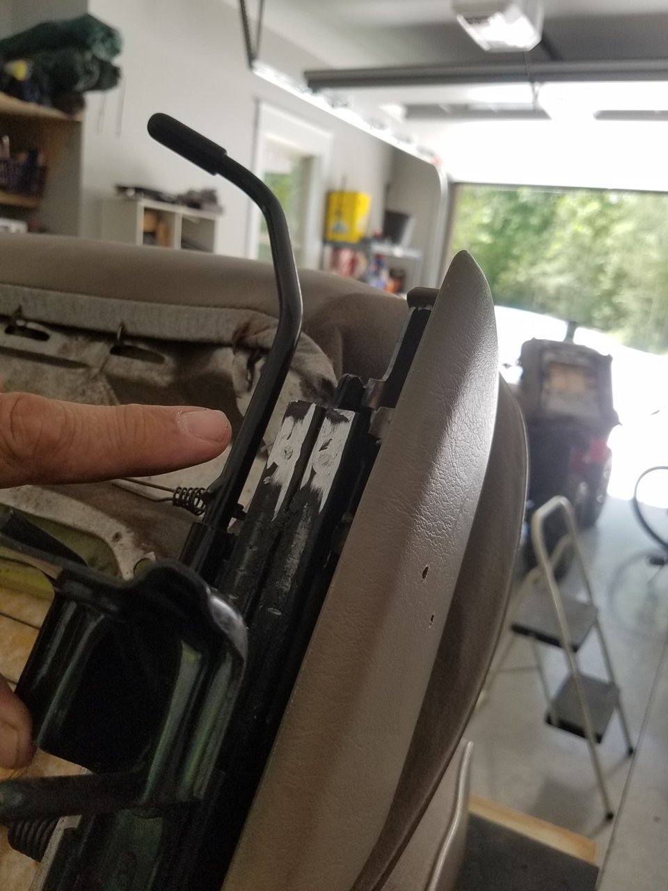

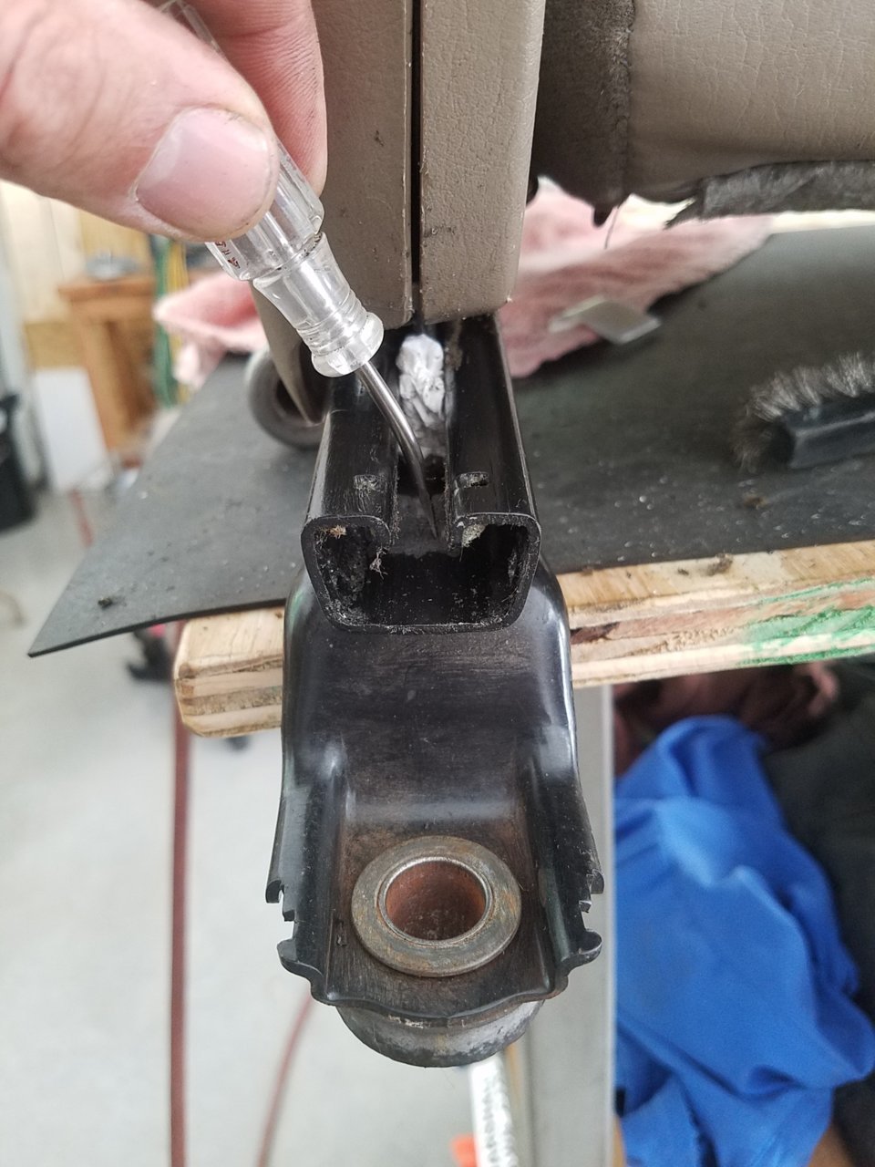

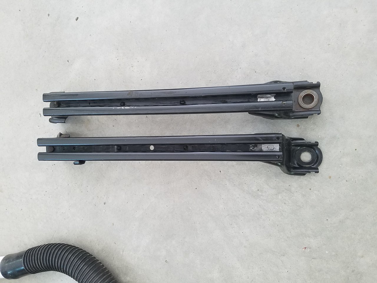

    Original cloth seats weigh 28 lbs each and the 4 runner seats weigh 32 lbs each. I'm happy with the small gain. Here's a few pics that show exactly where I ground to remove the lower seat sliders. Like I said before, the inner rails bolt right up so here is pic ormf where I ground the two bumps off the forward outer bracket.
    I used a 4.5" angle grinder with a cutoff wheel and here is the after pic.
    Here's a pic of where I ground off the head of the river(inside the rail). Screwdrive is pointing. Note the paper towel stuffing in the rail to help prevent metal shavings from spreading.
    Here's the difference between the outside rails. 4runner on bottom.

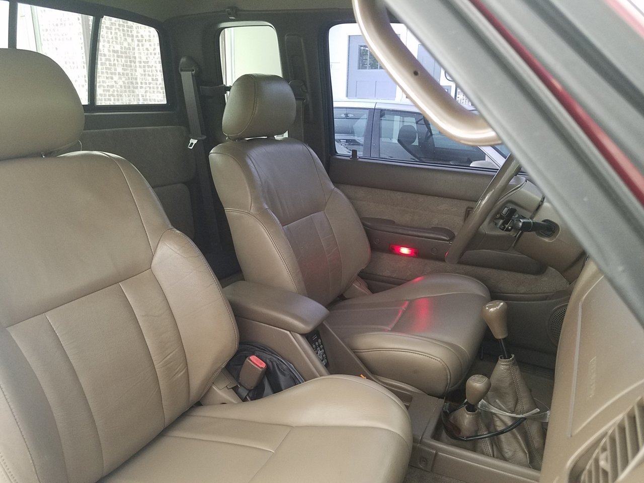

    Wasn't expecting to have to swap the seat belt receivers but they dont interchange with the belt buckle. Came out pretty darn nice. I guess it took me about 4 hours.

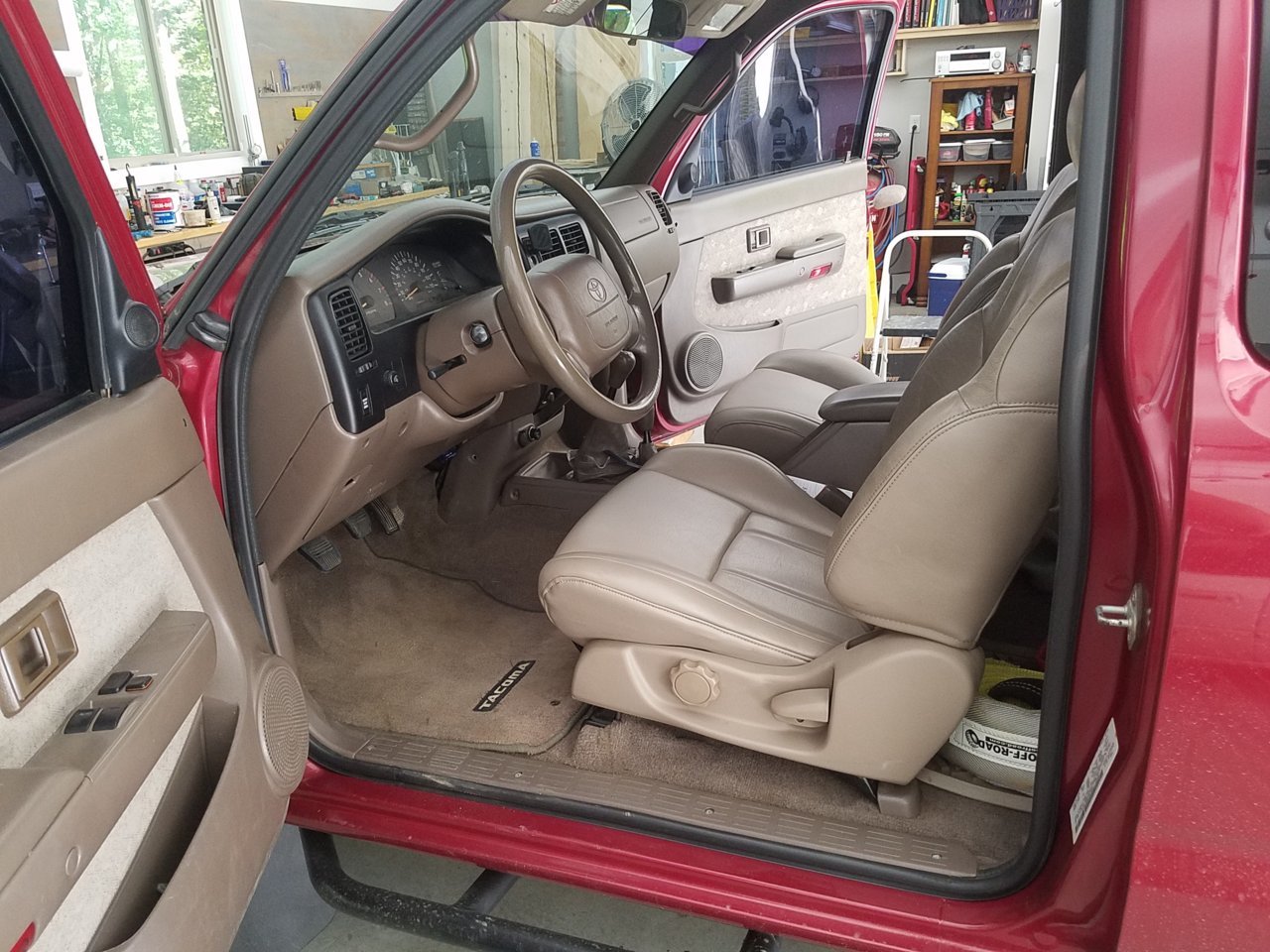

    I finished installing them today. I pulled the seat cover off and used flex tape to repair the tear in the upper seat back. Will see how it holds up. This was the first time I have ever pulled seat covers off. It wasn't too bad.
    JBTacoma and OG_Tacoma like this.

    Looks good, I bet they are comfortable.

    Glad to see them go to a good home!
    WOW, nice job! They look even better in there than I thought!!

    I have plans 45 minutes away tomorrow so it will give me an idea. They seem pretty comfy but my lower back makes the decisions on "comfortable".
    Thanks.
