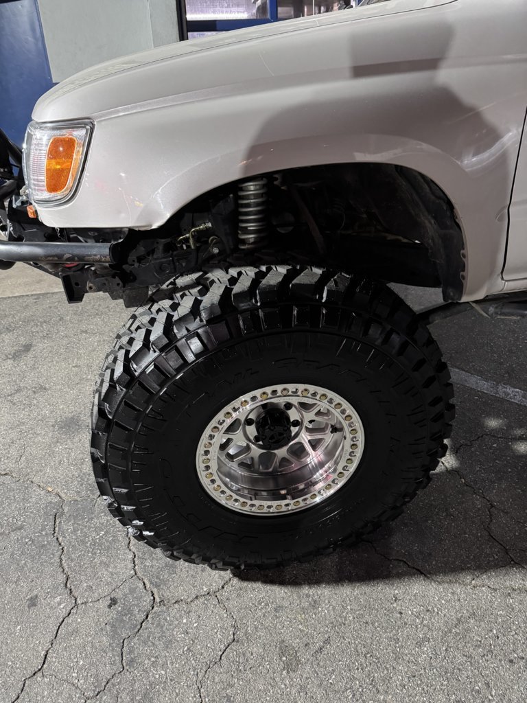

    I got mine from a local shop through FB marketplace called Salinas Tires and Wheels. They get blanks and then send to wheel shop once you specify lug pattern of your rig. Supposedly they get their wheels from wheelpros, so you might wanna try there.

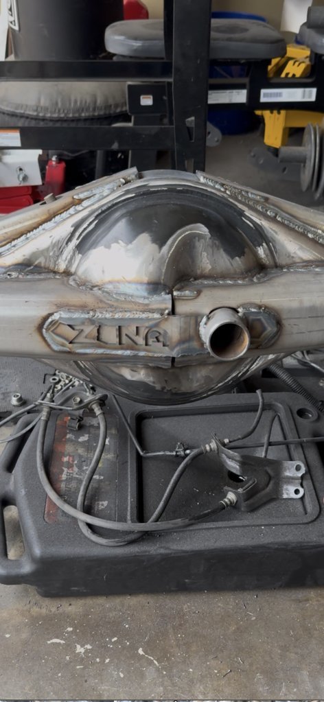

    I’ve been lacking on progress updates with this build. Basically ended up getting an 8.75” 3rd gen Tacoma rear end. I figured guys are out there running these stock rear ends wiyh 40’s without any issues. @Ricardo13x was the mastermind behind putting it all together. Picked up a complete rear end on marketplace. Had to regear to 4.88, change the driveshaft flange to match the pinion side flange of the rear end. @Ricardo13x built a new brake line, move the spring perches, regeared it, cleared the fenders in the front and rear, and put it all together. Only thing I can take credit for is welding on the zona motor sport truss.
    Ricardo13x likes this.

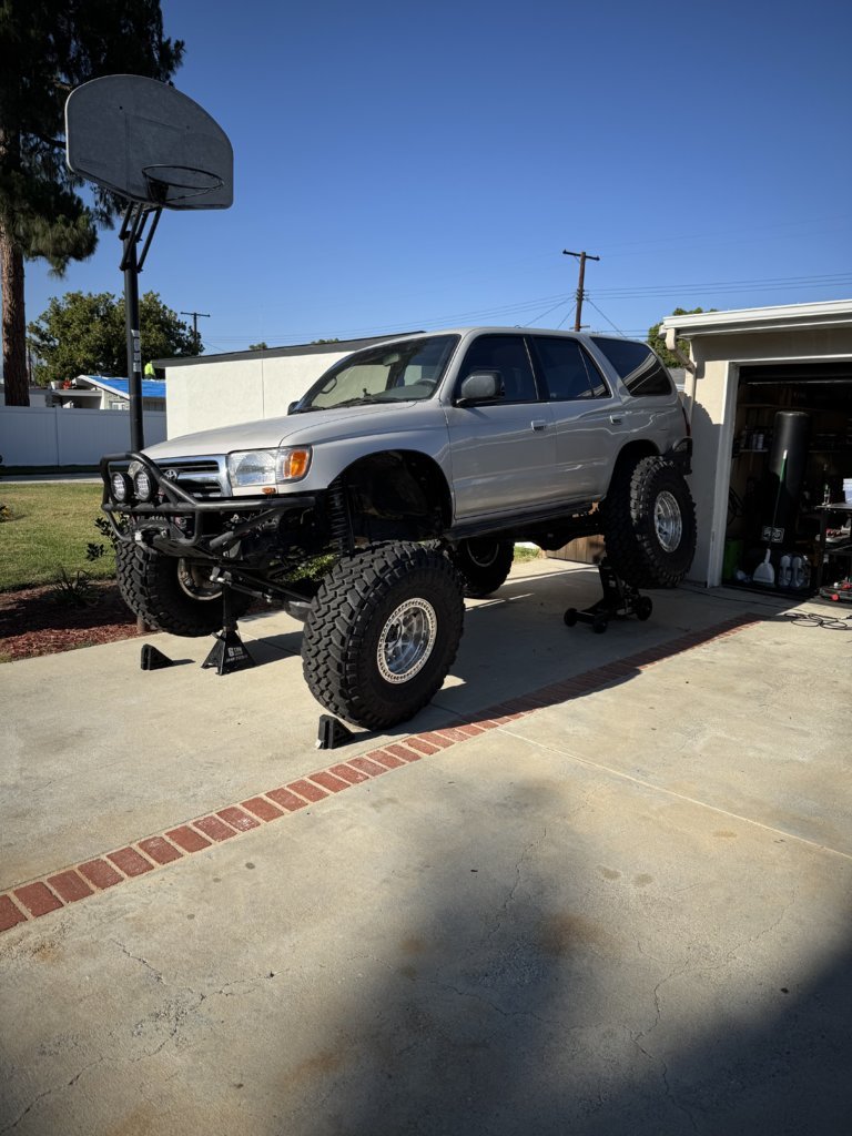

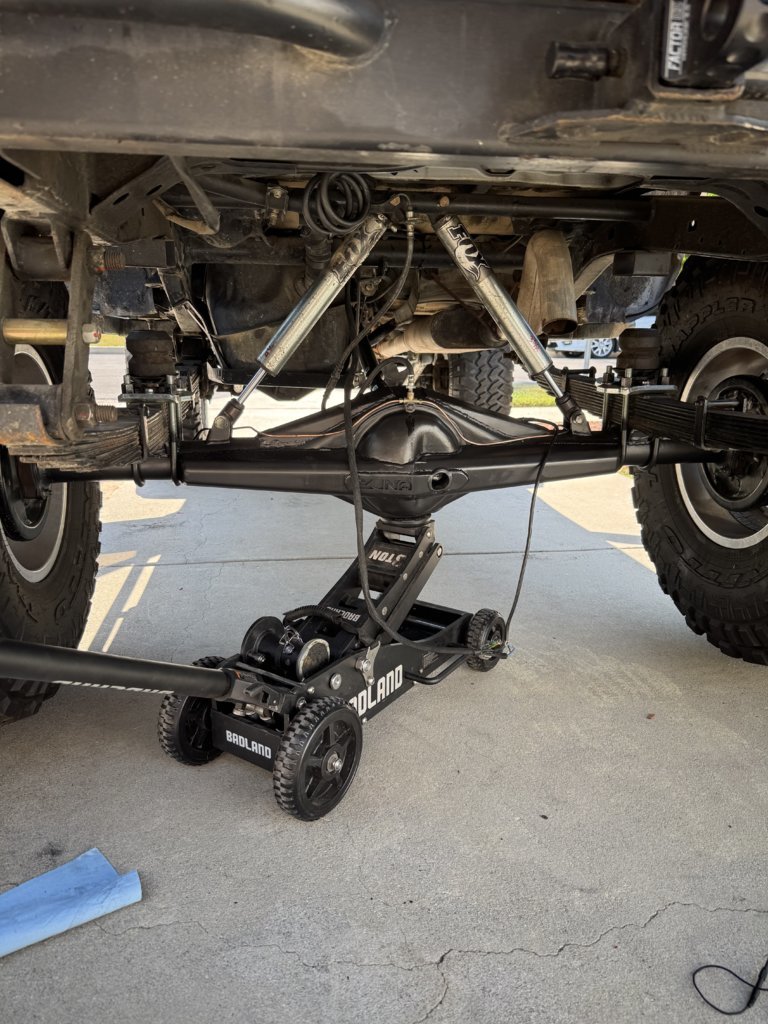

    Forgot to add, @Ricardo13x also had to move the air shock mounts. He brought them a little closer so hopefully the rig doesn’t sway as much. He also connected the e-locker that came with the rear end. Just waiting on nuts and washers for the driveflange from Toyota dealership on Monday. Then it’s time to take her for a ride. Here’s how she’s sitting.

    A shock is just a dampening device, truly has nothing to do with body roll. Without said device, the leaf springs will just bounce. Mounting the absorbers more in a vertical plane helps dampen the most. Mounting the absorbers in an “A” will remove that optimal absorption but allow the user to gain more travel.
    If you’re trying to limit body roll, consider adding a front, rear, or both sway bar so the truck will return to plane faster and prevent body roll. Adding a rear sway will be the easiest, considering the rear tire isn’t in a turning tire. Adding a front sway is extremely tricky but doable and more involved. Considering the frame mount track bar, pitman arm of the steer box, axle width, and tire turning radius is also a huge factor for the front. There’s nothing else you can do to prevent body roll without the addition of a sway bar. I’m running an offset RockJock in the rear and offset TK1 for the front. Adding the rear helps tremendously for both surface streets and highway but is a night and day difference once I got the front sway on. Handling the mountain road curve at a fast rate of speed feels way better than an IFS.
    Out of curiosity, why the semi float 8.75 and not the full float 80? WMS difference between both axle is .75” and the 9.5 third is more robust compared to the 8.75. Another benefit of the FF is the easy of service, pull the shaft and you have access to the third, no mess like a semi float. Plus, on a FF, the weight of the vehicle is supported by the hub, and the axle shaft only transmits torque while a semi-float, the axle shaft supports both the weight and the torque.

    good call on all the above and questions. Addressing the shocks: yes I know it’s not gonna get any better, it got moved in more and more vertical actually way more spread out before. I plan on getting an outboard shock relocation as one of my next projects. You are also spot on for the rear sway bar. Matter of fact @Ricardo13x and I talked about it before he left for the night as he drove through the riots in LA. ROC Joc antirock in rear is next up on project as well.

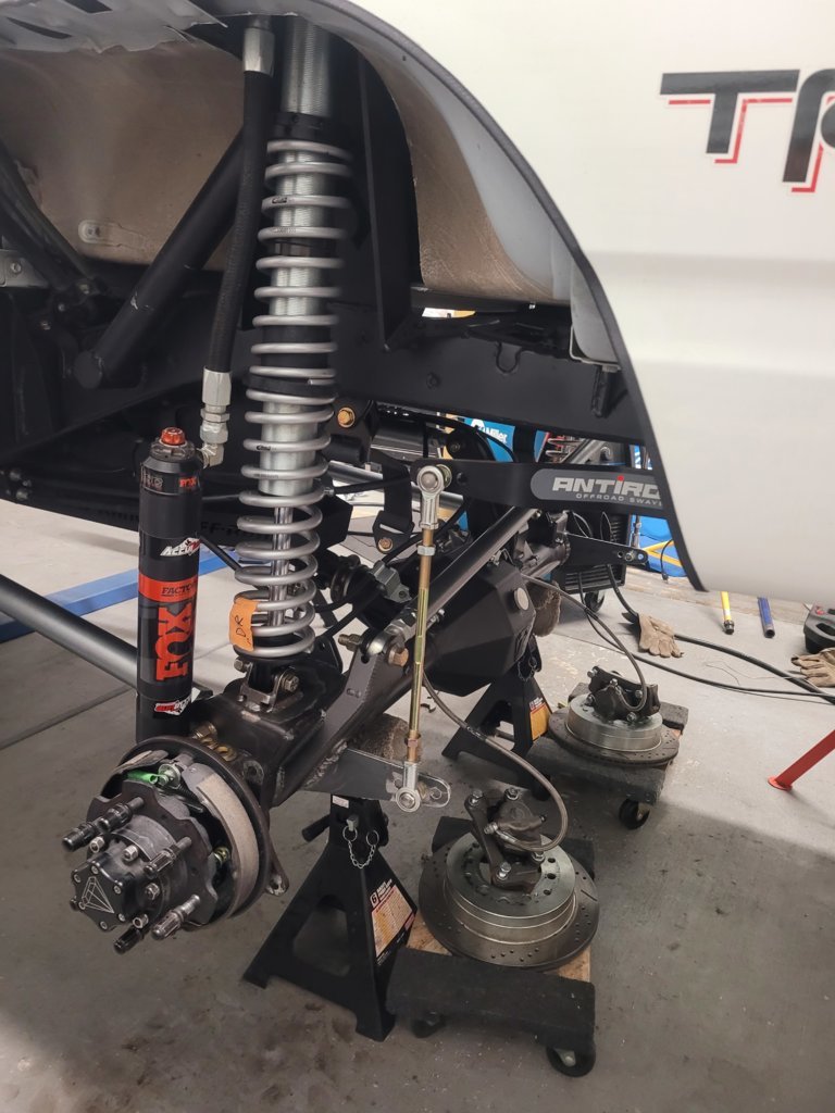

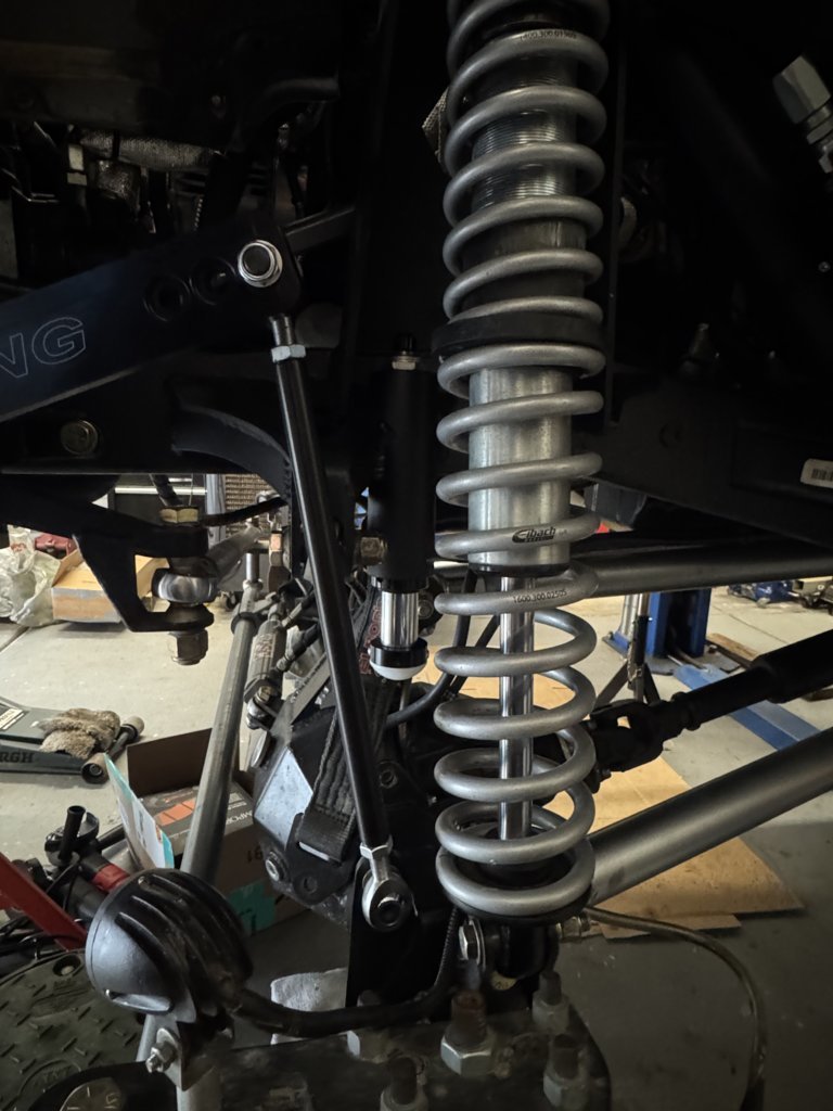

    @02hilux probably best if I just straight up go for the swaybar in front. Then add the rear after if even needed. Are you using some quick disconnect on yours?

    No quick disconnect for me, I leave them in tact when I offroad. Haven’t feel the need to disconnect them, maybe the 20” arm has help to not disconnect. Plus, if needed, it’s just 2 nuts to remove to pull end link and accessing them is easy. Like I said above, the front will be time consuming, challenging, and a headache trying to package everything together in a compact location with lots of moving parts unlike the rear. That’s why majority will run a rear instead of a front. I honestly don’t think you’ll need a front sway if you add a rear. If you think about it, leaf springs, in a way, do act like a sway by returning the truck back to plane. Adding a rear sway will add resistance to the leaf springs and I think that should be good enough IMO. I been in a few truck that has rear sway with leaf springs and 3 link front and it drives pretty darn good.
    If you decide to add a front, do your measurements twice and cut once, lol. Consider tire turning radius, farthest outward point of the pitman arm when lock, frame mount track bar bracket, location of coilovers etc to consider your sway placement and arm length. Too short of an arm is not good for the bar. Too long of an arm will cause bind. No win situation, lol.
