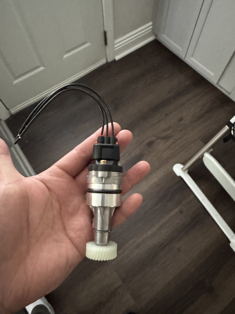

    All right, update to the Speedo. I got one functioning. Ordered a Tacoma VSS from Amazon. It has 34 teeth. Here’s link: OCESTORE 83181-12020 Vehicle... https://www.amazon.com/dp/B09T5TF3LW?ref=ppx_pop_mob_ap_share
    also ordered a 3 wire pigtail connector: uxcell Speed Sensor Connector... https://www.amazon.com/dp/B0CJRTYQS5?ref=ppx_pop_mob_ap_share
    Followed all instructions from here: https://www.pirate4x4.com/threads/3...g-speedo-without-wheels-speed-sensors.626684/
    To summarize: by transfer case tail shaft, there’s a little cover held by a 12 mm bolt, my bolt broke, went to Ace and got a replacement only difference is just a 13 mm now. Remove that. Replace with the Tacoma VSS. It’s a bit snug but it will work itself in. Tap it in slowly and gently, it will go. Here’s how that VSS looks:

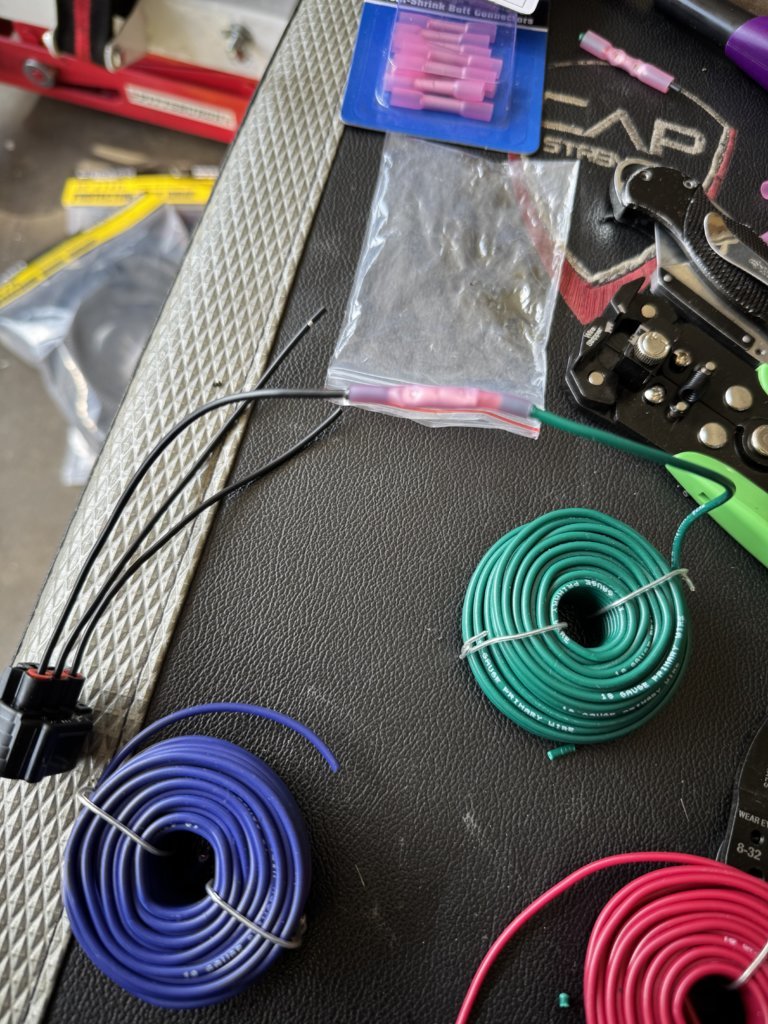

    Get yourself 3 18 gauge wire of different colors to make it easier. Get some butt connectors and have them all like this.

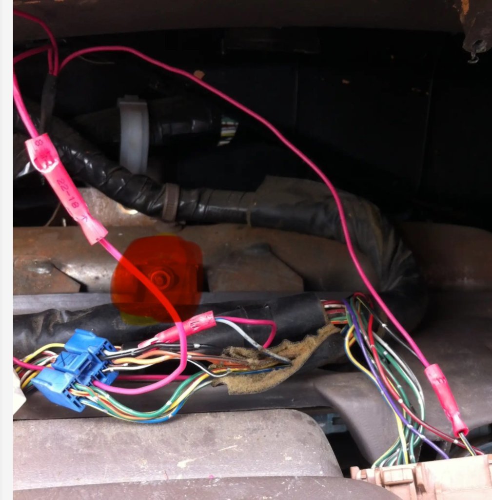

    If looking at back of connector with pig tail, left connector is signal (I used green wire), middle is ground (I used blue wire) and hot wire is all the way to right (I used red wire). Extend those wires out and route through the firewall. I routed on top of transmission and used firewall on driver side by master brake cylinder. From there I fed it to the cluster gauge dash. My cluster gauge had 4 connectors. Brown, blue, small white and big white. On blue connector, I spliced in to the grey and blue wire the signal wire (green). On brown connector, I spliced in to the black and yellow wire with the power source wire (red). This black and yellow wire has 12v on ignition only. The blue wire, I grounded on this nut (highlighted in red).
    From there put everything back together. At first drove around the block still no speedo. @Ricardo13x sent me a post from irate4x4 where the guy said he cut the grey and blue wire. So essentially, I routed the signal wire directly to the blue connector that had the grey and blue wire. Snip I went so I eliminated the ABS ECU from possibly sending any signal to the blue connector. Well, what do you know, Speedo and odometer is working perfectly. No codes, no engine light. Just gotta drive the rig around a few hundred miles then time to get smogged. All on point for another trip to the Rubicon early August after all the jamborees are over with.
