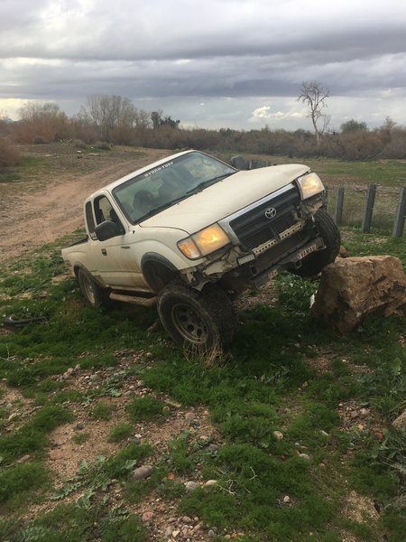

    A little bit of an update, at 270,500 about 4-5k of 4wd consistently being equipped and daily driving to and from work. The Tacoma World meet in AZ was HUGE! It was sick to see so many options for the tacomas uniqueness in person. Here some pics of my bad girl getting put to use, 4wd Conversion for the win.
    Out by my house in Avondale AZ, with the rear locker on and my front locked I can climb anything my tires can touch haha.
