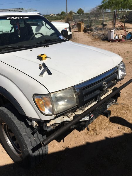

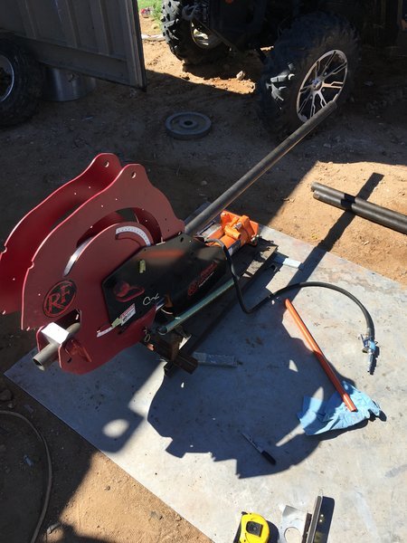

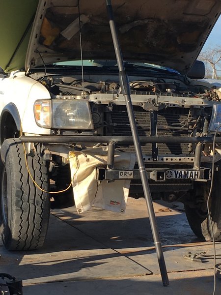

    A super chill friend of mine has some sick tools when it comes to building shit on your own and at your house. We didn't have gas to properly mig weld but he did have a bender that ran off air powered hydraulic ram and a tube notcher. So stoked that it's my own two hands and the help of friends making my truck come to life! The 4wd is working great guys!

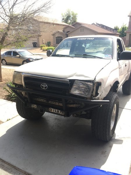

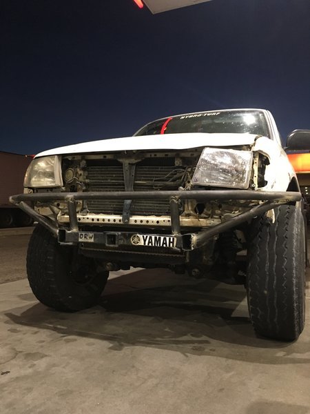

    Painted black and grill back on I have my 7" led pods now installed off the frame behind the bumper... loving the progress. Stinger coming next as well as sliders and possible brace over the cab or motor.

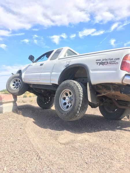

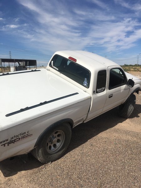

    Had a little bit of fun out by my house in Avondale, Arizona. I need to try and get footage of hauling through the dirt switchbacks, it's super loose and I get sideways connecting the turns. Here's a few pics! Crawling up some concrete barriers a tad larger than my tire size... Locker does work! Possible quick release sway bar disconnects soon haha
