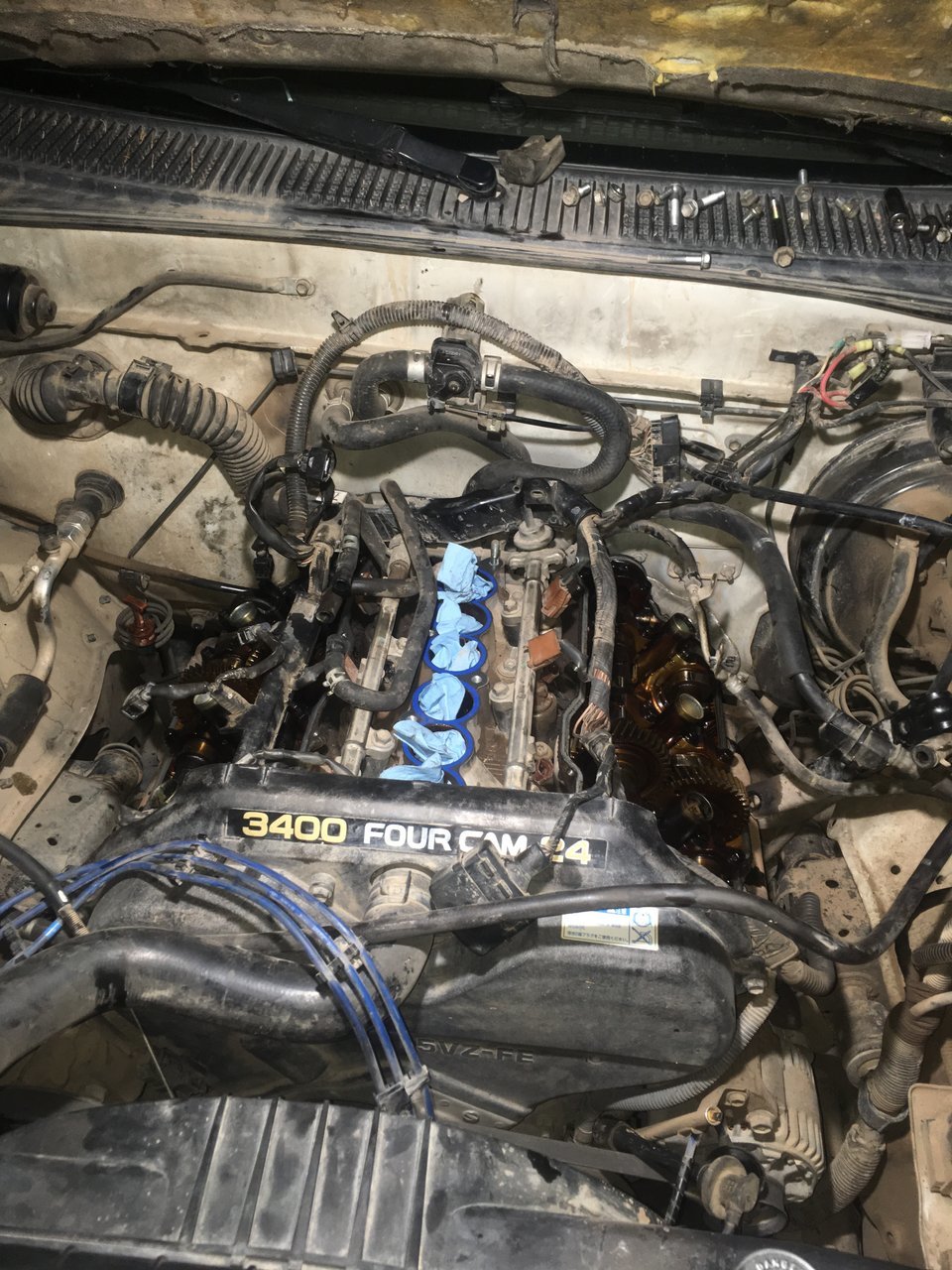

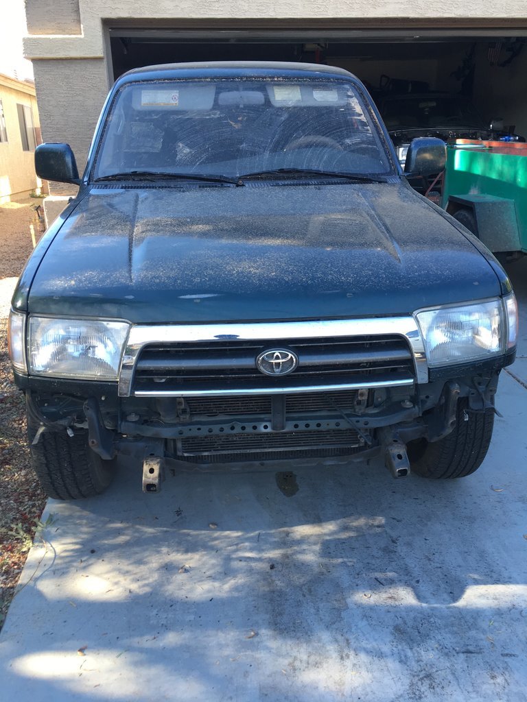

    Swapping the motor is not at all anything I worried about. I'm at the part where I'm figuring out what I'm doing as far as the harness... it's going slow and easy but I'm sure I'll get it done. Need a t100 ecu but I may just swap out the whole trans I'm not sure yet if I want to move up to the newer style like my Taco has now or not. Pretty excited to have a 4 runner and especially love the second gen with the tailgate. Also... bought another 4 runner haha 3rd gen 4x4 with the 3.4 and it's awesome! Already about to build a bumper for it!

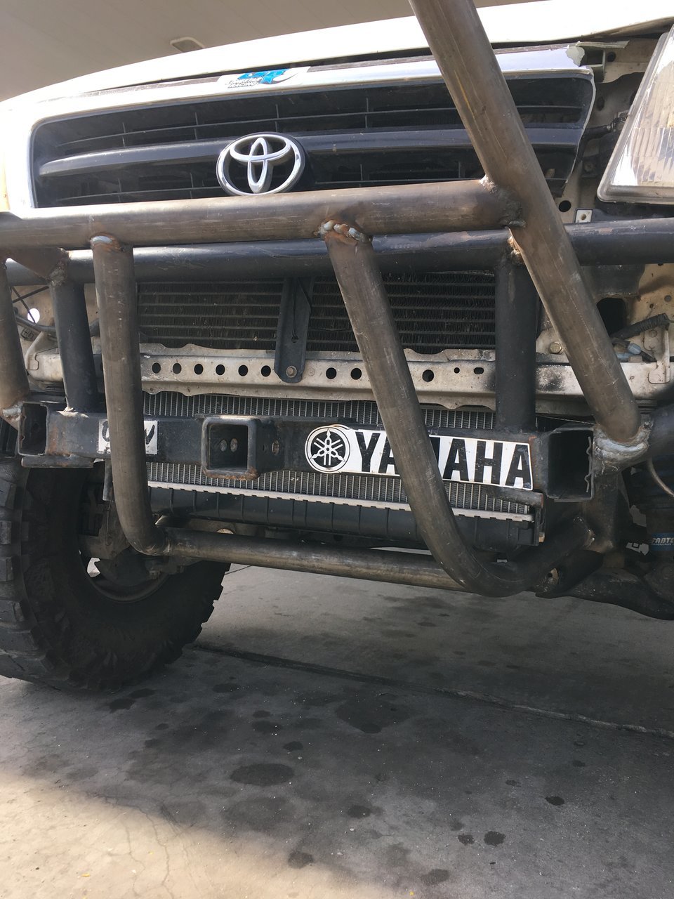

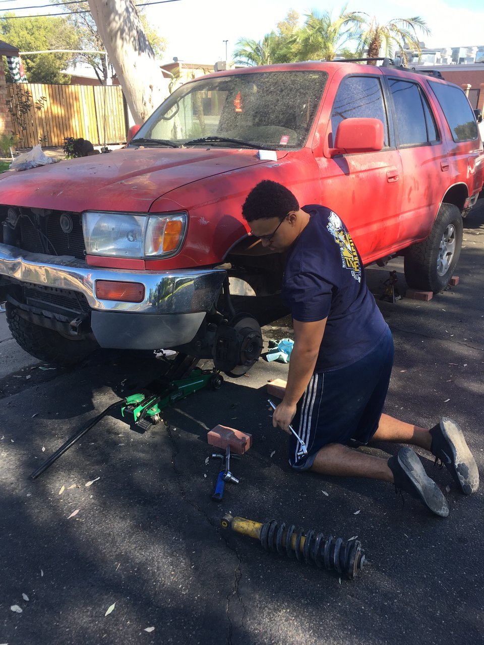

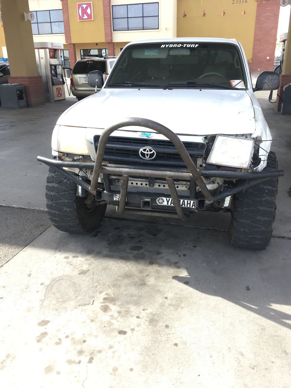

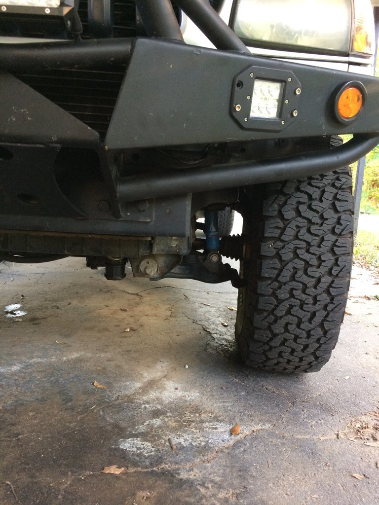

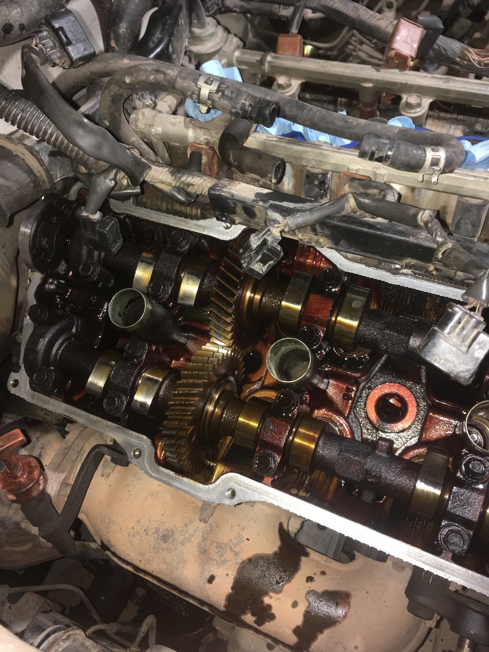

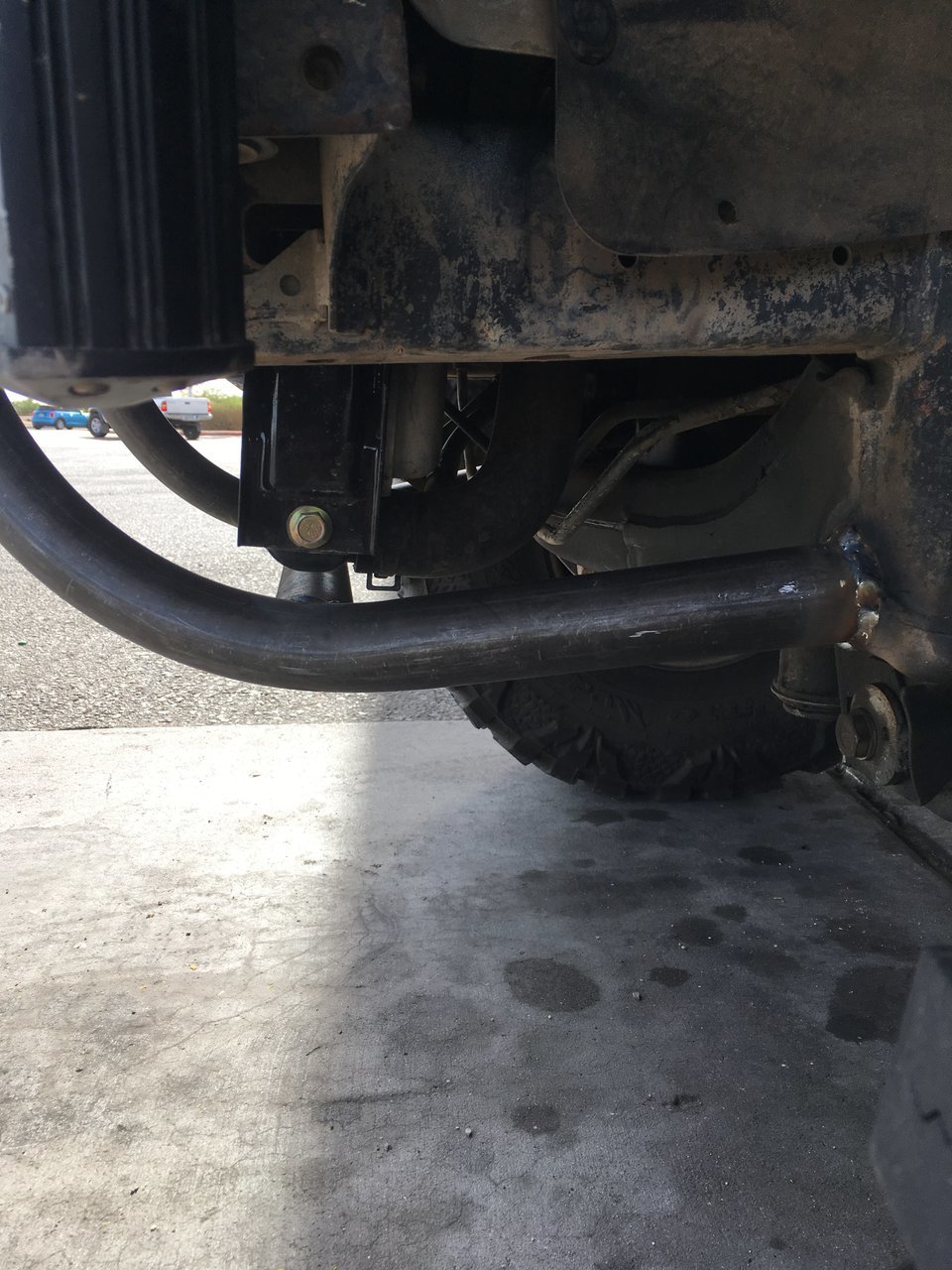

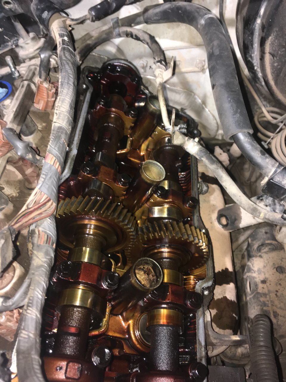

    Out here just chugging along 295k now, rear main is leaking now... did my valve cover gaskets last weekend and grabbed the stuff I need to do the rear main. Yesterday I worked on the front end of my truck with a buddy. We got a nice little cage around the radiator for protection. Some pics... also made my lil bro lift his 4runner. A member on here gave me an OME lift for the front and we slapped it on as well as threw on some Tacoma wheels with BFG mud terrains haha.
    IMG_2433.jpg IMG_2434.jpg IMG_2435.jpg IMG_2481.jpg IMG_2483.jpg IMG_2480.jpg
    My little brothers 4 runner, it had a set of Tacoma wheels and tires but I want to get him wheeling so we upgraded slightly on the cheap.

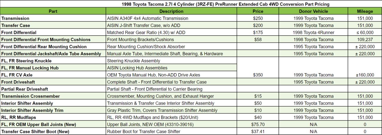

    I'm actually doing this swap next month. In case anyone wanted a thorough parts list (assuming you will be using Manual Hubs and swapping over a Manual Front Jackshaft) here's what I bought so far:

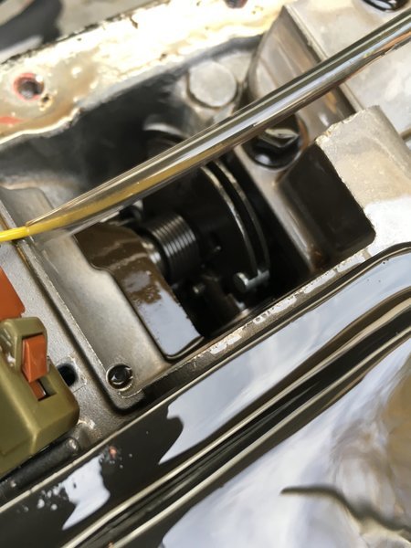

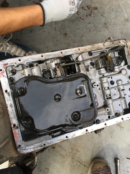

    Is this an A340F? That looks nothing like the transmission filter on my A340F. It's a lot smaller than mine.

    That was the 2wd a340a

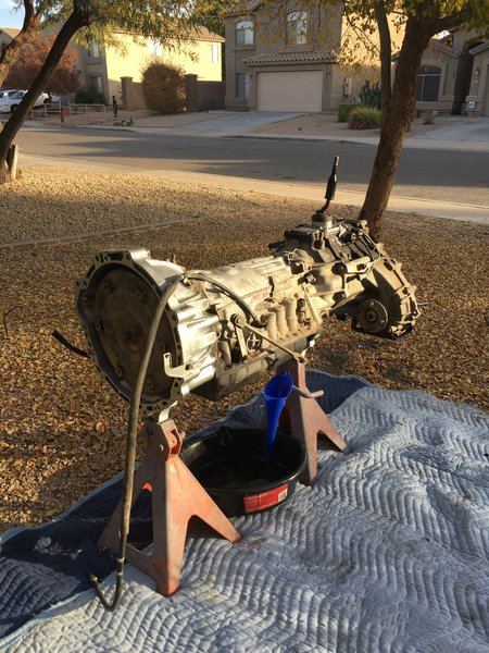

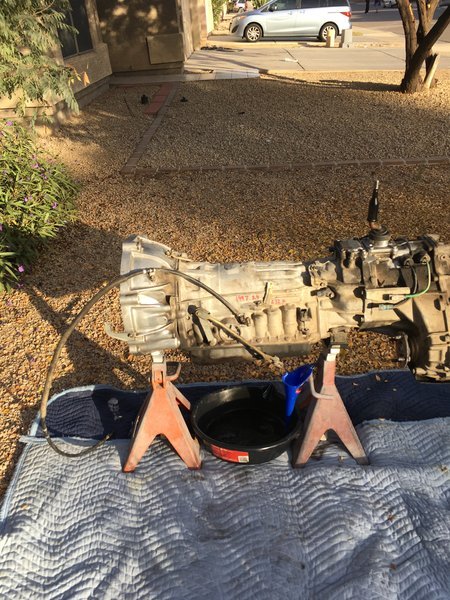

    Yes hahahaha. That picture was because I used the speed cable from my 2wd trans because the tranny I bought was broken at the plastic where it mounts up

    I wonder why the A340F trans. filter is bigger than the A340E's considering the use the same internals.

    Well the f holds a shit ton more trans oil if I remember right so maybe just proportionate to the amount of oil it has to filter consistantly

    I was under an impression they were both identical in exception to the output shaft, maybe the torque converter holds more?
