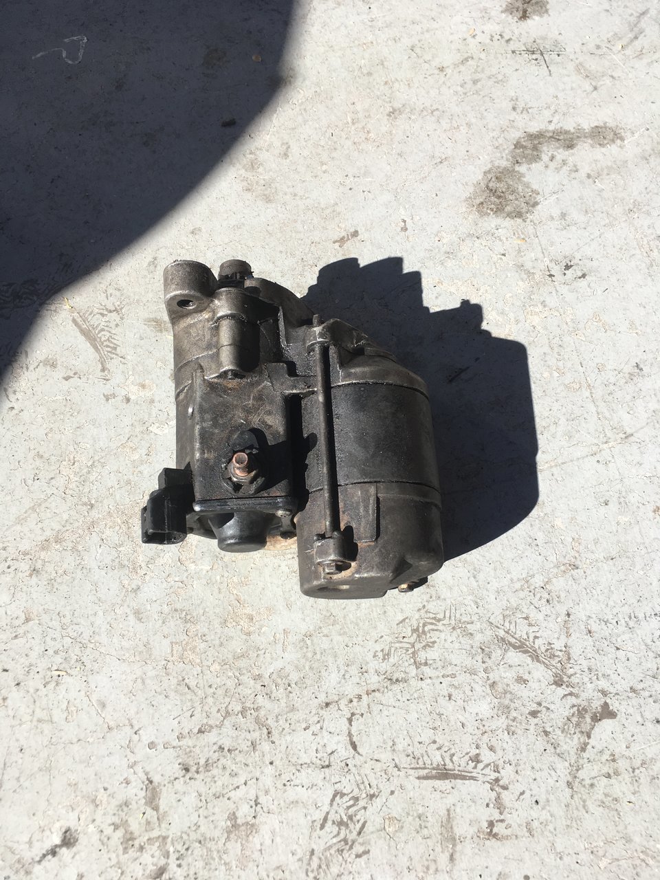

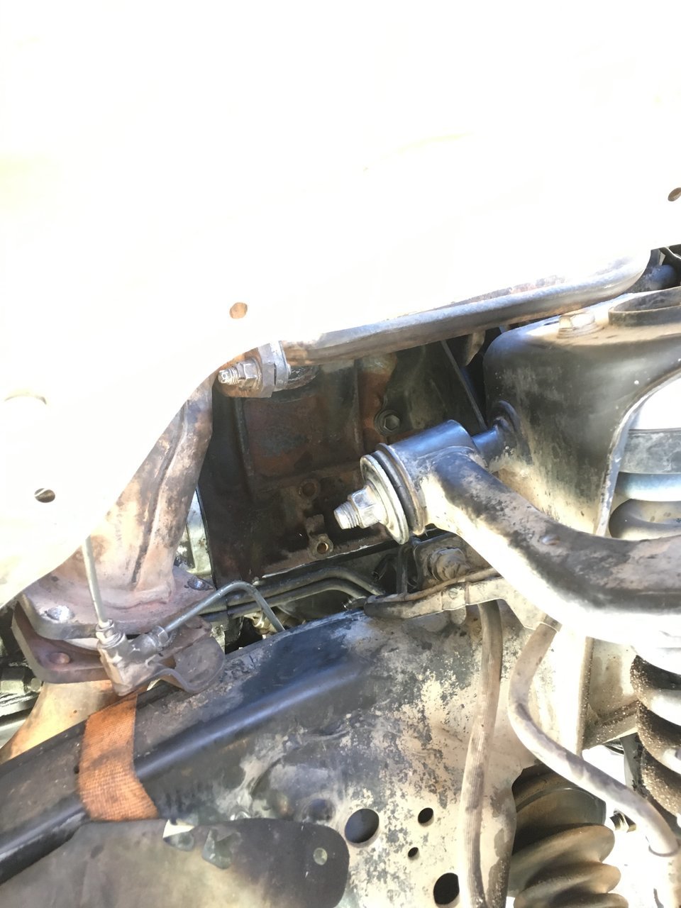

    Just a PSA, if you are working on pulling a starter on a Toyota 3.4... watch Timmy the Toolman. PERIOD!!!
    Got my starter out in about 15 min haha now to go test it. Fucking bummer cause I wanted to fire my truck up and see if that motor is any good haha
