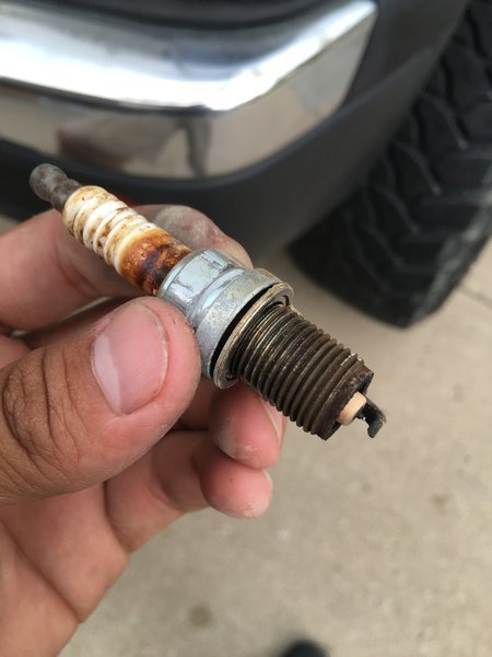

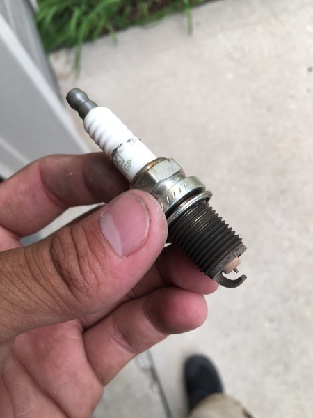

    Thanks for the info zer0. I have new coils and plug wires coming and should be here Wednesday or Thursday. I went ahead and got factory plugs to see if anything changed before the new coils and wires came but to no avail it's still acting up. Good thing I changed the plugs though cause I believe the previous mechanic was lazy and only changed three plugs and told my friend he changed them all.....
    Driver side
    Yuck!
    Passenger side
    Looks a hell of a lot better.
    Im hoping the new coils and wires fix the issue. I've also ran injector cleaner through it three times now about every other tank.

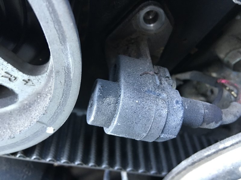

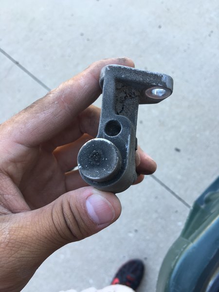

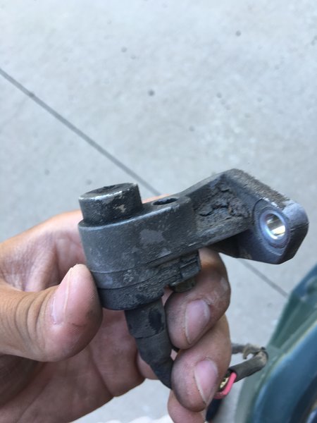

    Found a post of someone talking about their crank or cam sensor causing their issue. They seemed to have the same problem I'm having with the intermittent starts but when it's running it runs like a champ! So I went ahead and pulled both and replaced them. Even after changing them nothing has changed. Still intermittent starting but runs fine when it does. Also every time after changing something I take it for a short drive to see if anything is different when driving and still the same, no noticeable issues and seems smooth. I was going to take it for a long drive this morning but when I went to start it, it didn't start after about 10 tries so I just said forget it and here I am typing this up lol.
    Old cam sensor.
    After seeing the old sensor I was sure this was the issue but I was wrong. Blah! Now I definitely don't know where to go from here. It's just weird there's no issue when running to help point me to other things. I also rented out a OBD reader last night to see if there were any codes being thrown that wasn't setting off the CEL but no codes are showing.

    the K16TR11 is what I put in, the pics of the plugs from above were the old ones. Would leaky injectors cause problems running? When it does start it'll fire up within like 1 second of turning the key. Its happened before when I got in the truck first thing in the morning and it fired up 1st try multiple times with no hesitation. Which I've found it weird that people say these trucks take 3-4 seconds to start when this is one of the fastest starting vehicles (when it does start) I've ever driven. Also holding it for long periods (5-10 seconds) doesn't do anything.
