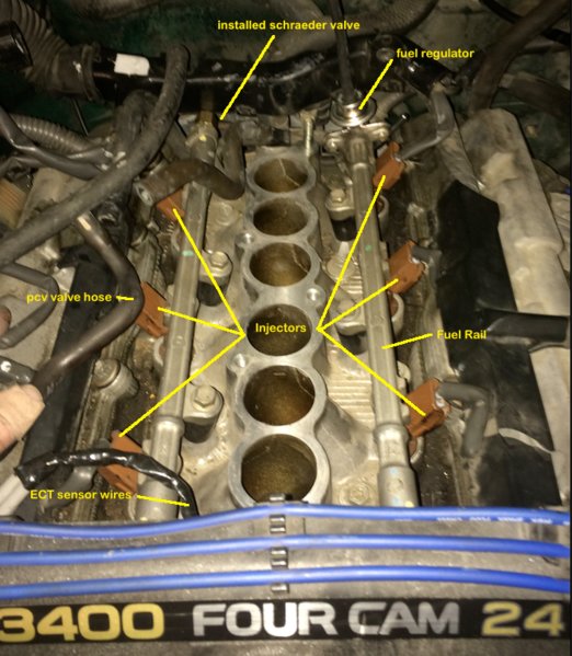

    Also, you asked me a while back how I connected a fuel gauge. This is a photo of my 3.4 after installing the fuel regulator. In the upper left you can see where I removed the regular union bolt and replaced it with a brass version that includes a schrader valve to connect the fuel gauge. Once the fuel gauge is connected you can test running fuel pressure and do the leak down test mentioned by BldEgl2.

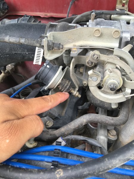

    What is this and whats its purpose? I figured it was some sort of buffer for when the throttle snaps back to the closed position or is it something more? I just tried to start it and a buddy was messing with it by opening the throttle and it started after 4 failed attempts. But if i give it gas while in the driver seat it doesnt start it. Also after about 4 more tries of messing with it being separated it finally didn't start like normal. He also went to the exhaust and said he could smell gas.

    And and about the picture above, is that just a buffer like I think it is or is it actually something?

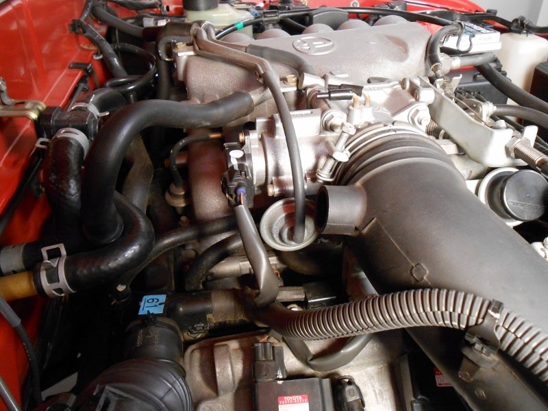

    That is called a Dashpot. It functions exactly as you thought. Found on the man trans trucks, absent on the autos.
    The "Throttle Opener" is the vacuum actuated device on the rear of the throttle body. It holds the throttle plate open a tad via light spring tension to allow a bit more air for starting. As soon as engine vacuum develops (few seconds), the spring is overcome and the plate is allowed to close to the normal position against it's stop.

    Two different things.
    Throttle opener is low center of the pic, shiny round thing with the small vacuum hose attached (no wires), just to the left of the main intake tube. A hose that plugs into the main intake has been removed for clarity.
    Throttle position sensor is dead center, black plastic (with wires). Secured to the t-body with 2 screws.
