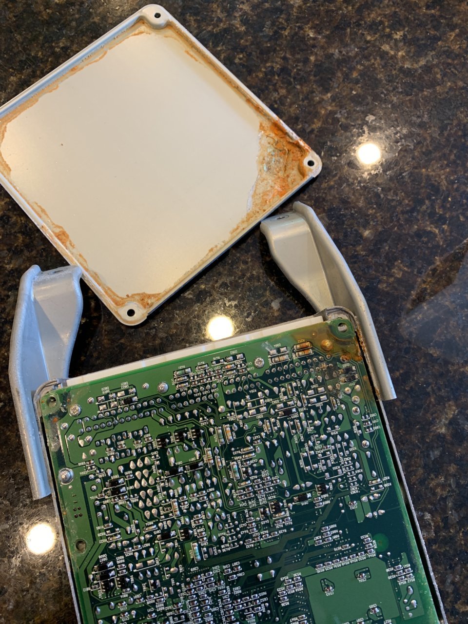

    Wow thank you so much for this write up!! Saved me a lot of money. My check engine light bulb was burn out and so I didn’t know that my ecm wasn’t turning on right away every time I tried to start my 97 taco. I knew something was up with power to the ecm or the ecm itself so I pulled it apart and found a bunch of water damage. Hopefully I can clean it all up and replace some of the components affected. Thanks again man

    Here’s a pic of my board:
