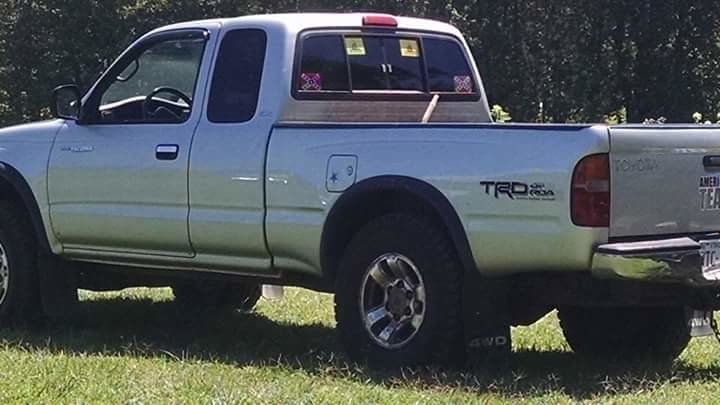

    Noting the lean in the picture, check the passenger front suspension real well. It looks like it has taken some damage as well.

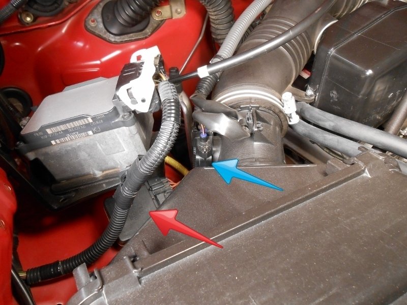

    The MAF sensor is on the air intake just behind the air filter... make sure it is connected and not damaged. take a look at all the wire harness connections on the front end of the motor.

    My 2.7 will start without the MAF connected, but will throw a code immediately and idle like crap

    That was right on wire came loose thank you sir

    Way she was lol
