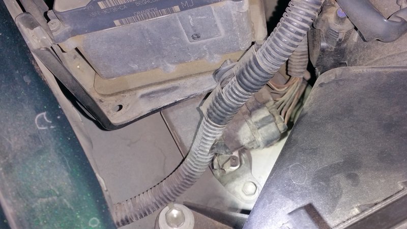

    V6? There's a ignition ignitor module (89621-35020)on the inner fender(apron) on the pass side right behind the air cleaner. Make sure that didn't get damaged. looks like this.....

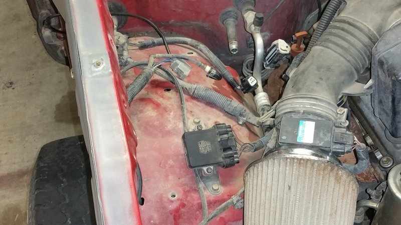

    Do you have a V6? fresh phone pics ....On My truck and on my red parts truck
