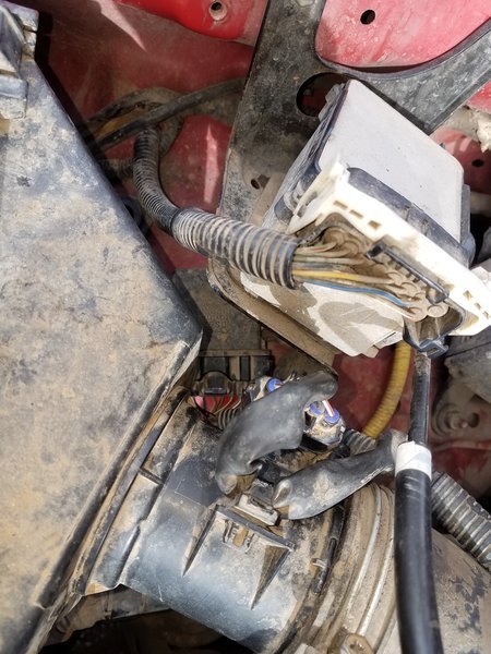

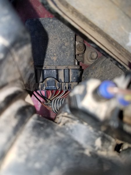

    As an update i was able to fix the problem. I hate when people just fix it and dont let others know haha. There was one small wire on what i believe to be the igniter that was pulled loose. I was able to cut some of the cover back to show mire wires and bend it around a little blue rubber seal that it orginally went through to ensure connection. Ill leave a picture if itll let me.

  18. Feb 19, 2017 at 2:04 PM
    #38
    TaterSalad89
    TaterSalad89 [OP] Member
    Feb 13, 2017
    #210488
    20
    David
    2000 toyota tacoma
  19. Feb 19, 2017 at 2:04 PM
    #39
    TaterSalad89
    Feb 13, 2017
    #210488
    20
    David
    2000 toyota tacoma

    That makes sense since the PO1300 is the ECM is not seeing the igniter signal so shuts the fuel off.
    Glad it runs
