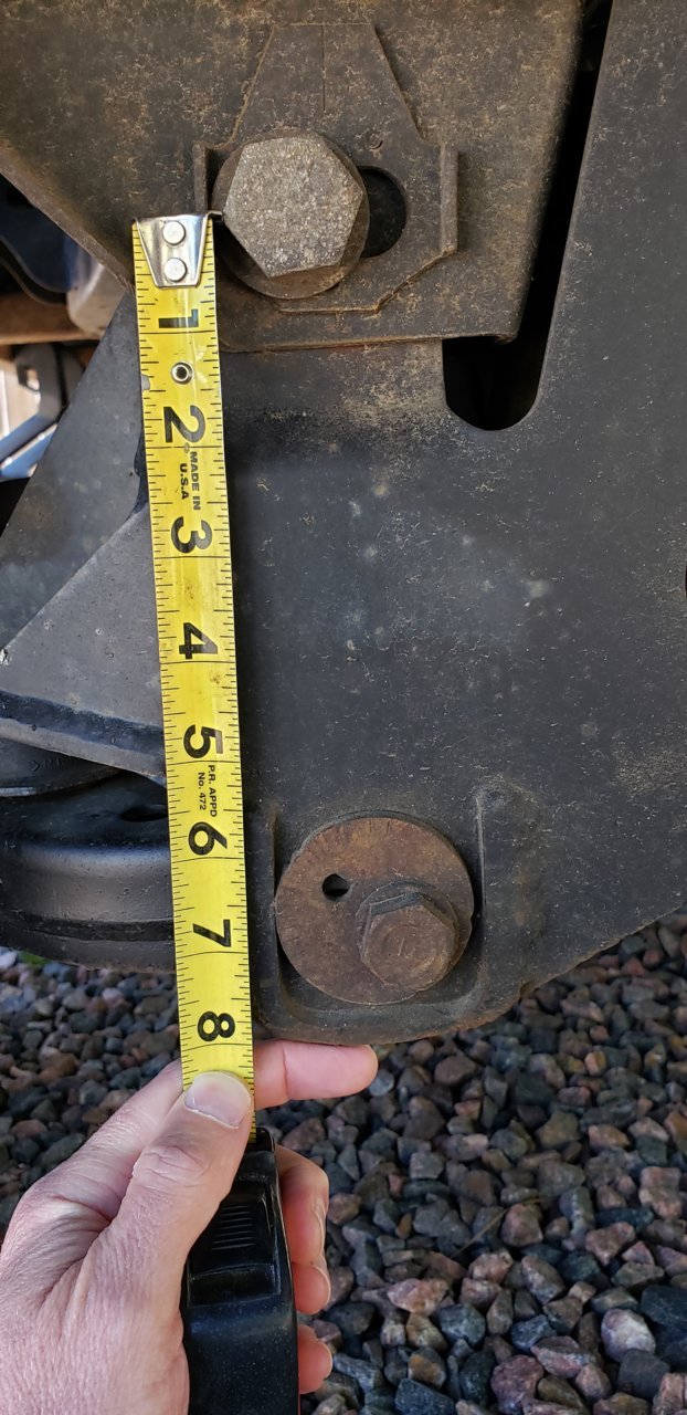

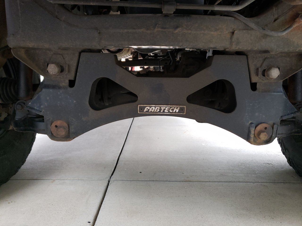

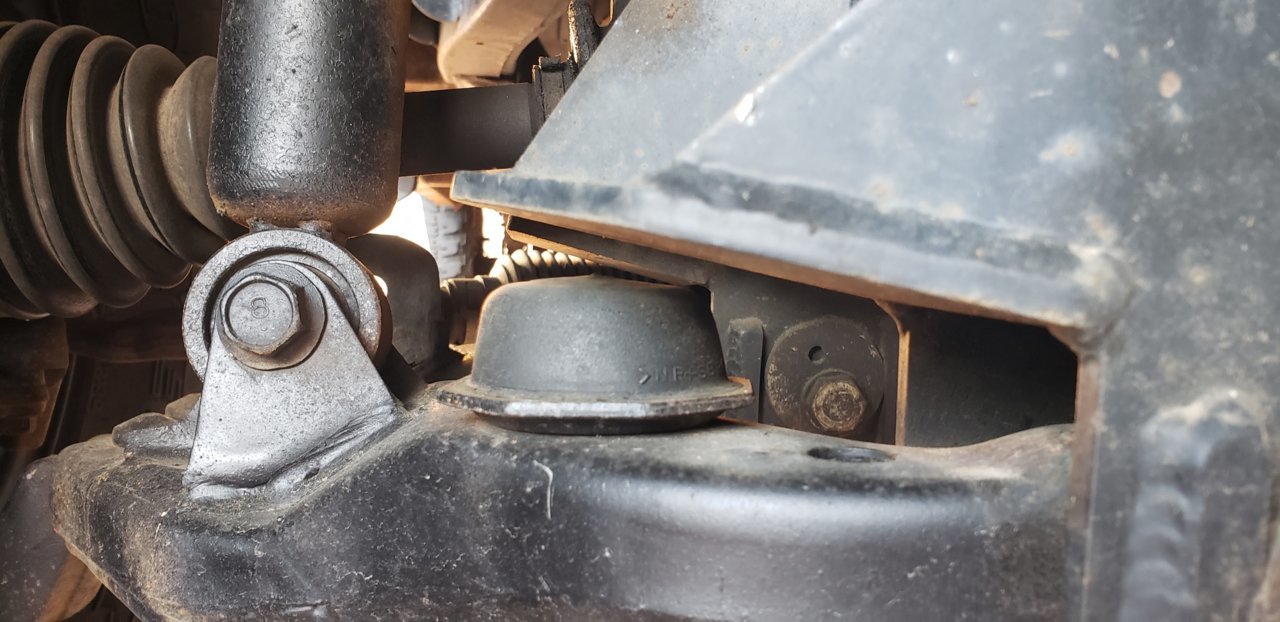

    Question on this lift. I am guessing that this is a 6" lift. When I measure between the old LCA attachment point and the new LCA attachment point I measure 7". See below.
    What gives? If this is in fact a 6" lift, I have lost an inch of ground clearance! Initially I was thinking the front was low due to improperly sized springs and a busted damper. But this is a big concern for me.
    Are all of the 6" Fabtech Bracket Lifts guilty of the sin? Why would the good people at Fabtech do this to me?!?! :mad::rofl:

    So image from the previous post. Anyone ever take the Fabtech bracket and shorten it? Cut a couple of inches off the top and reweld some bracing to regain that ground clearance.

    Most people either revert the truck back to original (find a cross member off a wrecked frame) or SAS it. The fabtech kit is garbage. Don't waste any money on modifying it. Unless you have lots of fab skills and time on your hands.. but then why not just SAS it and "do it right".

    Well, sell it and start over- Going to be a ton of work to remove or modify that lift.

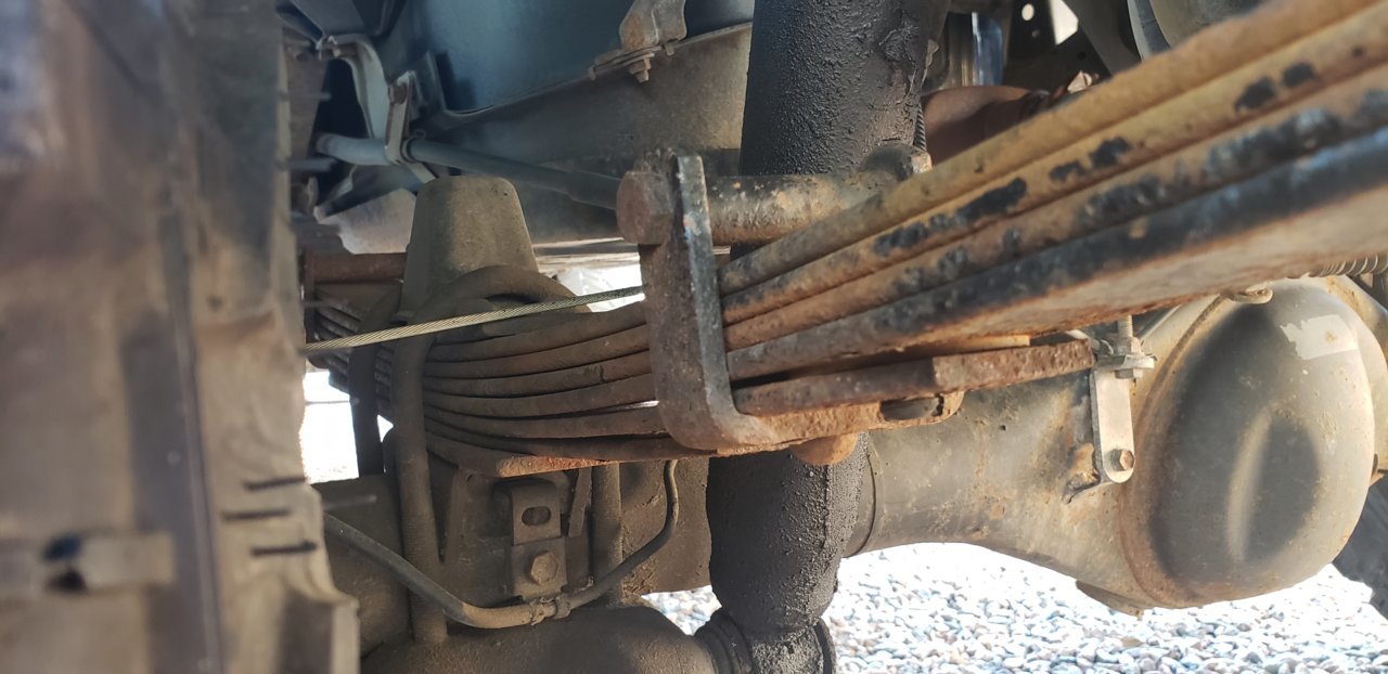

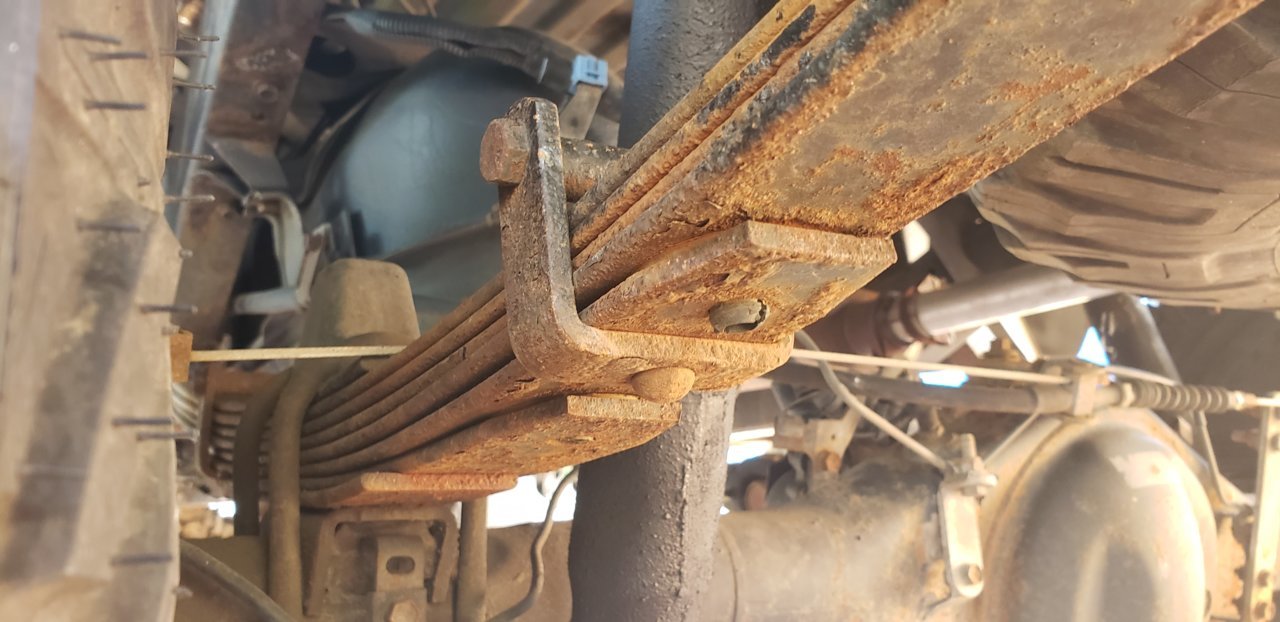

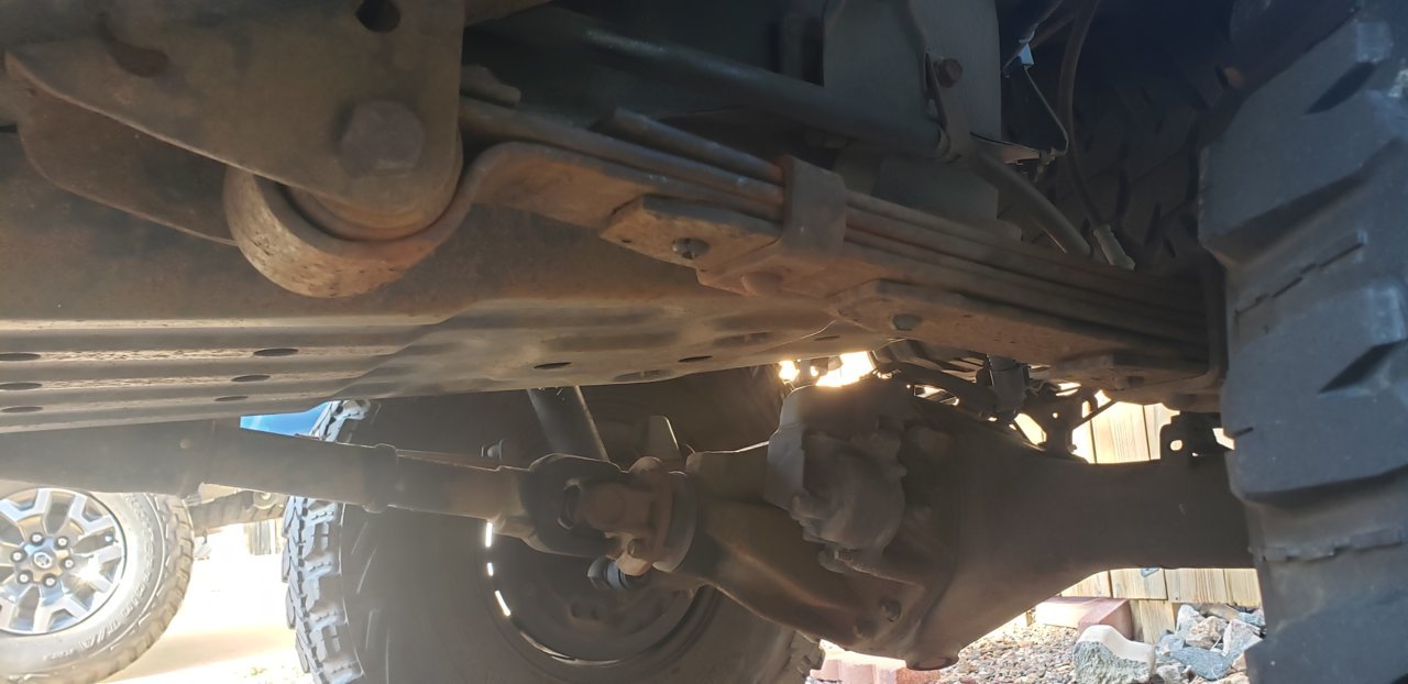

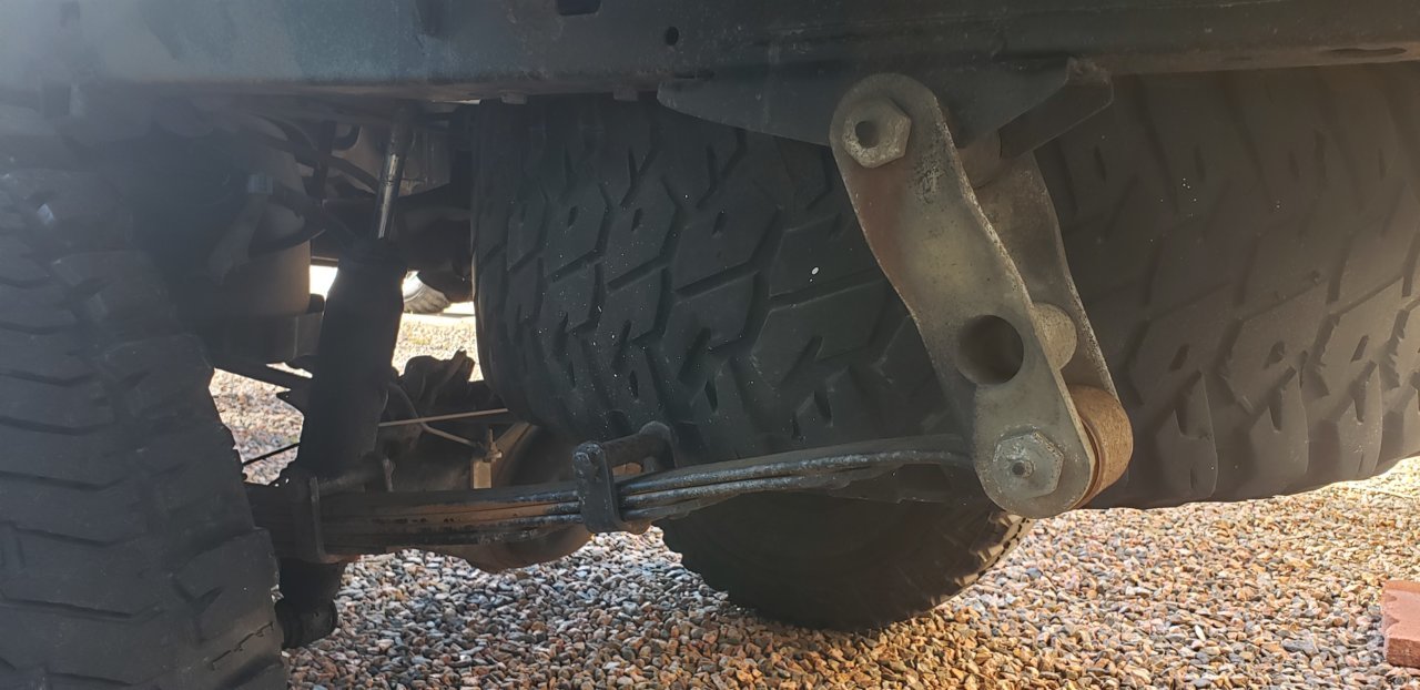

    Anybody have any idea what I have going on here with the rear leaf springs? I'm assuming; overload spring has been cut/removed and multiple leafs have been added. And the shackle adds lift as well.
    TW please help me figure out what I have here.
    My concern is when I replace the front shocks and put in proper springs im going to be riding (even higher) high in the front. I'll have that horrible lean thats so popular nowadays. Personally I like the rear a smidgen (maybe a few smidgens) higher than the front. Anything else looks wrong. Below is how close my bump stops are to the frame as she sits. Driver.
    Passenger
    I really appreciate any help on this. I did not realize how much I would loathe this lift before I purchased the truck. I may end up removing it in the future, it is just not in the cards at this time... At this juncture. It wouldn't be prudent... he he... he he... sorry...:pout:Now I am just trying to make the best of the current situation.

    Those aren't stock leaf springs (the forward eye is military wrapped). You'd have to see if there are any identifying marks on them. I recall the FB lift kit involving lift blocks in the back- so maybe the PO did something smart and get a custom pack built/arched at some point.
    And yes, those are much longer shackles; at least + 1.5". So the springs would need to be around +4.5" to match a 6" front lift. I don't really recall any off-the-shelf 4.5" springs, but that doesn't mean I remember everything.

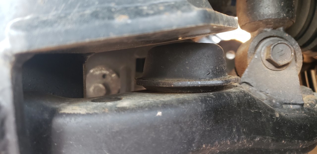

    Pics of the bent shock please. And replace those front shocks with some bilsteins and the front springs with some OME 880.

    So, I'm assuming (agian) the easiest way to match the front would be a longer shackle. I will not be using blocks.

    You also have longer shackles in the rear.
