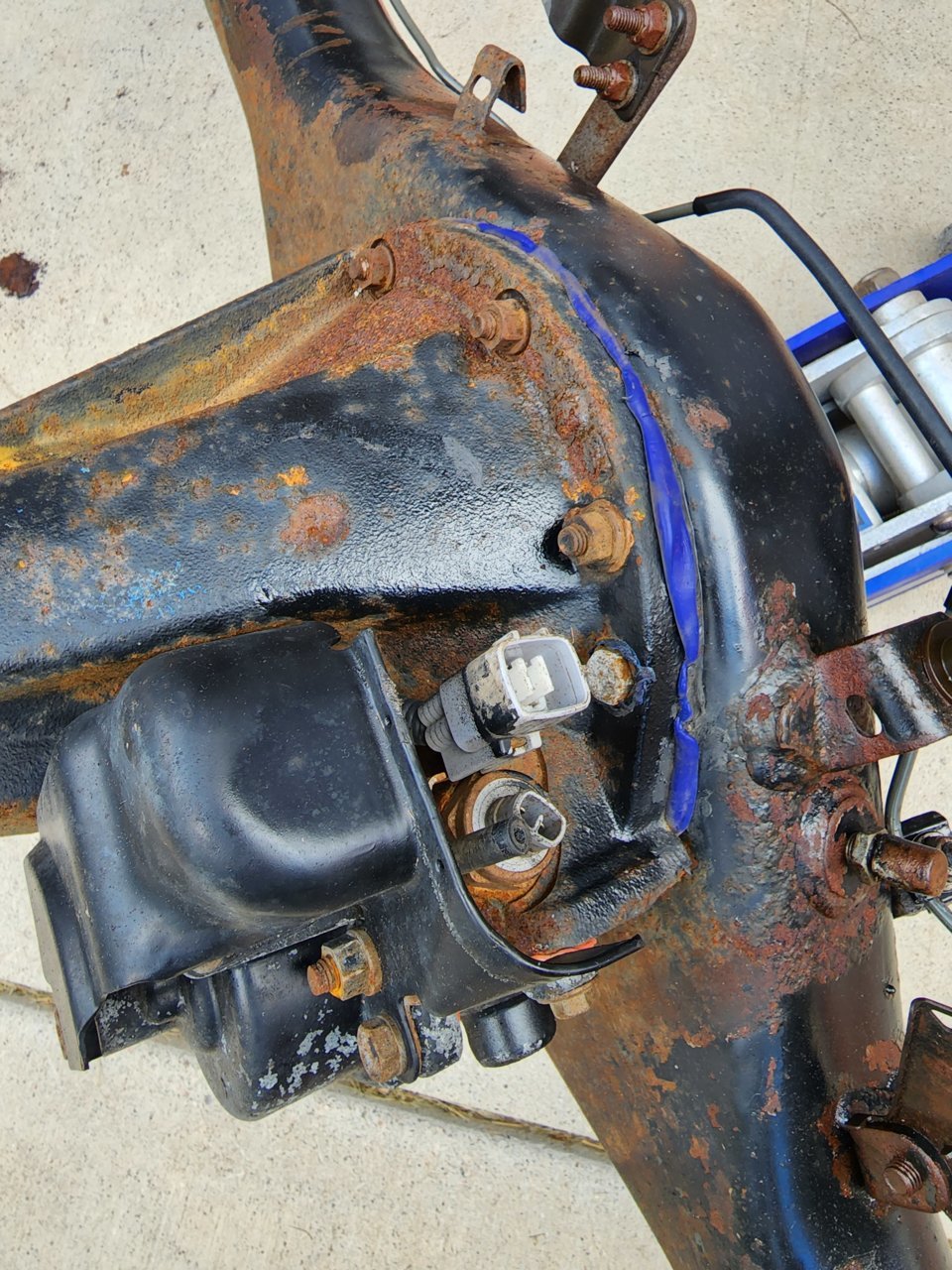

    Pic for ya. TBH if the slider snapped off it wouldn't hurt my feelings too bad as I was never excited that they were welded to the frame in the first place. But, I seriously doubt they are going anywhere.

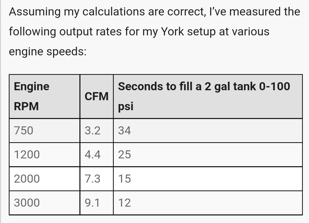

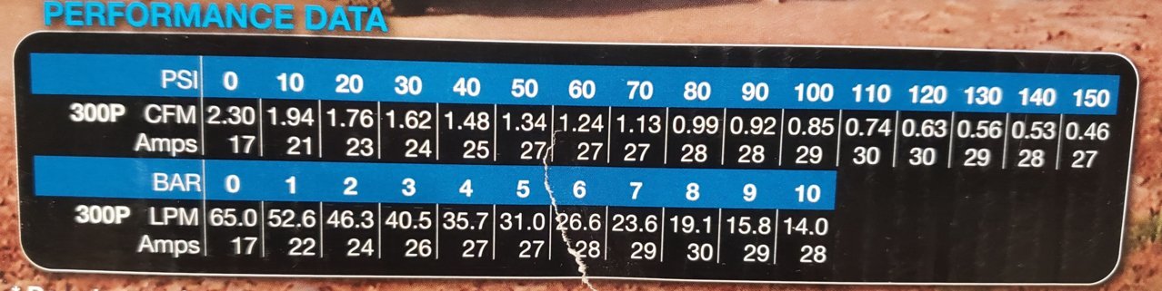

    So, quick internet search tells me the York is far superior. Sounds like air tools are usable on this setup. Mine will need some work. It did come with an airtank and everything but I think I will complete rewire it, and disassemble, clean and oil the pump before trying to turn it on. Probably throw an oil separator inline as well.
    This is off my Vivair 300p box. I assume this is pretty reliable.
    Pulled this off the nets. Have no idea how reliable this is but it does make some sense as the compressor is driven by a ~200hp motor. Should deliver consistent flow rates at any usable (things I would need it for) PSI. You can see the vivair loses cfm as thr pressure goes up because it is driven by a tiny motor.
    There is much evidence online that the York compressor is a great air source. This is a keeper.

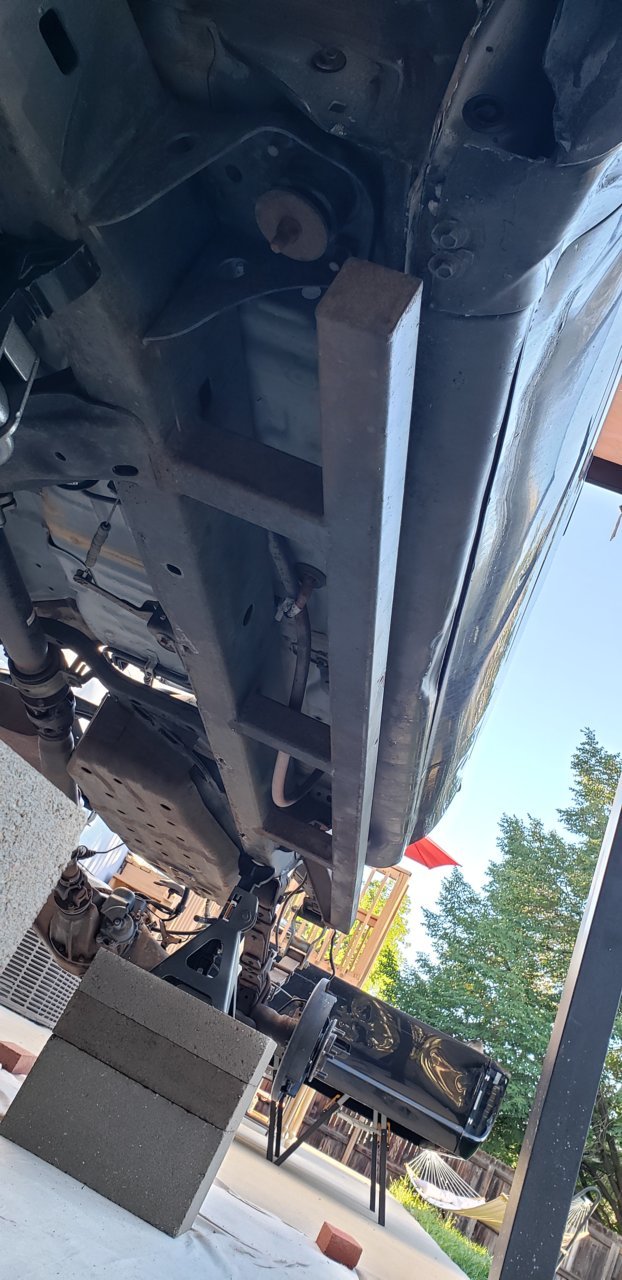

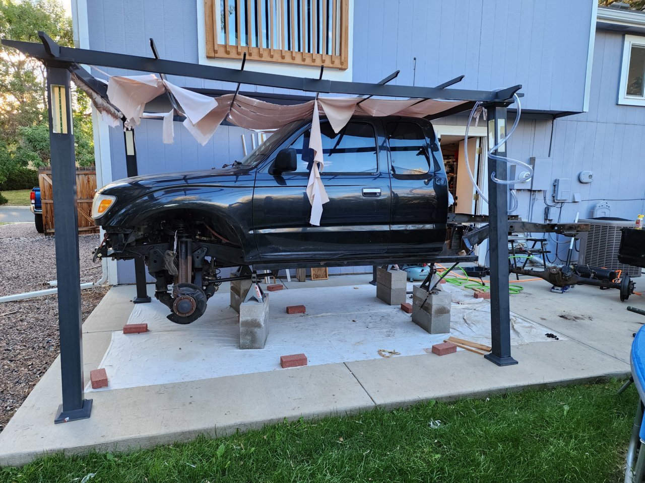

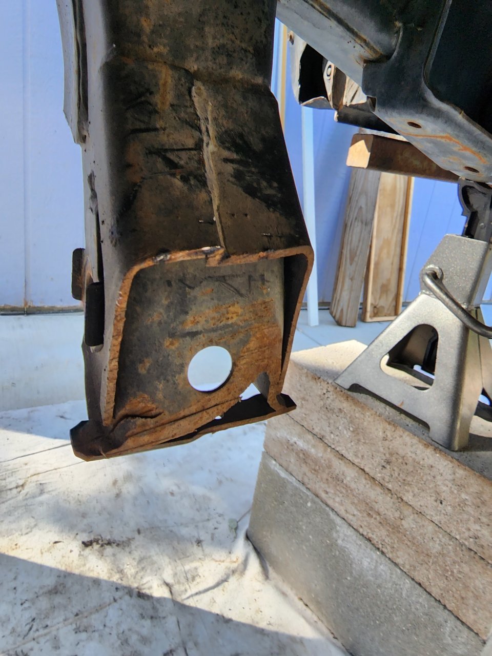

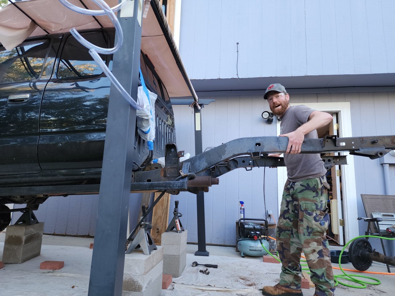

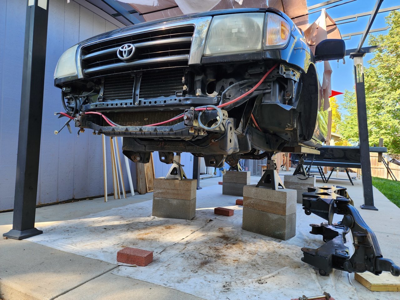

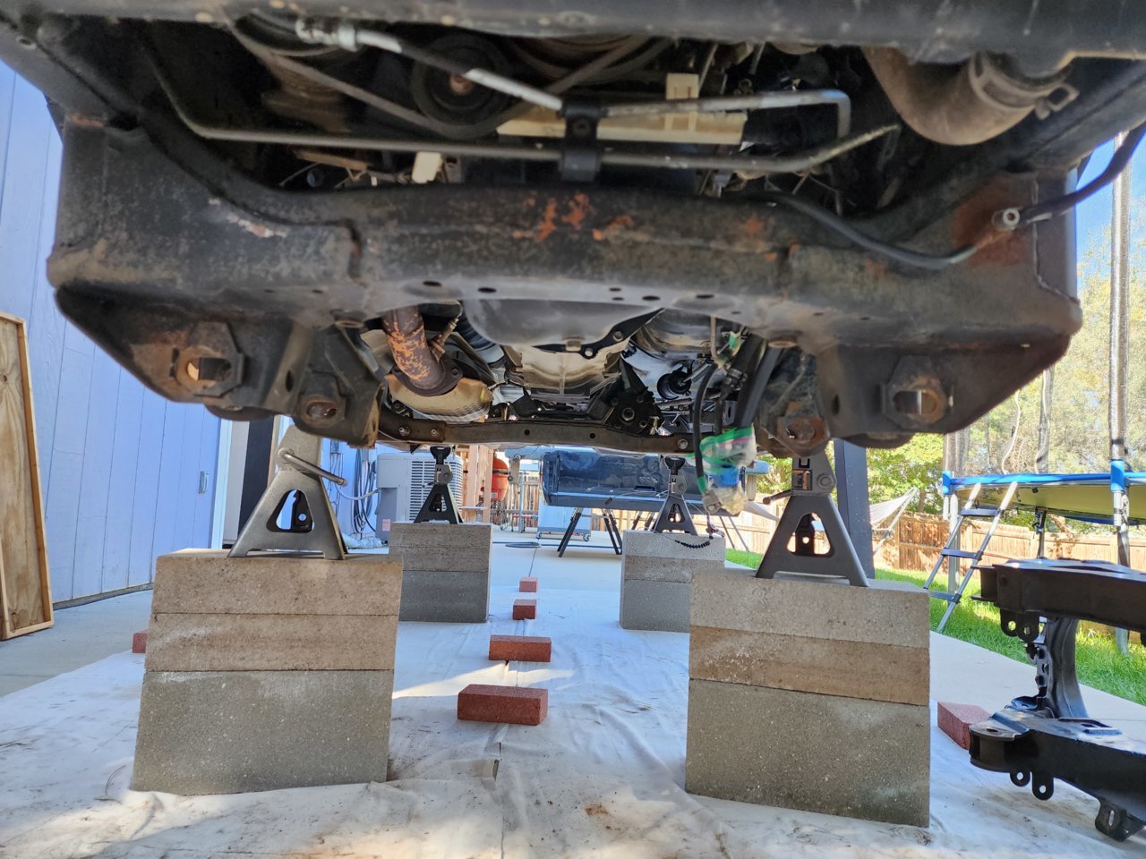

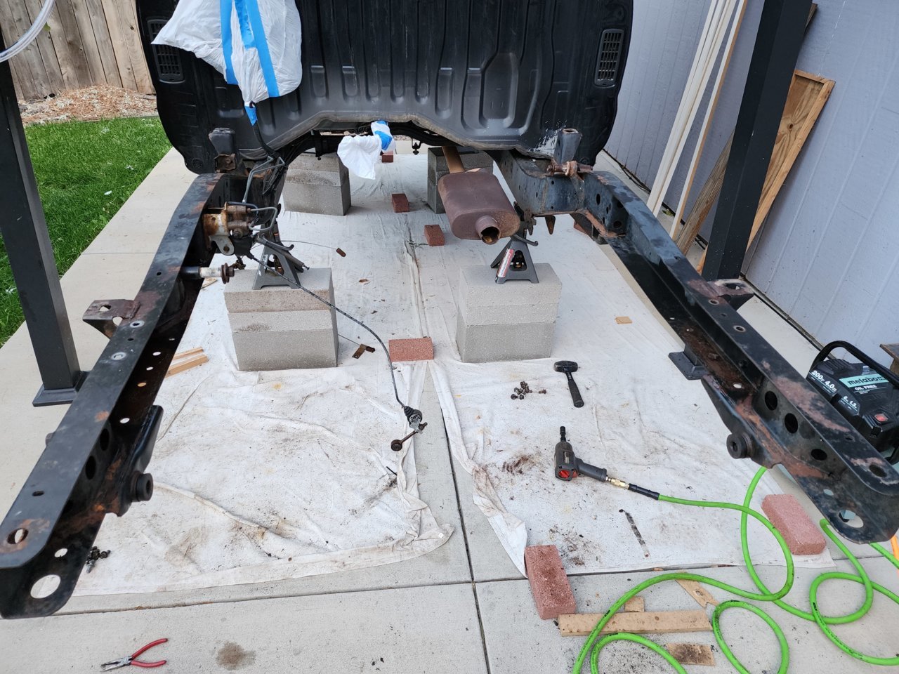

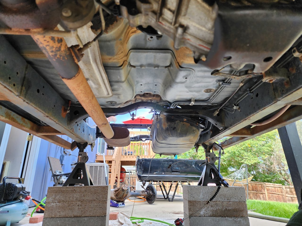

    Quick update. Things have been hectic for me the past couple of weeks. I had a close friend pass away and have been dealing with the aftermath. Life goes on...
    I have torn the truck down further. The rear is basically ready for blasting and paint. 20221002_181238.jpg
    A little tip for everyone, pay close attention to your initial jackstand placement if your planning on disassembling this far. I was pulling the frame crossmember that supports the rear of the fuel tank and damn near knocked the truck off of the jackstands. I did not consider how light I was making the back of the truck. Note the rear jackstands in the photo. I could lift the rear with 2 fingers.
    I added some weight to the rear to help keep her stable. As I remove front end components things should even out some. Hoping to have the front mostly disassembled this weekend.

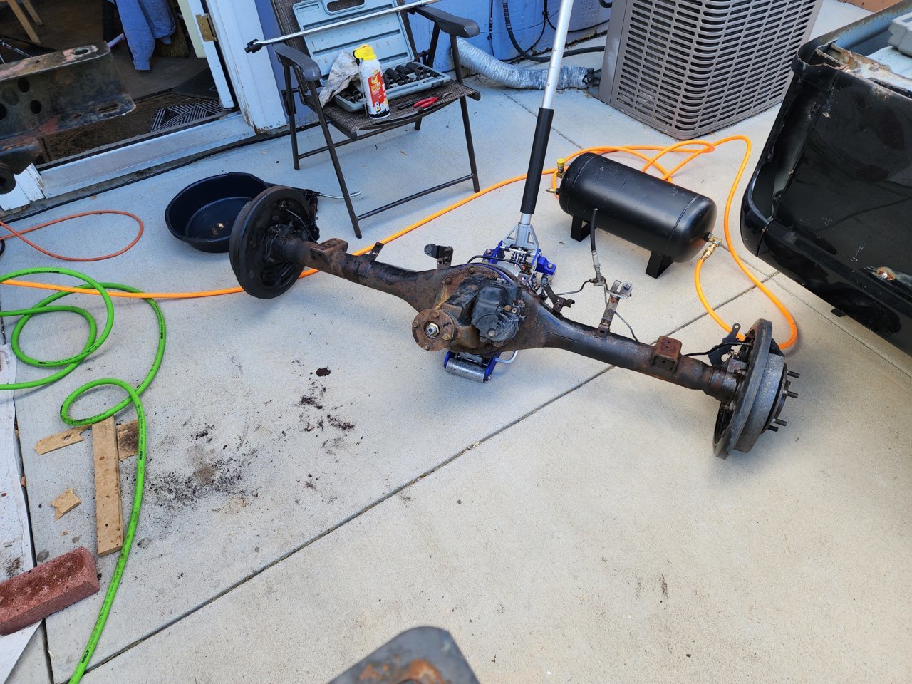

    Think the bastard the did the gears used enough sealant?
    I'll likely split it, clean and reseal. 4.88 gears for anyone who is curious. To get the correct ratio I had to stop one side from turning, spin the other, count the revolutions of the pinion and axle then divide by 2.
    A few more pics.
    20221002_150407.jpg 20221002_150358.jpg 20221002_150352.jpg 20221002_150119.jpg 20221002_150111.jpg 20221002_111348.jpg 20220924_193429.jpg
    Stay tuned!!! More to come!!

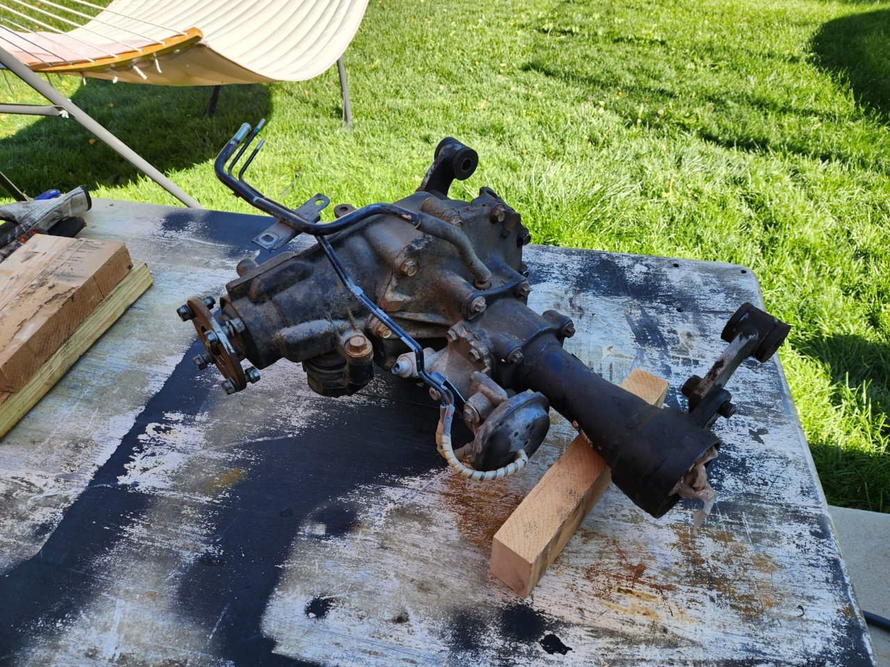

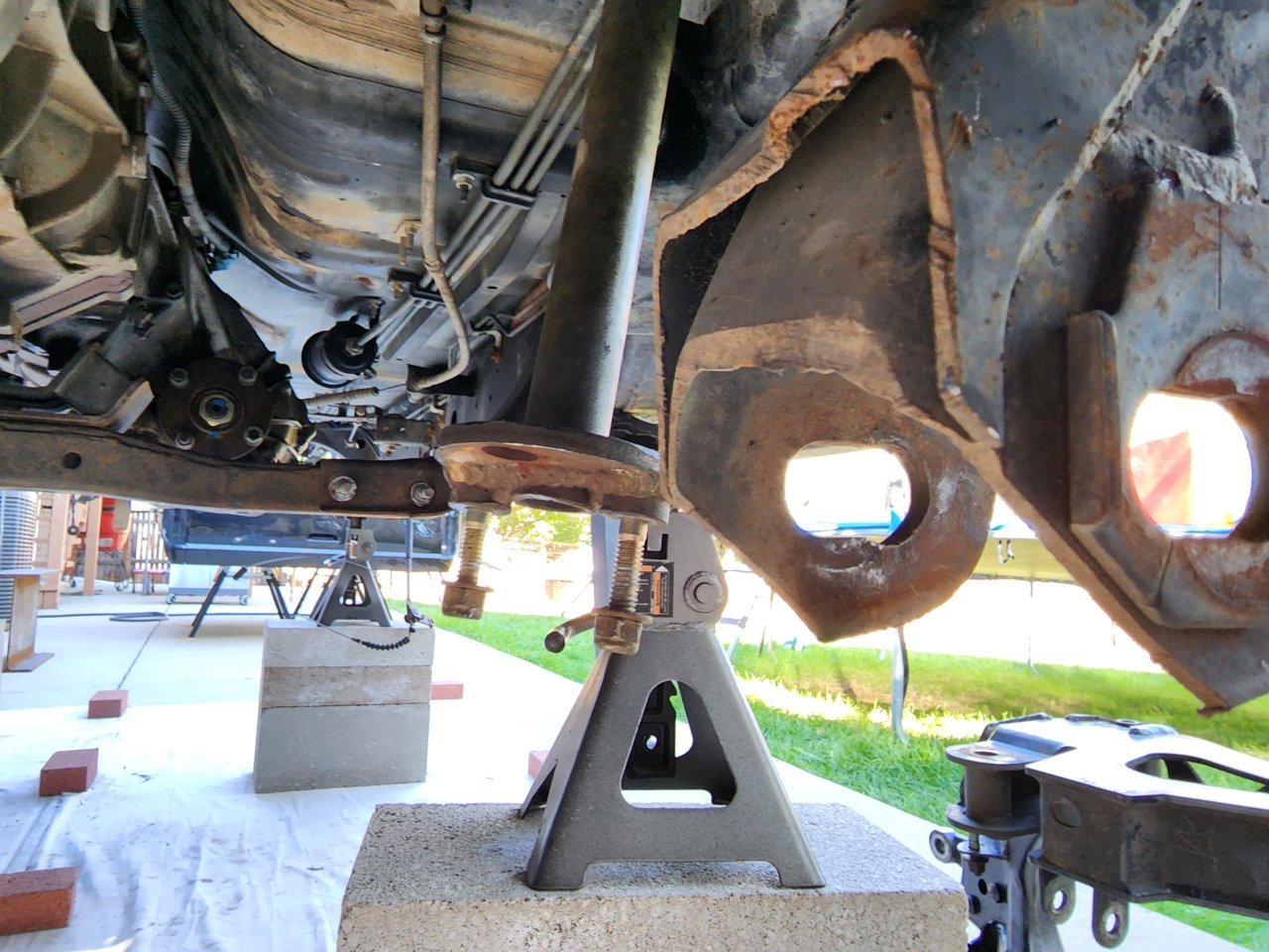

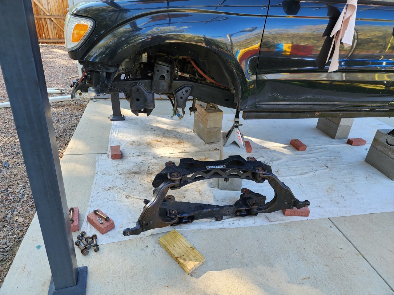

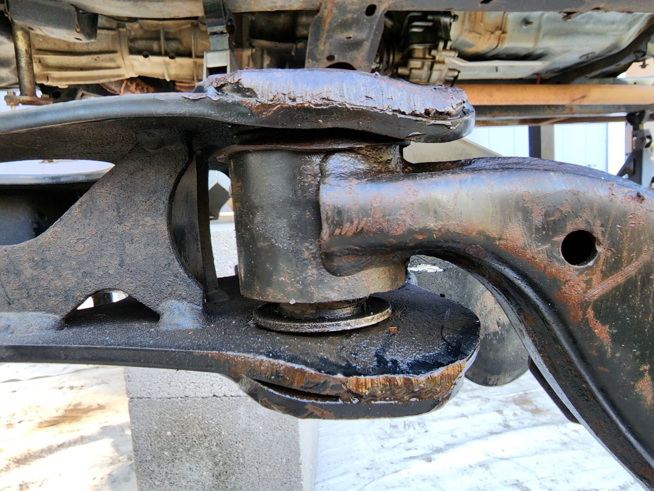

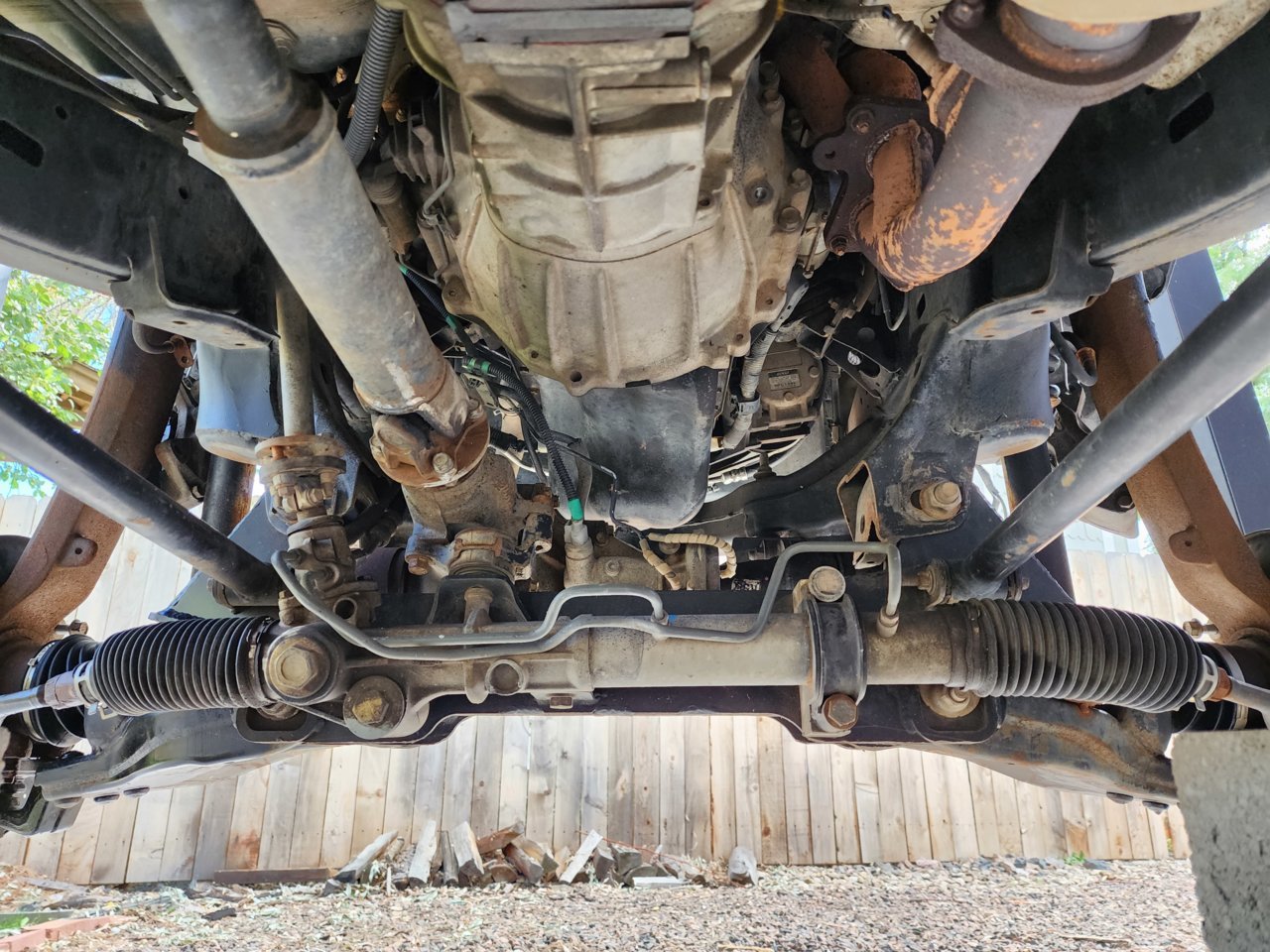

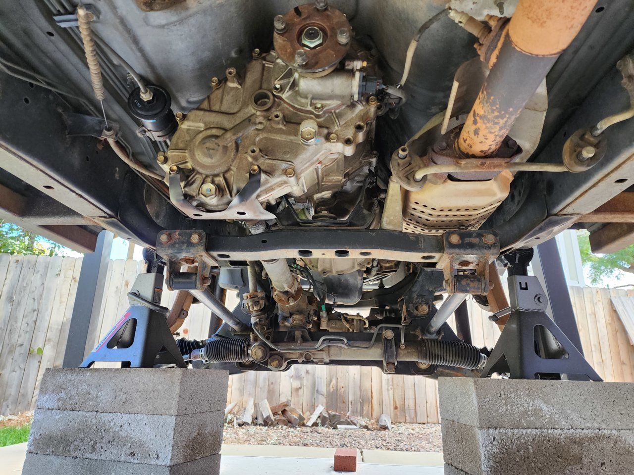

    More progress? ... Feels like I fell down the rabbit hole and I bumped my head... not sure how I got here. :der:
    I got the front end torn down... mostly...

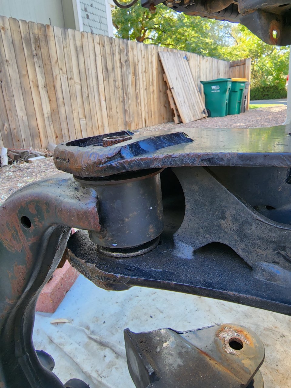

    Still have to free the LCAs from the Fabtech Drop Bracket's grasp. Looks like the bottom of the DB took some pretty hard hits, to the point I am afraid the LCAs could be bent. I am really hoping this is not the issue as I have already destroyed my meager budget many times over. I have had to put a stop to spending for the time being. I have plenty of work to keep me occupied in the mean time.
    This thing was an absolute beast to wrestle out by myself!

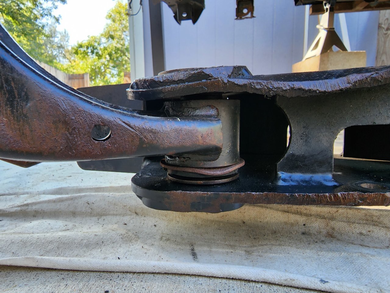

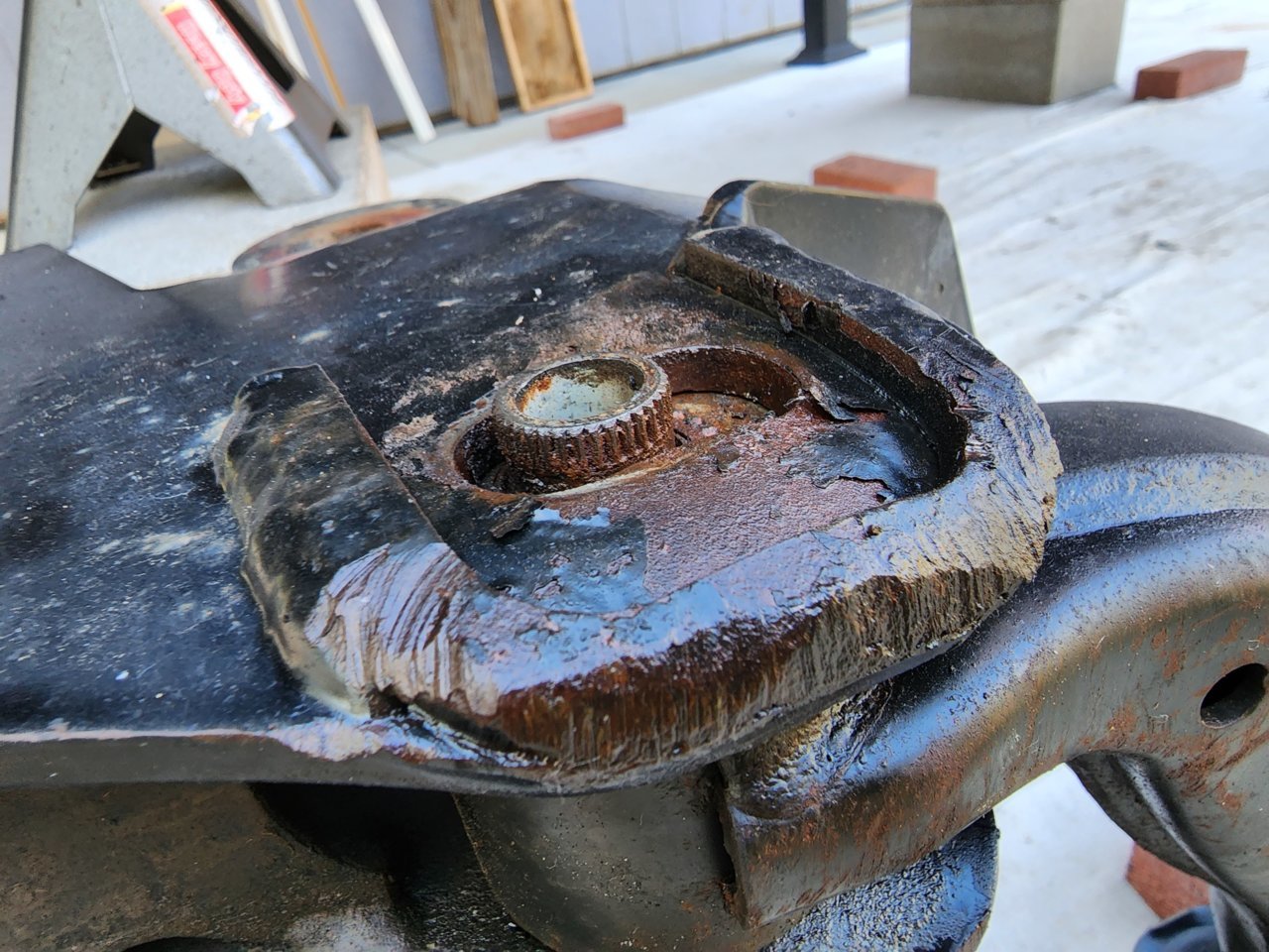

    While the internals look clean and all coated in clean oil, no oil drained out when I pulled the CVs. I also did not lose any oil while wrestling the thing out of its home in the truck. I am a little concerned about the oil level. I also noted a gritty feeling when rotating the CVs while everything was still in place. This will definitely get opened up and inspected before re-installing. The 4wd did function correctly before disassembly.

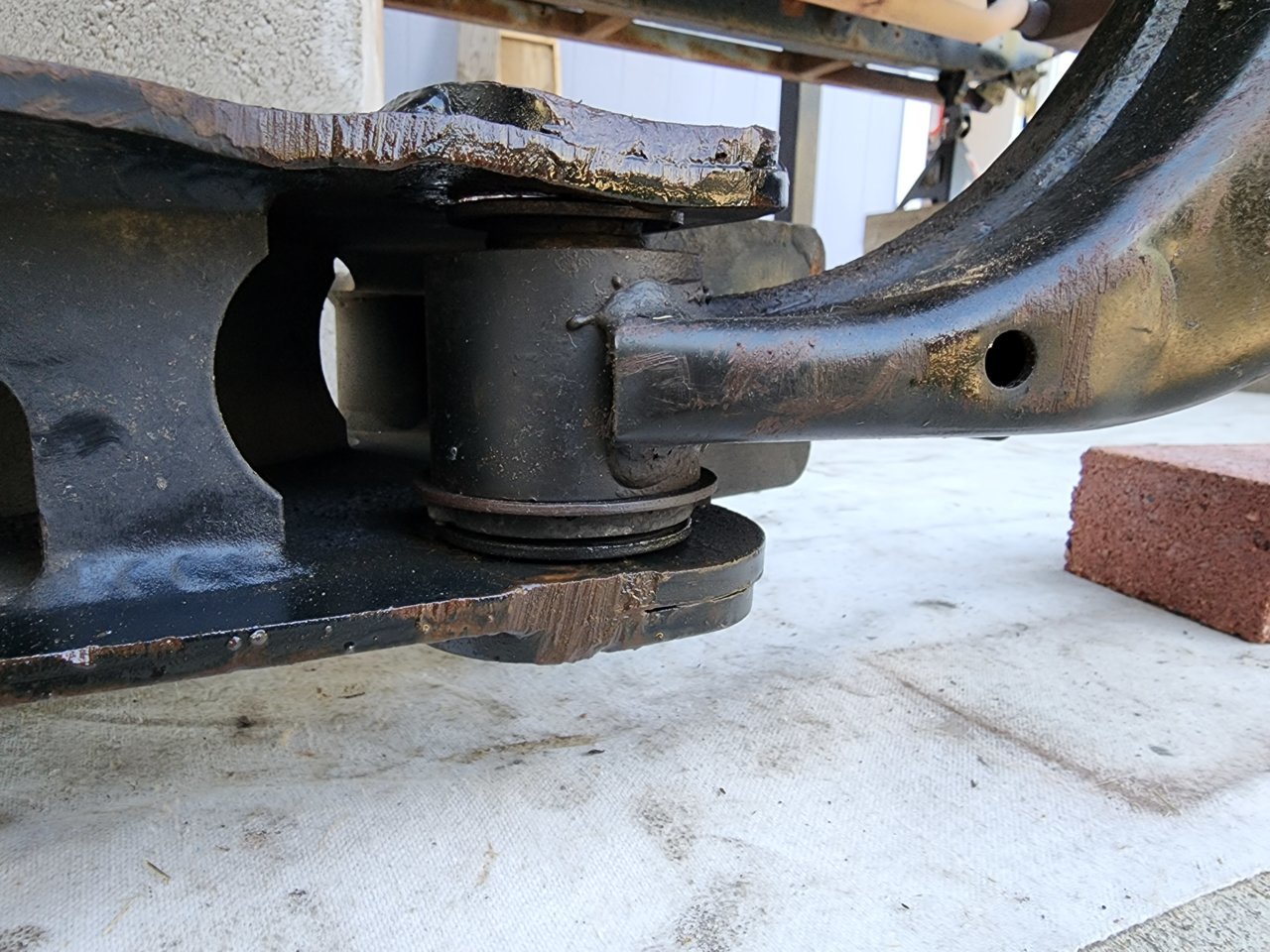

    Here are some shots of the carnage at the LCA DB interface.
    20221009_151231.jpg 20221009_151222.jpg 20221009_151218.jpg 20221009_151206.jpg 20221009_151159.jpg
    I will get all of that straightened out and possibly reinforced before re-installing it on the truck. I have a pretty good idea for reinforcing the DB connection to the truck and increasing ground clearance as well as protecting the underside of the front end. Y'all will have to stay tuned for more on that.
    A couple of shots of the carnage done by the DB installer.
