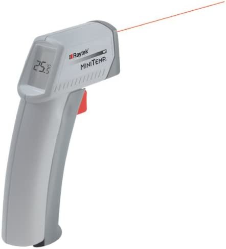

    You can pick up the little infrared temp guns pretty for reasonable money. When the gauge reads normal pick a few locations like the top and bottom rad hoses and the heater or bypass hoses and note the temperature.
    Check your benchmark spots a few times for a consistent average. Next time the gauge spikes jump out and check your benchmark points.
    BTW, shiny surfaces don't give accurate temperatures, the black hoses will be more accurate.
