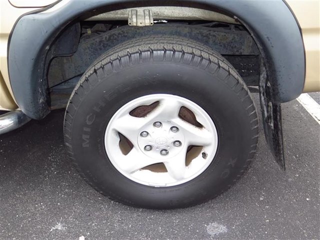

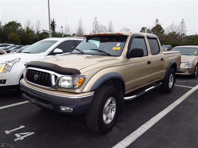

    Hello, I am new to this forum. In an effort to wipe out car payments I am looking at getting rid of my current vehicle. The main replacement that I am looking at is a 2001 Taco Double cab V6 w/auto trans. The truck has about 65k miles and clean car fax. Also according to car fax the vehicle has been registered in Florida the whole time. From browsing these forums it seems like frame rust is the biggest issue to look out for. I have not checked the frame out yet. This car is being purchased through a dealer so it is just now going through their inspection. I am thinking I should be able to get another 150k miles out of this thing. What other pitfalls should I be looking for if any? I would imagine any 14 year old vehicle is going to have some surface rust on the underside. Here are some quick pics:

    That's a low mile Tacoma so as long as the frame is solid, you shouldn't have too many issues.
    1. Timing Belt and Water Pump due around 90k miles. Sometimes sooner due to a water pump leak.
    2. Wheel bearings on these trucks are not the greatest.
    As long as it's been well cared for and it's solid, they are pretty reliable. If you don't know the maintenance history, then performing a semi-major service to exchange all fluids wouldn't be a bad idea. Run a can of BG 44k through the fuel system as well. Get the brakes inspected as well. Otherwise, drive it.
    Good luck!

    Yeah not much than what's been stated already. It shouldn't have any serious rust for being in FL, reliable to the core.
