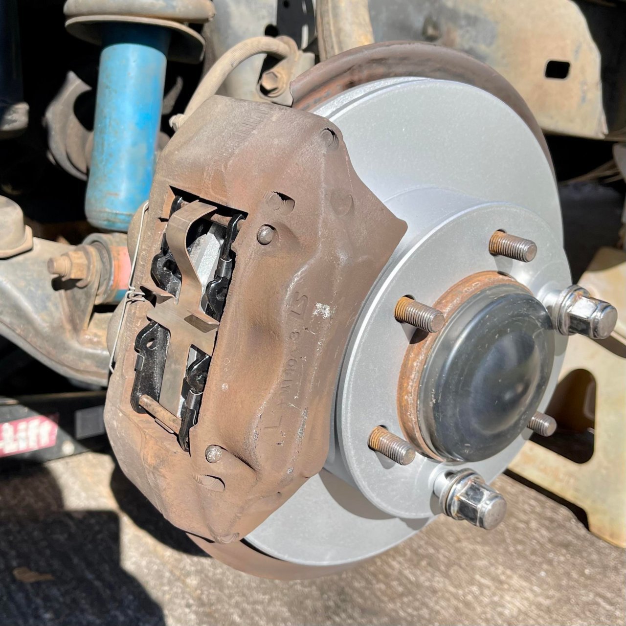

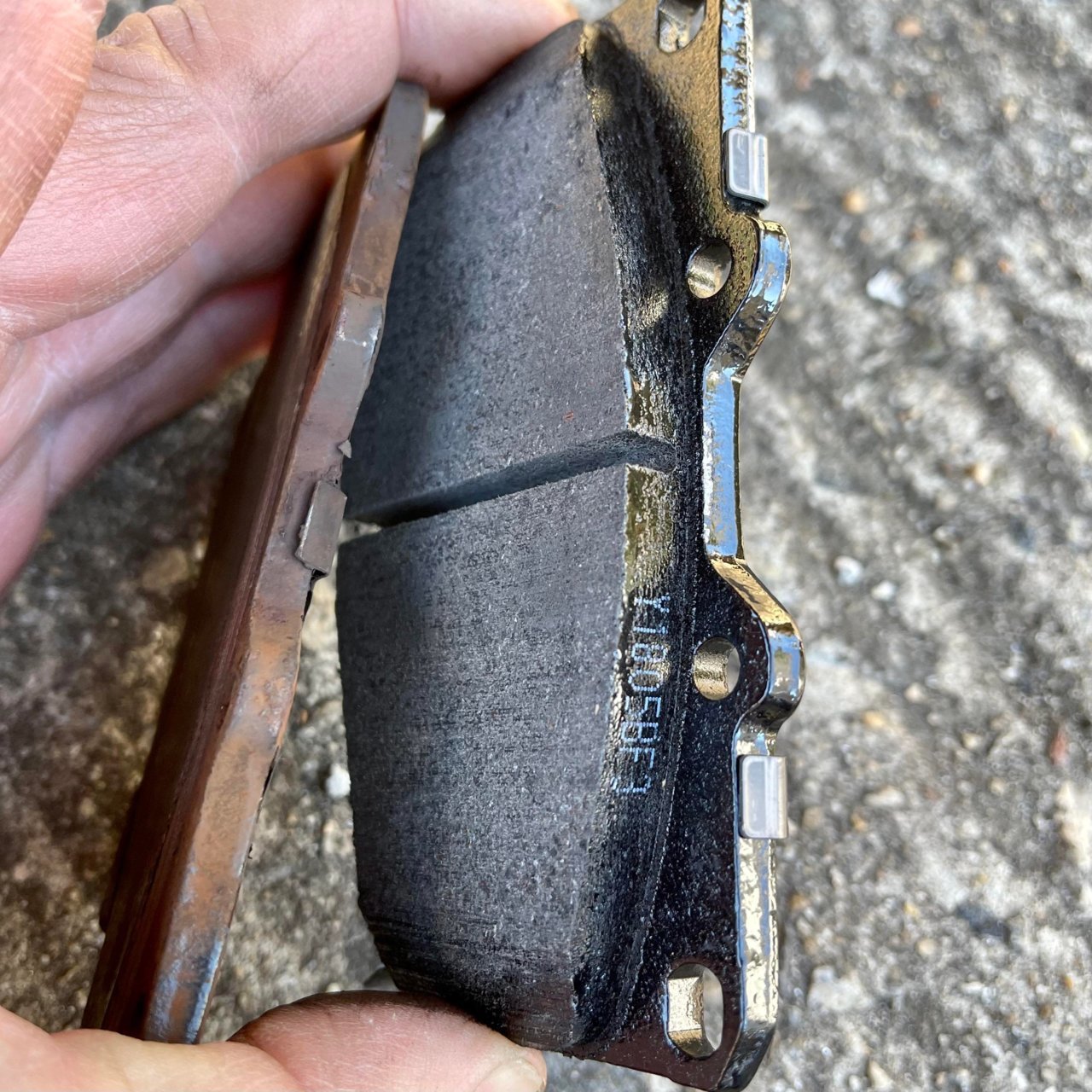

    New Brake Pads: 5-1-2019 225,000 miles
    Front Rotors Turned: 5-1-2019

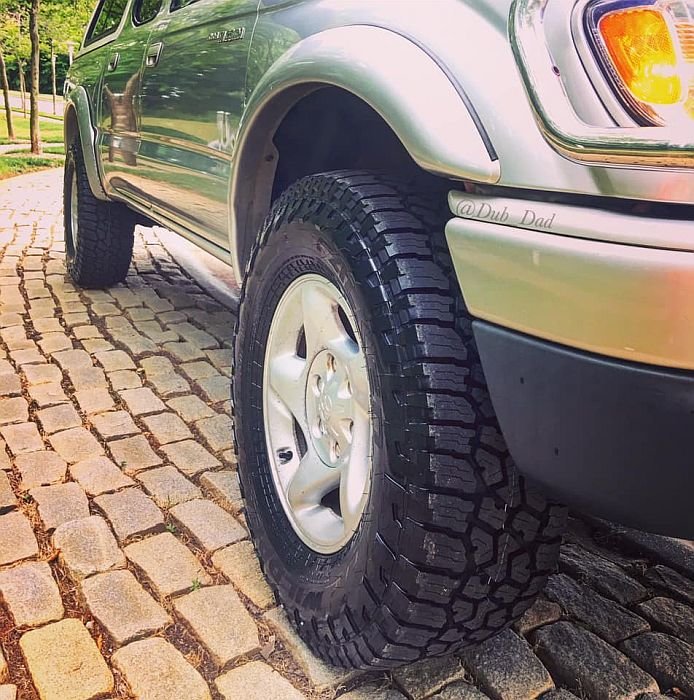

    NEW TIRES:
    6-4-2019: 227,400 miles
    Falken Wildpeak AT3W ( 265 70R/16 )
    from Greer Tire ( Greer SC )

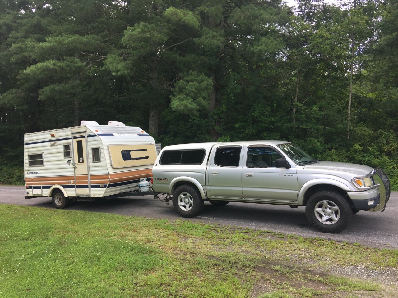

    Picked up this 1982 Coachmen Travel Trailer to have a little more fun.
    Pulls great!

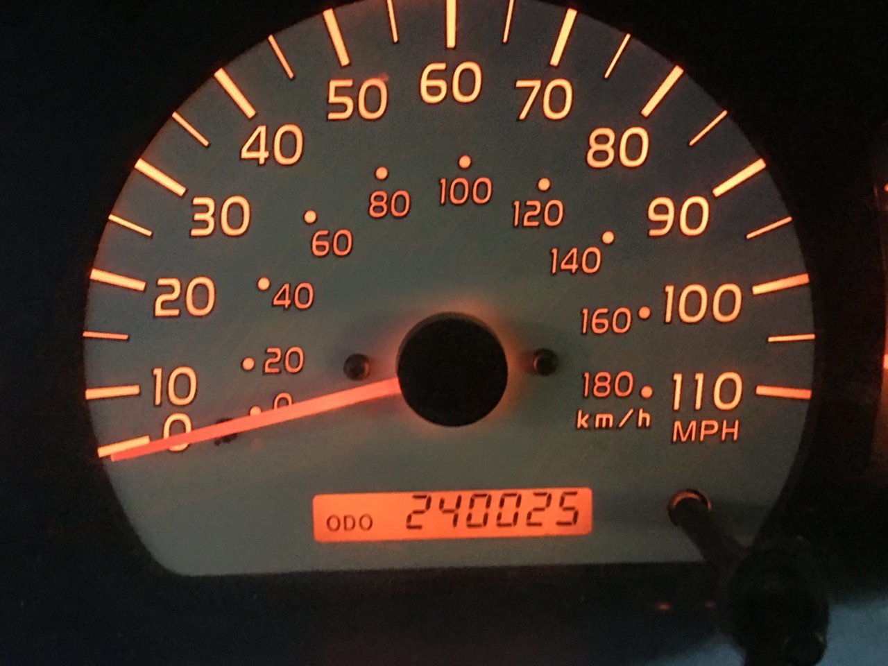

    Passed the 240000 mark today!
    No issues to report.

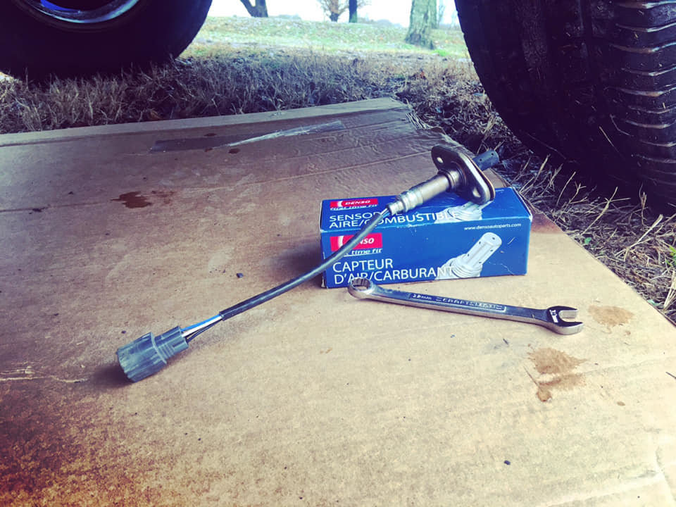

    Been having issues with truck stalling, just dies while accelerating. CEL code P0100 ( MAF sensor )
    I changed this out 12/18 with Denso brand, cleaned out MAF sensor and thought that did the trick... but it stalled out 2 days later.

    Ended up replacing MAF sensor, seemed to fix the issue of stalling.

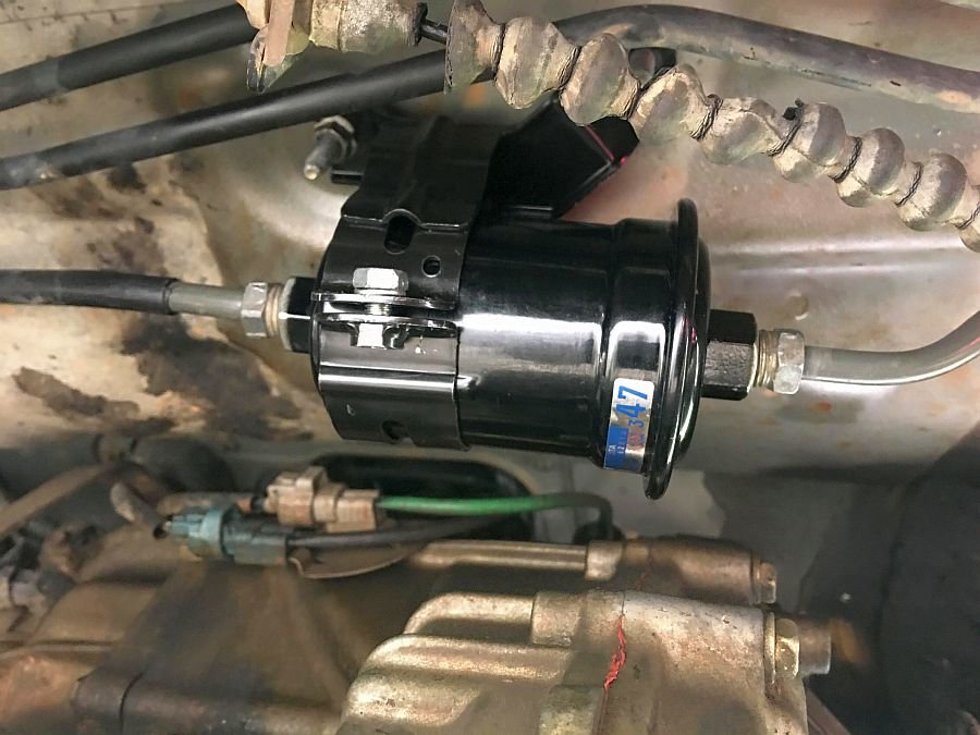

    UPDATE:

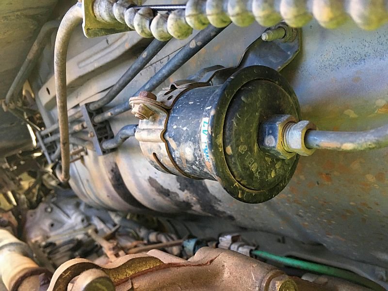

    7-6: 249,285 miles
    Changed out fuel filter. other one didn't look bad, until I took it off and fuel that emptied from it was nasty and dark color.
    not to bad of a job, front line fitting was a little sized but sprayed it with penetrating oil and let it sit for a bit and then it finally released.
    no leaks after installed, so good to go.
    These are supposed to be changed out every 25,000 miles.

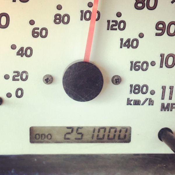

    8-14-2020
    Turned 251,000 miles and all is well!

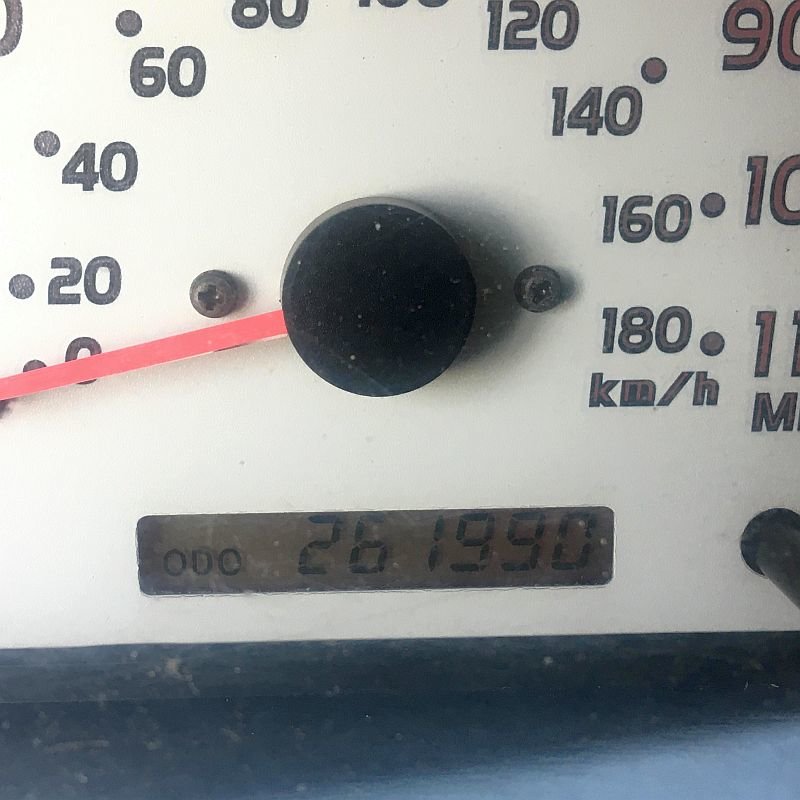

    Maintenance Time!
    02-17-21 : 261990
    Oil and Filter Change ( 5738 miles )
    seemed like it was raining every chance I got to change it. finally done today.
    * Note: 34,590 miles on tires since purchase.

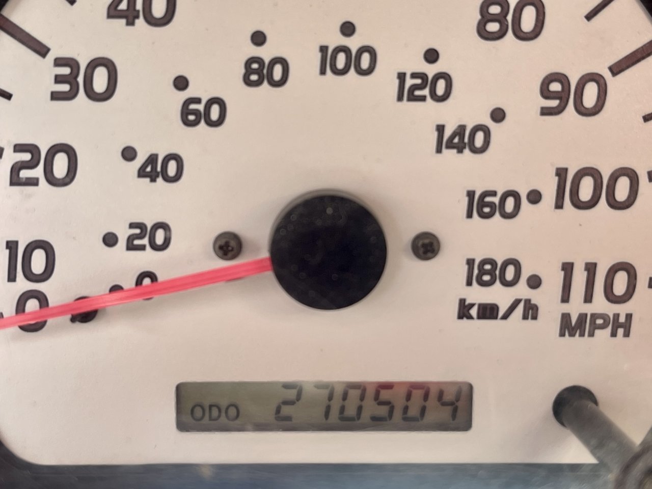

    05-22-21: 266570
    Oil and Filter Change ( 4580 miles )
    08-09-21: 270504
    Oil and Filter Change ( 3934 miles )
    * Note: 43,104 miles on tires since purchase.

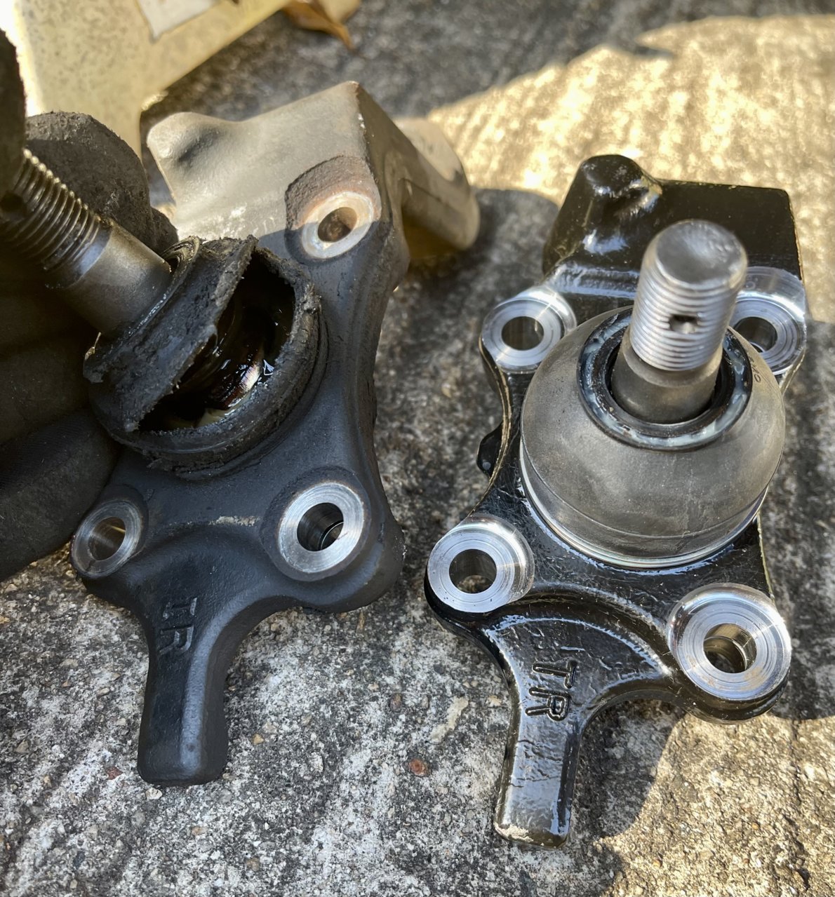

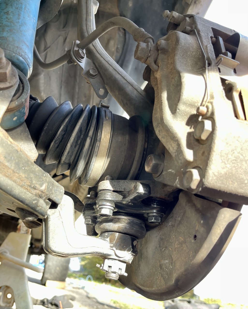

    11-21-2021

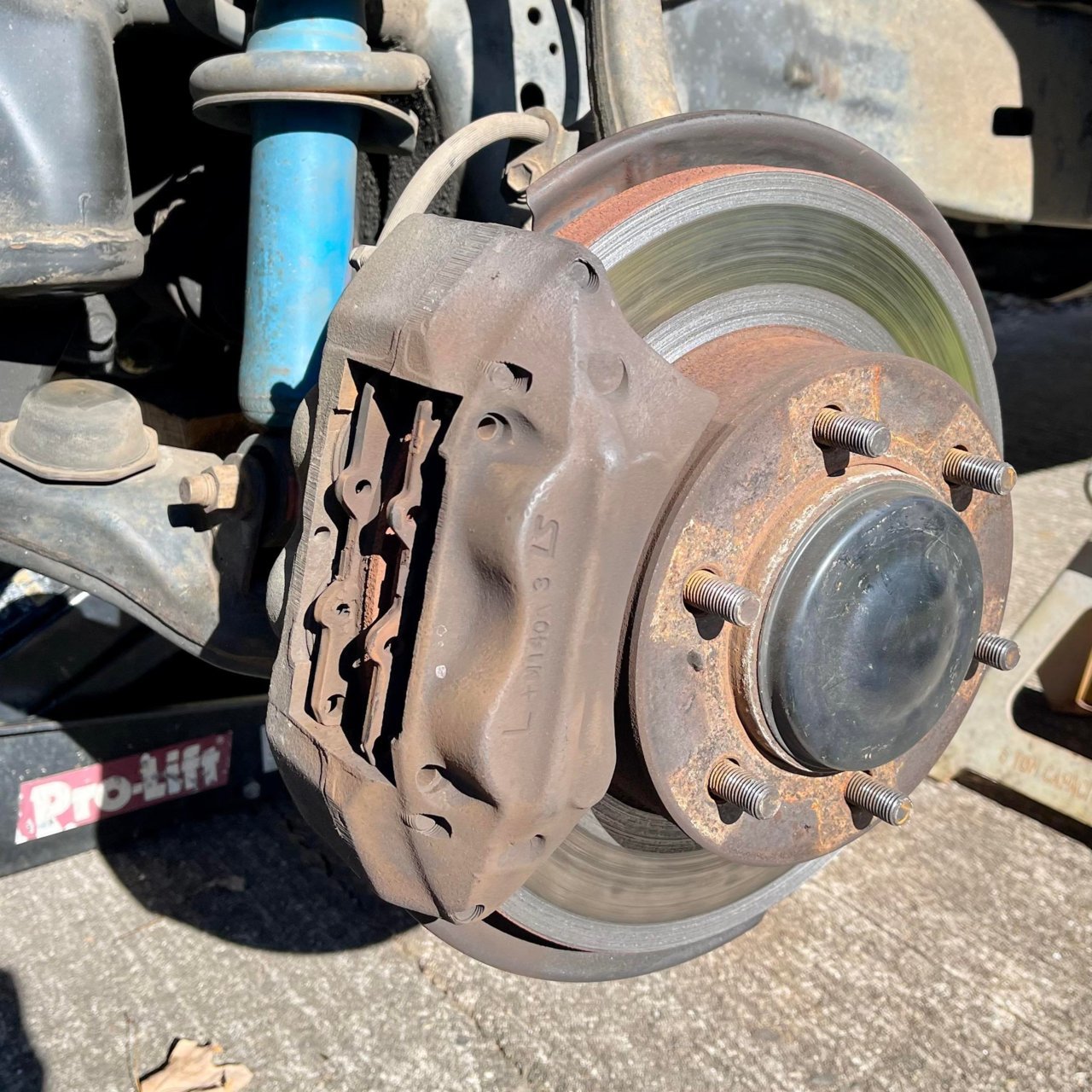

    Lower Ball Joint replacement OEM Toyota ( 04005-03235 )
    kit came with Left and Right LBJ, 2 new castle nuts, 8 bolts w/ washers and New Cotter Pins
    * reused outer tie rod castle nut.
    Boots were torn, only a matter of time before LBJ failure
    Torque Specs:
    14mm bolt/washer are 37 ft/lb ; ( if you have flange bolts 59 ft/lb )
    Ball Joing Castle Nut 105 ft/lb
    tie rod castle nut 67 ft/lb
    LUG Nuts 83 ft/lb
