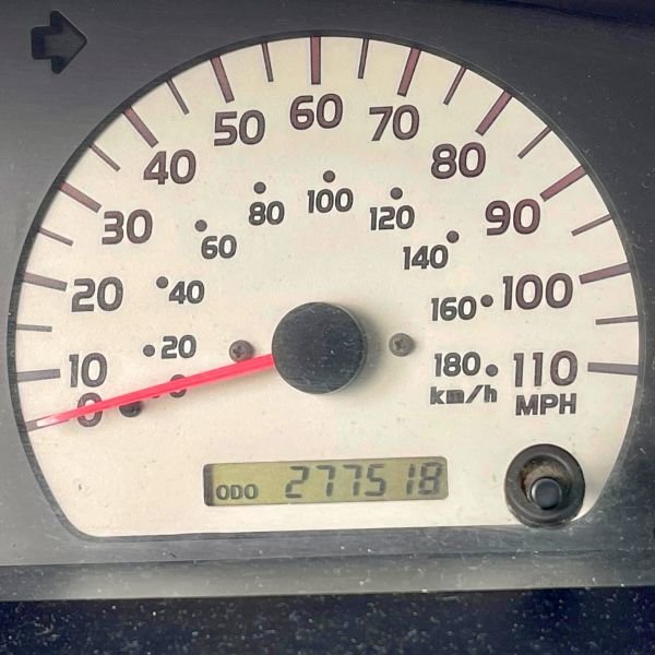

    Fuel Filter Change:
    1-25-202: 277,518 miles
    ( 28.233 since last ) * should be done every 25k miles

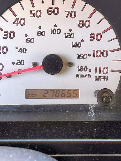

    Update:
    03-01-22: 278655
    Oil and Filter Change ( 4368 miles )
    * Note: 1,222 miles on tires since purchase.

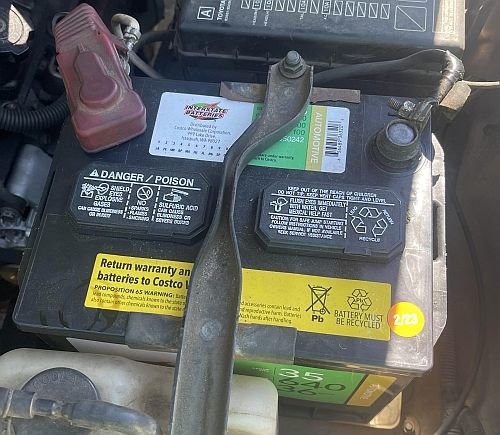

    Alternator went out, replaced with:
    NAPA REMAN/ALTERNATOR Part #: RAY 2139147
    Kept Original Toyota OEM and will replace brushes and keep for backup incase NAPA fails.

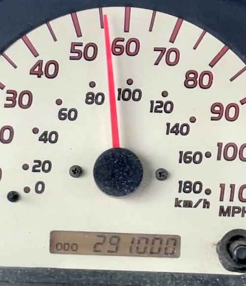

    Hit 291,000 Miles on 1-25-2023 All is good!

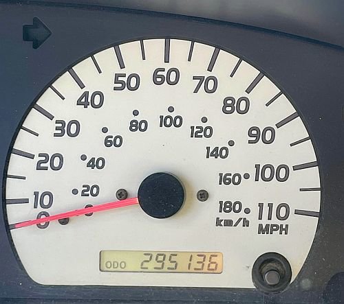

    Oil / Filter Change: 4-10-2023 295,136 miles * changed myself * ( 6001 miles )
    * Note: 17,703 miles on tires since purchase.
    * Tire rotation done.

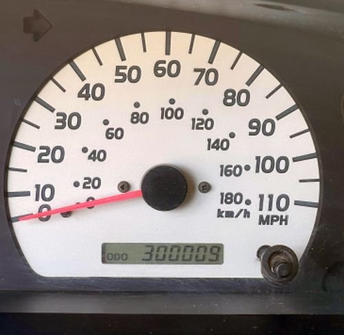

    8-16-2023
    Hit 300,000 miles today.
    Time for an oil change and filter.

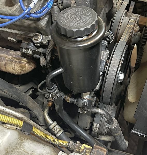

    Power Steering pump w/ pulley replaced, still hearing a whine when I accelerate.
    will be looking at Idler Pulley and replace bearing, also will be checking at AC compressor.

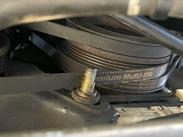

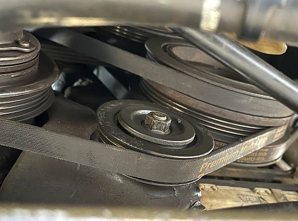

    Update:
    12-20-23: 304,312

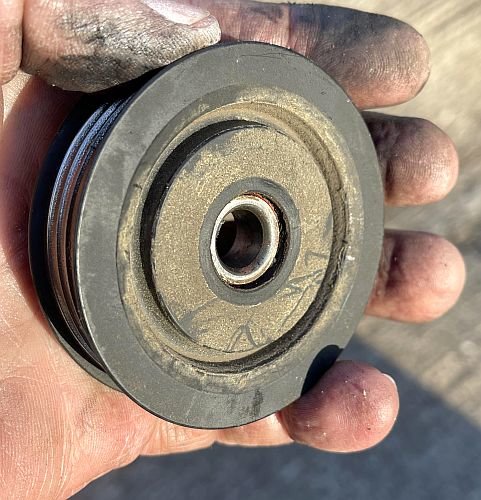

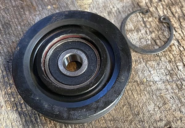

    Finally got to the idler pulley, changed out the bearing ( 6301-2RS Bearing ) keeping the OE pulley.
    removed C clip, then tapped the bearing out, Cleaned and put some grease along the inner area,
    then tapped the bearing back in with a socket that fit the outter edge.
    * 14mm socket to loosen the nut, then adjust the belt tension, slip belt over, remove nut, washer and pulley.
    Backside of pulley once removed.
    C-clip removed, new bearing in.
    back on and a lot quieter. ( new belts will be coming when I do Timing belt maitenance )
    Overall a very simple job, about 30 min
    ( just remember to remove that C-clip, before beating the bearing out.
    it may be buried in grease and grime, be sure to put it back too. )
