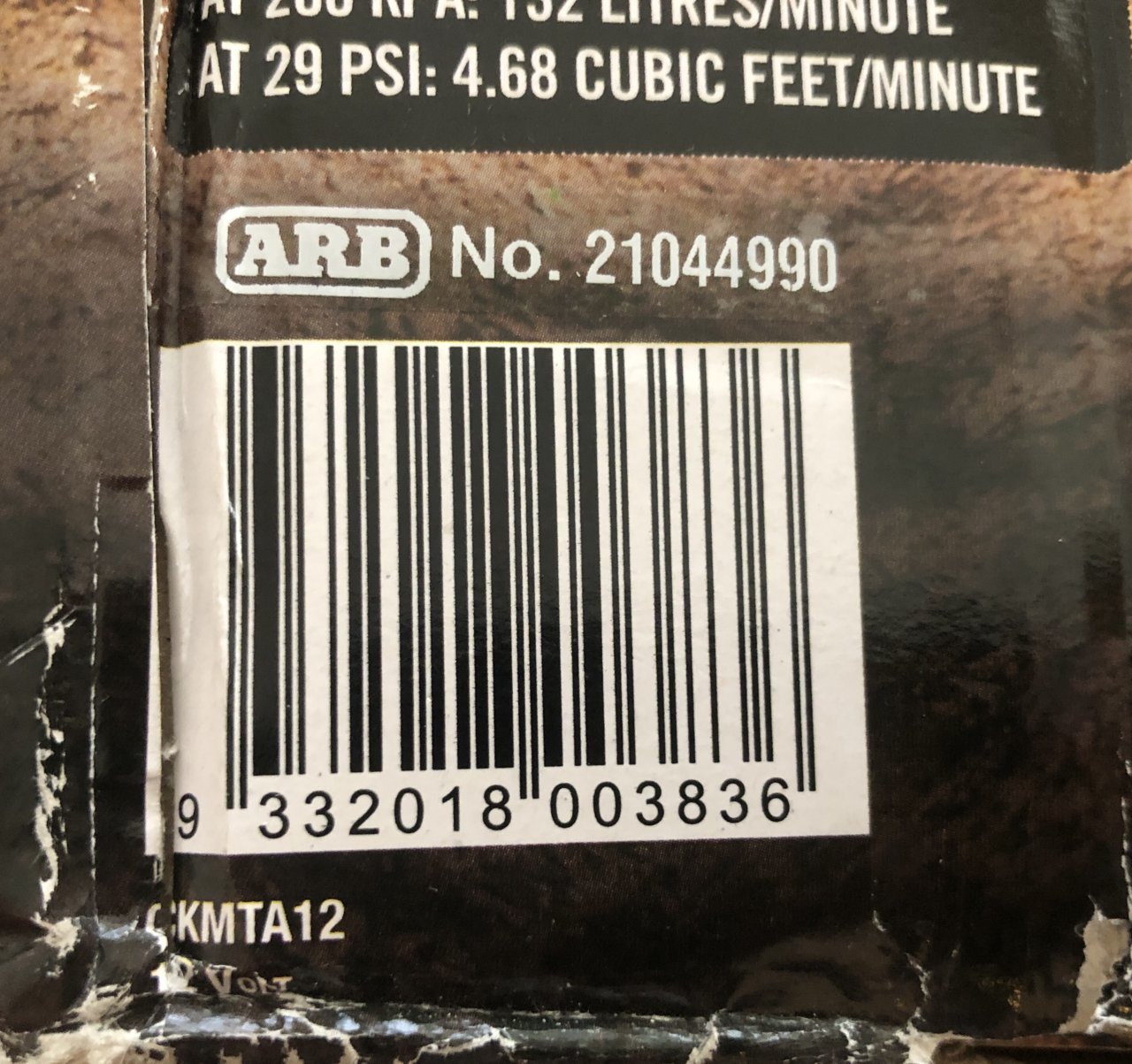

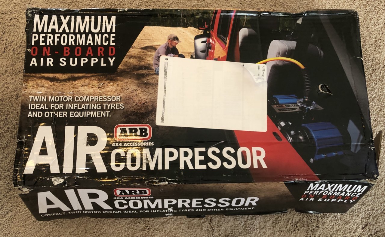

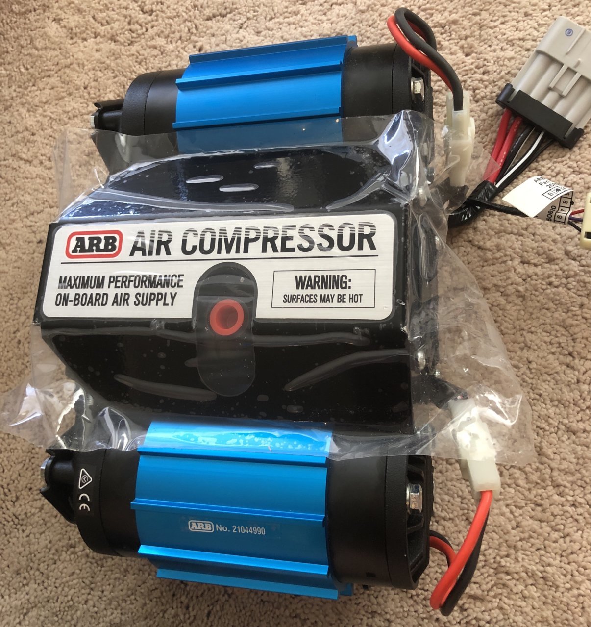

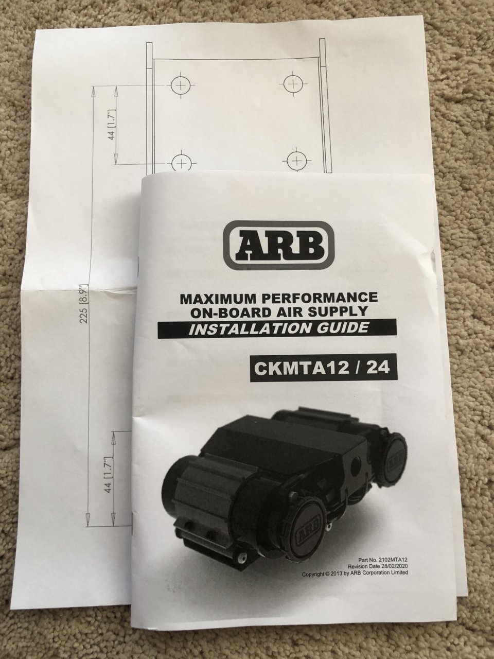

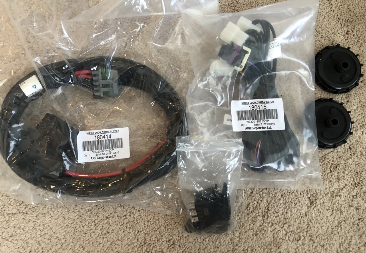

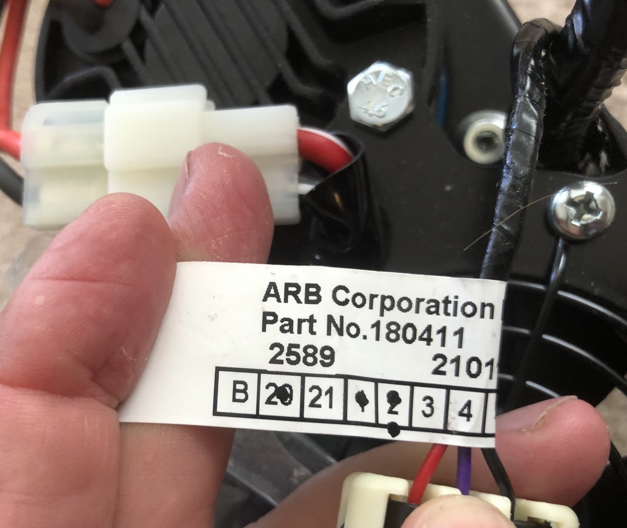

    First, I just got an ARB Twin compressor (plan to add lockers), but cannot tell if I received the right product or not, specifically is my unit 24V or 12 V. I need 12 of course, but cannot find any indication on the unit of what it is. There is a sticker stating "ARB No 21044990" which does not come up on the Arbusa.com website. The carton does say in the CKMTA12 but how can I register the unit if I cannot find it's serial number?
    Any advice/opinion greatly appreciated.
    Here are some pics of the compressor. The carton is really beat up.

  4. Aug 15, 2021 at 4:00 PM
    koenbro
    koenbro [OP] Well-Known Member
    Feb 7, 2017
    #209951
    264
    Phoenix, AZ
    2001 Tacoma SR5 Xtended cab 3.4L 5Spd
    Thank you.
    Isn’t it strange that it doesn’t have a factory sticker with model number, serial, etc?
  5. Aug 15, 2021 at 4:02 PM
    YotainOregon
    YotainOregon Well-Known Member
    Aug 9, 2020
    #337102
    196
    Steve
    Oregon
    1st gen Tacoma TrD
    @koenbro The model number is right under the SKU on the box you should have a serial number on a stamped plate on the unit somewhere

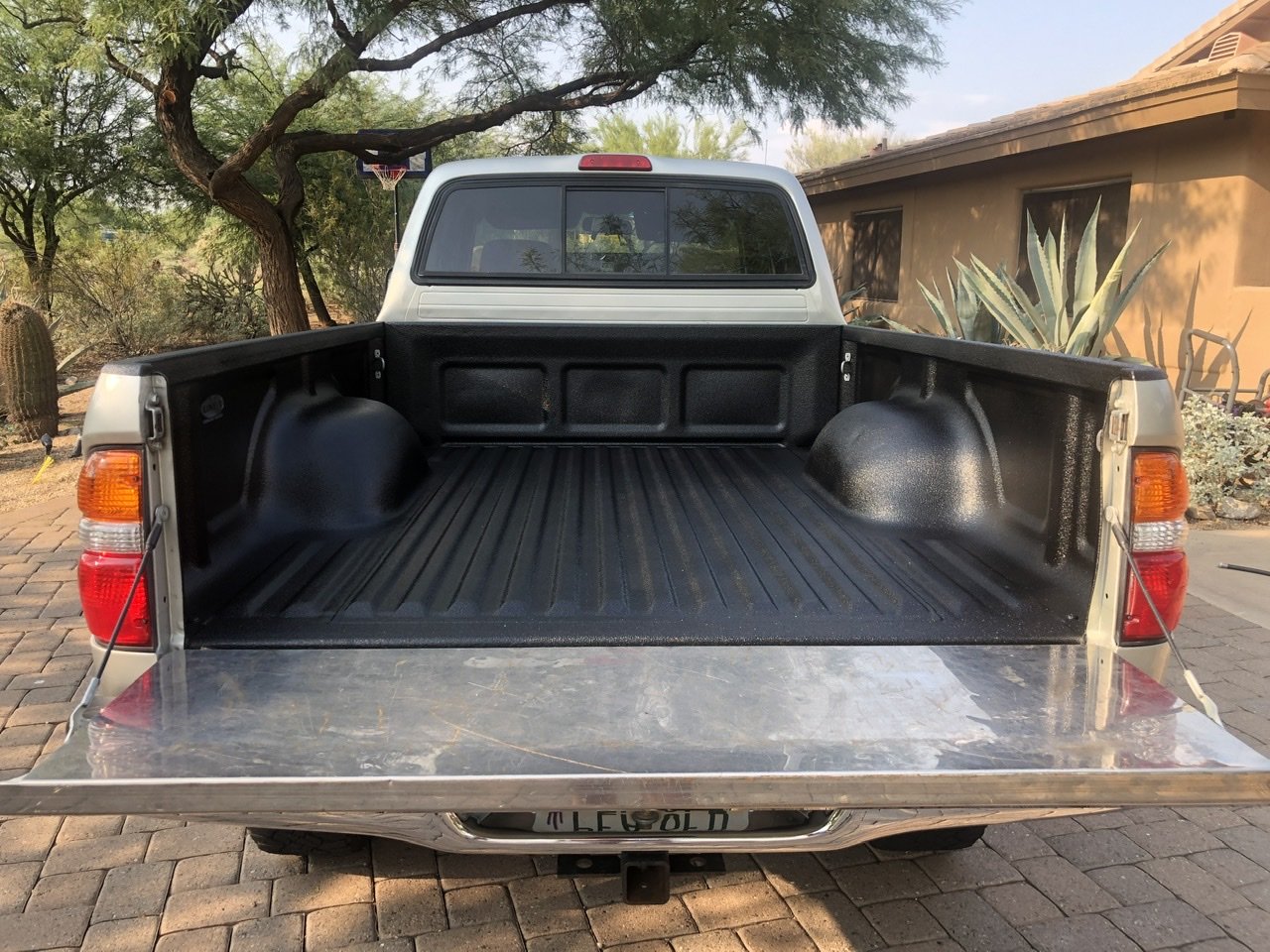

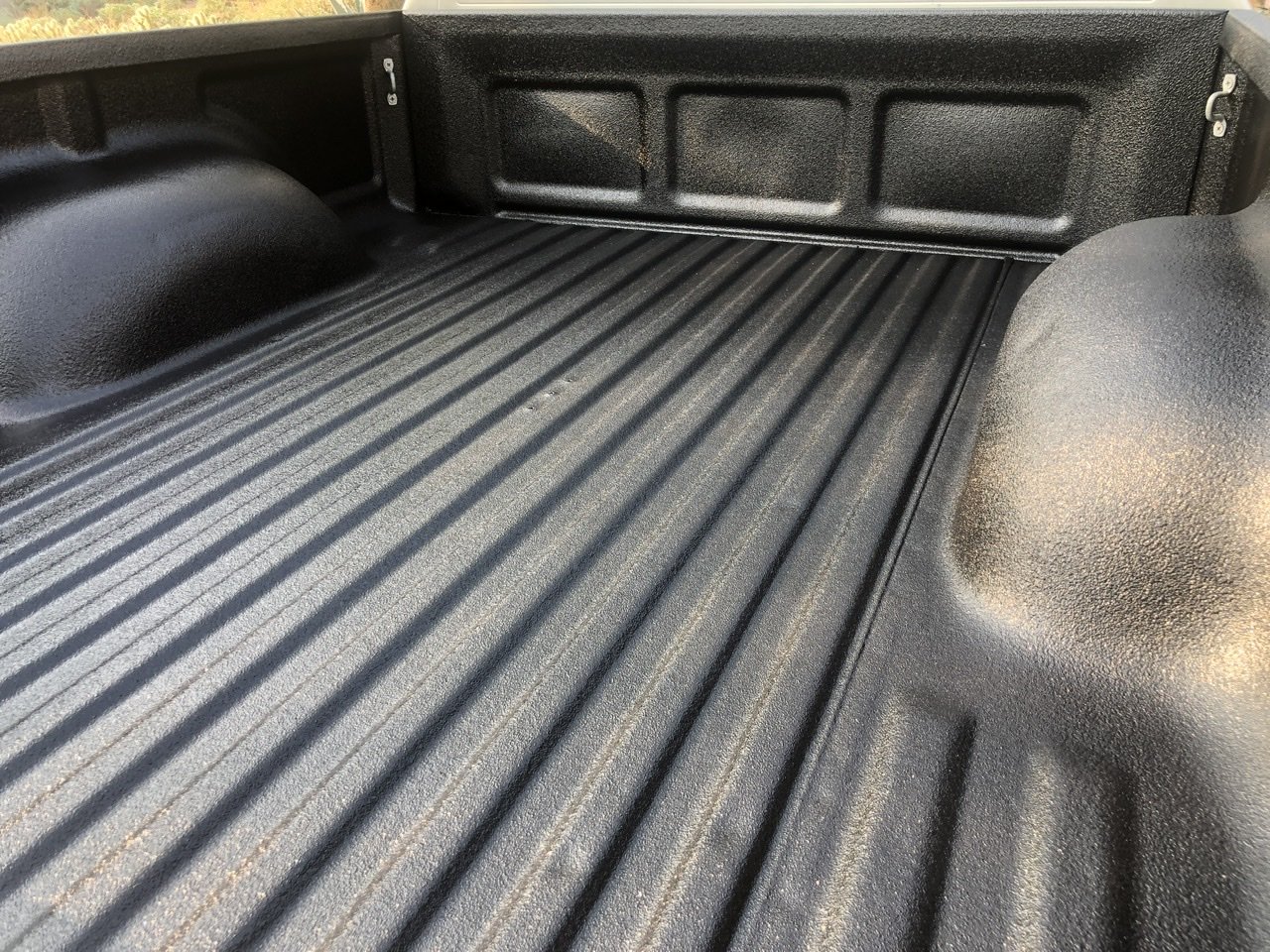

    Today I had the bed sprayed with Line-X.

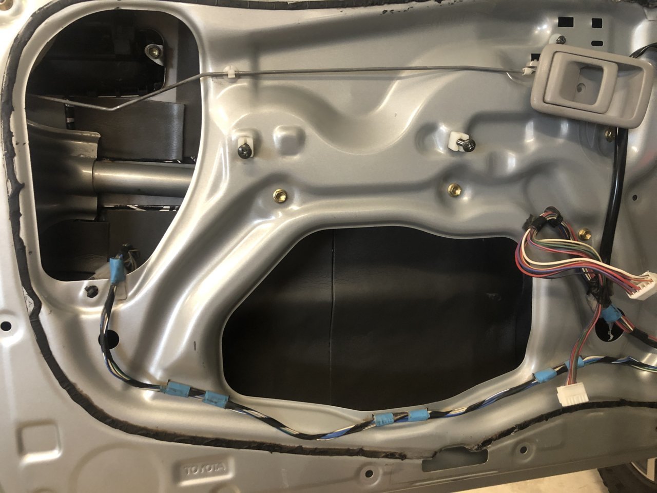

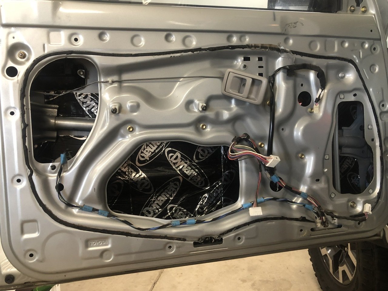

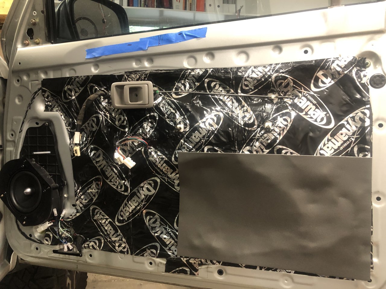

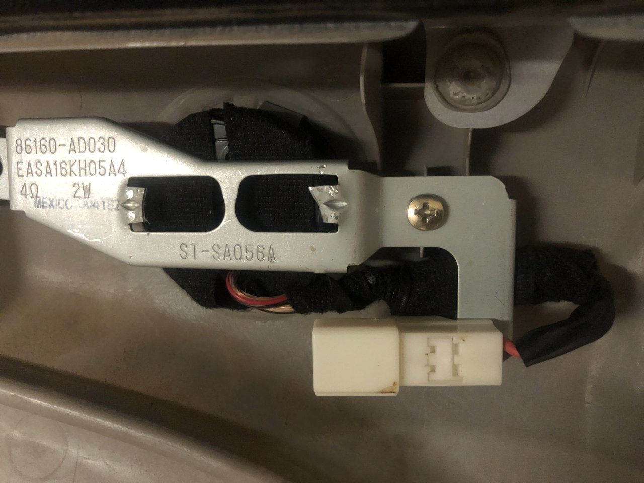

    Also finished the right door then tackled the driver’s door, which went MUCH faster. After lining the outer wall with Dynamat plus foam, did the same with the inner wall. Also replaced the speakers.

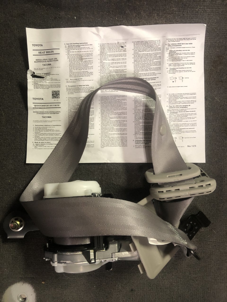

    Finally I went to the dealership and picked up a new driver’s safety belt.

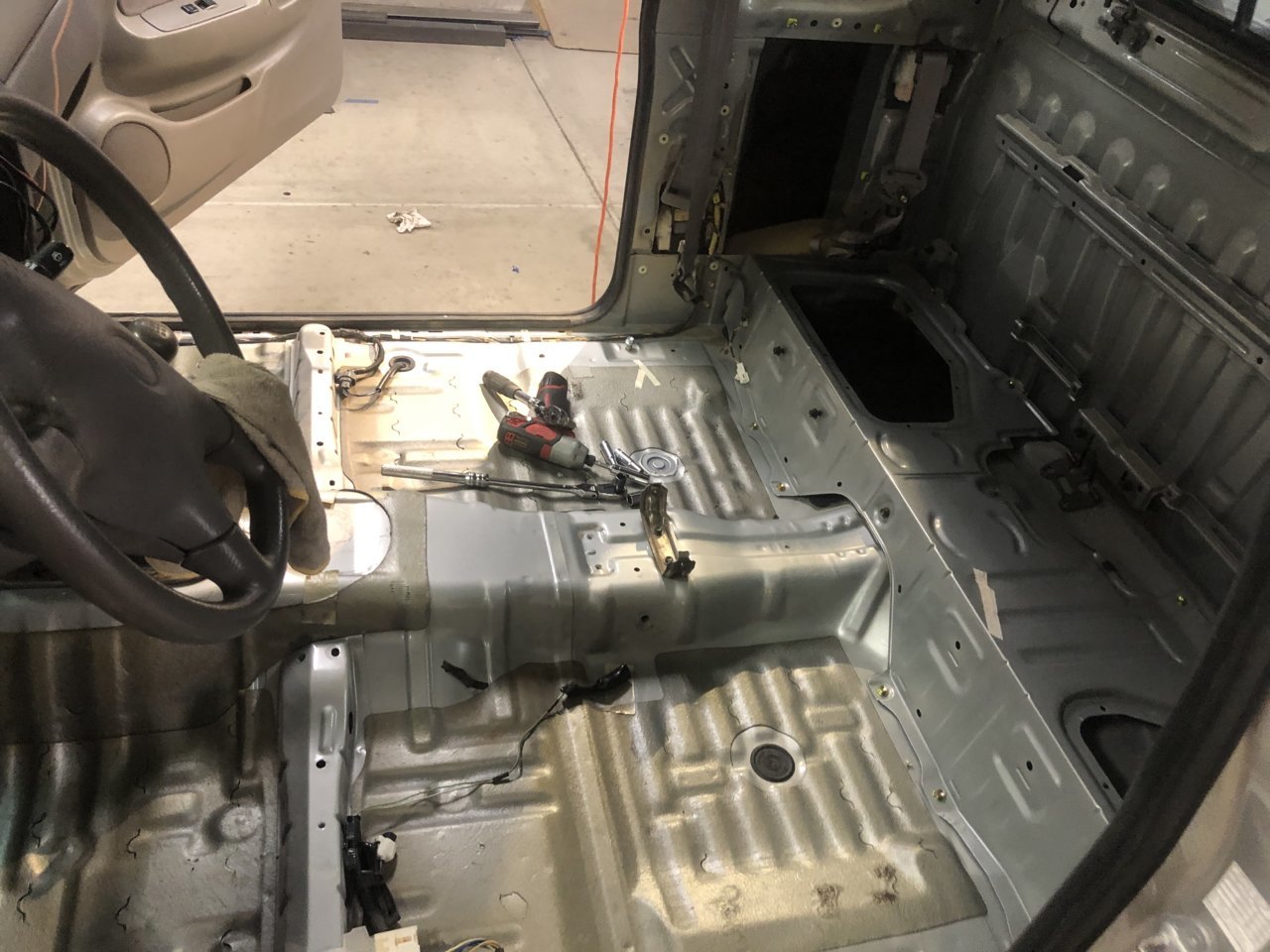

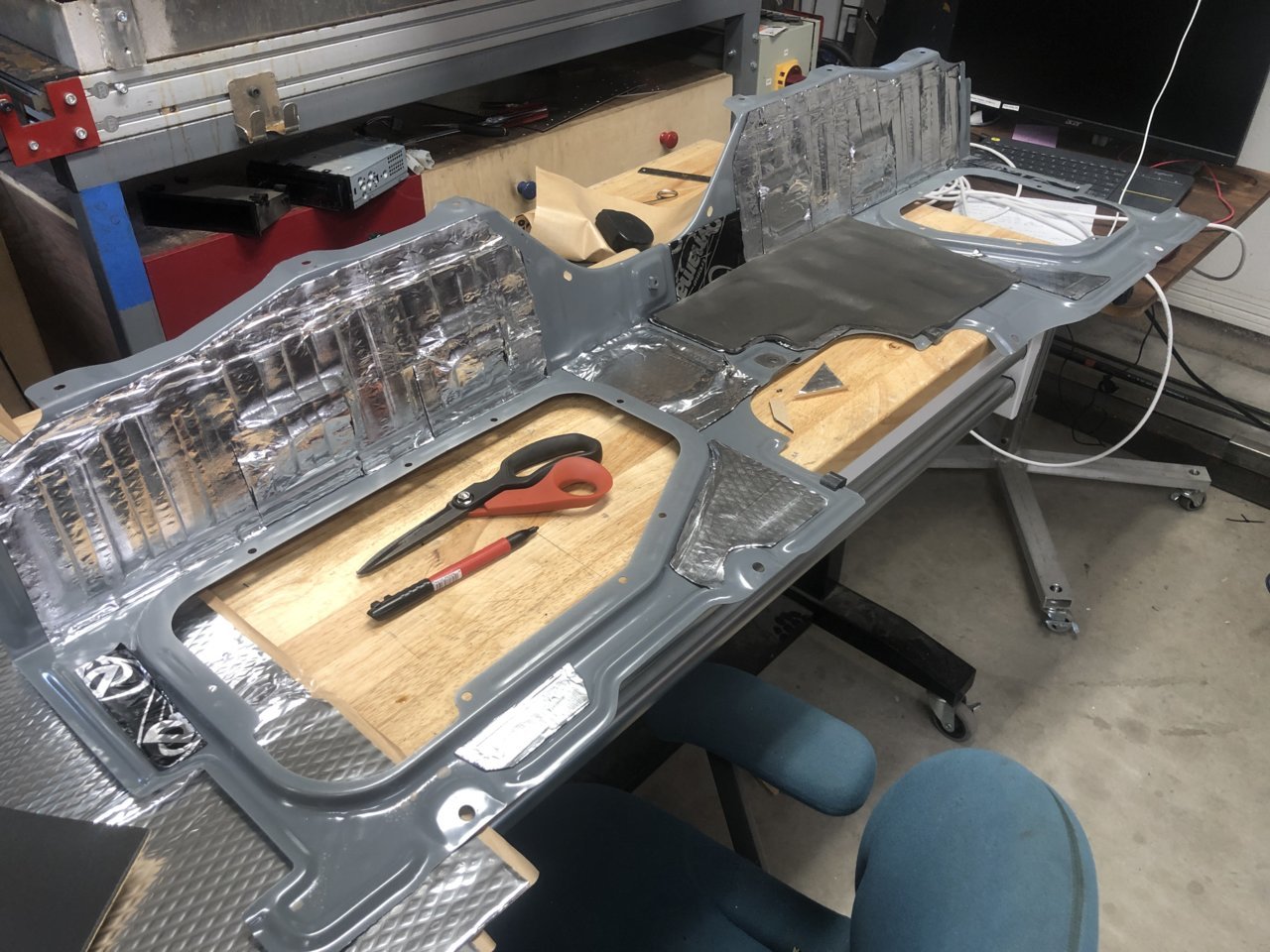

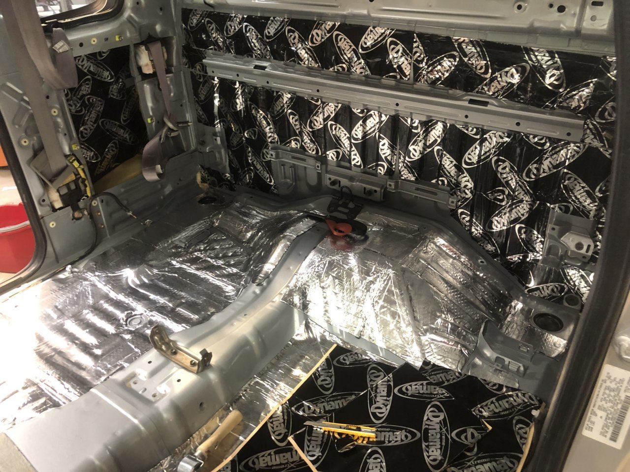

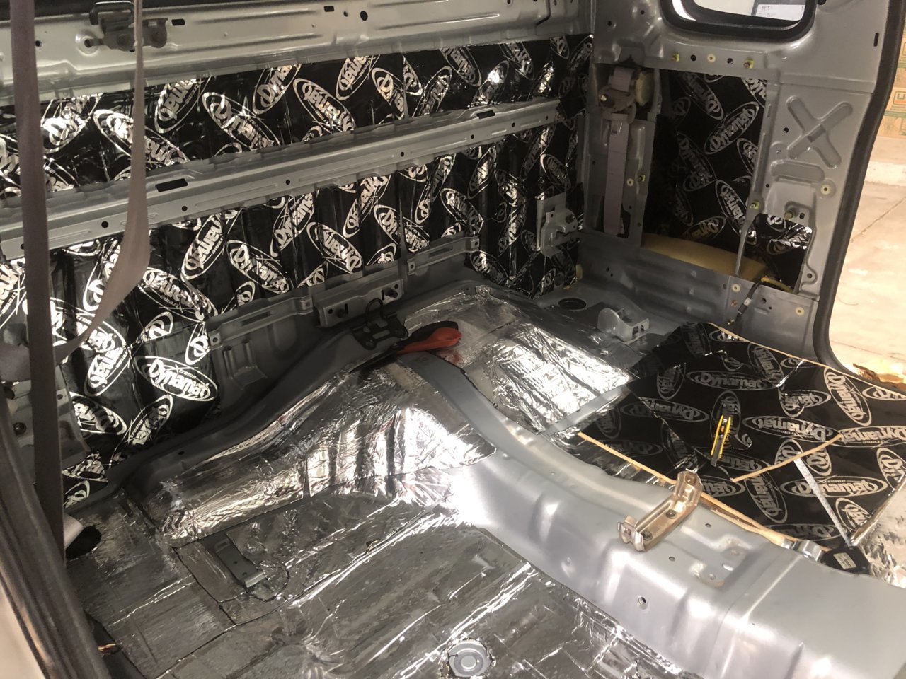

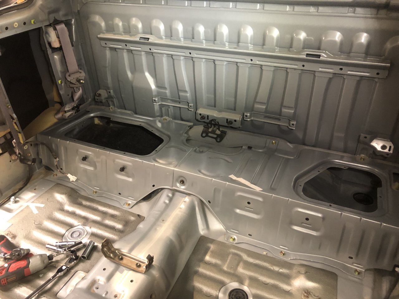

    Today I removed the back panel, side panels, and ripped the carpet out. I even removed the sheet metal shelves that support the rear seats. Cleaned it all out. For a 20 year-old, this truck is super CLEAN. Then I proceeeded to lay Dynamat and Noico everywhere. Finally I laid foam on the back panel.

    Removing the interior was quite easy following various writeups from TW and elsewhere. Covering everything was quite time consuming because of the contoured surfaces, and the need to reveal screw holes and wire access grommets. Lots of measuring, matching, cutting.

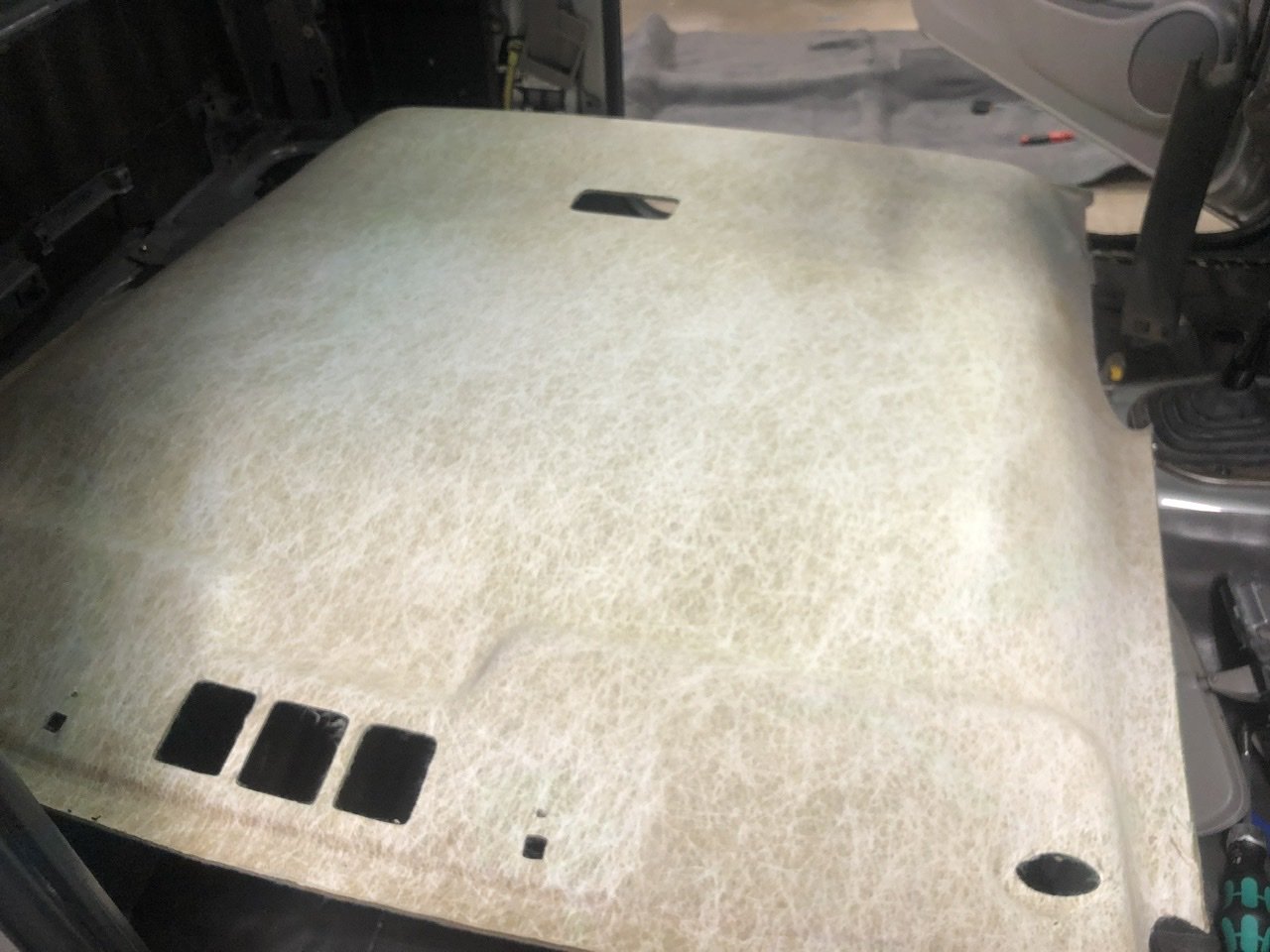

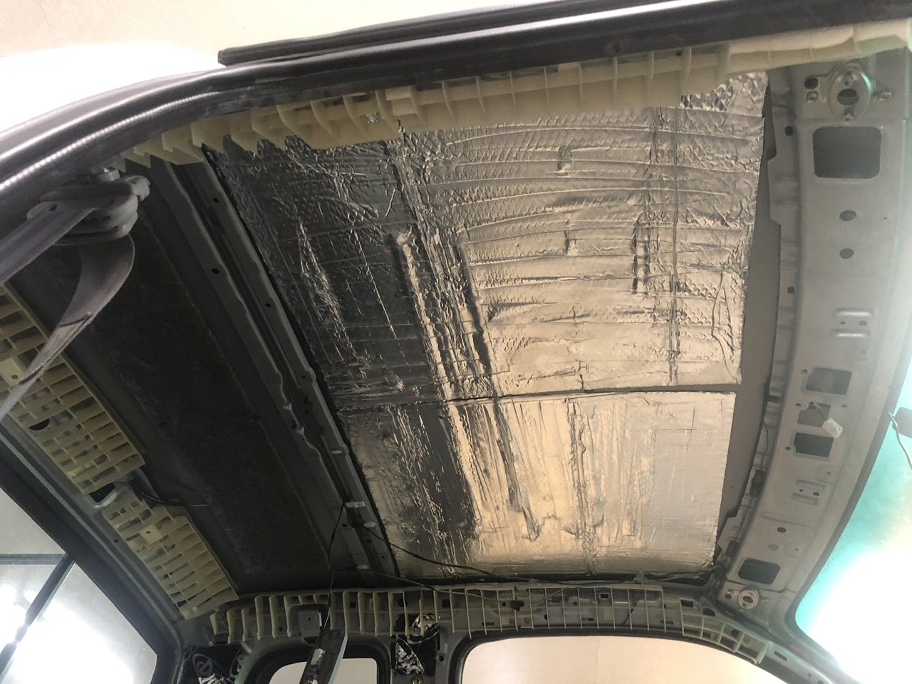

    I dreaded removing the headliner, because I have never done it on any car, and was convinced I will not be able to put it back the same way, thinkning it's soft and needs tensioning somehow. As I finished the floor and walls, I had a few sheets of Dynamat/Noico left and realized I don't want to store them, plus I will never do this project again; wanting to do the definitive job, I dropped the headliner. Much to my surprise, it was easy -- it is one-piece, molded and fairly rigid. Under it there was a 1/2 in thick sheet of felt, that was easy to separate in one piece, as the glue strips were dried out.
    So I covered the roof also, then reattached the felt, and put the headliner back. In the end, I am glad I did it.

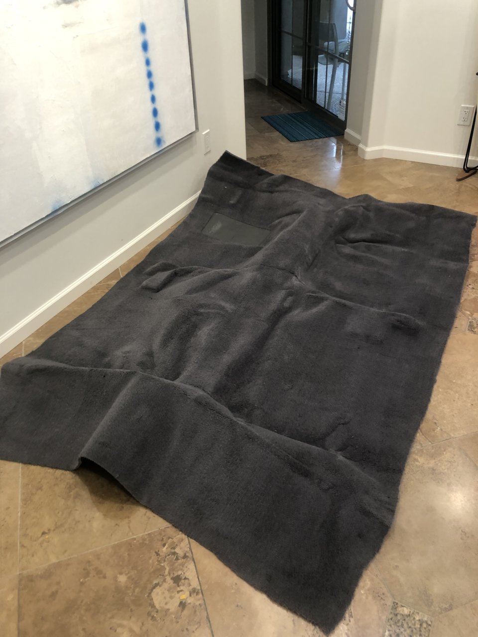

    The one disappointment is the new carpet, from https://www.factoryinteriors.com/. You get one large, undifferentiated carpet with contours for the transmission tunnel and transverse rib for the seat. However, the OEM carpet has a ton of cutouts, for the transmission, front center console, attachment for the console between the seats, various screw holes, seat belts, rear storage compartment, etc. So you sign up for a major crafts project, and I doubt very strongly I can do a professional job; and sure as hell, am not interested in looking at a hack job. I tried to cut out the transmission and the console which are the obligatory minimum to even lay the carpet in the truck. Major pain. So after trying to fit it in, have put the old carpet back, and am in a conundrum: I will try to find a local shop that might be able to put it in, and if I can't, will just abandon the carpet upgrade.
    Does anyone have any suggestions on how to tackle the carpet upgrade? I most definitely do not want to cut it and fit it myself.

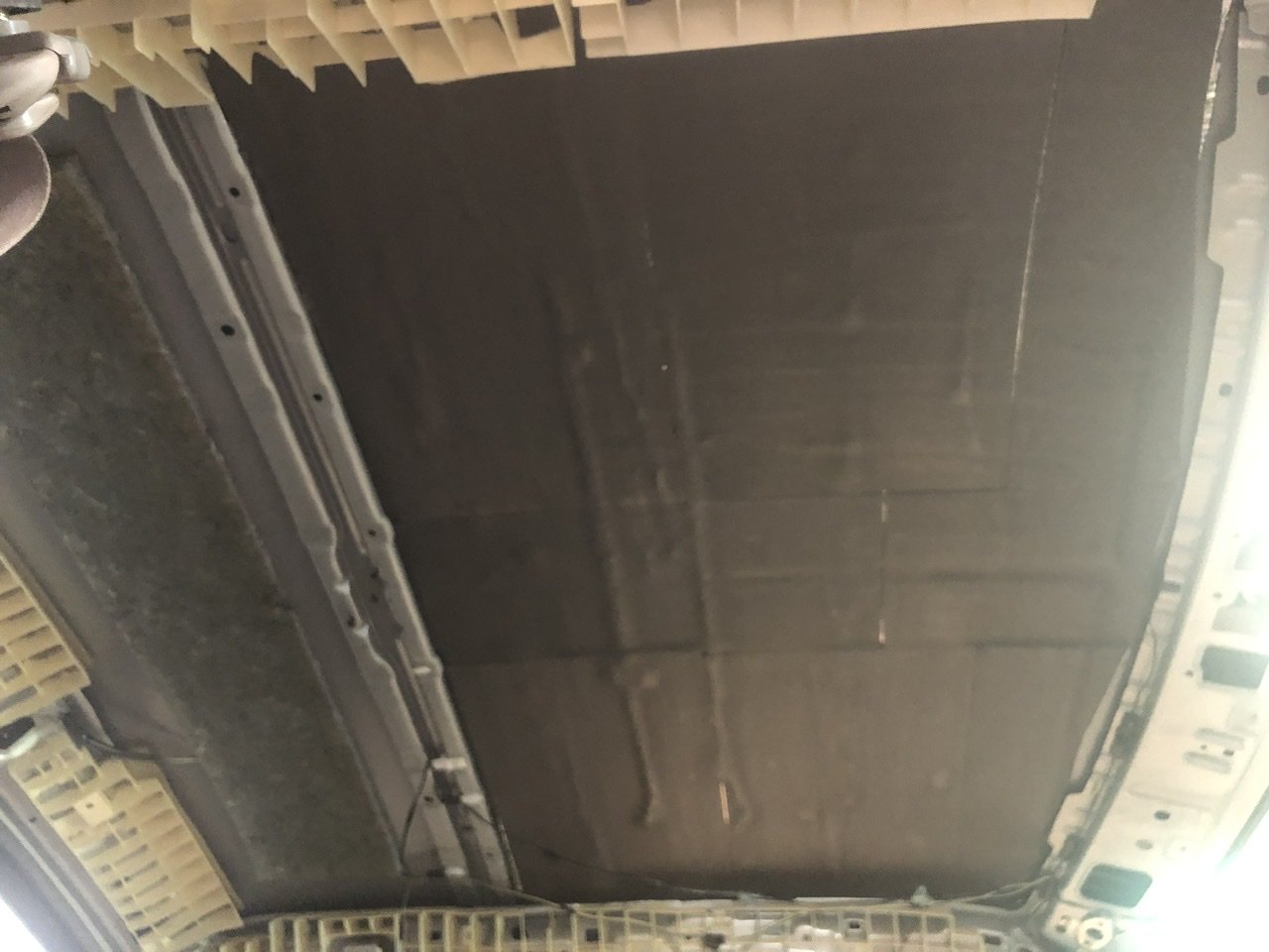

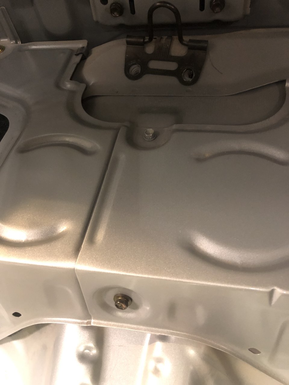

  16. Aug 20, 2021 at 9:20 PM
    #16
    koenbro
    Feb 7, 2017
    #209951
    264
    Phoenix, AZ
    Some pics from today. Have even covered the rear storage compartment/ rear seat support shelf:
    This is the first layer to the roof:
    And this is the foam:
    The head liner was easily removed and replaced.

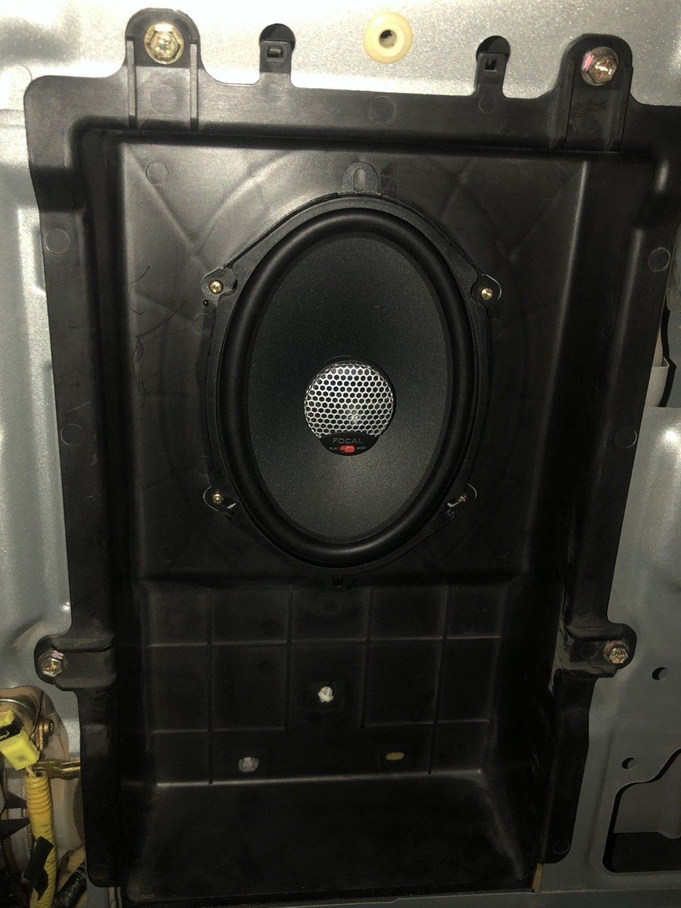

    Rear speaker:
    Hamer95USA and Bubba’sTaco like this.

    I just new carpet but haven't put it in yet. I don't have the old 1. I used mat66 from Amazon to sound deadening for mine n it's quiet down the cab alot. My suggestion for the new carpet would be to lay the old 1 on top of the new carpet and use as a template for cutouts

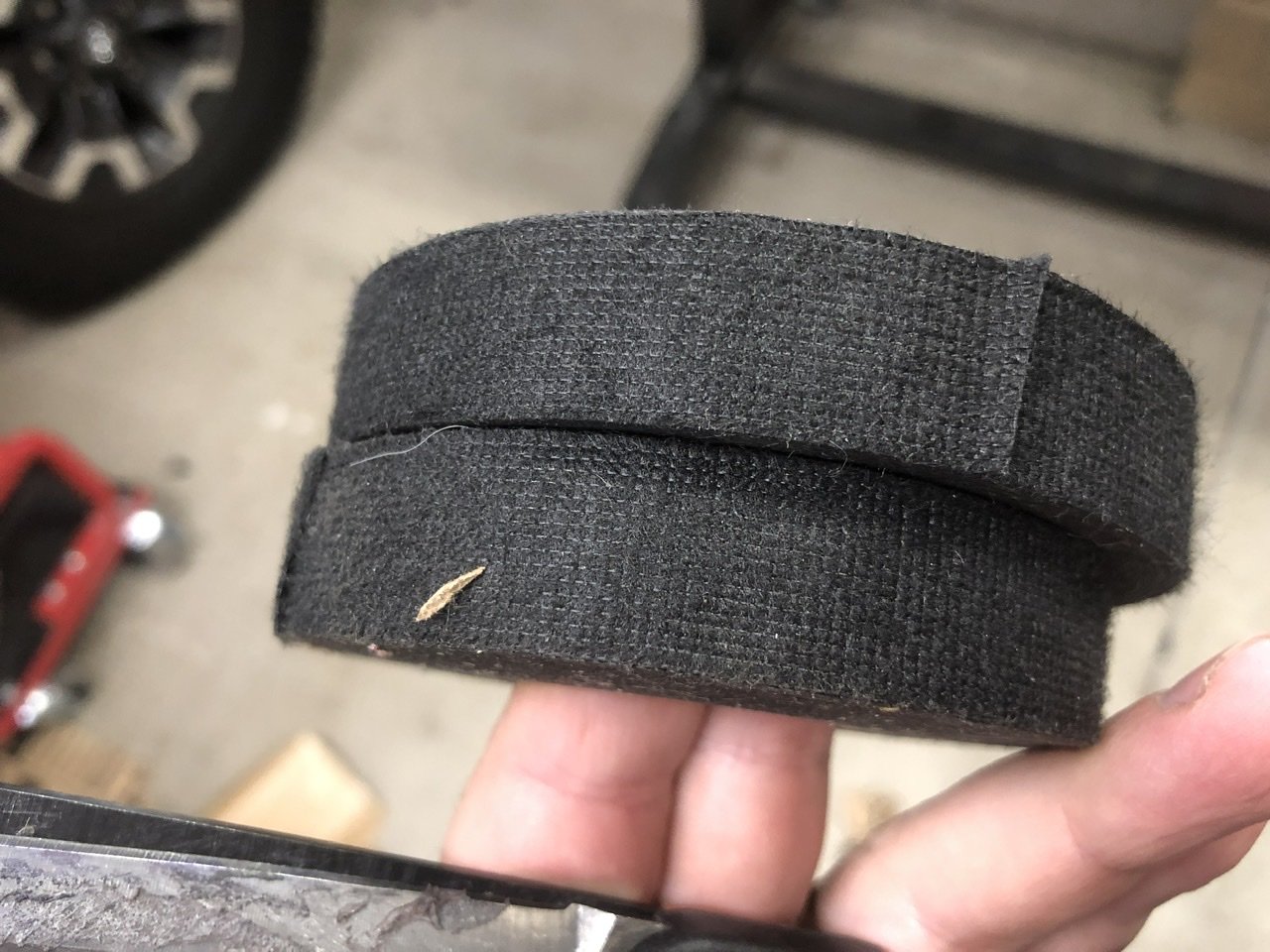

    Have used tricot tape to wrap the speaker wires and the wires I brought up from the head unit to the top of the windshield (GPS and 4G).
