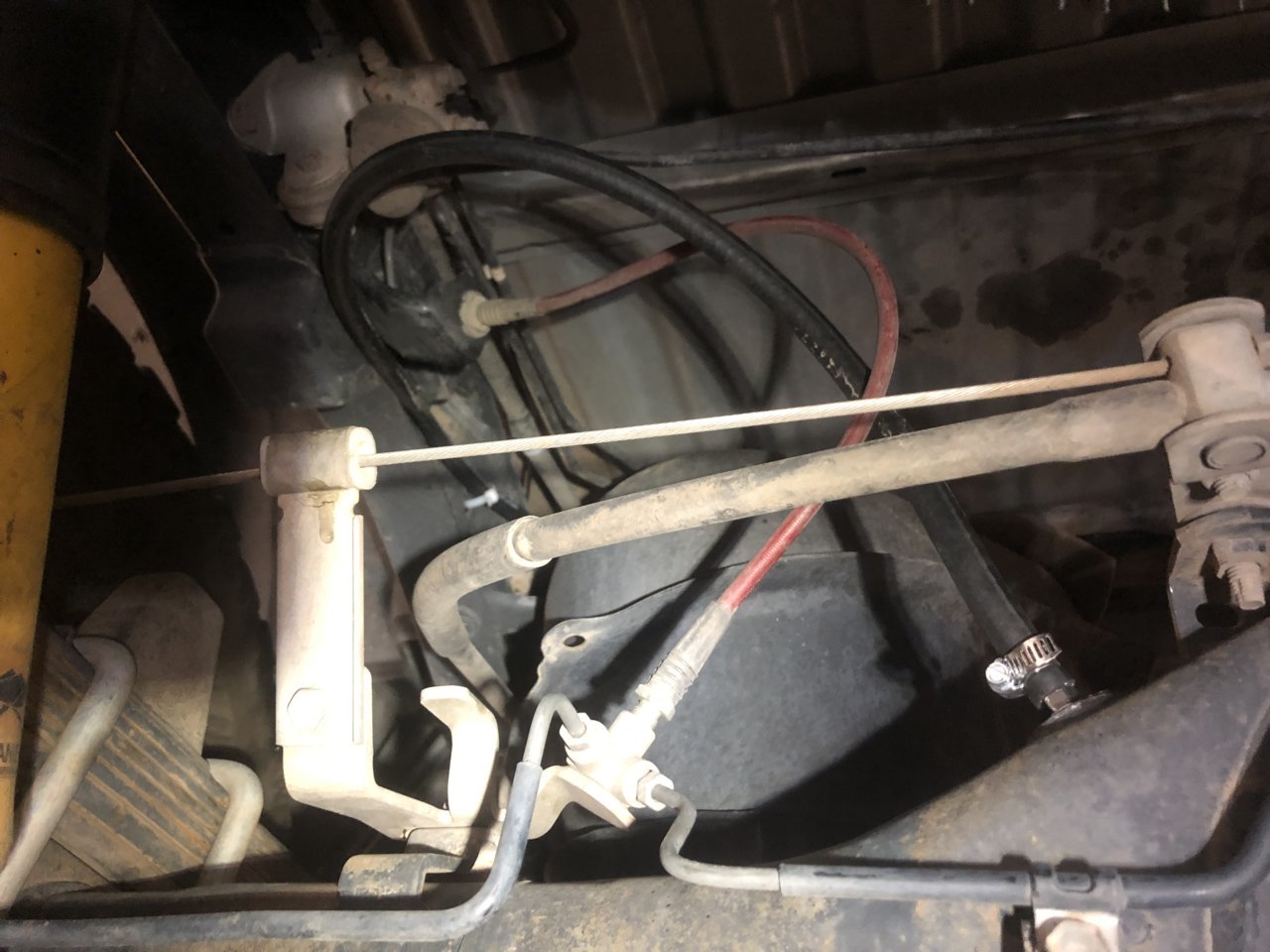

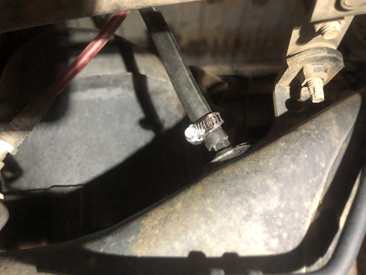

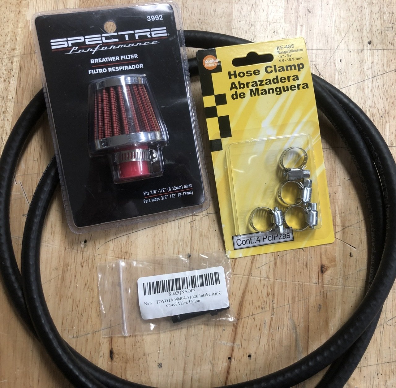

    Have gotten the parts for the diff breather mod. Wanted to save a penny and did not buy the ARB relocation kit, instead went to NAPA.
    AB1D9060-B87A-4779-8FDD-002030D6A4ED.jpg 17FB2654-A6DF-457B-9D7B-777F4FD27A15.jpg

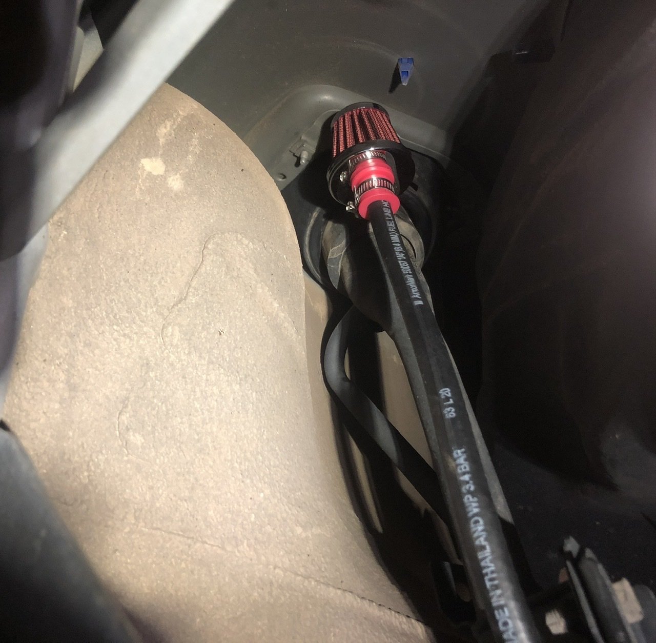

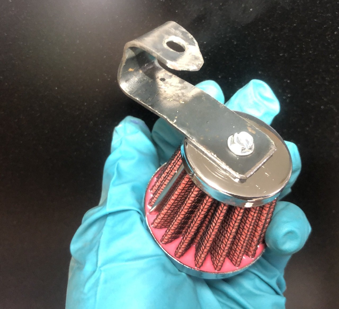

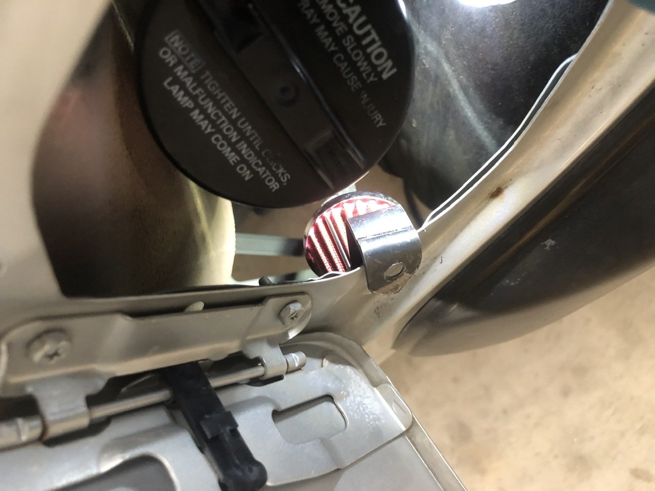

    I completed the rear diff breather mod today. Made a simple bracket to attach the filter:
    I do not want it to show in the gas opening:
    That’s what the filter looks like from below.

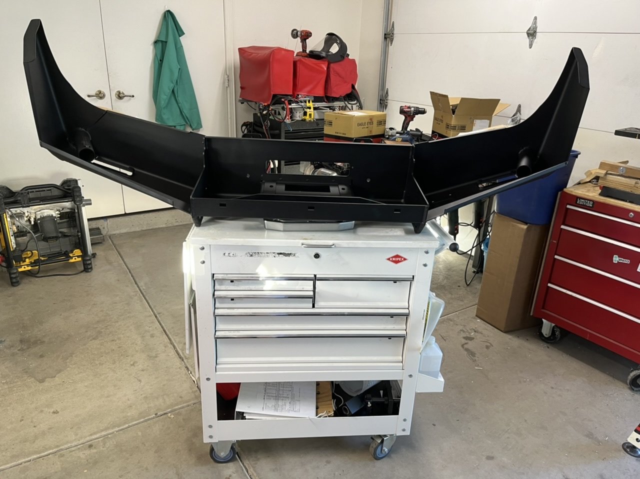

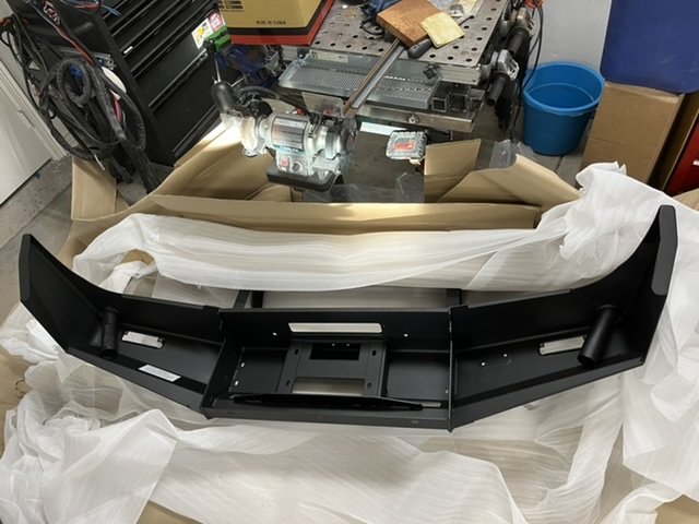

    Picking up the build again. Have had the Eaton TrueTrac installed by the local DesertRat shop.
    Next will be an ARB bull bar #3423040, and a Warn M8000-S winch.
    The bull bar arrived well packed in two units on a pallet. Here it is on a furniture dolly:
    And here on top of my trusty HF tool cart:

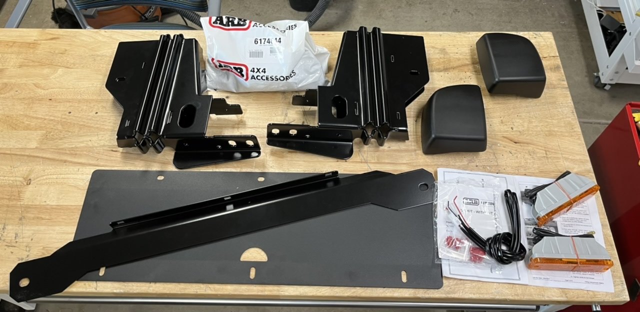

    It comes with a bag with small parts, turn signal lights, a bumper kit, and various attachments:
