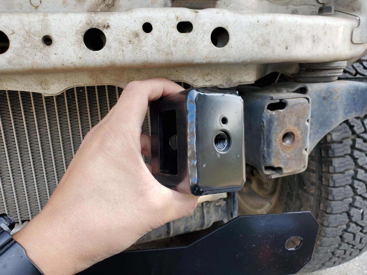

    Does anyone know what are these for?
  2. Aug 8, 2022 at 6:08 PM
    #62
    Kwikvette
    Feb 27, 2019
    #284735
    81,754
    Fresno County
    4 run, 2 don't
    For mounting your bumper :burp:
  3. Aug 8, 2022 at 6:10 PM
    #63
    Kwikvette
    Feb 27, 2019
    #284735
    81,754
    Fresno County
    4 run, 2 don't
    They're sandwiched between those brackets that 'crush'
    koenbro[OP] likes this.
  4. Aug 8, 2022 at 10:15 PM
    #64
    koenbro
    koenbro [OP] Well-Known Member
    Feb 7, 2017
    #209951
    285
    Phoenix, AZ
    2001 Tacoma SR5 Xtended cab 3.4L 5Spd
    Thank you @Kwikvette the photo is very useful.
    Interestingly there are no useable YT videos for this installation; the only close one is by a guy with a 1998 Taco who trimmed the front end of his frame, which does not apply to my model year.
    The instructions from ARB are pretty weak but I downloaded the ones for the xxx20 model of bullbar (mine is a xxxx40, but they are supposed to only differ in finish). The instructions are different between these two versions, and putting them together I managed to install the thing. My truck is a 2001 yet its front config resembles a 2002 and later with the crush cans welded to the crossmember. So it was pretty confusing at first.

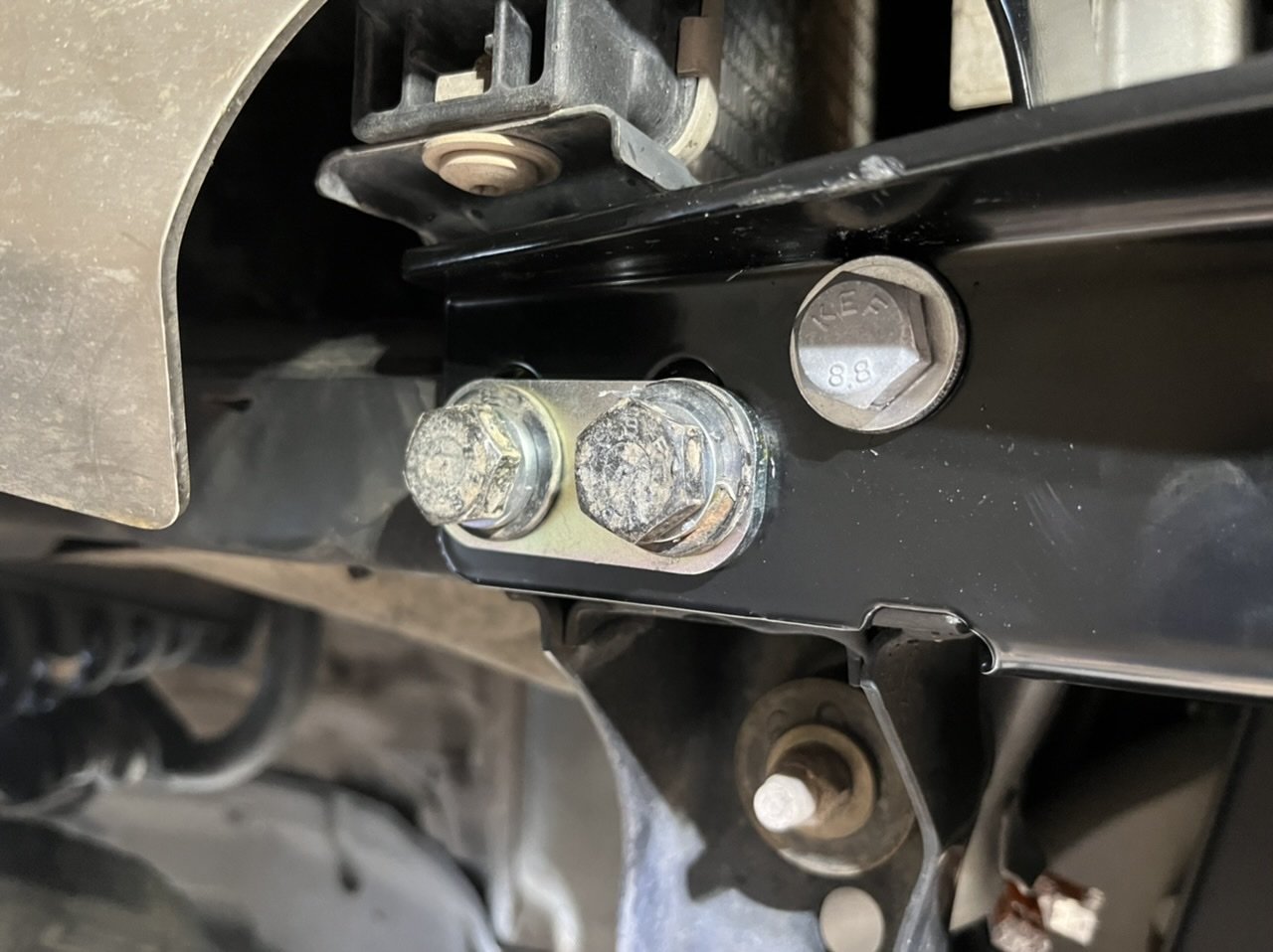

  5. Aug 8, 2022 at 10:49 PM
    #65
    Kwikvette
    Feb 27, 2019
    #284735
    81,754
    Fresno County
    4 run, 2 don't
    Did you drill through and utilize the bolts provided since you're going to use a winch?
    koenbro[QUOTED][OP] likes this.
  6. Aug 9, 2022 at 8:45 PM
    #66
    koenbro
    Feb 7, 2017
    #209951
    285
    Phoenix, AZ
    Oh yeah and what a major pain that was! Found it hard to align the top hole so it punches out where the bracket expects it so to speak. In fact I missed by enough on one side so now the hole is more like an oval. Oh well. Then on the other side the frame had an internal folded over sheet metal piece near the weld line that interfered with the 13mm sleeve. Definitely happy that I drilled the frame after the bumper was installed, otherwise not sure I could have fitted it on. Anyways glad it's done, but I haven't torqued the bolts to spec yet. Still deciding if I should remove the bumper to attach the cables and replace the headlights first, or do everything after the bumper is torqued on.

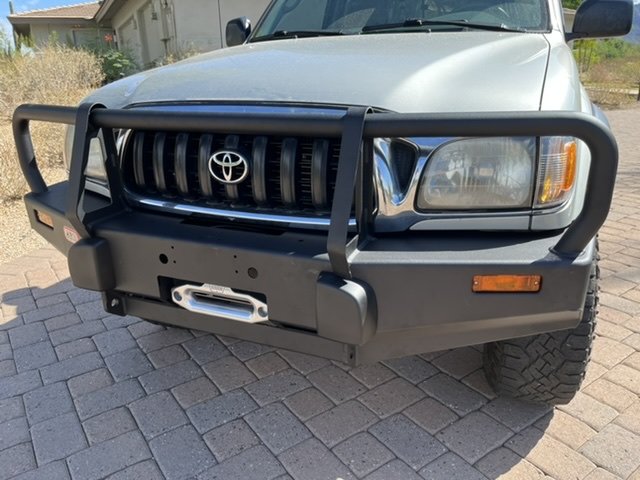

  7. Aug 10, 2022 at 10:27 AM
    #67
    koenbro
    Feb 7, 2017
    #209951
    285
    Phoenix, AZ

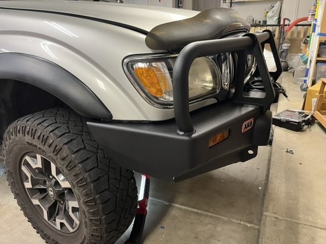

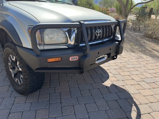

    This is what the underside looks like:
    And this is what she looks like now:
    I am very tempted to put back the wind deflector, as I am not used to the "bald forehead" look. Will see.

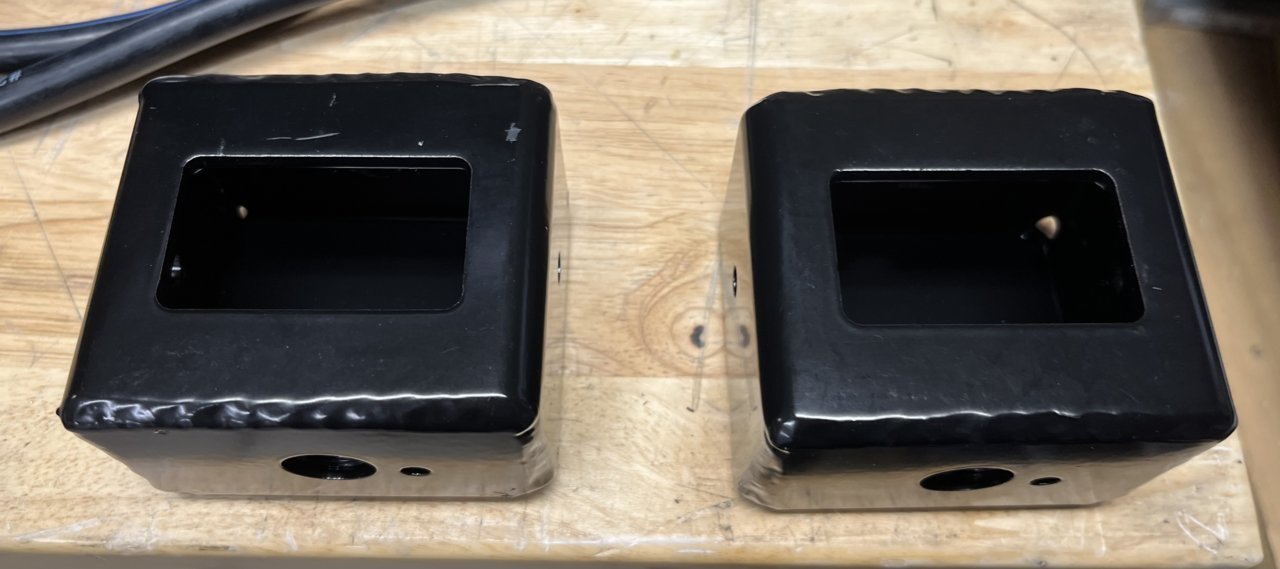

    In the meantime I 3D printed a bracket to relocate the contactor pack. My winch is the M8-S, the newer iteration of the M8000 so it has a contactor, not solenoids.
    From left to right versions 2,3, and 4.
    The two red ones are quick iterations from ABS with low fill. The final black one is made of PC-ABS FR, an automotive grade engineering material. Version 1 was when I initially contemplated placing the contactor pack inside the bumper in the right-side cavity. I milled an aluminum holder, but discarded the idea soon thereafter:
    And here it is with heat-set inserts:
    And with the base of the control box mounted.
    Still undecided on cable. Have 1/0 welding cable on order but I am not sure that is optimal. How come the factory power cable is #2 gauge and 6 foot long, with the return cable same length and caliber? There is a 12-14 foot total length of #2 gauge, and by relocating I add 40 inches or so.
    Wonder if I can get by with #1 gauge. Every choice is a tradeoff and oversizing has its clear weight and size penalty. Will the cable fit through the openings in the control box base plate for example?
    The factory info says the draw is 435 Amps for which #2 is clearly grossly undersized, yet that's what the factory ships with and the relocation kits also have that size (or close to it) cable. So am undecided.

  9. Aug 10, 2022 at 10:42 AM
    #69
    Kwikvette
    Feb 27, 2019
    #284735
    81,754
    Fresno County
    4 run, 2 don't
    Your pads on your bumper are upside down :burp:
  10. Aug 10, 2022 at 10:44 AM
    #70
    koenbro
    Feb 7, 2017
    #209951
    285
    Phoenix, AZ
    Oh, man. #despair

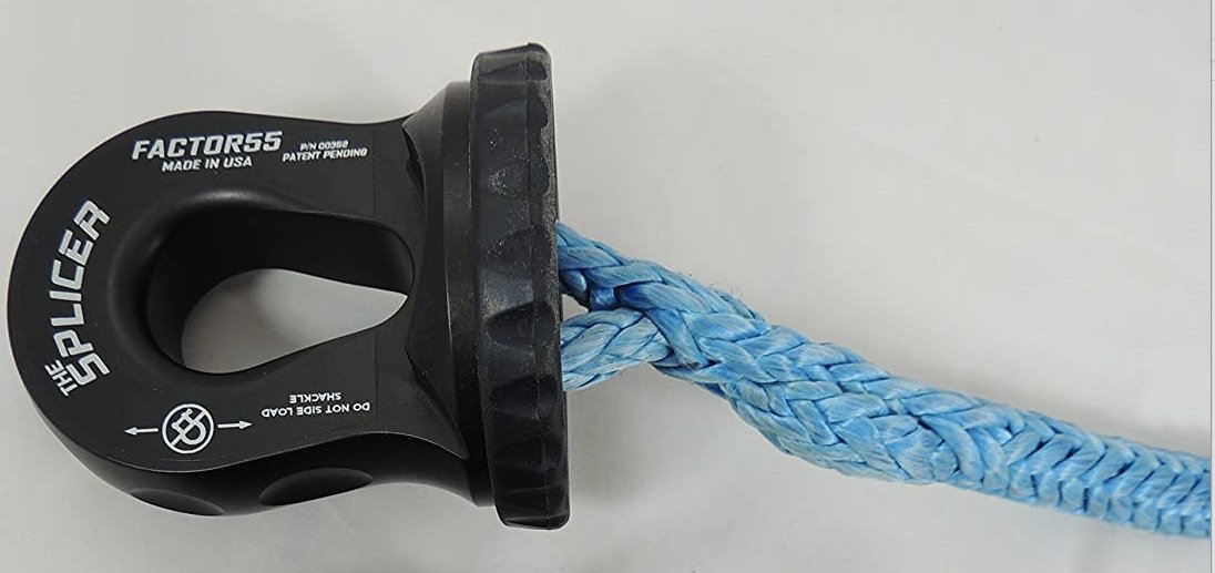

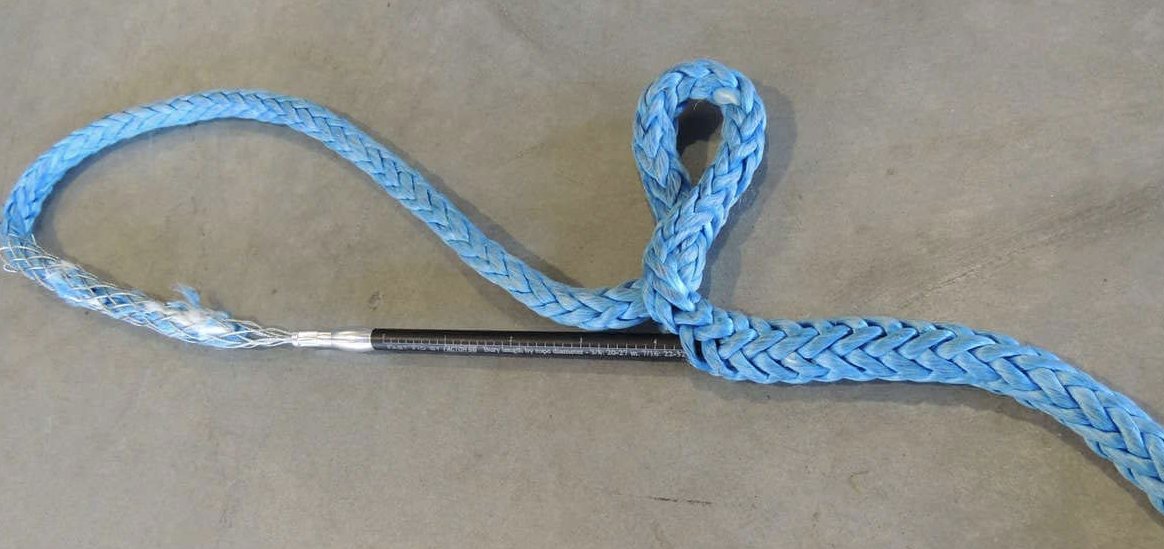

    Not much progress but today I replaced the factory loop with a Factor 55 Splicer. I used their Fast Fid and it made the job a breeze.
  16. Aug 26, 2022 at 9:41 AM
    #76
    Andy01DblCabTacoma
    Andy01DblCabTacoma Well-Known Member
    Mar 12, 2021

    Single braid dyneema splicing is super easy- straight bury for days. Barely even need a fid- I've used a bic pen before in a pinch.
  17. Aug 26, 2022 at 9:49 AM
    #77
    Andy01DblCabTacoma
    Mar 12, 2021
    #359086
    3,986
    Andy
    San Diego, CA
    01 Double Cab v6 4x4 TRD
    F: Kings SPC, R: 5100s+J59s. Custom armor.
    ... wait... fucking $50 bucks for one fid and an odd wire trap?
    Were their instructions to follow this:
    That is a super janky splice.

    Yeah I paid 50 bucks for their fid and used it for my rope and found other uses for it (pulling 4-gauge wire through the firewall). Love it.

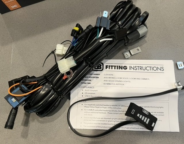

    The build continues. The mailman brought a few goodies today:
    I already had a Viair 1 gal tank, but i regret having bought it so will sell it. The plus side is that it has 4 ports, the down side is that the feet are tall (tank needs a lot of space to mount) and it is steel and too heavy. I am trying to be thoughtful about the weight. In fact I have some preliminary thoughts about the bull bar (for a later post).

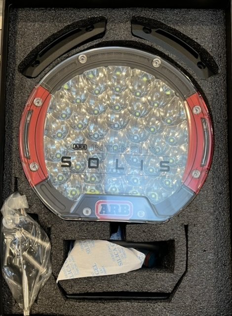

    The main attraction of the evening:
    I got the kit that has one spot and one flood. Solidly built, has that quality feel.
    Haven't decided yet if the final mounting spot will be on the bumper or on the roof, but will start with the bumper mounting. The roof mounting will a need a bracket, and I will not drill through the cabin roof sheet metal, so it will be something reaching forward from teh bed over the cab. So that will happen later, but I already have ideas.
