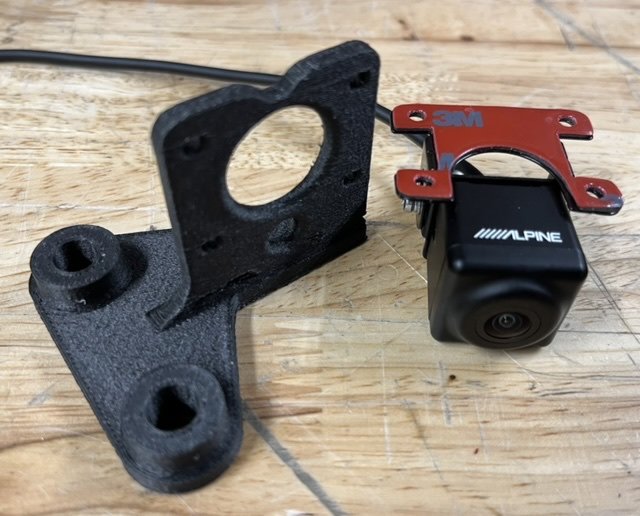

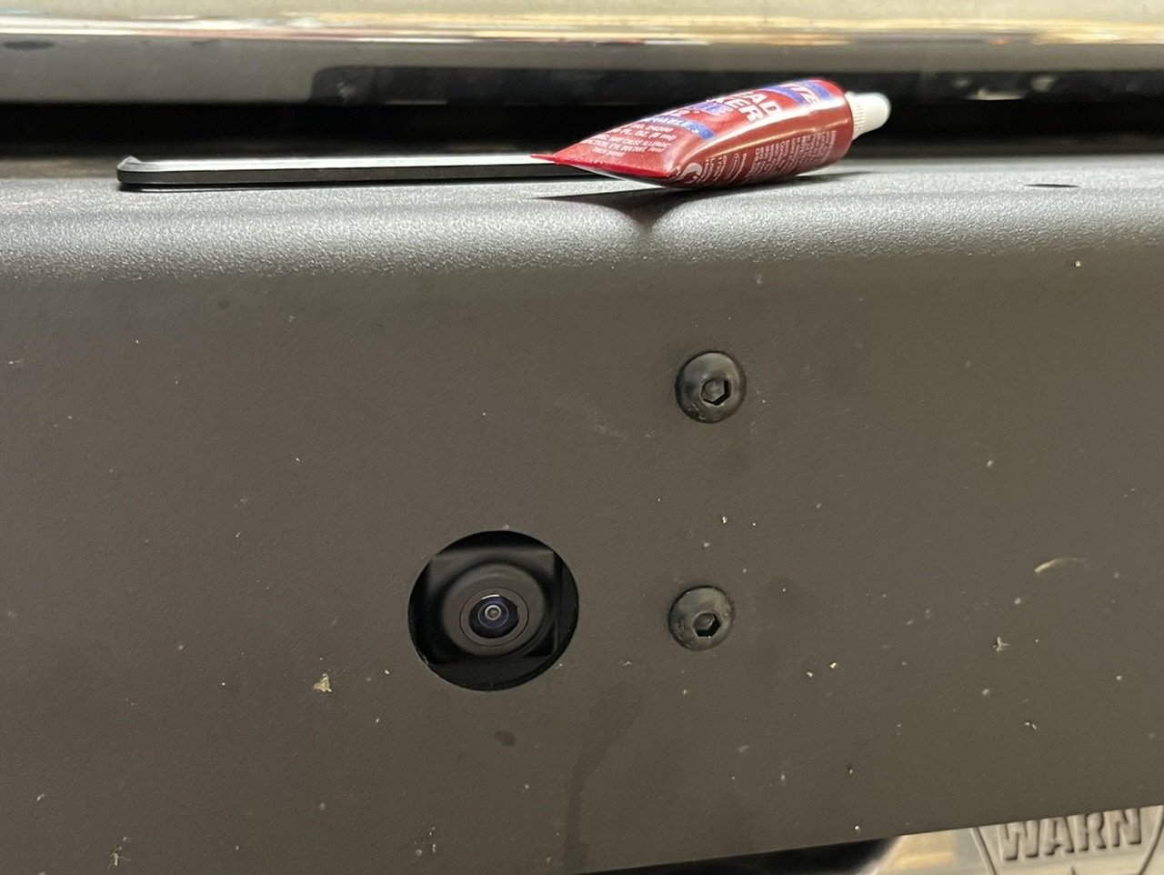

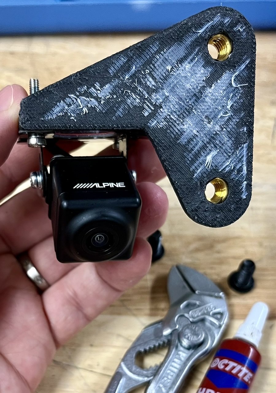

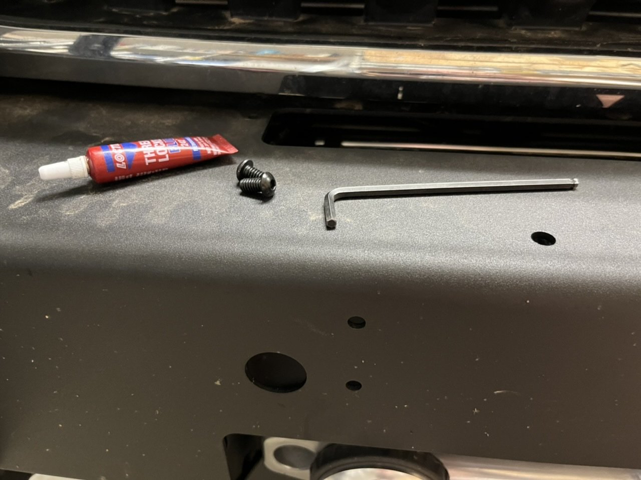

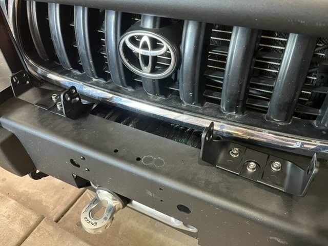

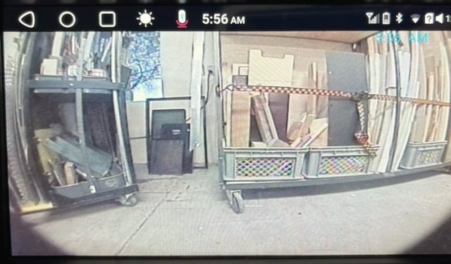

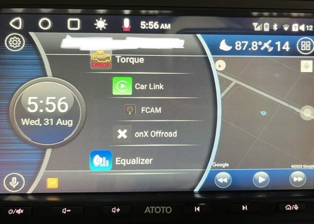

    I had a rear view camera laying around that I wanted to put to use, so I printed a bracket and mounted it inside the bumper to serve as a front/trail camera.
    The camera mounting plate has a sticky tape but decided to use M3 screws instead, so I can remove it later without drama.
    Some of the support material didn't wash off, but no problem, as it will not show. The material is nylon - carbon fiber otherwise and was annealed after washing.
    The bumper came with a conveniently sized hole.
    A little thread locker later, it's safely mounted.
    And voilà, I have a front camera!

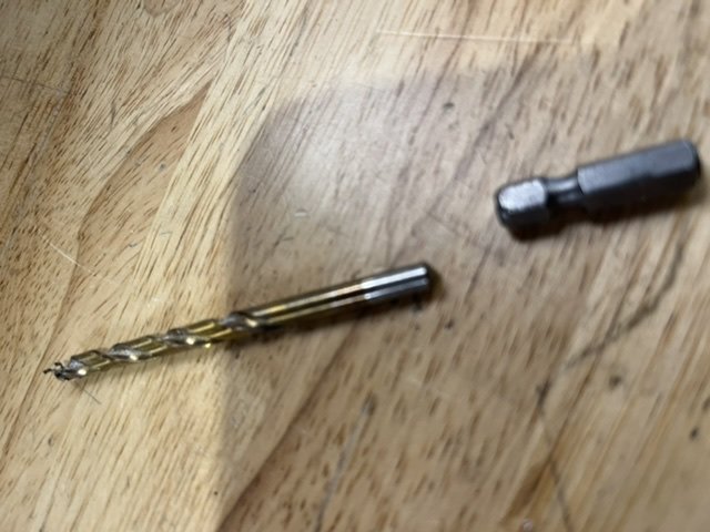

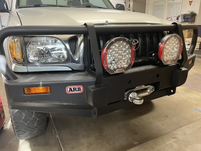

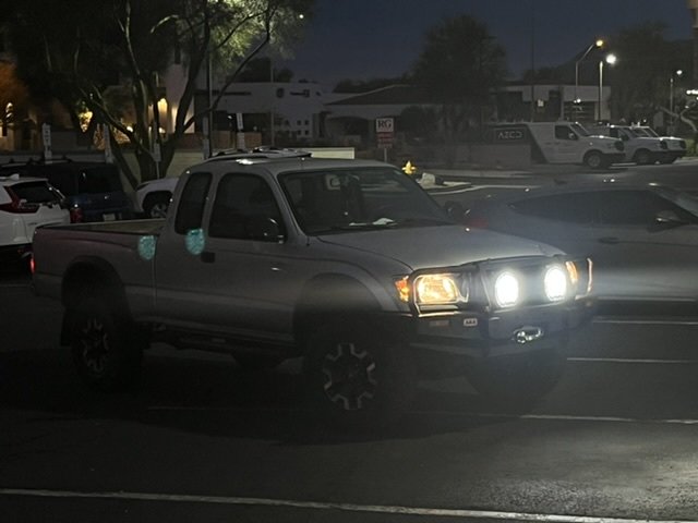

    Driving lights:
    Have started the installation of the driving lights. They are quite large and heavy. Drilling the bumper sheared one of my drill bits clean off its socket.
    The mounts install easily and allow adjustments for lateral rotation.
    I still have to sort out the wiring and connect into the high beam. Will probably replace the red bezel with the provided black ones; these are too showy.

    Very big light. I have ordered the amber covers as the color temperature is too high (light is too white/blue) for my taste.
    Kwikvette likes this.

    4 run, 2 don't
    Damn they're bright.
    Are they spot or flood?
  7. Sep 3, 2022 at 8:29 AM
    #87
    koenbro
    koenbro [OP] Well-Known Member
    Feb 7, 2017
    #209951
    307
    Phoenix, AZ
    2001 Tacoma SR5 Xtended cab 3.4L 5Spd
    One spot (driver's side) and one flood. They sell the kits with FF, SS, and SF. Mine is the latter; frankly a flood-flood would also work very well.
    It has an adjustable (0-25-50-75-100%) output. Pictured above is the full output, but I expect to use it mostly at 25-50%.
    Kwikvette[QUOTED] likes this.

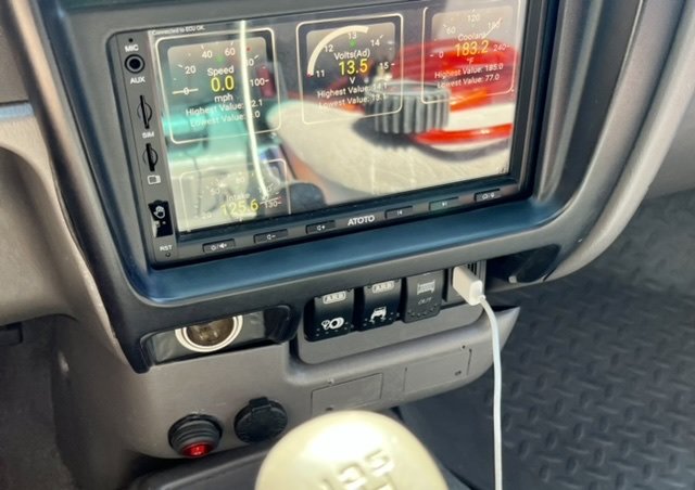

    Contura switches in the dash

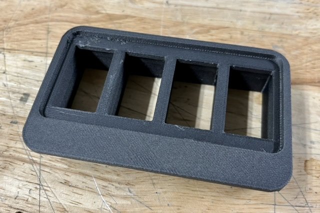

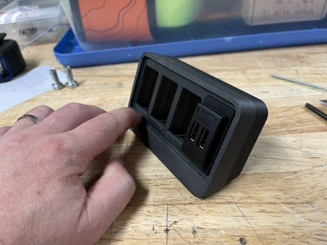

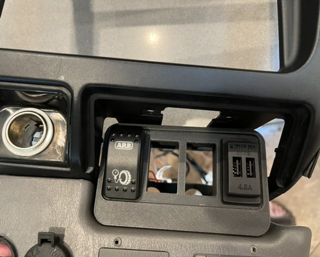

    To mount the compressor, front locker and another (thus far unassigned) Contura switches in the dash, I printed a 4-opening panel to use the ashtray space.

    can you share the STL for that switch panel?
  10. Sep 4, 2022 at 7:36 PM
    #90
    koenbro
    Feb 7, 2017
    #209951
    307
    Phoenix, AZ
    The stl file format cannot be uploaded to TW, but *.zip is allowed, so here it is. The build is made to fit these 1/4"-20 heat set inserts.

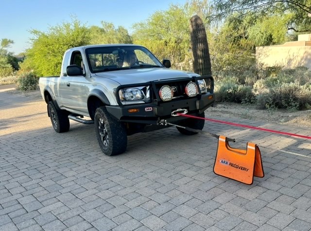

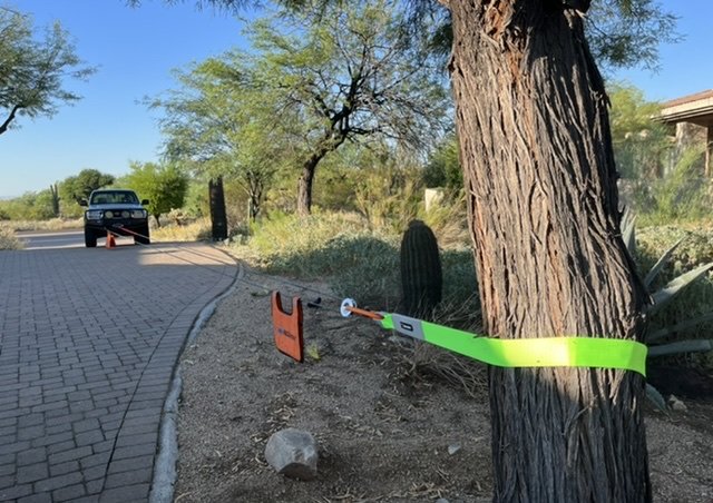

    Today we practiced recovery for the first time ever.
    catskill.joe and Kwikvette like this.

    Putting together the first iteration of the recovery kit. Will add a shovel, a second pair of gloves, and probably a second hard shackle. Still need to make a rear hitch recovery point.
    BTW in the recovery practice photos above, both dampeners are on the same run, so I moved the one closer to the tree to the other run as soon as it threatened being sucked into the pulley. Also the dampener closer to the car had to be velcroed closed so it wouldn't fly around in case of failure. That's what happens when you are a noob :rofl:-- but that's also why we practice at home.

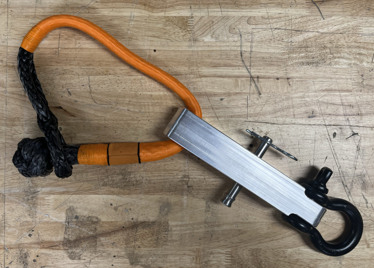

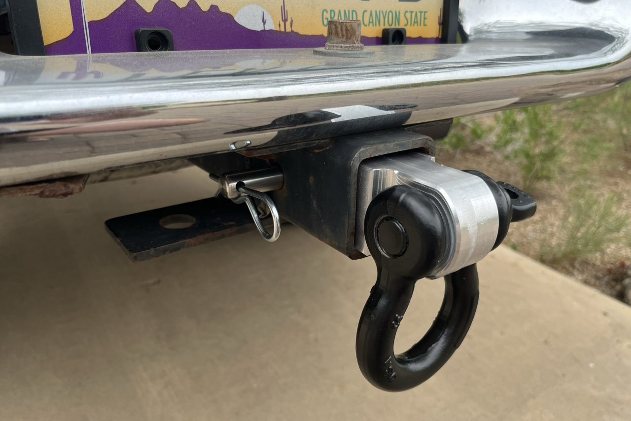

    Rear (hitch receiver) recovery point.
    I was inspired by the Factor 55 Hitch Link Pro, but wanted one that allows for both a hard- and a soft shackle. Because I had a piece of 6061 scrap laying around and its size was appropriate, I decided to make one. Here is a one-minute video showing the process.
    https://www.youtube.com/watch?v=8peohol0xck
    And this is the end product. Please note it is "TACTICAL", "BILLETT", "MILSPEC" and whatever other meaningless marketing jargon you can attach. Don't forget "OVERLANDING"

    Surprised you don't just make your own rear bumper.
    Two frame rails that allow for an easy bolt on setup for the base of the bumper; from there it's just about adding what you want to it or simply tying it in with square tube even.

    You are 100% correct: I should redo the rear bumper. This hitch recovery is a stop gap measure.
    A new bumper will be part of a redesign of the bed. I was very impressed by the flat bed solutions you can see on YT. They seem practical and efficient from a storage point of view and to allow a camper to be built over them. For example this one a guy in California built, it is superb:
    https://www.youtube.com/watch?v=O2M7Z1ryaQg&t=666s
    I will build my flavor of it and am very tempted to do it out of 2x1x1/8" Alu tube arranged with the wide edge bearing the vertical load. I have not seen Alu solutions online probably because of cost and/or difficulty to weld it; I am obsessed about weight saving (the bull bar is an obvious violation of this rule), and that's why am looking at Alu. For many reasons related to work, etc this will have to wait until at least after November.
