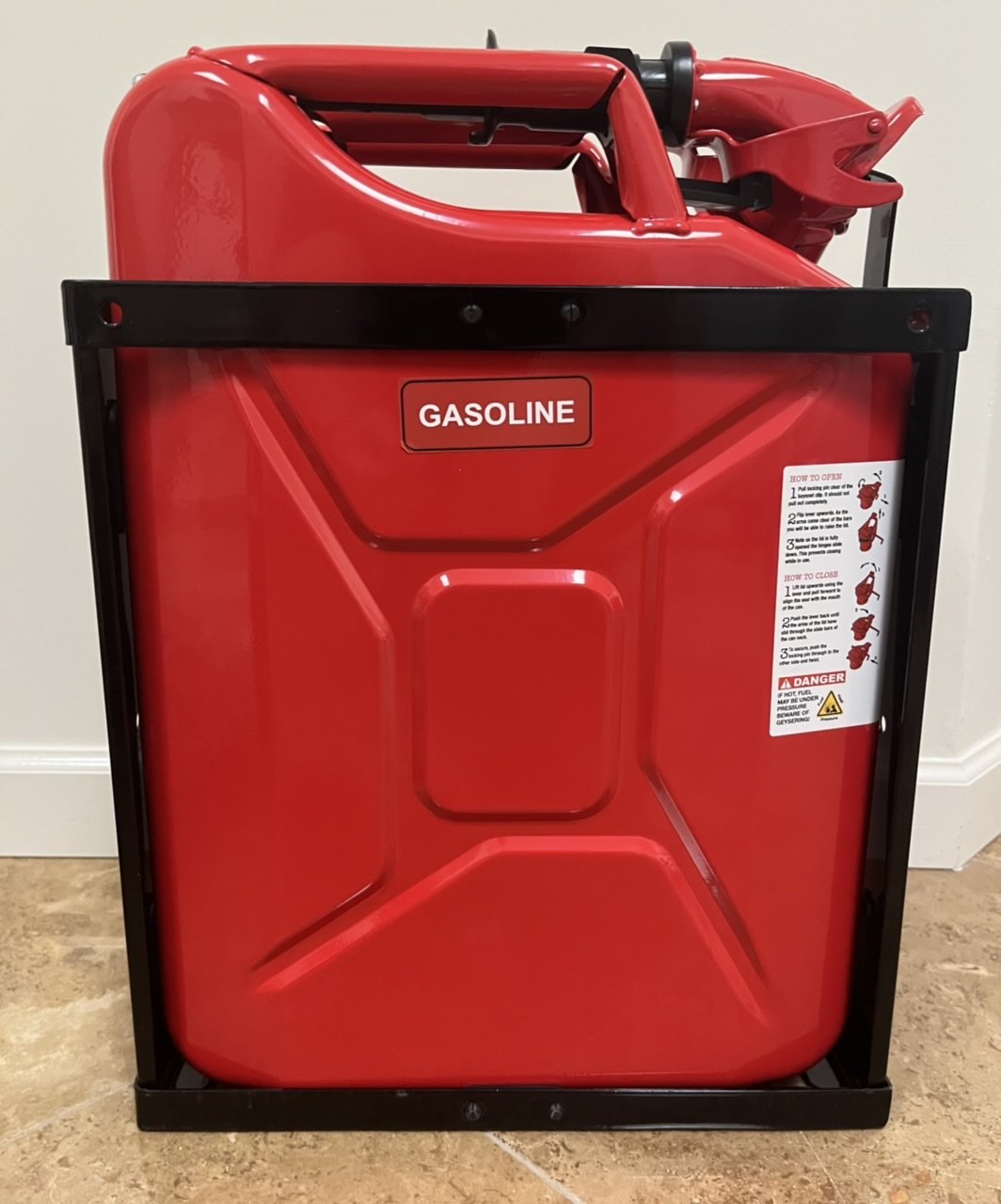

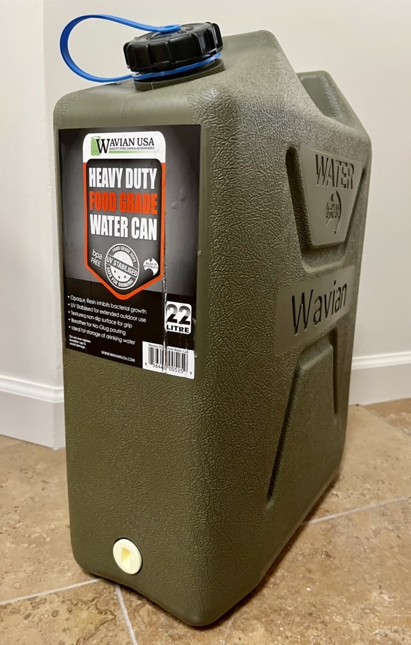

    The build (or, rather, the shopping spree) continues: instead of mounting a second tank have decided to just get a Jerry can. Have looked at Rotopax, and although immensely popular (Rotopax and the high lifts are ubiquitous in mall parking lots in Scottsdale, AZ) I went with the true and tried NATO jerry can. Also got a Made in Australia BPA-free 22 liter water tank. Both came with mounting cages.

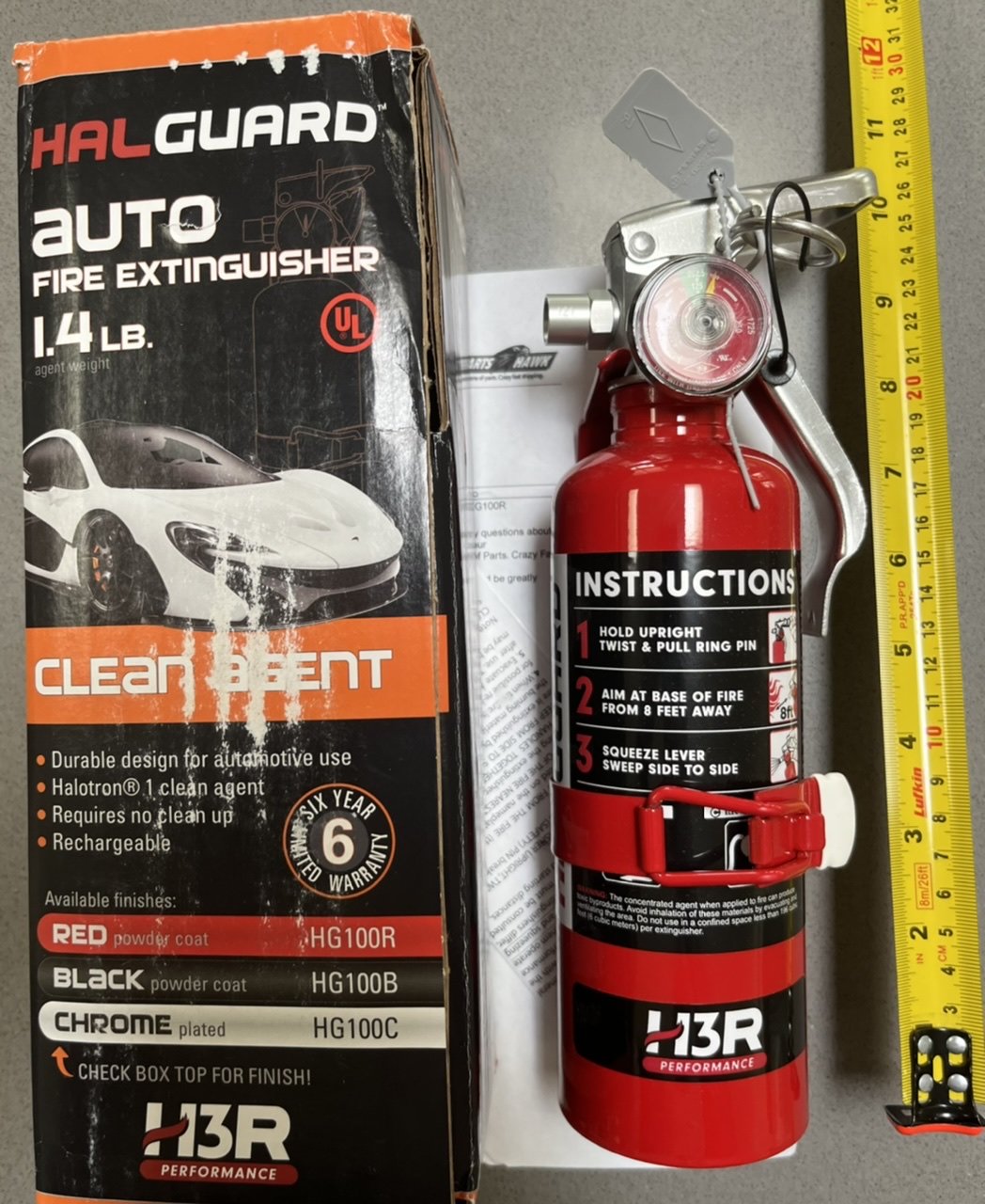

    And the amazingly tiny fire extinguisher

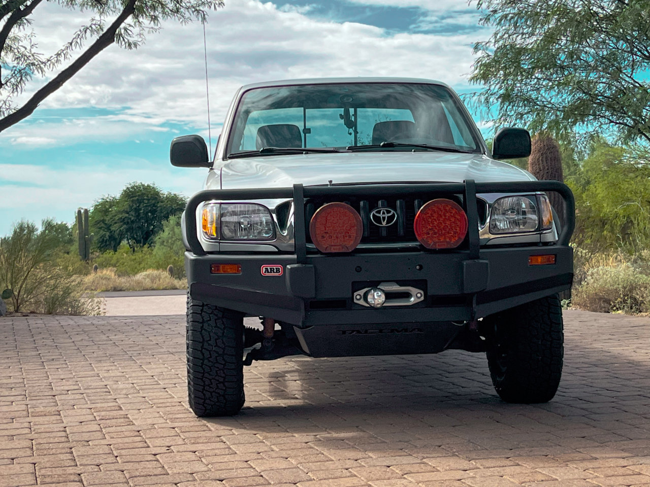

    This is what the narrower tires look like:

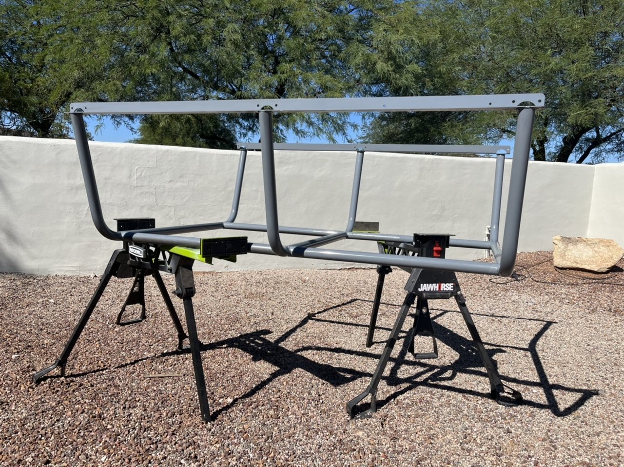

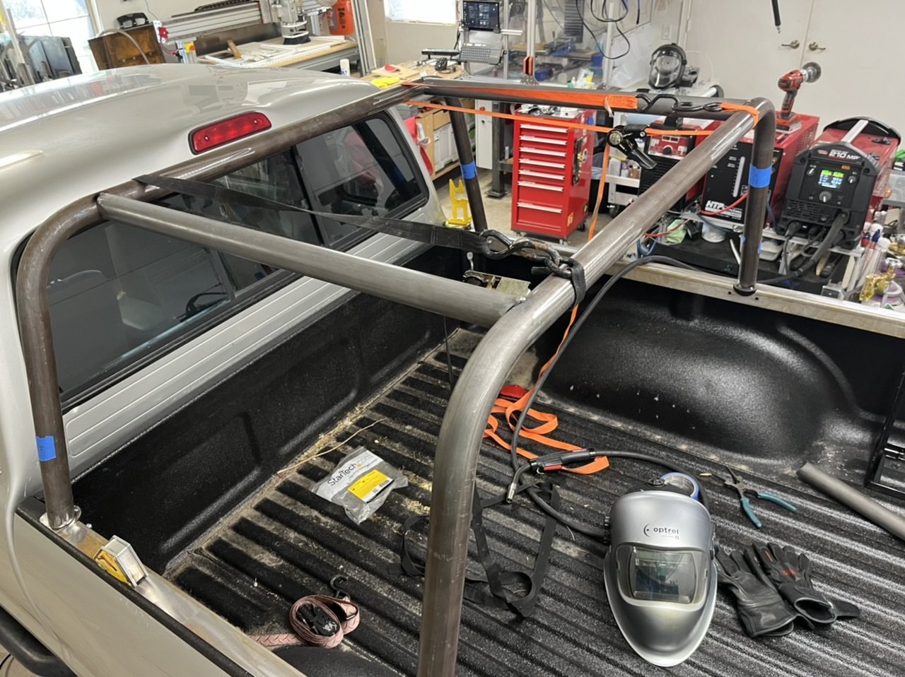

    I have one of the weld-it-yourself bed racks and it’s time to install it. D013FE71-6E9A-46D1-A3A5-3DF4A9E289C9.jpg
    Have mounted the rails on the bed and tack welded the rest with MIG then took it off. Started to TIG it but it was slow going with weird out of position seams. So I just MIG-ed it up. Will drill some holes for brake lights then paint it.

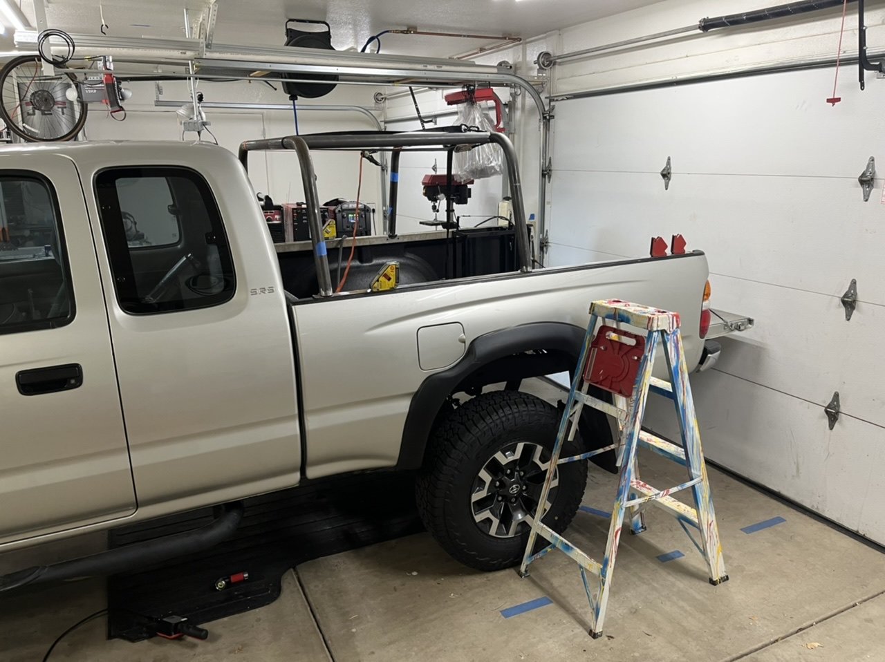

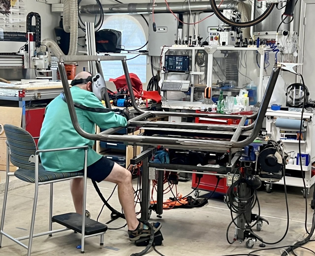

    Ttwo more from earlier in the process

    • Attach the two sets (four total) MaxTrax -- they need some sturdy attachment.
    • Will also fit the 2nd spare wheel inside the bed, on the driver side, in the back. Although the wheel carrier will mostly be attached to the bed, I think some crossmember will be attached to the rack (haven't designed it yet).
    • Water jerrycan.
    • The gas jerry can is already attached to the bed.
    • Plan to carry a full length shovel and that will need some home too. Got one of the foldable infantry shovels but it is not comfortable to use, and there is no penalty in carrying a full length one, so the foldable one goes back.

    Once painted, I will see how much heat distortion the welding has caused. Perhaps it’s not gonna fit on the bed.
  20. Oct 22, 2022 at 11:22 AM
    #120
    Kwikvette
    Feb 27, 2019
    #284735
    81,768
    Fresno County
    4 run, 2 don't
    You think having welded it distorted it enough?
    I would've welded the parts up while they were still 'mounted' to the bed.
    Remember though, being that the pieces are cut appropriately to size...if it did 'distort' and cave inward slightly, it can bend outward once you attach said hardware.
