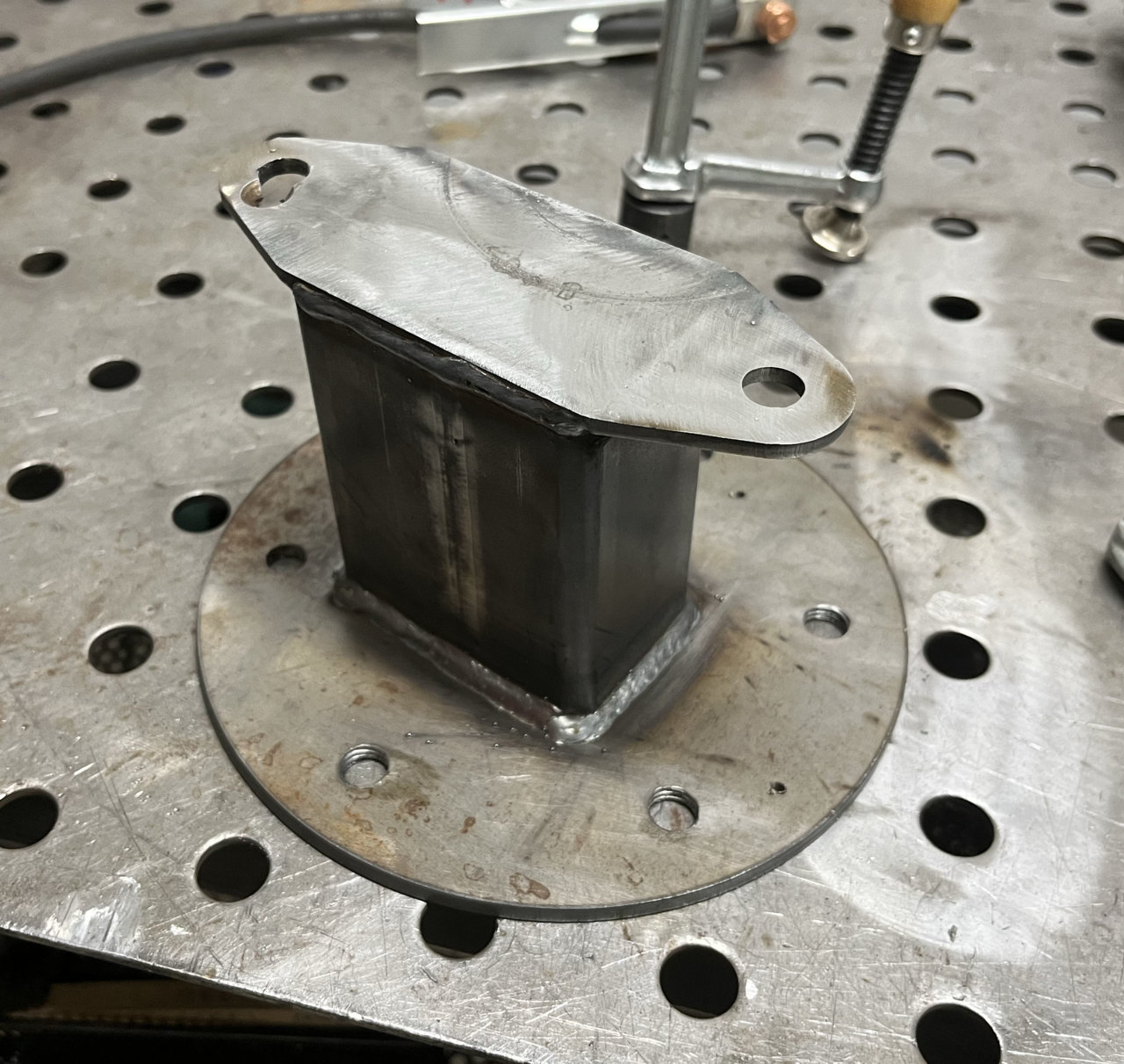

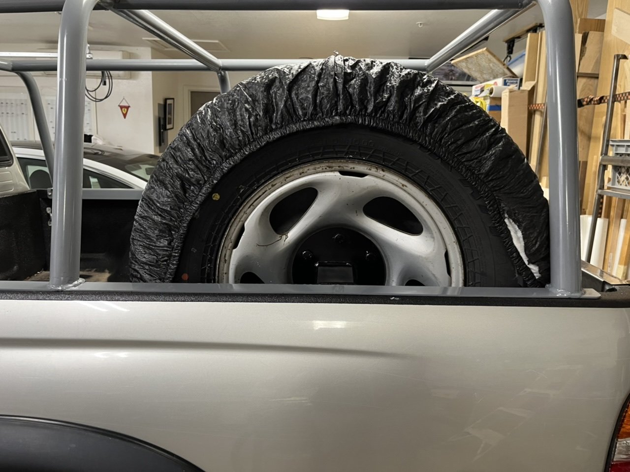

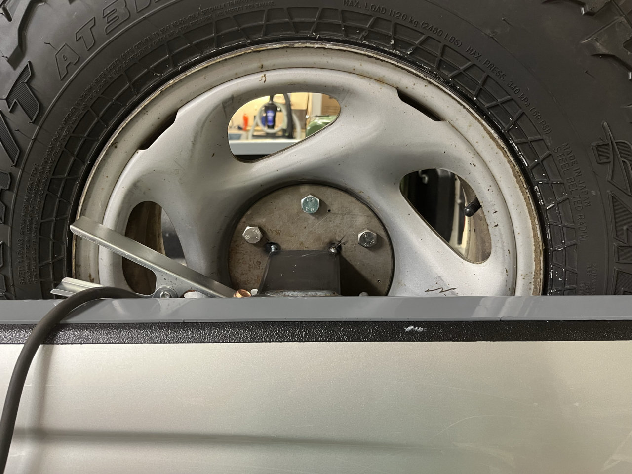

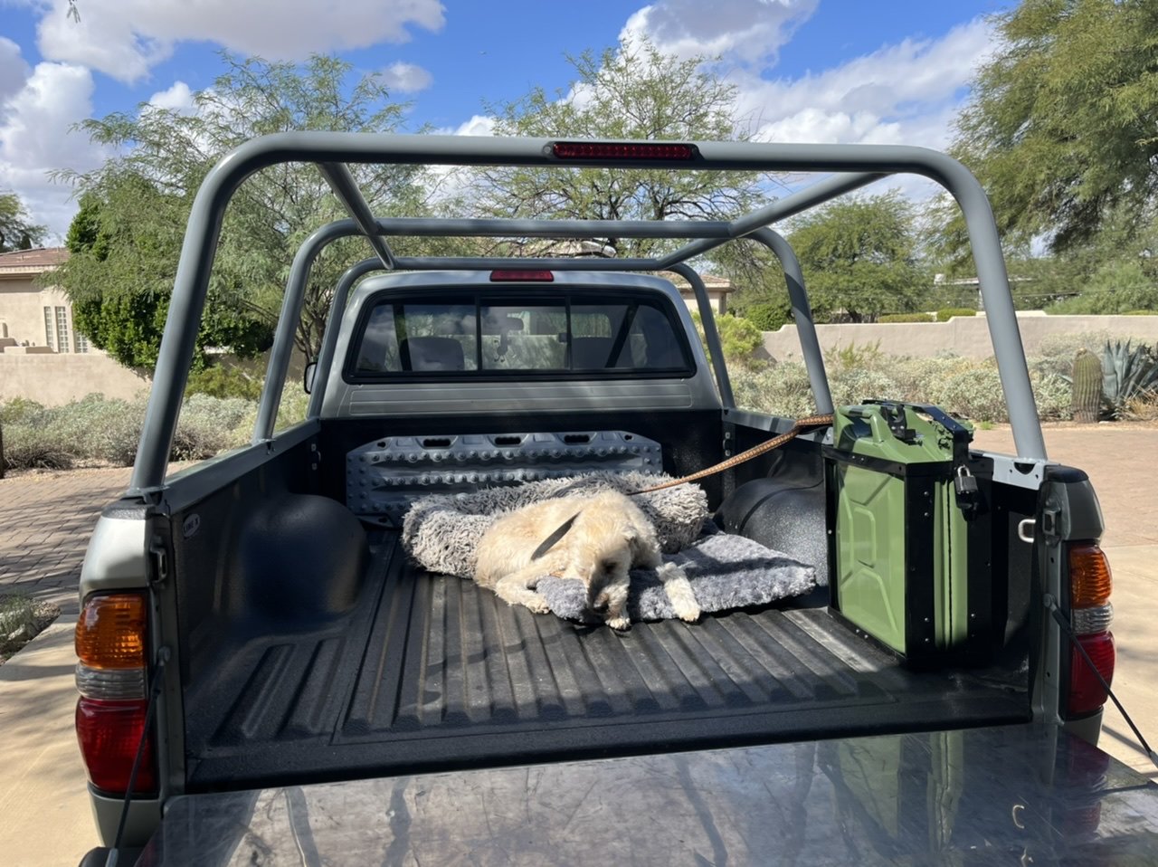

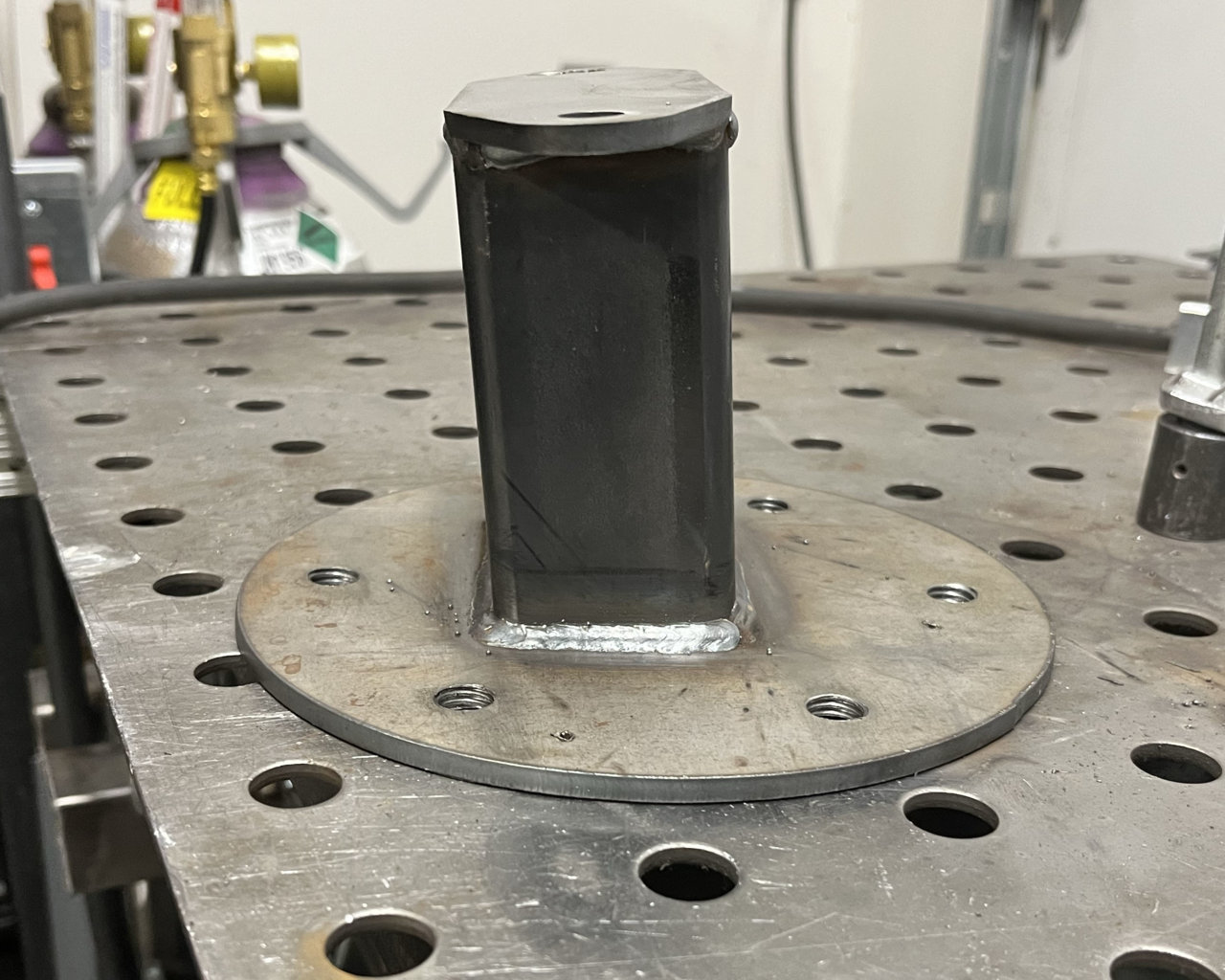

    Today after work I made a wheel carrier. It is a disc with 6 holes (tapped 12mm x 1.75 for "lugs") a piece of 2x3" tube and a tab. The disc and tab are 3/16" steel, cut with plasma.
    The tab screws unto the rim/lip of the bed with 10mm screws, then the wheel connects unto the disc with 12mm stainless screws and there will be a straight piece that braces two "lugs" and allows a padlock to secure the wheel. If that doesn't make sense, will add some more photos.
    I am not sure if it is enough to connect the whole assembly (wheel plus this carrier) with only two 10 mm screws to the rim/lip of the bed (plus the horizontal piece of the canopy frame) while driving 65-80 mph on the freeway. Any thoughts?
    BTW the reason I use specific material (3/16" plate, or 2x3" tube or 10 mm screws, etc) is that I am reusing scrap and stuff I have lying around.

  6. Oct 26, 2022 at 6:02 AM
    #126
    Kwikvette
    Feb 27, 2019
    #284735
    82,962
    Fresno County
    4 run, 2 don't
    Do you allow enough room for adjustment on that tire carrier?
    I ask because, as "outfitted" as you are, you have more than enough to get you out of a hairy situation (if deployed properly).
    But you'd need to get into said situation to begin with, and I forget what tire size you're running.
    33's seem to be a real nice sweet spot for "big enough"
    koenbro[OP] likes this.

    Yeah I thought about tire diameter and the tradeoffs involved. My current size with the Falken 245/75R16 is approximately (245 * 0.75) * 2 / 25.4 + 16 = 30.5" which is 8% bigger than OEM. So not even close to 33" (and I agree with your point about it being a sweet spot, diameter-wise), but I wanted to consider gearing, wheel + tire weight and some secondary conveniences (speedometer accuracy and fuel economy). If anything I would like to have a bigger sidewall, as I am now sitting only at 184 mm; would love 200-220 mm to be able to air down mo' betta.
    That said your question raises an important point: the carrier is not adjustable, thus will not work with bigger tires. For now that is OK, and is the first iteration. I was thinking of using a vertical tube, attached to the bed at the bottom and to the rim/lip at the top. Then a larger tube/sleeve could move up and down on it and be tightened down with two screws at the desired height, and the carrier proper be attached to that sleeve; that design would accommodate up to 33". Might still end up doing it that way.
    For now I wanted to knock together smth simple as I plan to go offroading the next weekend. Still need to attach the two sets of Maxtrax and a shovel.

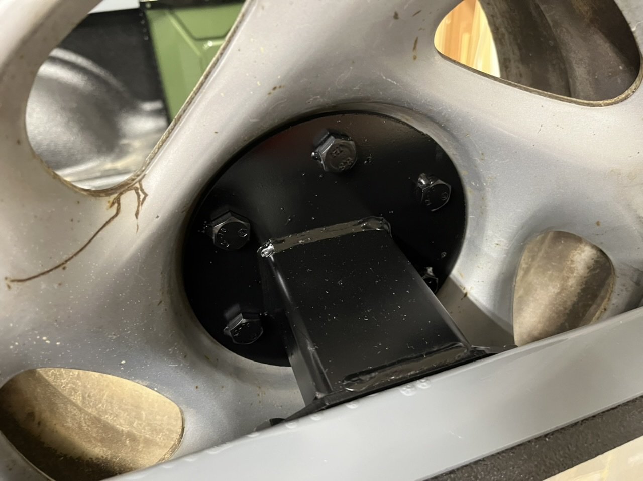

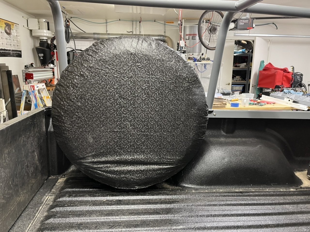

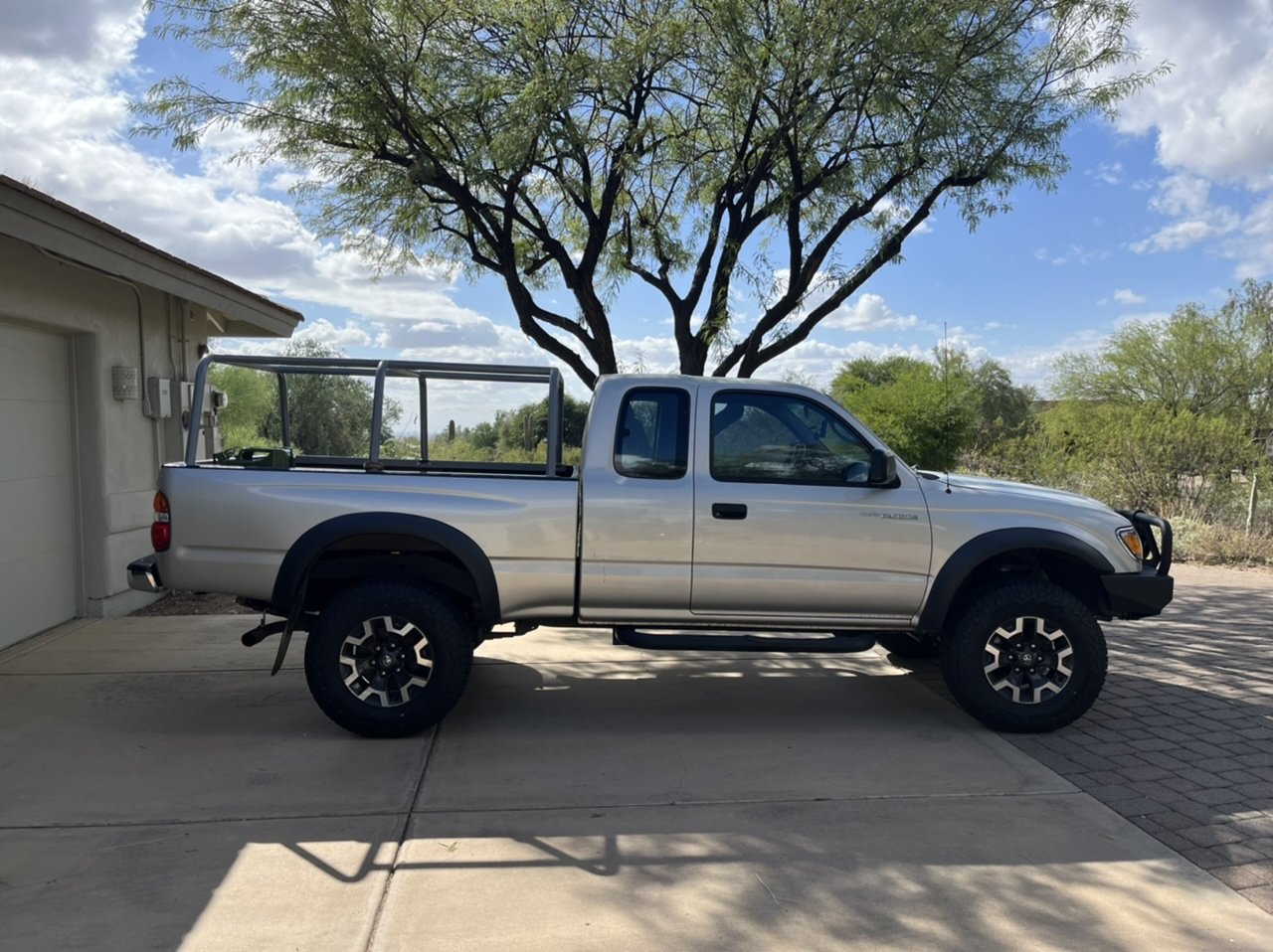

    And here it is, mounted. The wheel cover I bought does not provide adequate coverage and it tore at first use (cheap Amazon trash). Can anyone recommend a quality cover that won’t tear from just looking at it?

    Those Jeep covers work well, just get one that doesn't say Jeep.

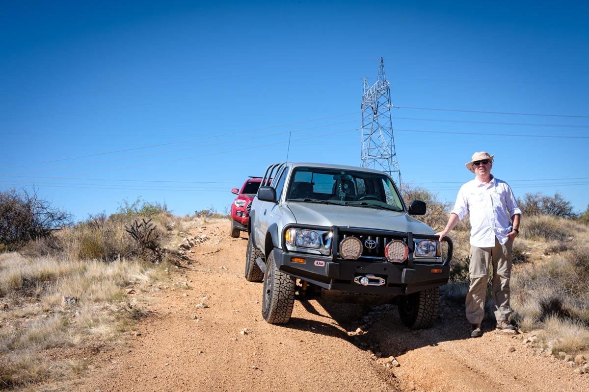

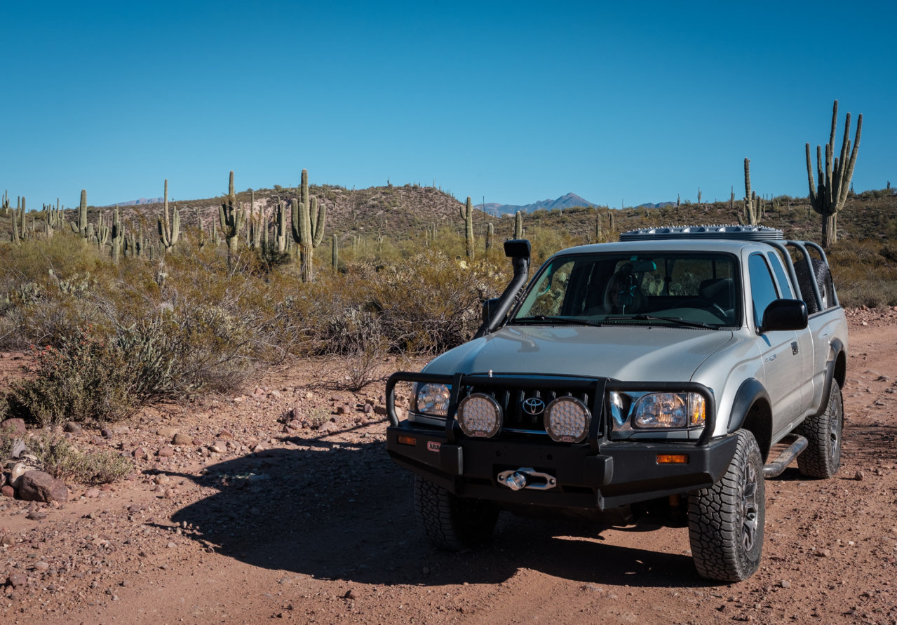

    Went overlanding today in Tonto National Forrest with a buddy who has a 3rd gen Tacoma with double cab and long bed; so he has a looong wheelbase.

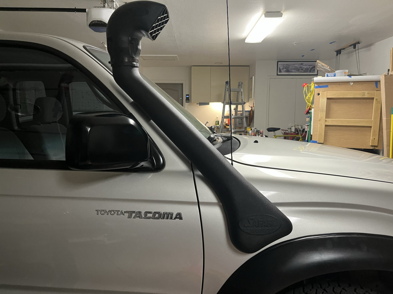

    • snorkel (have already bought the unit but haven't installed it yet).

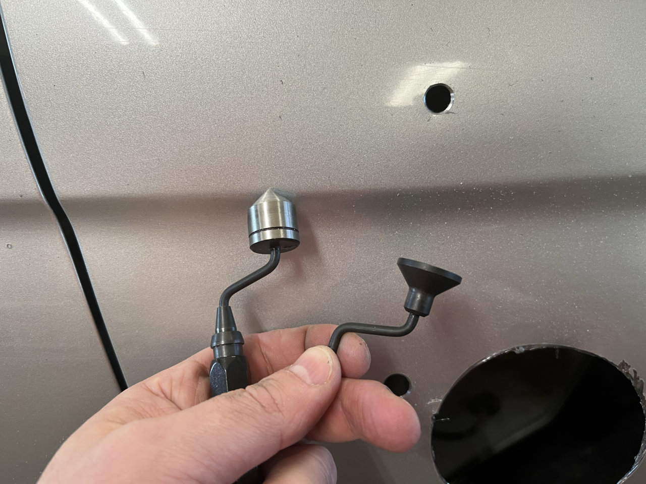

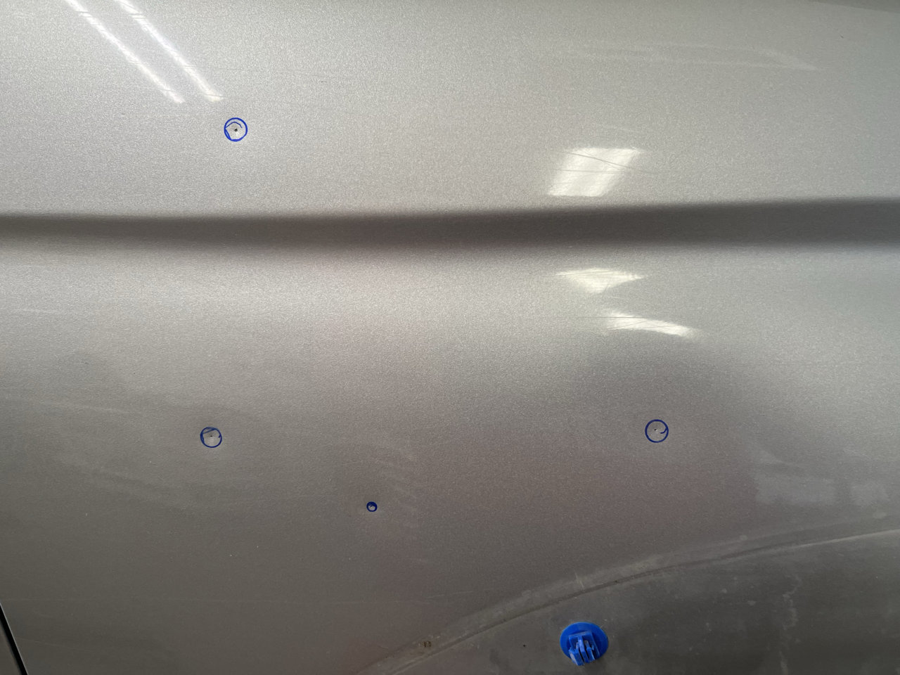

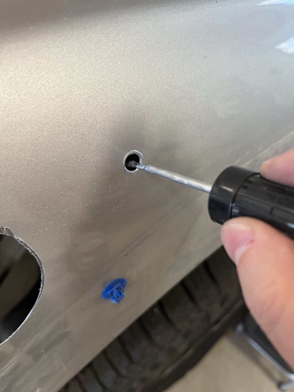

    I was just fooling myself thinking that the build is over. Am planning to explore a trail in Tonto National Forrest that has two water crossings and so decided to install the snorkel I had already purchased earlier. The truck came with a Air Raid direct air system that I removed and sold to another TW member and am reinstalling the factory air filter box. The previous owner had the good sense of keeping it and so it came with the truck.
    Using the template that came from ARB I punched the holes, with some hesitation.
    Drilled them out and deburred them, then painted them using some car paint that came with my younger daughter's car:
    Now I am waiting for the paint to dry. Literally.

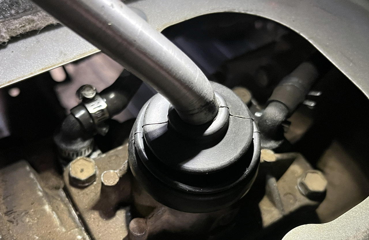

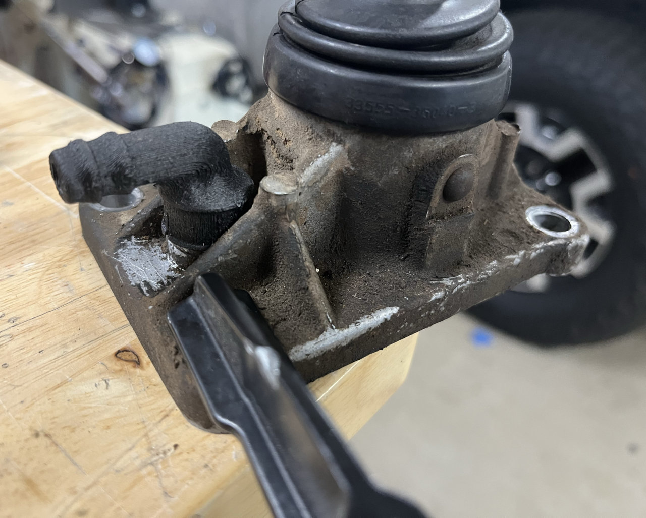

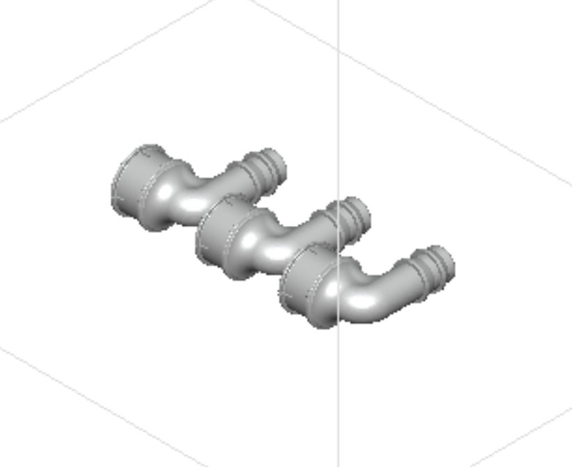

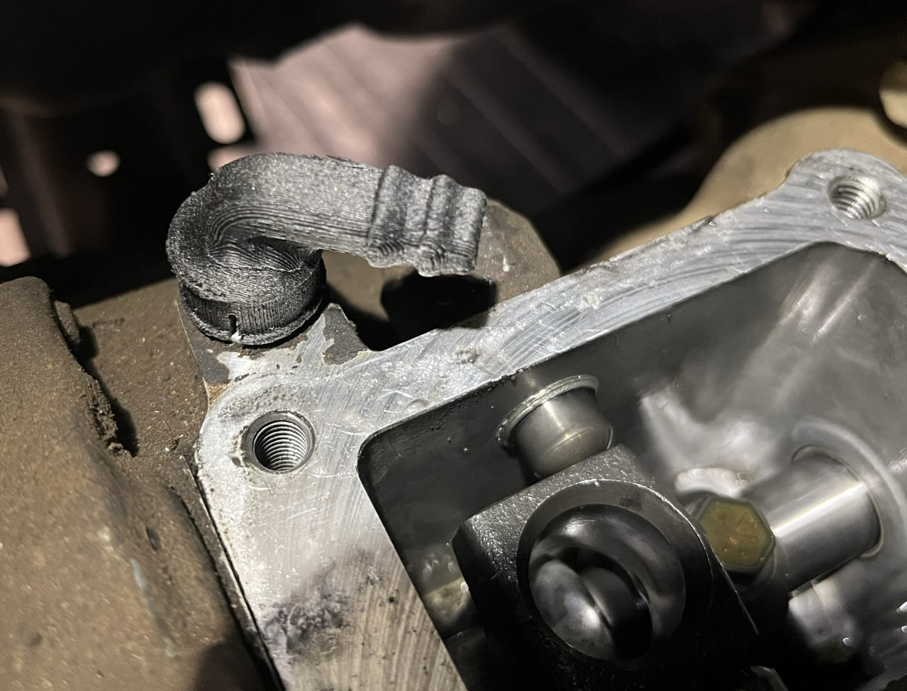

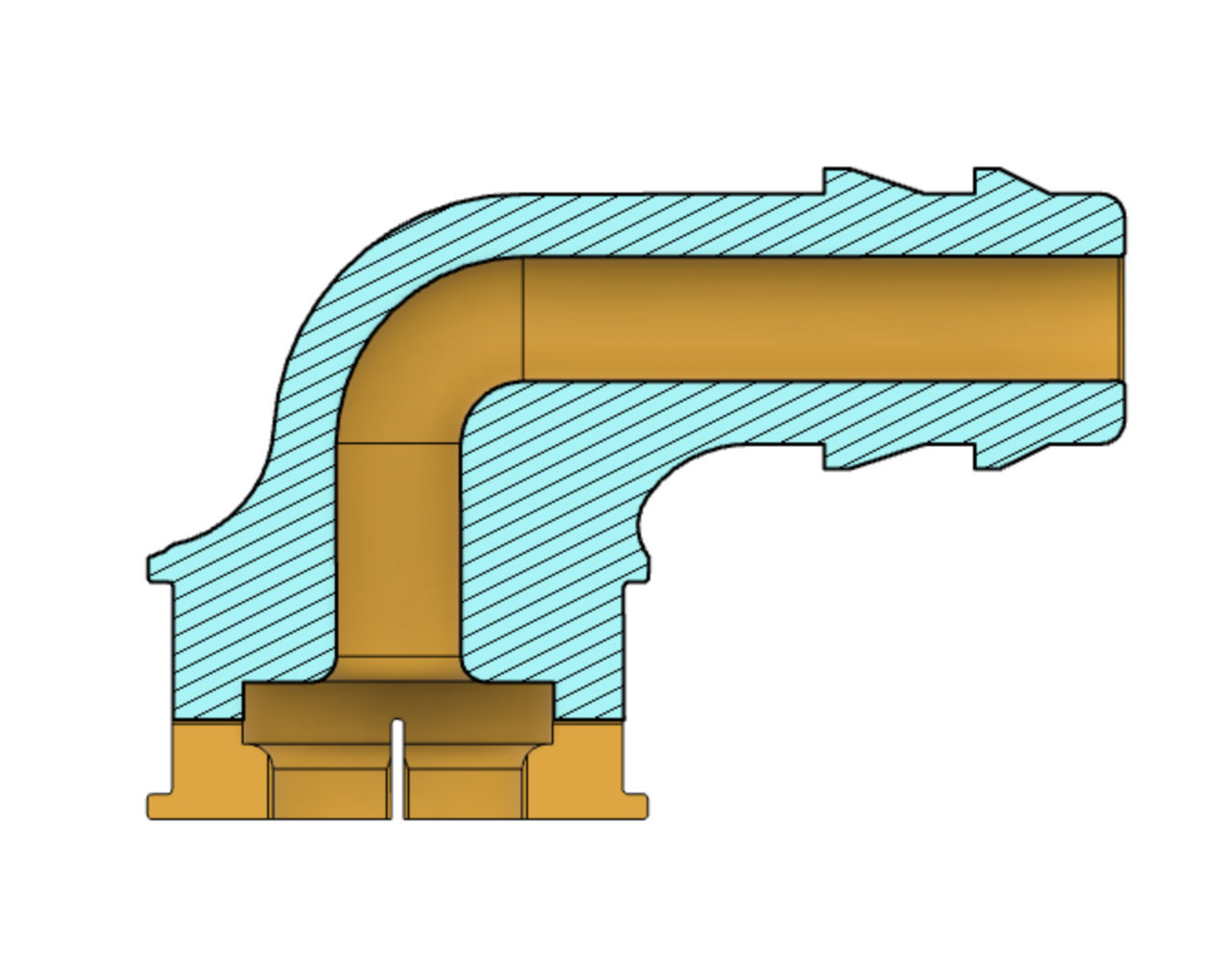

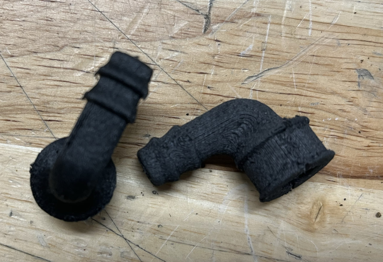

    Finished the transmission breather. This sub-project took longer than expected, as I tried to just clamp a 3/8" hose on the nipple left after one pops off the breather cap. The tight space forced to hose to turn sharply and crimped the hose; plus I was not confident that the few millimeters of the nipple will keep the hose on after rattles and heat dilation, etc. Next I thought of adapting a barbed elbow, but wasn't sure how I am going to tap the holes; the factory fitments are pressed in. The transmission top plate comes off but the second breather is attached to the body of the transmission. Even if one coudl pull the fitments out without damage, there still is the issue of tapping with swarf dropping in the transmission. After some decision paralysis, I designed a 90 degree elbow that snaps onto the nipple and once clamped down, is very secure.
    The barbed end is for a 3/8" ID hose.
    The bottom wraps unto the nipple and takes advantage of a groove on it.
    I printed three of them (thinking that one might break during install) sideways so the layers do not break off the wrong way. This resulted in a strong print, plus I made them out of Nylon/ Carbon fiber 12.

    The prints came out great. With a good push, the fitment snapped unto the nipple, still rotating freely, but once clamped down it was pretty solid, and I am fairly comfortable it will be water tight for my needs.

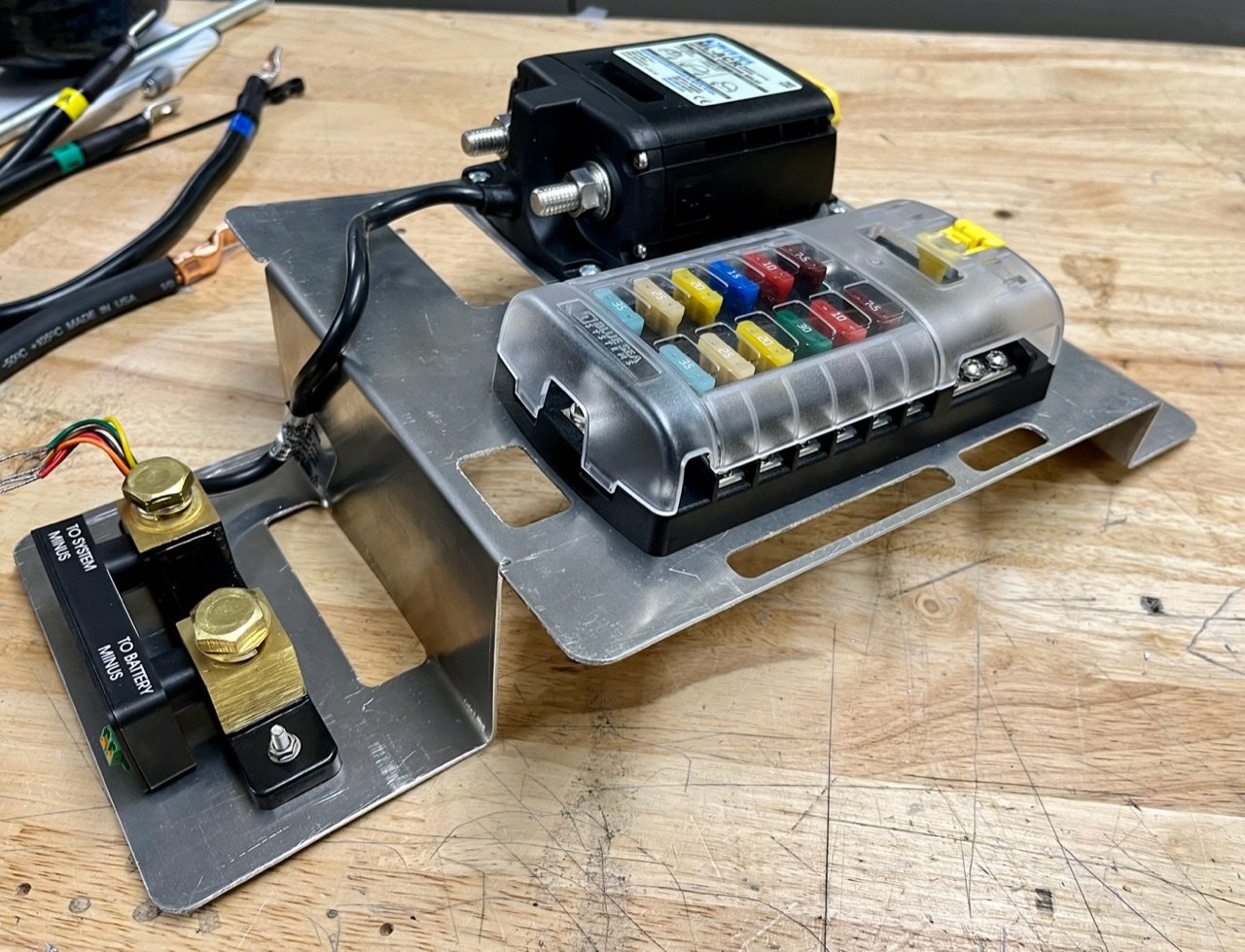

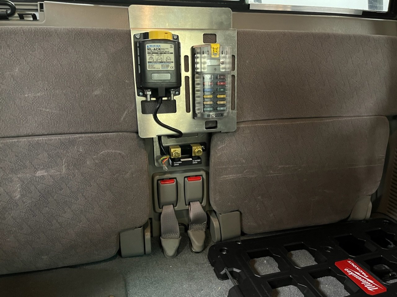

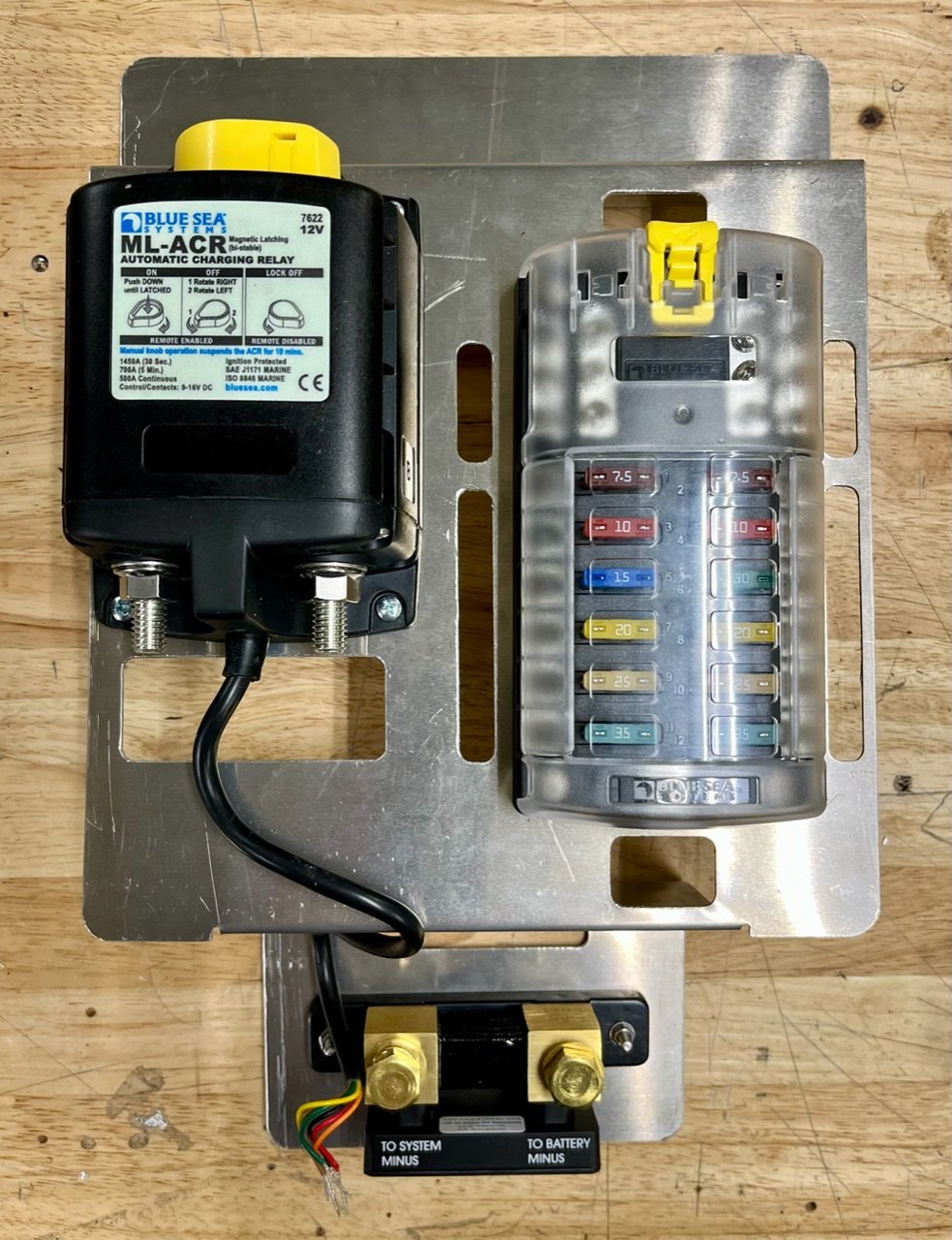

    I am prototyping a panel to install a battery monitor, charging relay and a fuse box on the back wall of the cabin. Will add a second battery 100Ah Renogy) for the ham radio and other “house” loads.
